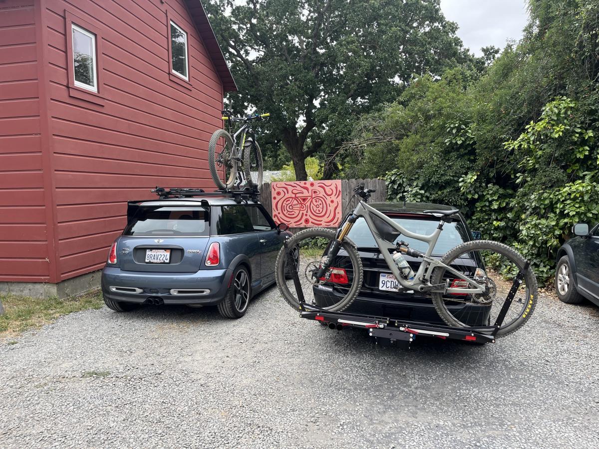

    Get an older bike on 26’’ wheels with steeper head angle and it will be 1’ shorter, problem solved!
    My 2022 SC Bronson XL also have a 50.5’’ wheelbase, at least I save 0.75’’ on my 1up hitch rack cause it’s mullet!!!
    Nice! Yeah my Ripmo is an XL also, thing is a beast. I’ve never ridden a mullet setup but I loved how nimble my old 27.5” bikes were! Definitely curious to try one some day
        I’ve had 26’’ until 2017 than switch to 29’’ than got my mullet in 2022. Would not go back to a 29’’ rear wheel. I should of ride 27.5’’ bikes all those year instead (never had a 27.5’’). 29’’ are fun to roll over stuff but IMO it takes too much energy to accelerate with them vs a 27.5’’. I think mullet is best of both world.

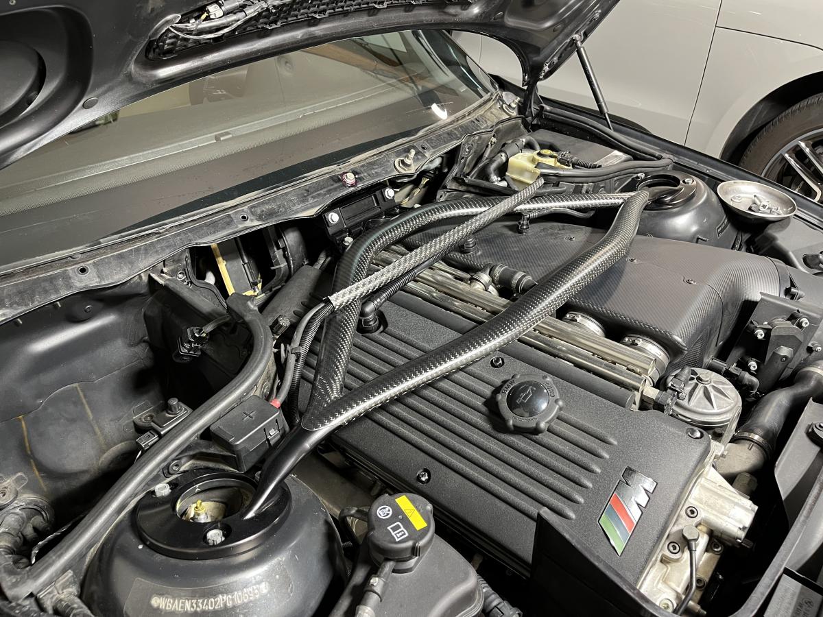

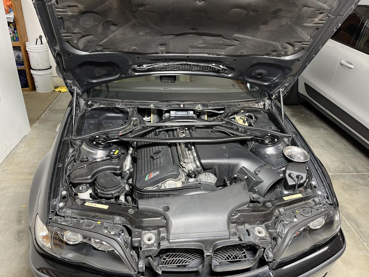

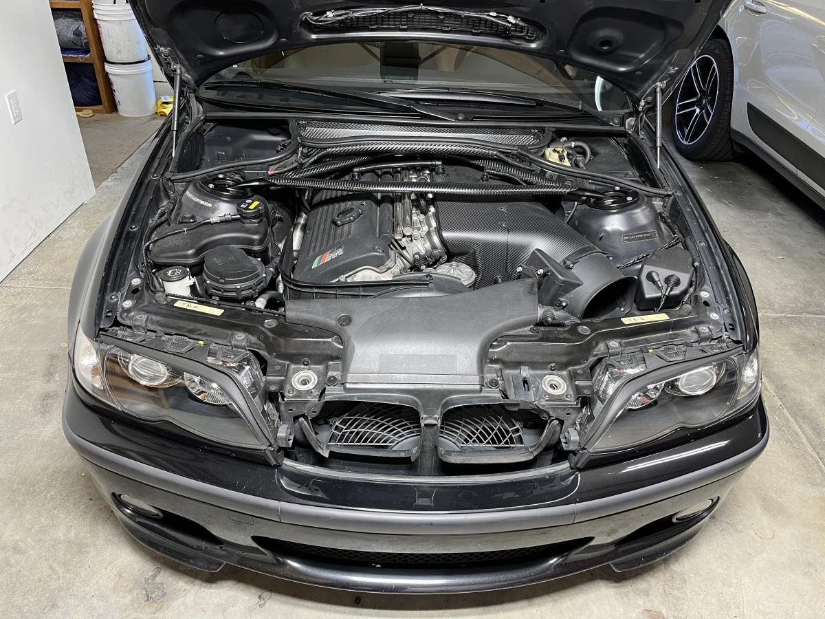

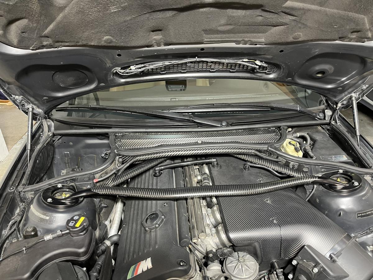

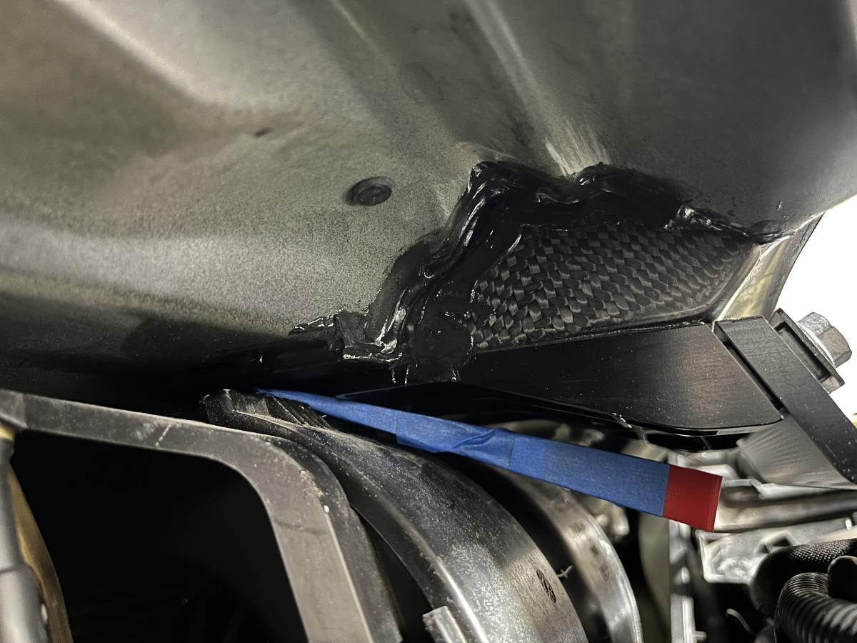

            Slon brace is installed. More details later after it cures up.

                I think it looks good in there, especially with the black anodized tower mounts. It would have been too loud with the clear anodized aluminum. Some day I may still remove and paint the cowl filter cover flat black to make it less conspicuous, but it's fine for now.
                I've been slacking on updates, and I have a bunch of photos to help detail the install, but for lack of time I'll just give my thoughts here now and detail the steps to install a bit later. Install wasn't too bad, it took about 2.5 hours and I was moving at a pretty quick pace. I'd budget 4-6 for this.
                Driving impressions ( tlow98 and mrgizmo04 have both driven it now as well, if they want to comment here), this will be hard to describe but I'll give it my best shot. Right away there's a huge difference. My first thought was immediately that the car doesn't feel like an e46 anymore. I had 50/50 mixed feelings on the first couple drives, but those have given way to 90/10 positive feelings. The car is way more rigid, feels more like a modern car, somewhere around an e39 or closer to an e90 with front end steering precision. Steering precision is way better and more accurate, once you place the wheel, the car doesn't need much interactive correction to keep course. The dead-center e46 feeling is further a thing of the past (this brace, combined with 712 rack and CSL-like toe settings). It's hard to describe, but there is the feeling of more 'support' for the suspension. Initially, it felt like the car was about to understeer because it didn't 'roll' or 'dig' into a corner, the body just stays as one and stays flat. Again very hard to describe.
                There is less feedback through the wheel, as some of the e46 feedback through the wheel seems to have come from undamped front end vibration. I'm calling this the e46 'sizzle' and it's what I was initially sad to lose. The car is certainly more capable and planted, keeps more consistent tire loading in corners, and is generally objectively better, but it did take a way a little of the low speed driver feedback that makes tooling around town exciting. It didn't take away all of it, the car certainly isn't like a modern EPAS BMW, but I'd be lying if I said I didn't miss a little of that feel through the steering wheel. That feel doesn't seem to have provided any real benefit, but it was part of the e46 experience. Now, the contrast to this is that the wheel doesn't vibrate much on the highway anymore, making it more comfortable and more "BMW-like" to cruise at high speed. The e46 always had some extra feedback at speed if you didn't have a super fresh tire balance, and it is actually much nicer on the highway.
                NVH is improved, the car is sharper, firmer, and more comfortable over tough roads. It's most noticeable when you hit bumps with only one side of the car, or hit a bump at a diagonal. Really, much more rigid and composed when interrupted. The car is slightly less 'crashy' on abrupt bump inputs, and generally just feels a bit tougher. Again, much more like a modern car
                I'm basically ignoring all the handling and feedback benefits, because I'm assuming folks reading this will already be well aware. To be clear, the car corners way more confidently and can be placed more accurately with less see-sawing at the steering wheel on the limit. It's a half way step between an e46 and an e90, and that's a good thing. It keeps a bit of the e46 sizzle, but adds some of the benefits of the stiffer, newer chassis.
                Overall, I knew to expect a change, but I didn't really know what to expect. I was really surprised by some of the changes, and after driving around and getting used to it, I wouldn't be able to go back. The rear is also now noticeably less planted and buttoned down than the front. I'm really looking forward to adding that v-brace to balance it all out. Soon. Thanks Slonik for getting this so right!

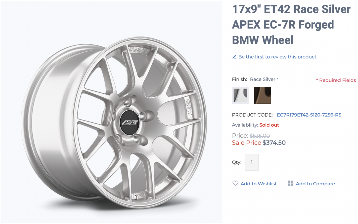

                Also, I did a quick tool around in mrgizmo04's M3 with 996 brakes and now I'm sold, it really does have pedal feel like a Porsche. I ordered the last 17x9 et42 Apex EC-7R wheel (drops a cool 7lb/corner!) in stock to test clearance over the 996 brakes as there's no way in hell the Style 32's can make fixed calipers work.

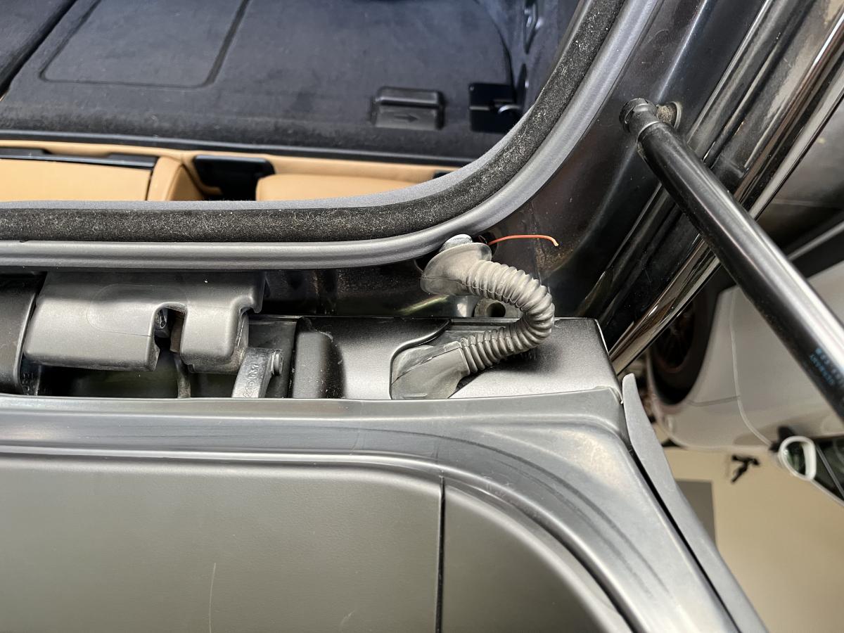

                        Today I tackled the trunk wire that broke and caused my glass hatch release button not to work. What a pain to fix, I had to pull off a brand new piece of plastic which unceremoniously broke in the process. Oh well, everything works again!

                          Happy to leave my impressions of the Slon brace here, as it likely makes the most sense. I hope it helps someone.
                          Bry5on and I have a very similar suspension setup. Koni yellows and stock springs. The only thing that differs is the tires, and sway bar and Slon bar. His bar being 31-ish mm and mine stock convertible front bar. But I’ve also driven his car with the same sway bar as mine. Both are swapped 330i’s with all the front end chassis stiffeners that come on the M3 as stock. I’ve also owned an e91 and know the feel very well as they have, you guessed it, nearly the same chassis reinforcement as stock from the factory that the Slon brace adds to the e46.
                          - it feels like a more mature e46
                          - aka, a better lighter version of an e39 which is pretty fantastic as I always thought the e46 lacked the e39’s tighter, bank-vault like build quality.
                          - less mid corner correction, especially if the surface is bumpy
                          - dare I say it, easier to drive, gasp!
                          I didn't drive it highway speeds, but it was a little eerie. Less "feedback" but I have a suspicion the "feedback" it weeds out is actually just needless noise. So, a step in the right direction. It’s less talkative, but the information it gives you is better and more accurate. It’s a great halfway house between the talkative e46 and, to me, boring e90 feel. The e90 is great, but I found it pretty benign and lacking a bit of character. It’s a little too isolating, to me, for a fun car. Great daily tho.
                          So, objectively better, for sure. And, for me, subjectively better as well. It’s just better. There are lots of ways to stiffen the rear of these cars and after doing so the front end invariably feels out of step with the rear after doing so. There’s now a fix and it’s rad.
                          The only argument against it that rings true with me is that around town driving comment Bry5on made. But that’s subjective and the kinds of statements old people like me make when a memory of something doesn’t quite match their expectation. And I sort of grew up with the E46 so I could see that. At the end of the day it makes the car better in every way with zero downsides I can think of. And in the world of aftermarket parts that’s mostly unheard of. Huge props for making something like this to such a high degree.
                          if the car came with this new and you removed it you’d think the car was absolutely worse off. My car now feels “jiggly” where I previously didn’t notice.
                          so yeah, it’s on my list, damnit. My $5k car needs another $5k part like I need another hole in my wallet :-)
