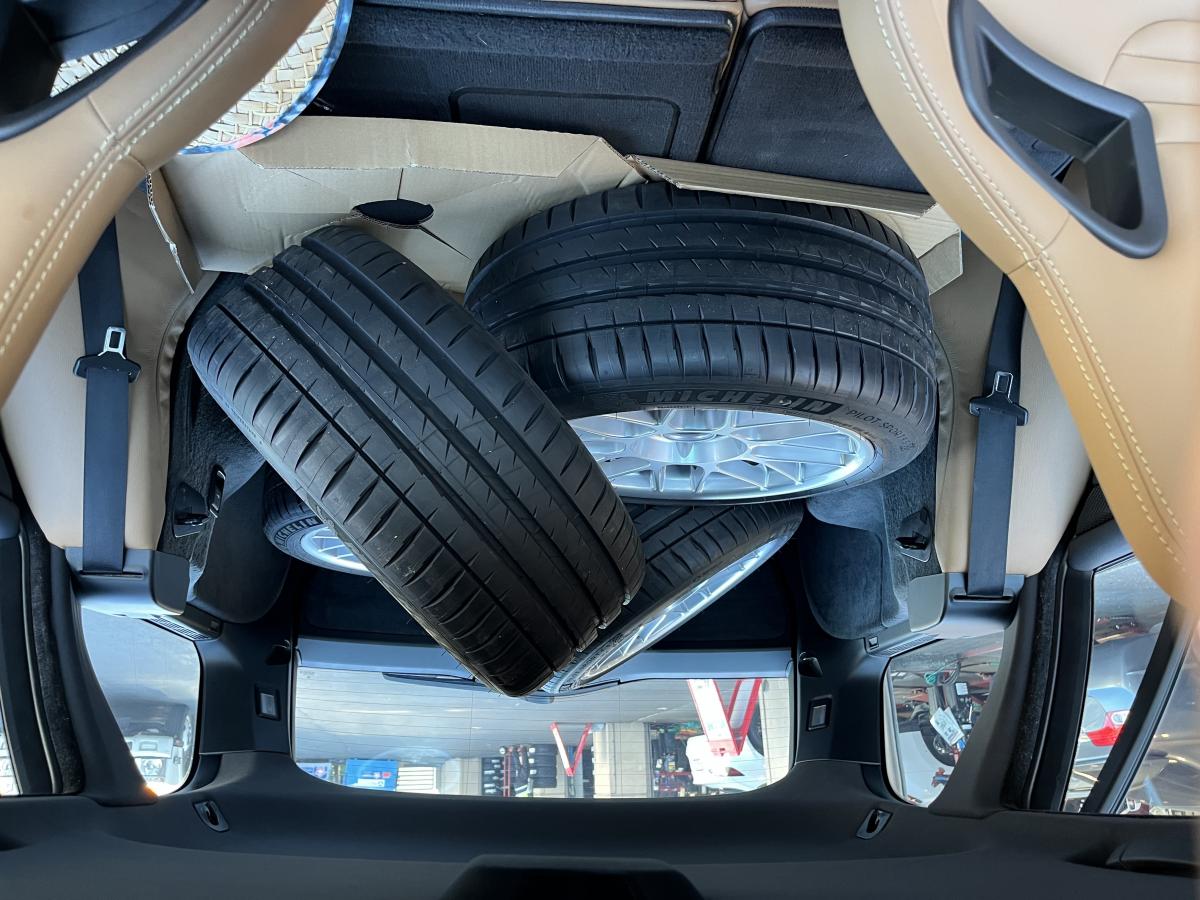

                          I committed yesterday and picked up a set of them. Overall they’re still light and ultimately I think this is the best balance of the above priorities. Bonus points that they’re the most affordable.

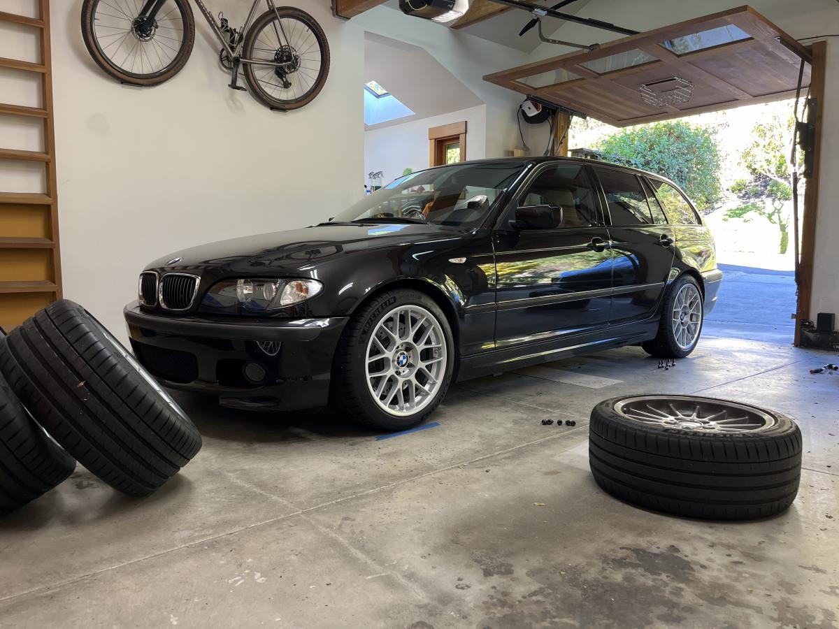

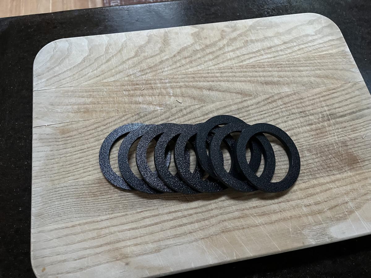

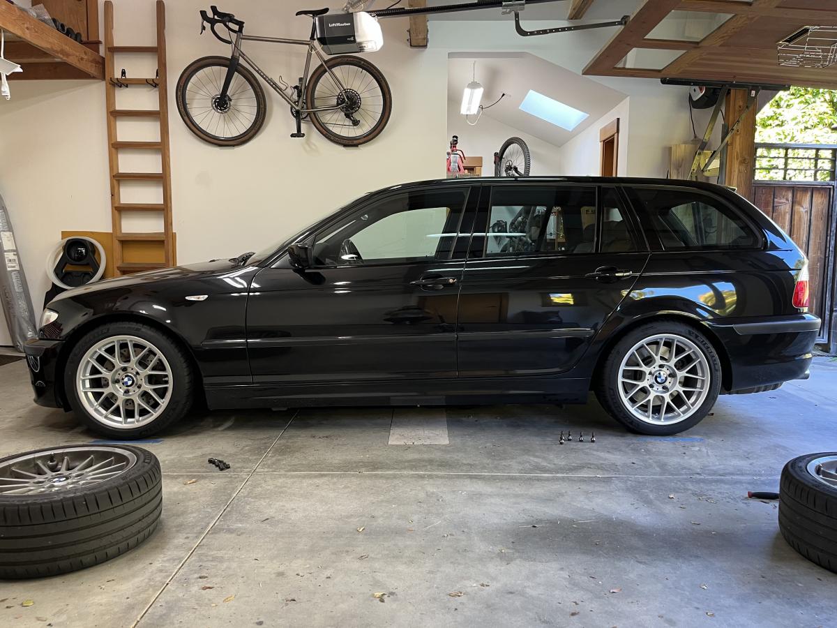

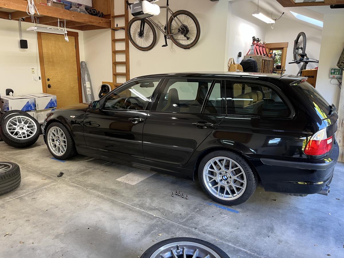

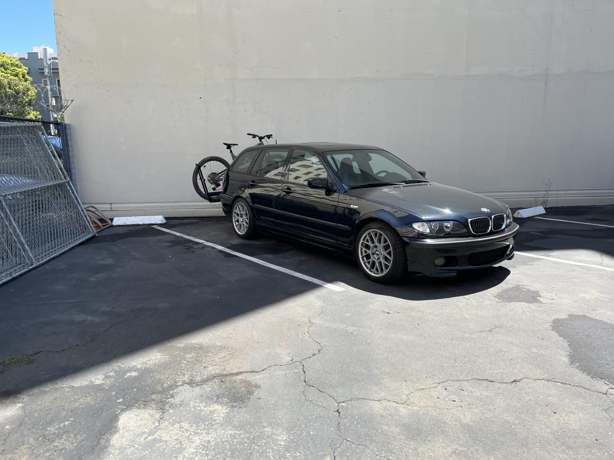

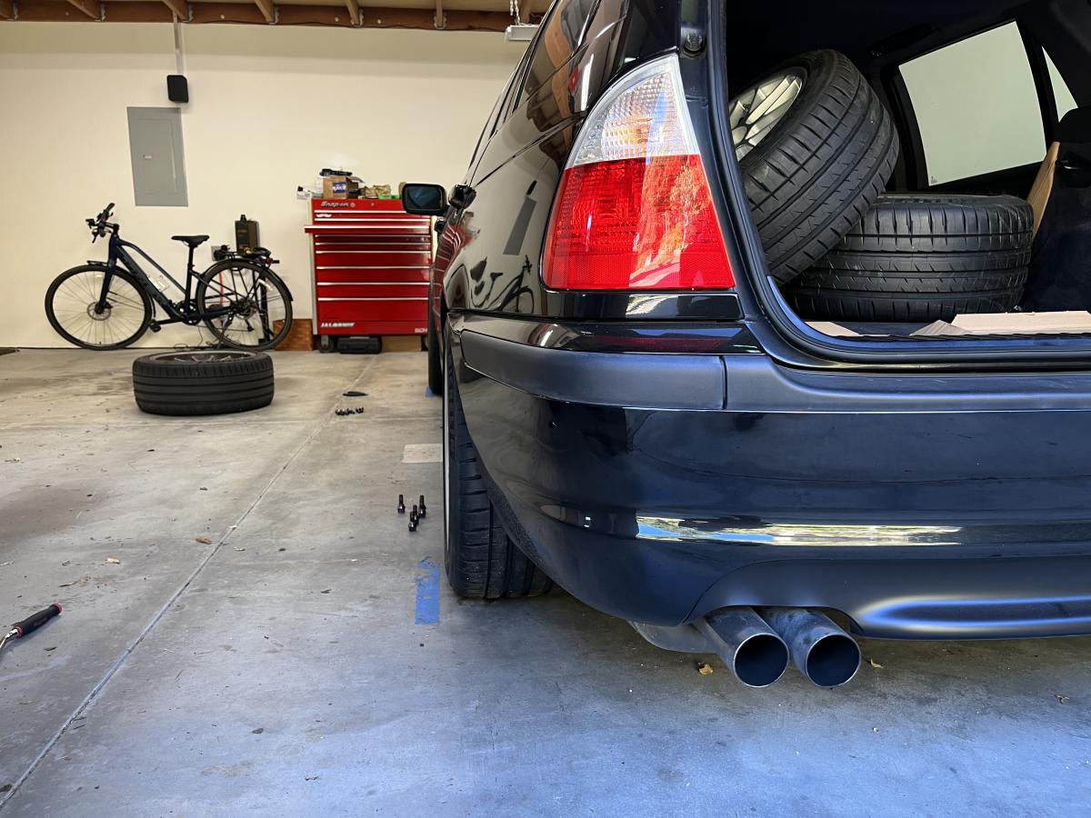

                              Math worked out once again. Perfect fitment of the 17x9 et52 e82 1 series wheels after adding some spacers. I’m not a fan of spacers, but there really wasn’t another option that fit the requirements. These end up being 7lb lighter per corner, dropping almost 30lb.
                              In front, with a 245/40/17 on a 17x9 et47 (after 5mm spacer) wheel, there’s 3.5mm clearance to the strut and just a few millimeters of tire past the fender with 2.15 degrees of camber from flipped strut hats set full positive. We’ve successfully preserved the correct factory scrub radius and steering feel.
                              Measurements are coming out at around 3mm clearance to 996 calipers, although I’m going to need to test fit this on another car before I commit to changing the brakes.​
                              In the rear, I’m running the same 245/40/17 on the same 17x9 (can rotate these) but with a 12mm spacer and 1.6 degrees of camber. This puts the tire lip straight under the fender, and it also appears to clear with no spacer. I still have to pull the spring out and check full travel clearance to validate, but it looks promising given the tire stretch.
                              All told, happy with how all this is turning out, even though I’m giving up my favorite factory wheels.

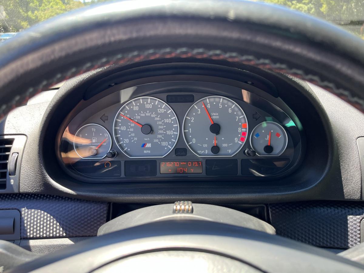

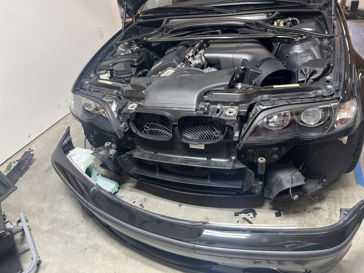

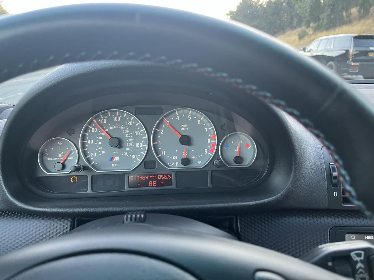

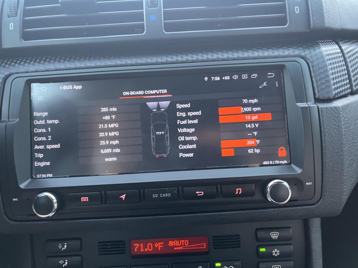

                                It’s been a little bit.. now that it’s summer and warm I’m chasing overheating again. In pursuit of solving that, I swapped the M3 aux fan and radiator ducting in. An improvement, but no dice. The car still overheats on hot days uphill with AC on, even at highway speeds. Maybe another radiator is in the cards, as I’ve been through three thermostats, two thermostat housings, two water pumps and two radiators. Really strange, super repeatable and temps are actually going up, it’s not just the gauge. I’ll get it eventually.
                                Click image for larger version  Name:	IMG_5680.jpg Views:	0 Size:	169.9 KB ID:	229298 Click image for larger version  Name:	IMG_5681.jpg Views:	0 Size:	253.7 KB ID:	229299

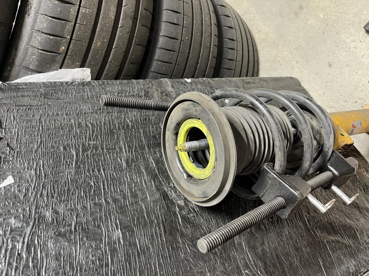

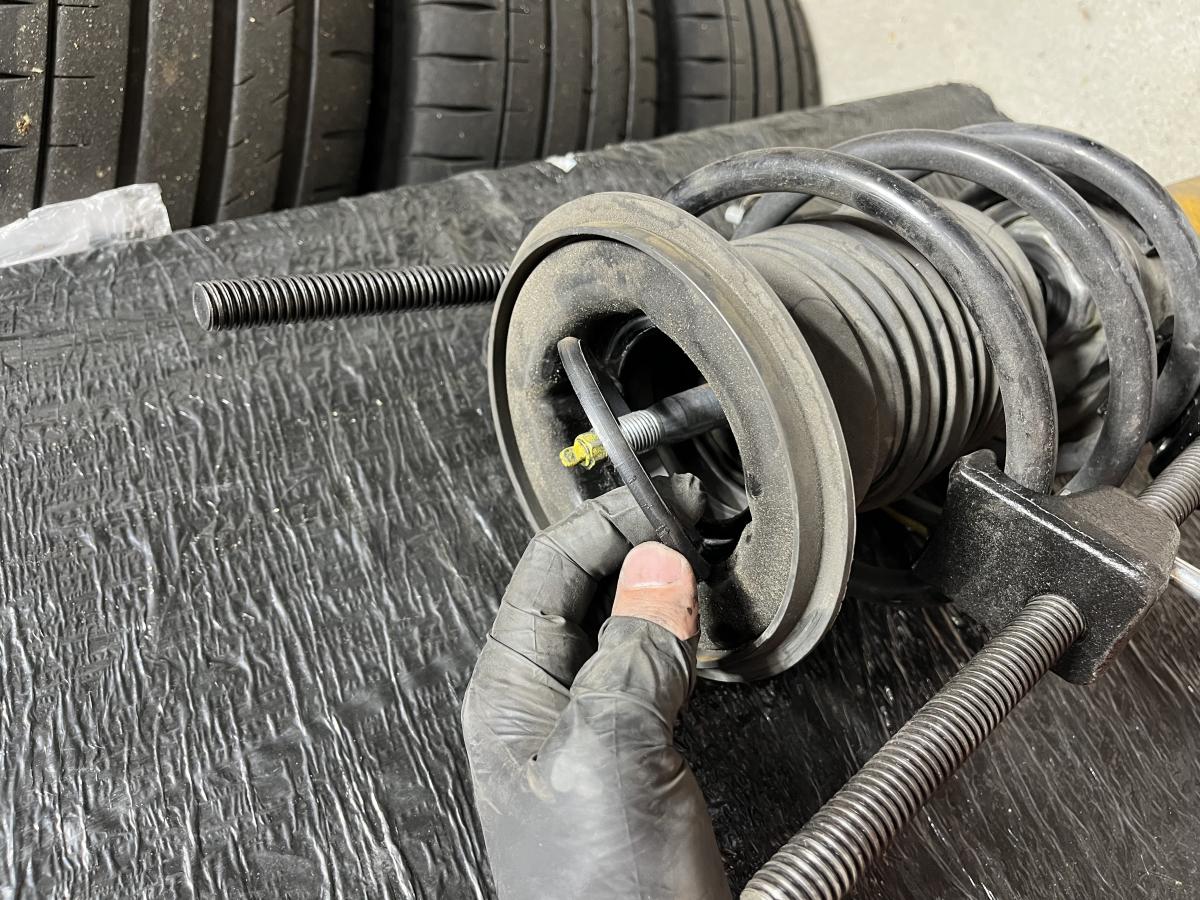

                                I also made and added some 6mm spacers to the stock M3 springs to bring it more to ZHP height. The roads around me really are shit and this made a great difference.
                                Click image for larger version  Name:	IMG_5792.jpg Views:	0 Size:	188.2 KB ID:	229300 Click image for larger version  Name:	IMG_5805.jpg Views:	0 Size:	215.4 KB ID:	229301 Click image for larger version  Name:	IMG_5807.jpg Views:	0 Size:	248.5 KB ID:	229302

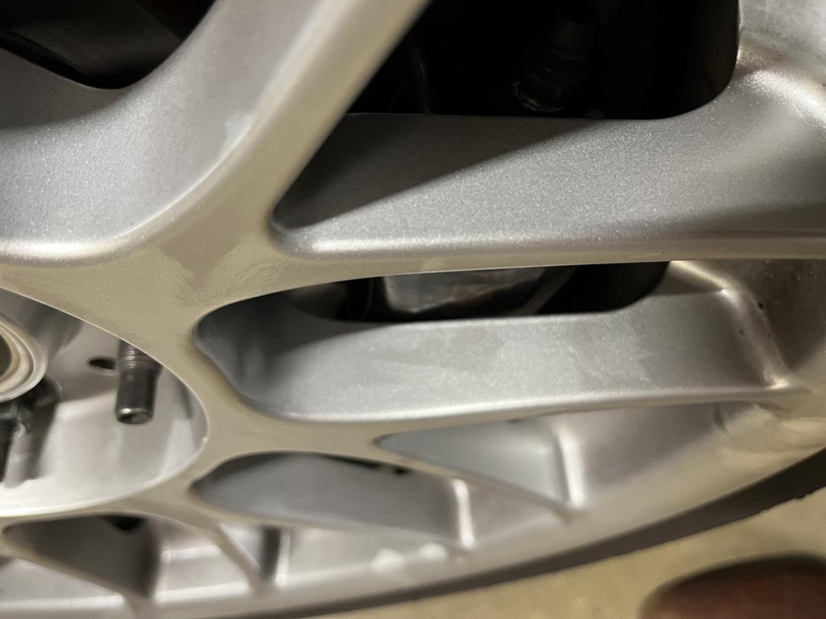

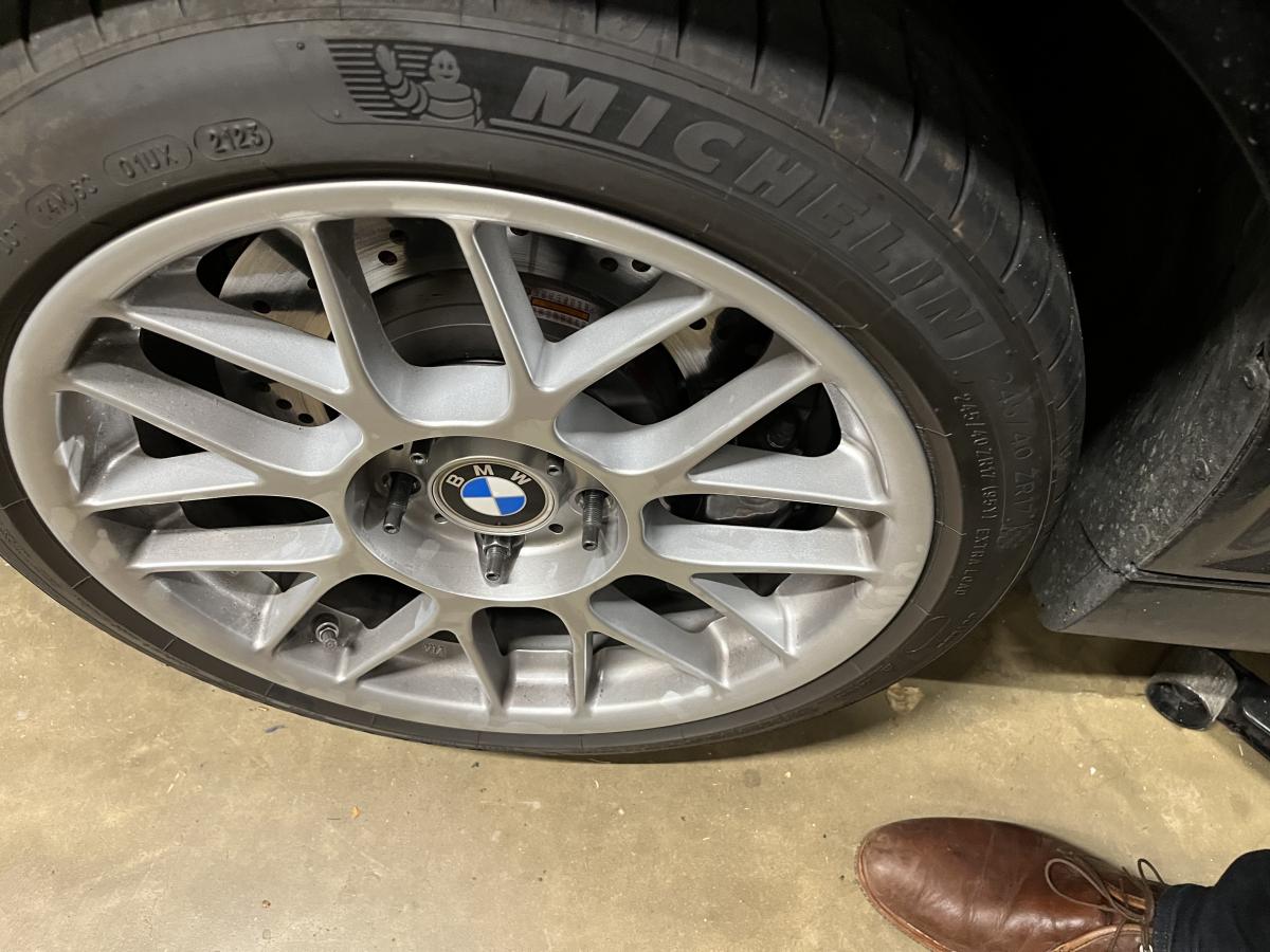

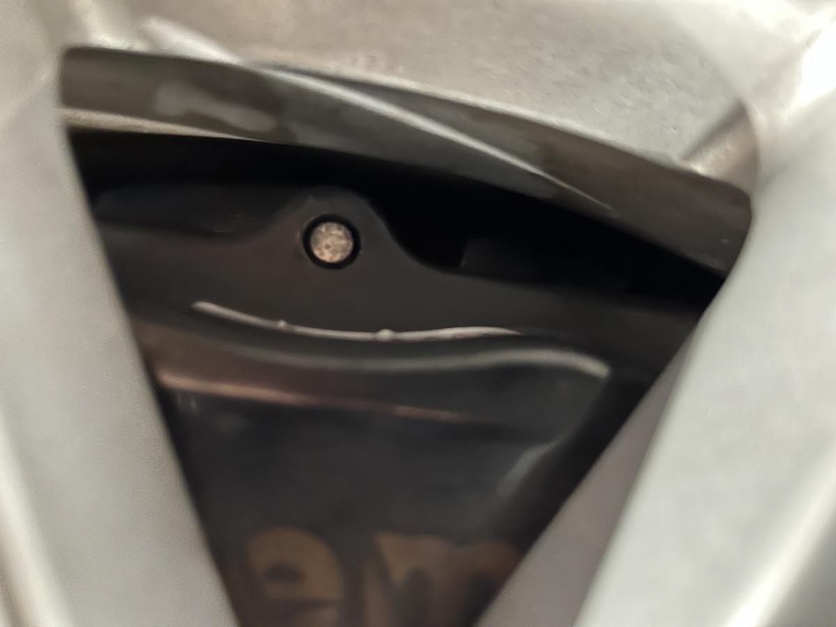

                                And last, I swung over to mrgizmo04’s place to test fit my wheels over 996 brakes, as by the measurements it was going to be super close and I didn’t want to commit if it was going to require a large spacer. Well, it was super close, just over 1mm of clearance to the 345mm brakes and 996 calipers over the 17x9 et47 wheels. I ordered some 6mm spacers to make it 2.5mm and placed orders for black Porsche calipers and all the parts needed for the brake conversion. I miss that Porsche pedal feel and one ride sold me on the swap. That, and the fact that my wife’s SUV and my 50 year old stock-brake sedan have better pedal feel than my M3 setup..
                                Click image for larger version  Name:	IMG_5872.jpg Views:	0 Size:	134.3 KB ID:	229303 Click image for larger version  Name:	IMG_5873.jpg Views:	0 Size:	84.8 KB ID:	229305 Click image for larger version  Name:	IMG_5875.jpg Views:	0 Size:	57.8 KB ID:	229304

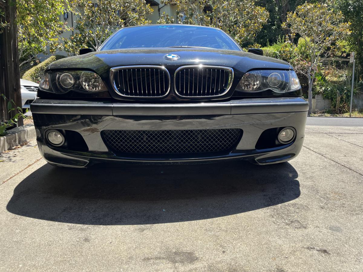

                                Other than that, just putting the miles on. It’s doing great.
                                Click image for larger version  Name:	IMG_5704.jpg Views:	0 Size:	224.5 KB ID:	229309 Click image for larger version  Name:	IMG_5831.jpg Views:	0 Size:	260.5 KB ID:	229308 Click image for larger version  Name:	IMG_5886.jpg Views:	0 Size:	138.0 KB ID:	229307 Click image for larger version  Name:	IMG_5888.jpg Views:	0 Size:	236.8 KB ID:	229306
