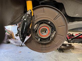

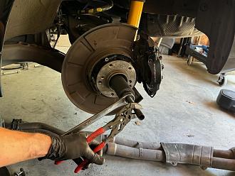

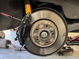

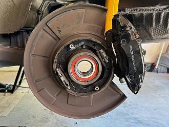

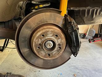

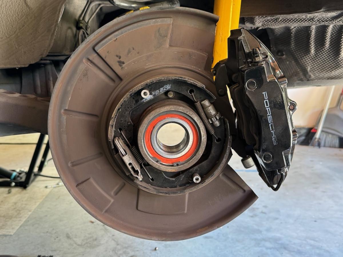

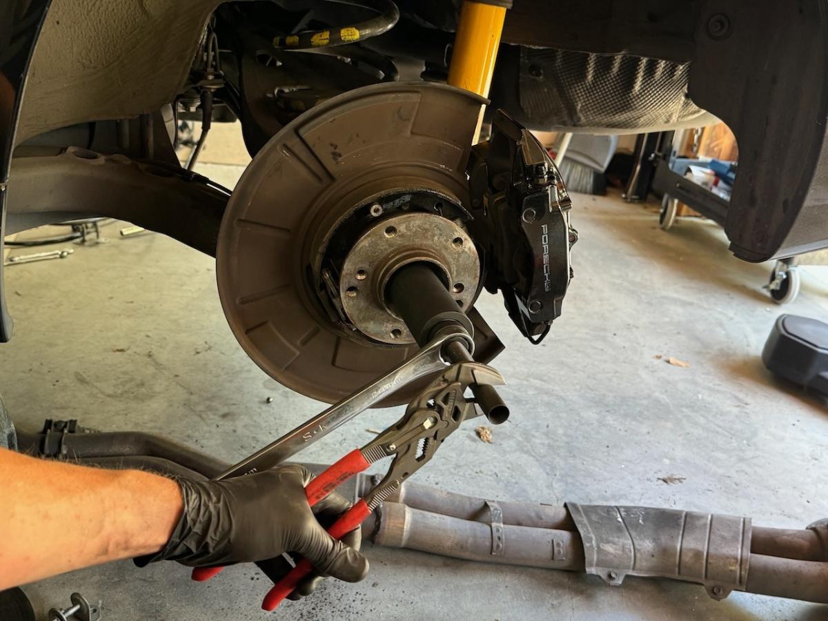

                      And following that five minutes of work (the post above took longer than the job itself), I headed to the rear of the car to do wheel bearings and half shafts.
                      I hadn't heard any grumbling noises from the back, but it turns out that the clicking I'd been hearing may have actually been related to the wheel bearing, as it was pretty shot on the driver's side. This job sucks on the e46, it's actually the first time I've done it. Mostly because the only good way to get the hub off is with a slide hammer. The later cars (and the e39+ I believe) have bolt-in wheel bearings. SO MUCH BETTER. Anyway, here we go. Lighter on pictures, no DIY here.
                      Left rear, this install tool is pretty slick and makes easy work of pulling the axle in:
ID:	272632 Click image for larger version
ID:	272635 Click image for larger version
                      And the right rear:
ID:	272636 Click image for larger version
                      And the fresh half shafts, where you can also see the crappy SSv1 tolerances pointing the exhaust too far to the passenger side:
                      Overall, this was a smaller change than the solid subframe bushings, but was still an improvement. Now that I think it was the wheel bearing driving the clicking, I'm inclined to say it wasn't worth the $1500 or whatever it was for both half shafts. It's better, but probably not $1500 better. There's not much of the m-clunk anymore, which is nice though! We'll see if it stays that way.
