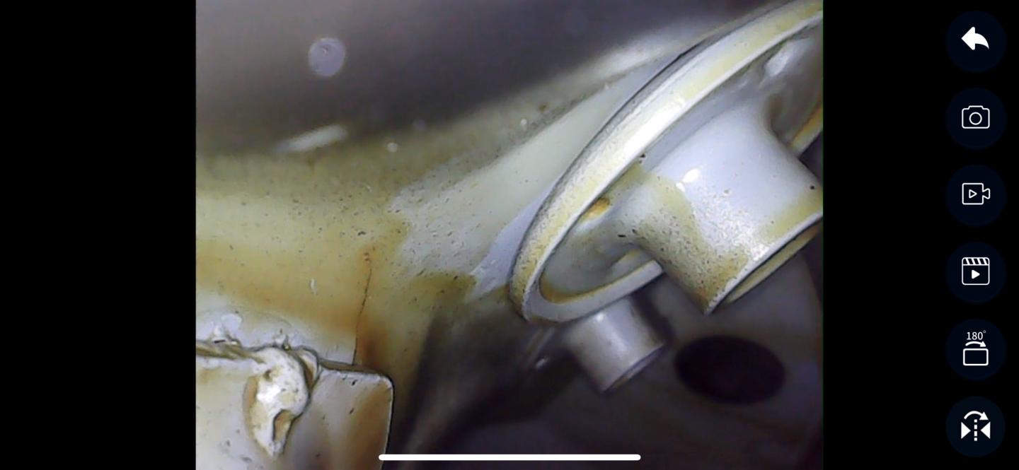

              FYI I'm pretty sure it is just the top layer of sheet. (Edit: thinking about this further it must be the case as it was the hole for the isofix bolt that I put the camera through)
              Here's a photo of the mounting points for the seatbelts, they're this captive nut/collar welded to the top layer of sheet metal. I don't have a photo of the isofix points handy, but can't see them being more robustly built than the seatbelt points. I suppose for the seatbelt the load is going to be fairly one-directional perpendicular to the plane of the sheet metal, whereas a brace is dealing with loads in the same plane as the sheet metal.
              (The orientation of the photo below is weird, but at the top of the photo is the angled top-layer of the seat base. The nearer captive nut/collar is for the RHS seatbelt receptacle and the further one is for the LHS receptacle and bottom point for the centre seat belt.)

                Oh, very cool! Had no idea that's how it's built under there.
