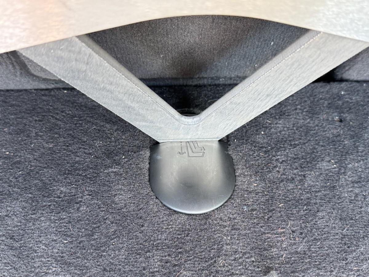

      I trimmed the isofix cover to clean up the install:

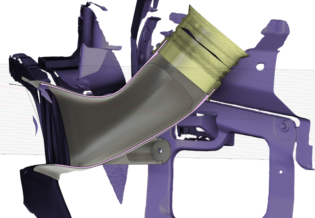

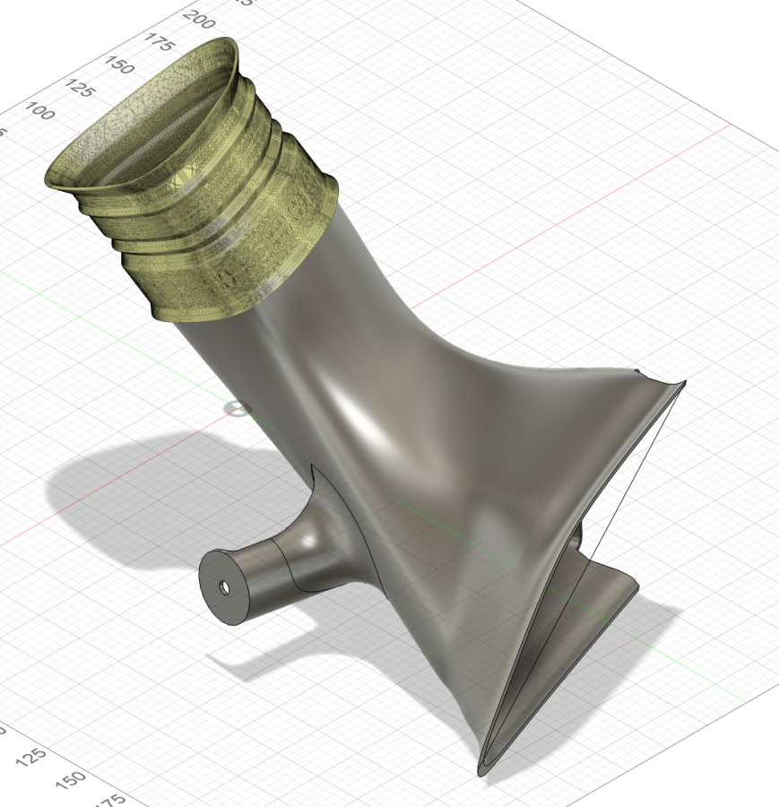

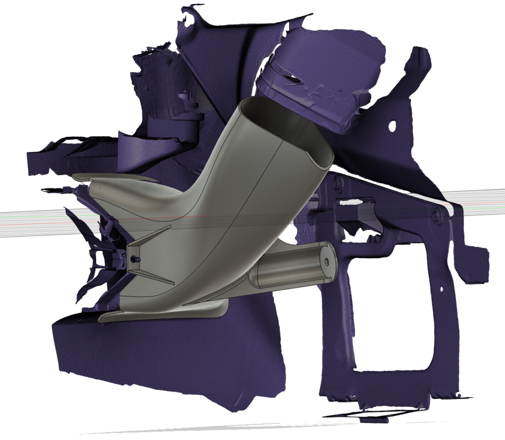

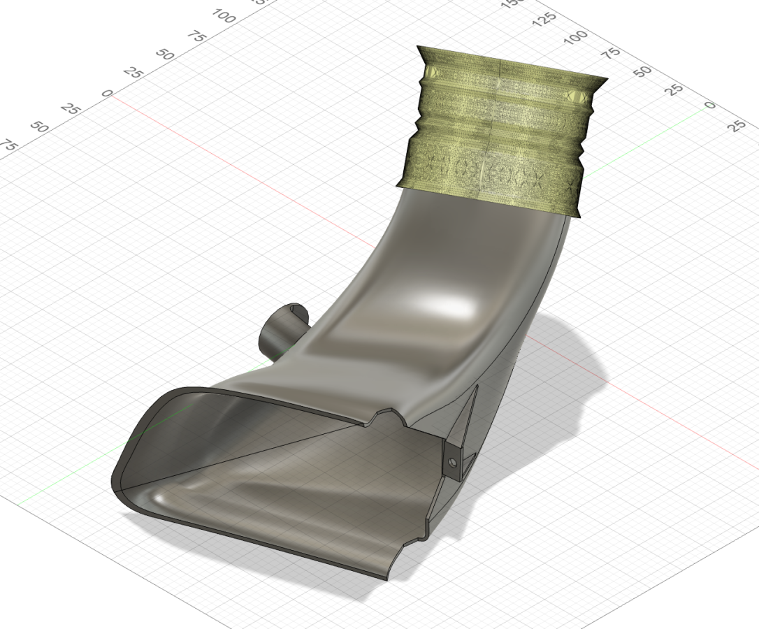

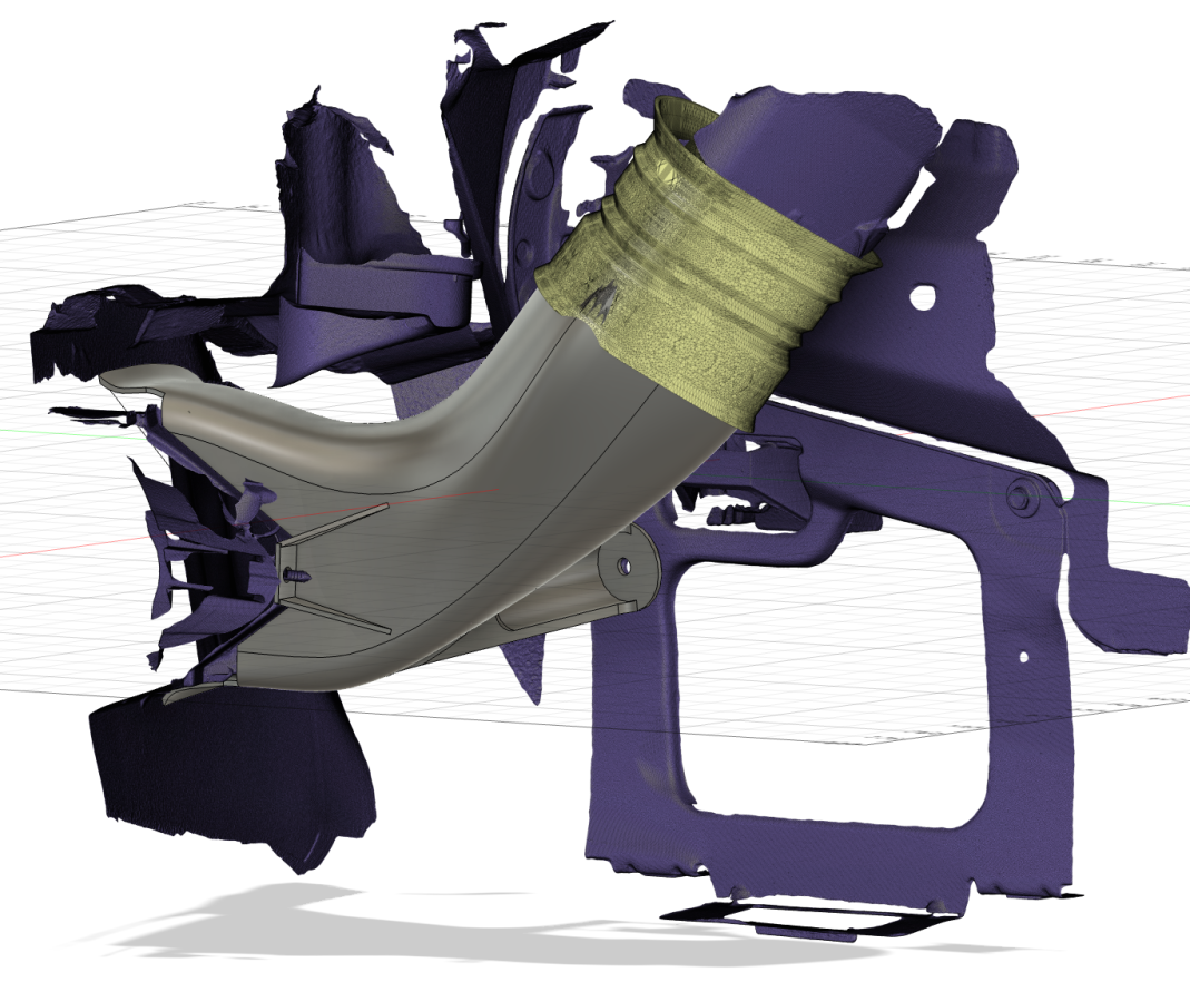

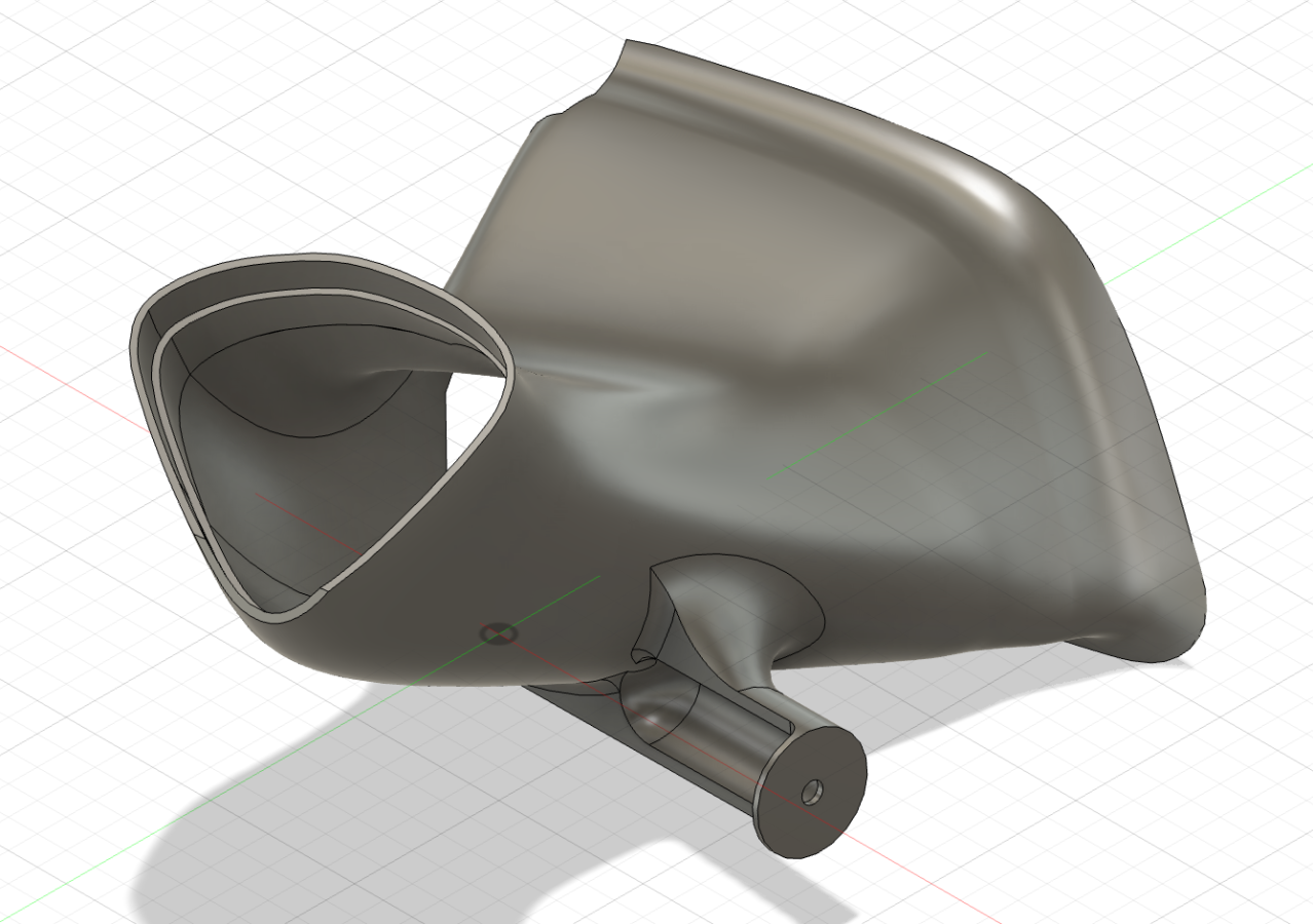

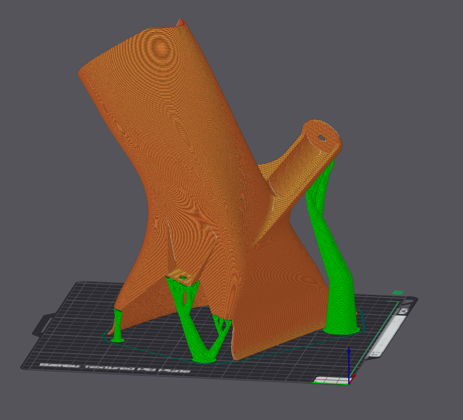

      And by popular demand, iteration 1 of the stock M3 bumper to CSL intake duct is complete and off to heinzboehmer for a test fit:

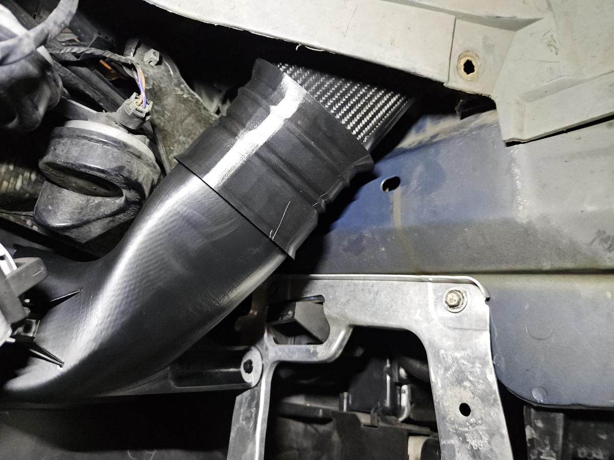

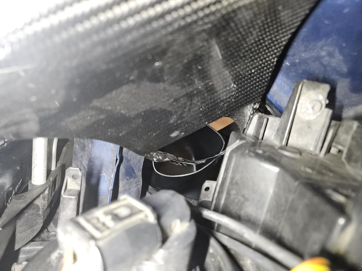

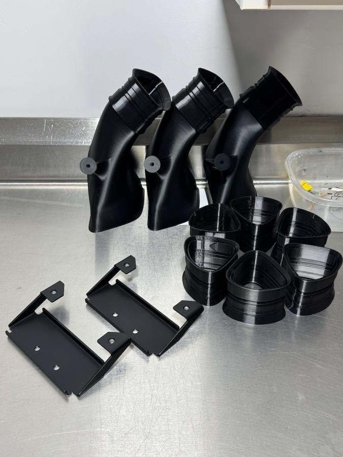

            Ok, standard M3 brake duct fits great on the car with a factory flap (but has a prior fender bender) and does not fit at all on heinzboehmer's car with the Karbonius snorkel. Time to print another and test fit on a second M3 after adding a couple little tweaks (more core support clearance, air transition into accordion boot).

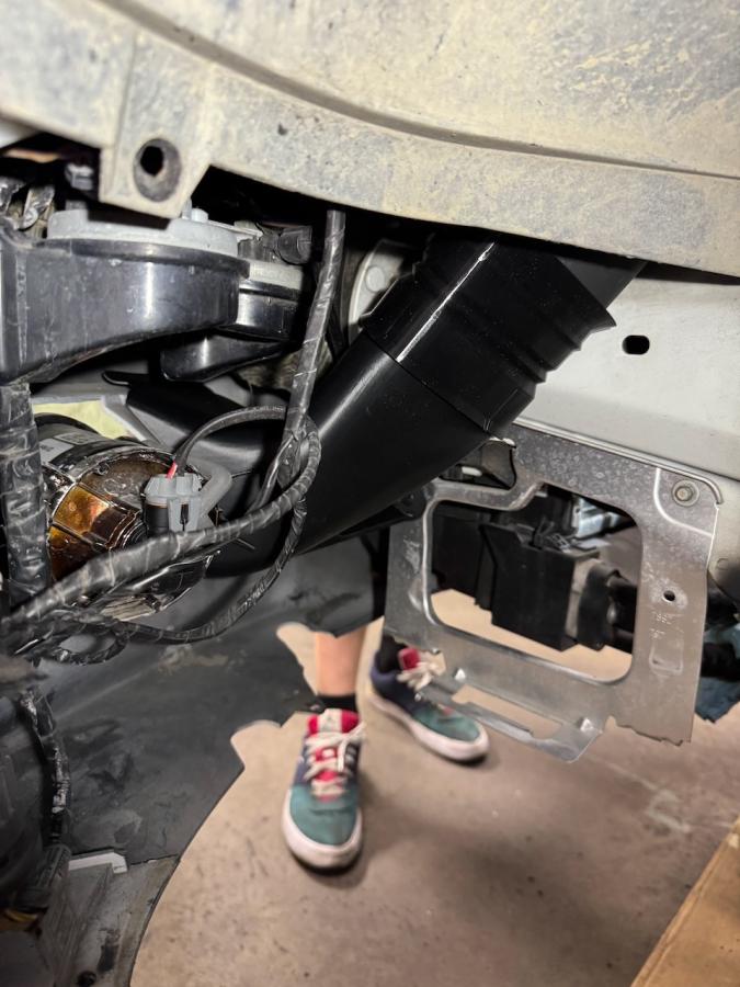

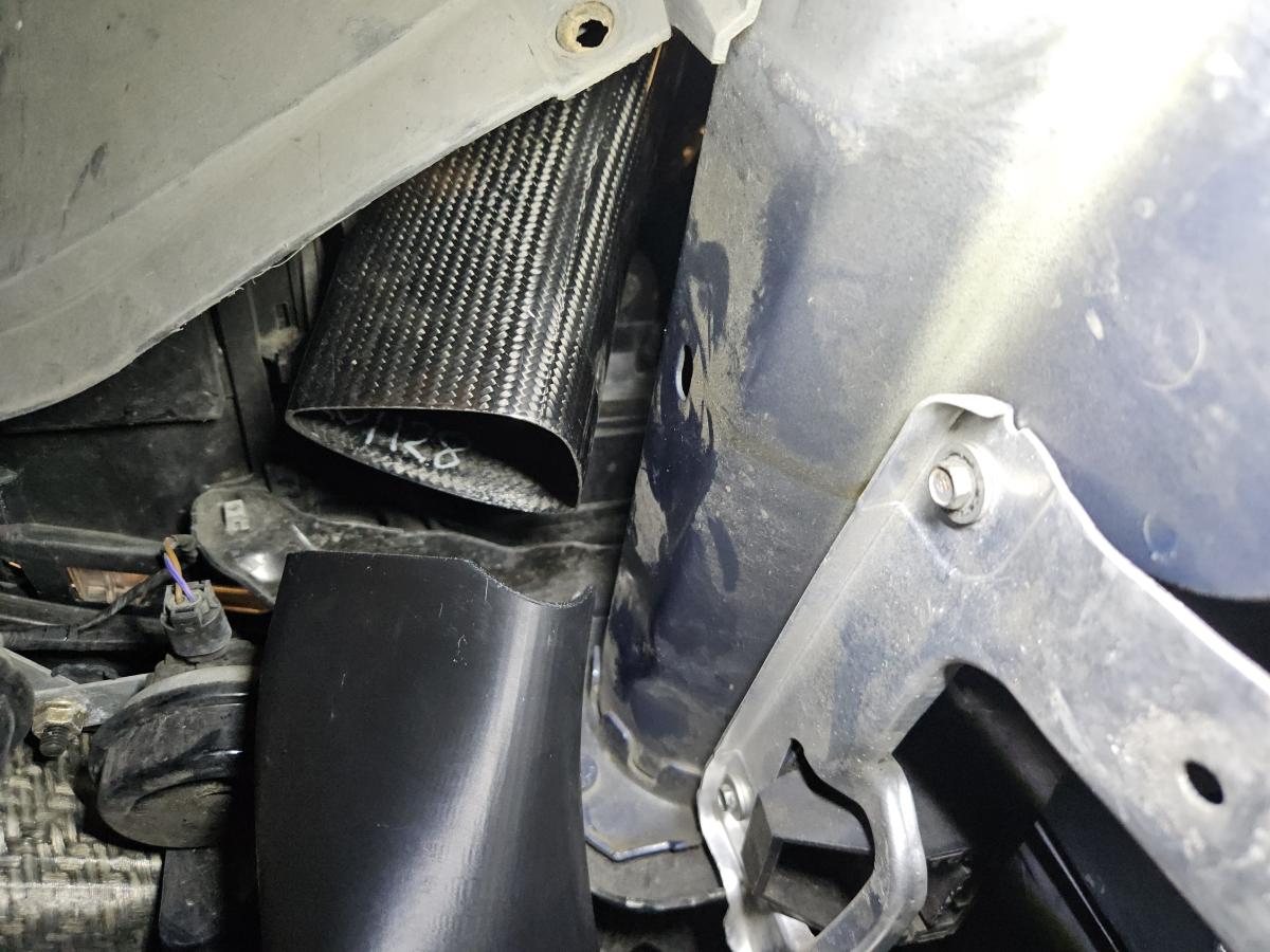

              Here are some pictures of the first test fit on my car:

              That's the same duct (as in literally the same part) that's in Bryson's pictures. There's clearly something off about my car, the scanned car or both. I think these are the possibilities:
              1. Karb snorkel is not the same dimensionally as OE.
              2. My intake isn't fully seated.
              3. My car's bumper fitment is off.
              4. My car's stamped aluminum brake duct bracket is far too bent out of shape (I know it is at least somewhat messed up).
              5. Scanned car has some tweaked dimensions thanks to the fender bender.
              6. Some unknown differences between early and late model years.
              Took my bumper off yesterday and found some failed plastic welds. They weren't in a spot that would have affected the duct, but I'm taking this opportunity to fix the fitment, as it's never been perfect.
              I've messed with the fitment of the bumper a bit, but haven't fully mounted it back on. Super quick test fit before work this morning yielded much better fitment of the duct. I'll continue messing with it later.
              But honestly, (1) above seems like the most likely culprit. Will keep testing.

                      By design there’s a 25mm gap and a flexible ‘accordion’ TPU boot. The boot slips over the duct, then the CSL snorkel ‘clips’ into the boot like factory and pulls the boot up slightly. The boot has 20mm of engagement so it can act like a slip joint and also can deform axially/radially. It’s the yellow modeled part in the section view above
                      Originally posted by YoitsTmac View Post
                      In fact it would be better if you could attach something to the snorkel shaped like a funnel that goes over the intake pipe to decrease the chance of air turbulence and ensure the air gets rammed in regardless of engine tilt.
                      ​There is also a lead-in to the TPU boot to transition the ID smoothly instead of into an abrupt lip. I think this makes 0 difference practically but makes my OCD much happier. Also can be seen in the section view above.

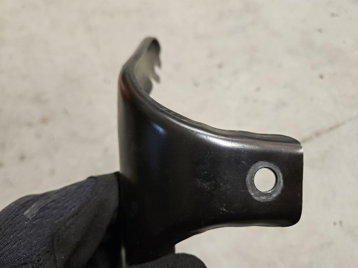

                        Okay so it turns out that none of these were correct. Actual culprit was the wishbone bracket under the airbox. Guess it got bent at some point:
                        Duct fits great with the bracket bent back to where it should be!

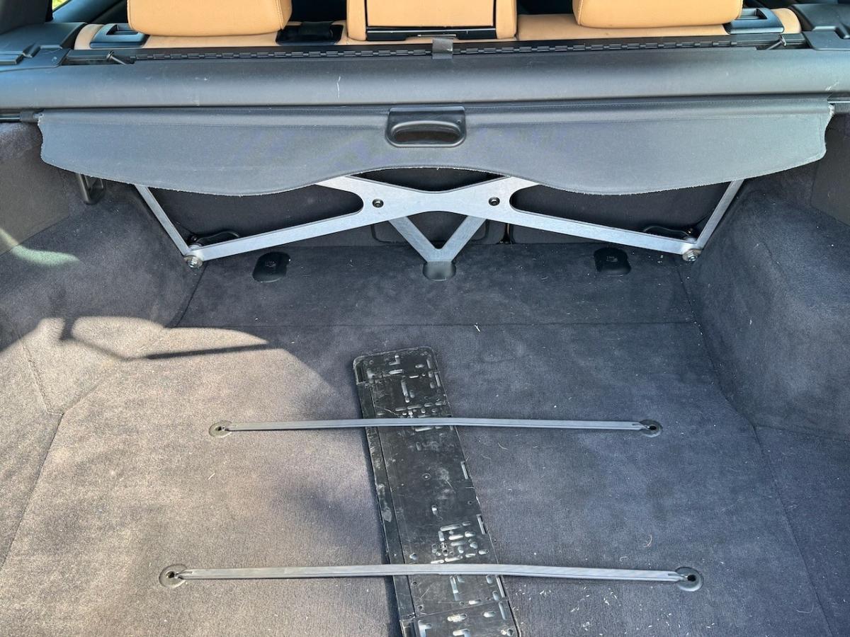

                            Cover in place:

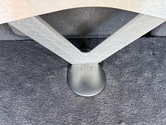

                            I'm pretty sure there's no difference in stiffness, or at least not much, from removing the top bar although I'm driving myself nuts second guessing and trying to feel something.

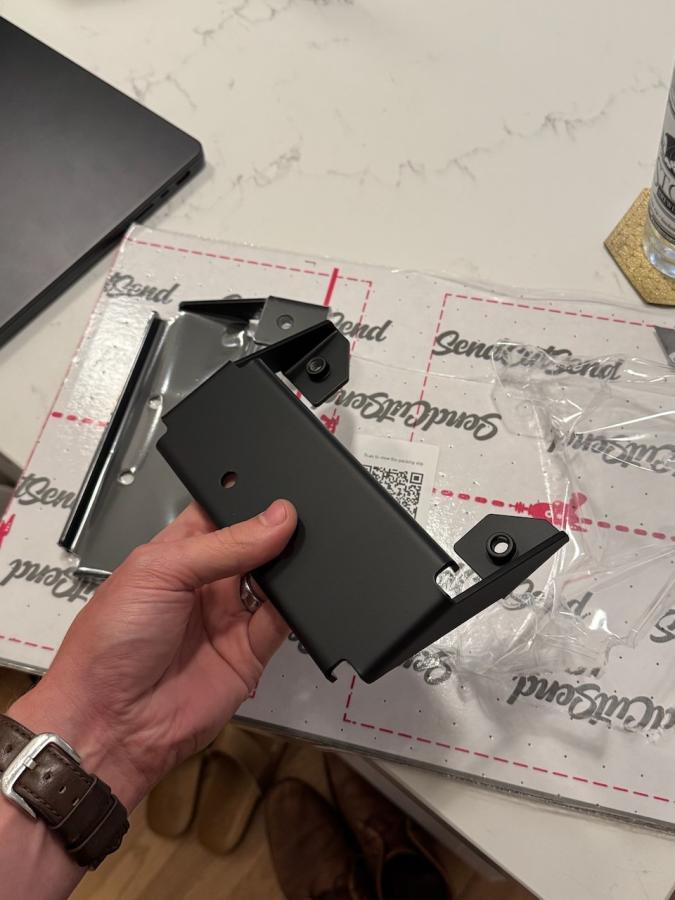

                              V-brace to subframe brackets showed up today, press fit nuts and powder coat both look great. If I'm lucky I'll get to installation this weekend.
