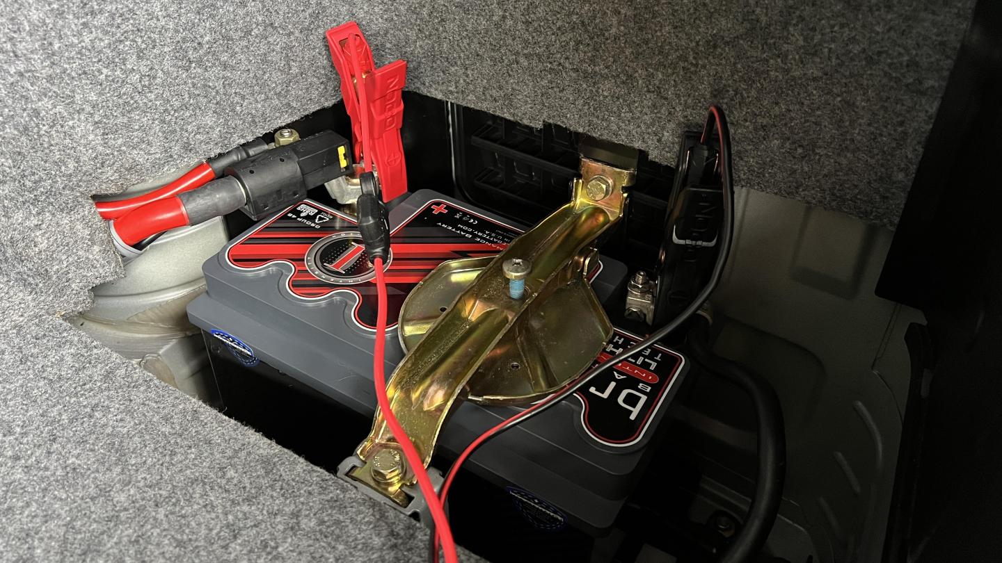

          Couple of small updates:

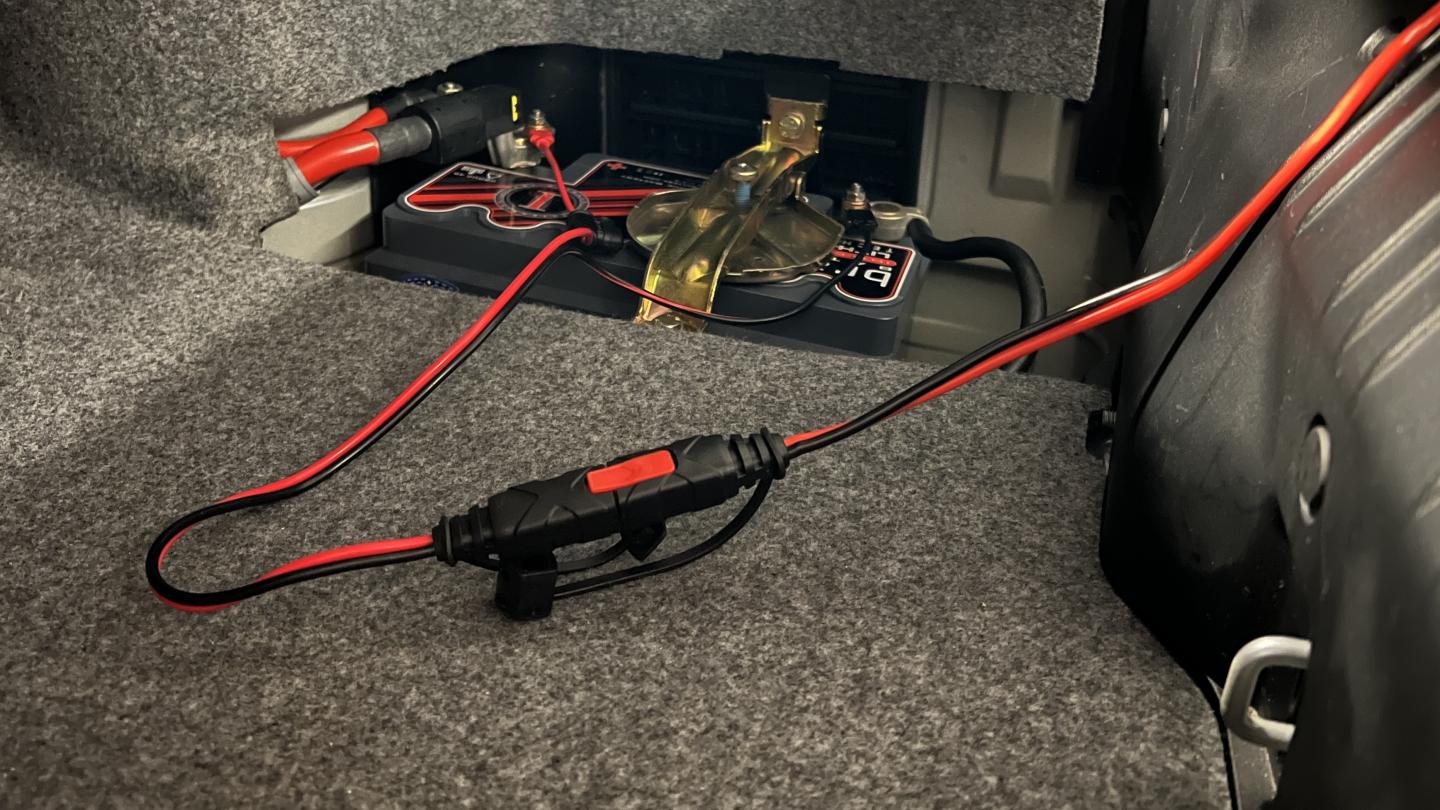

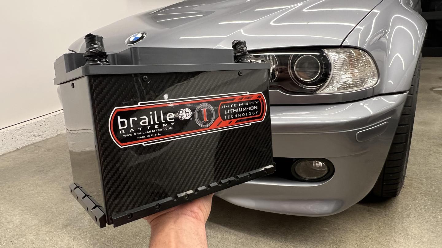

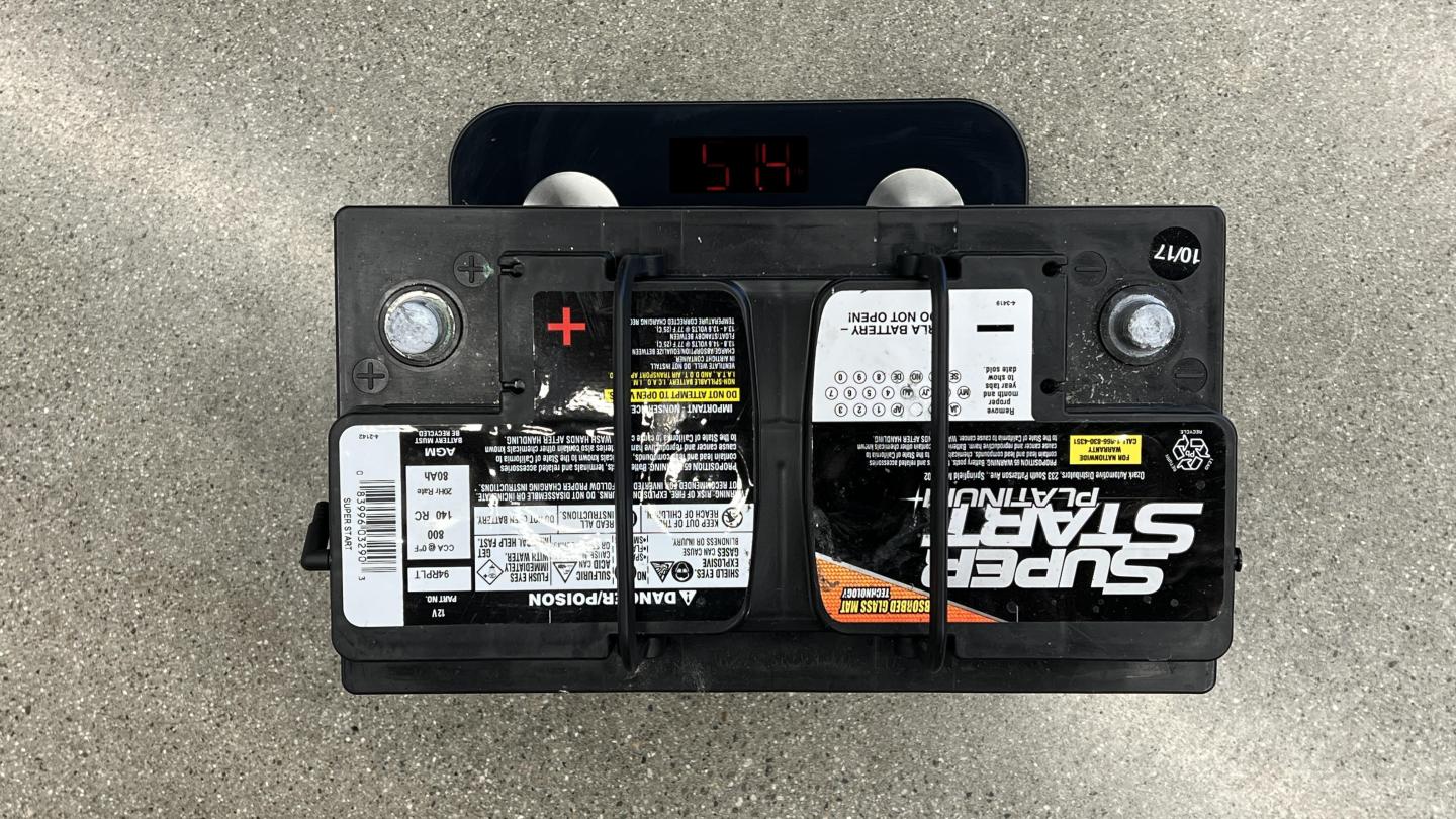

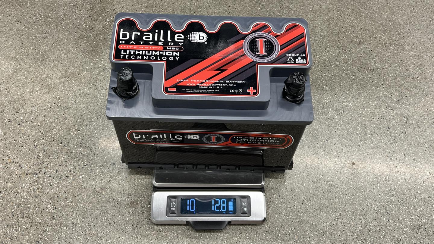

          The battery that came with the car was an O’Reilly unit dated 2017. I’ve been wanting to replace the battery for quite some time, and finally decided to pull the trigger on a lightweight battery. After doing research here and speaking with a few forum members, I chose to go with the Braille i48cx battery. The i48cx weighs 10.75lbs, is a direct drop in part, and is fully compatible with the NOCO Genius 10 charger that I already have in my garage. While weight loss isn't priority one for this build, shedding 40.5lbs while swapping out a part that needed to be replaced anyways seemed like a no brainer. If anyone is thinking of going this route, I highly recommend Braille as a company. They replied to every email I sent almost instantaneously, and picked up the phone immediately the one time I called to clarify info.
          Here you can see just how light the Braille battery is. I am able to fairly easily hold it up with one hand. It was so light that I couldn’t weigh it on my regular bathroom scale, and had to use a more precise food-grade scale instead.
          Click image for larger version  Name:	7.jpg Views:	0 Size:	148.9 KB ID:	266315
          Click image for larger version  Name:	8.jpg Views:	0 Size:	295.8 KB ID:	266317
          Compare that to the boat anchor that I pulled out of the car (51.4lbs)
          Click image for larger version  Name:	9.jpg Views:	0 Size:	266.3 KB ID:	266320

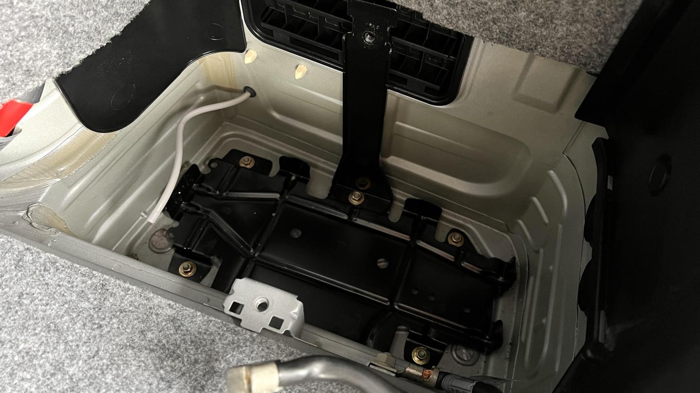

          Installation was essentially drop in. The only thing I had to do was move a small white plastic spacer over so that the battery did not slide to the front or rear of the car. While the battery was out, I vacuumed, wiped, and inspected the battery tray. Everything looked perfect.
          Click image for larger version  Name:	10.jpg Views:	0 Size:	136.9 KB ID:	266314

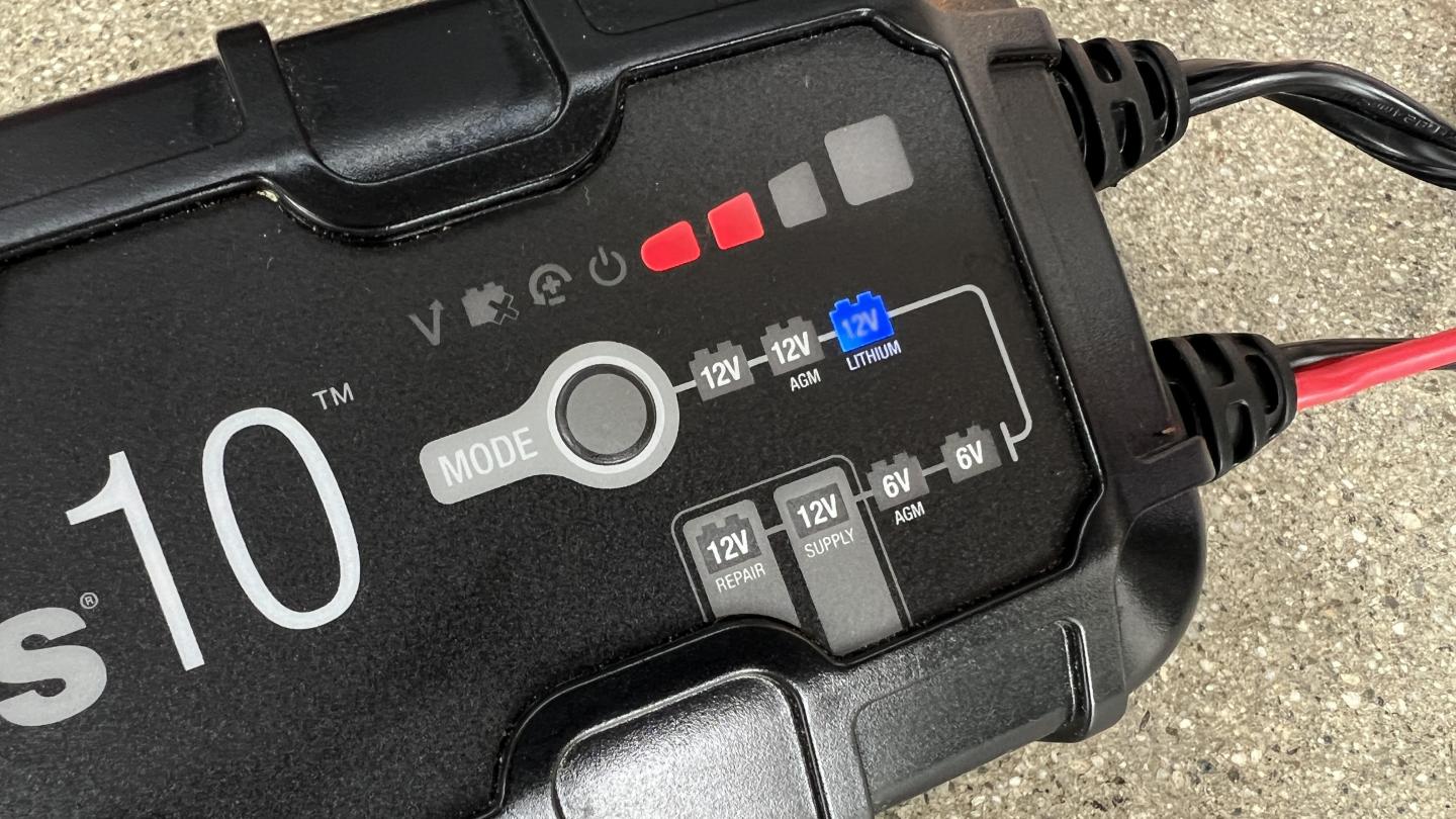

          Battery was hooked up to my NOCO chager and it was set to Lithium maintenance mode without issue.
          Click image for larger version  Name:	11.jpg Views:	0 Size:	207.3 KB ID:	266323
          Click image for larger version  Name:	12.jpg Views:	0 Size:	208.1 KB ID:	266313

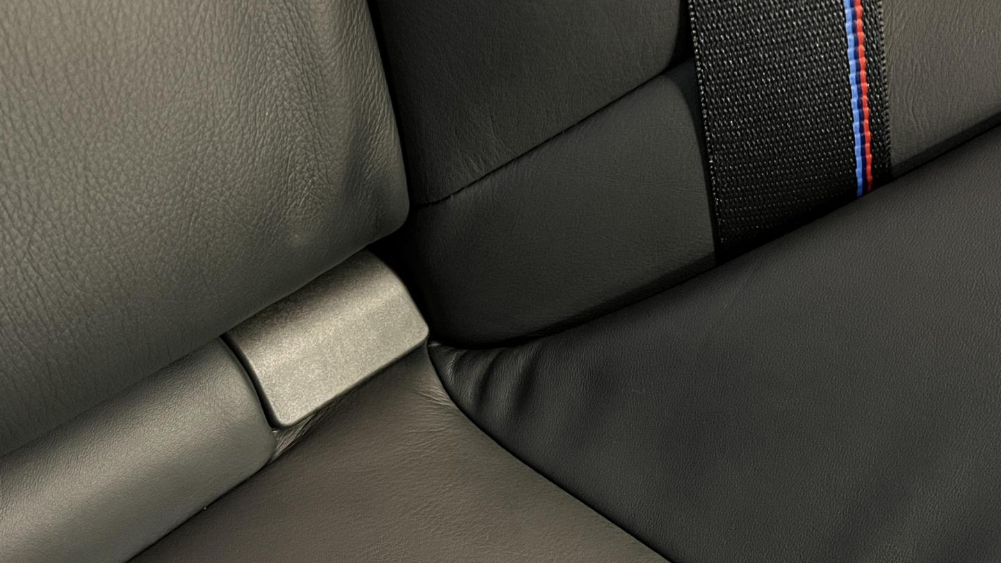

          I’m still fairly new to the E46 M3 platform, so it took me a while to notice that my car never came with the ISOFIX covers in the rear seat. After seeing the price (~$75 shipped) for two tiny pieces of plastic, I put off the purchase for a long time. Unfortunately, once I knew they were missing, I couldn't unsee it. It bothered me every time I looked into the back seat of the car. My attention to detail is both a blessing and a curse I suppose. I caved and spent the $75. I took them out to the garage to ceramic coat them prior to installation.
          Click image for larger version  Name:	5.jpg Views:	0 Size:	262.9 KB ID:	266322
          Click image for larger version  Name:	6.jpg Views:	0 Size:	151.9 KB ID:	266319​

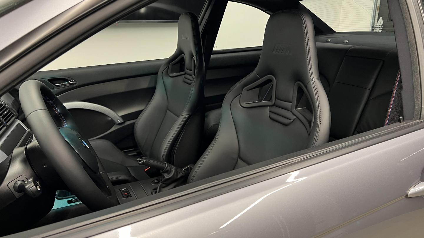

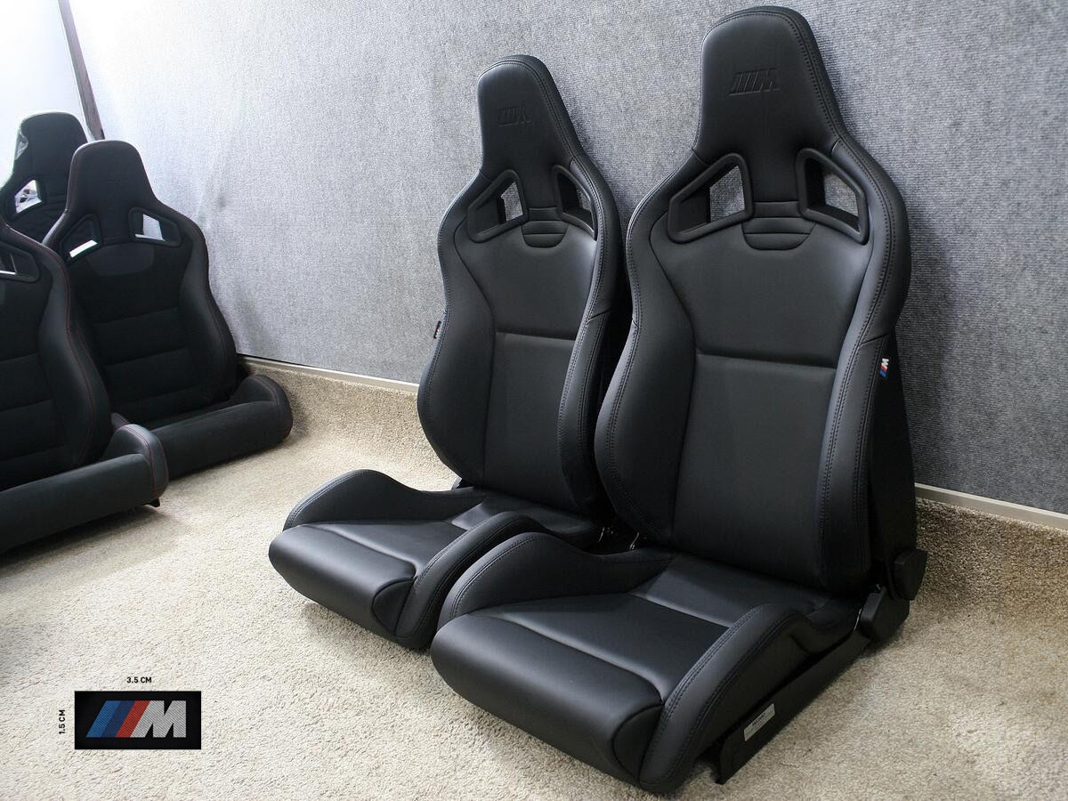

                    As I mentioned prior, the seats and custom seat-mounts are the last components for the interior phase of this project. I bounced back and forth between fixed buckets and more street/passenger friendly seats. After seeing BBB's seats, I decided to order a near identical set.
                    The specs are Recaro Sportster CS, custom leather upholstery, ///M logo embossed in the headrest. I also wanted to somehow tie in the tri-color, as I did with the seatbelts. Some of the examples of tri-colors integration on the AMX website were a little loud for my taste. I wanted something more subtle, so I asked Marek at AMX if he could create a small woven label (clothing tag) with the ///M logo and stitch it into the bolster seam. BBB provided me with some photos of his seats, and I used the photos to do a small mockup for AMX. Marek quickly took my mockup and designed the woven tag.
                    Although this is a mockup only, I expect them to look exactly like this.
                    Click image for larger version  Name:	SEAT_MOCKUP_1.jpg Views:	0 Size:	286.3 KB ID:	268282

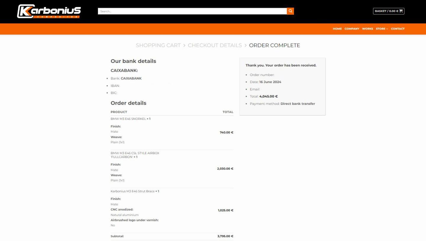

                    I again chose to deviate from the original CSL design, ordering all the parts in 1x1 matte finish carbon. Just as I did with the interior components, I will ceramic coat them which will give a satin sheen to the parts. Really excited for the install. In my opinion, a CSL intake is the biggest enhancement to the driving experience and character of our cars.
                    Click image for larger version  Name:	KARBONIUS_CSL_ORDER.jpg Views:	0 Size:	54.4 KB ID:	268281

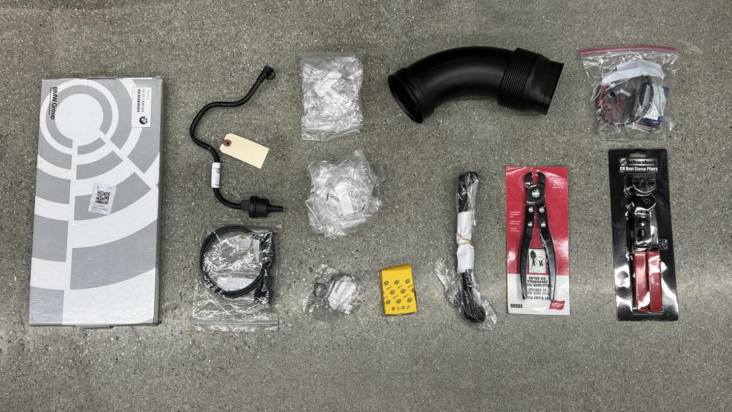

                    Prior to ordering the intake, I had already ordered and received all of the necessary parts, accessories, and tools for the installation.
                    Click image for larger version  Name:	CSL_INTAKE_PARTS.jpg Views:	0 Size:	279.0 KB ID:	268283

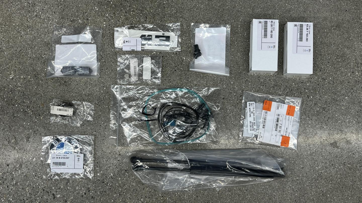

                    In addition to preparing for the intake, I also ordered a ton of parts for the CSL trunk I posted on page 5
                    Click image for larger version  Name:	CSL_TRUNK_PARTS.jpg Views:	0 Size:	303.6 KB ID:	268284

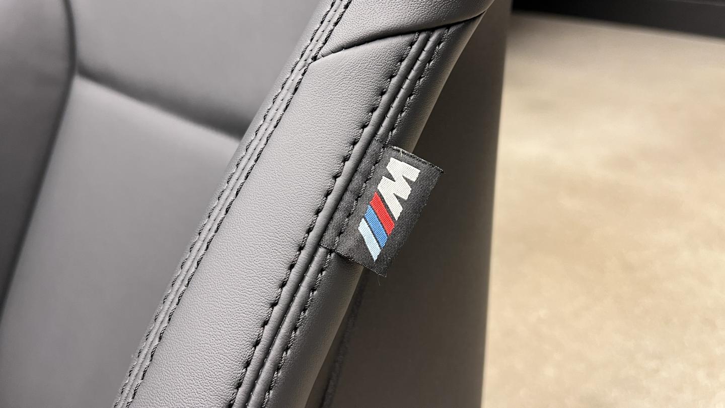

                        Very cool - love this little detail! looking forward to seeing photos of the finished seats!

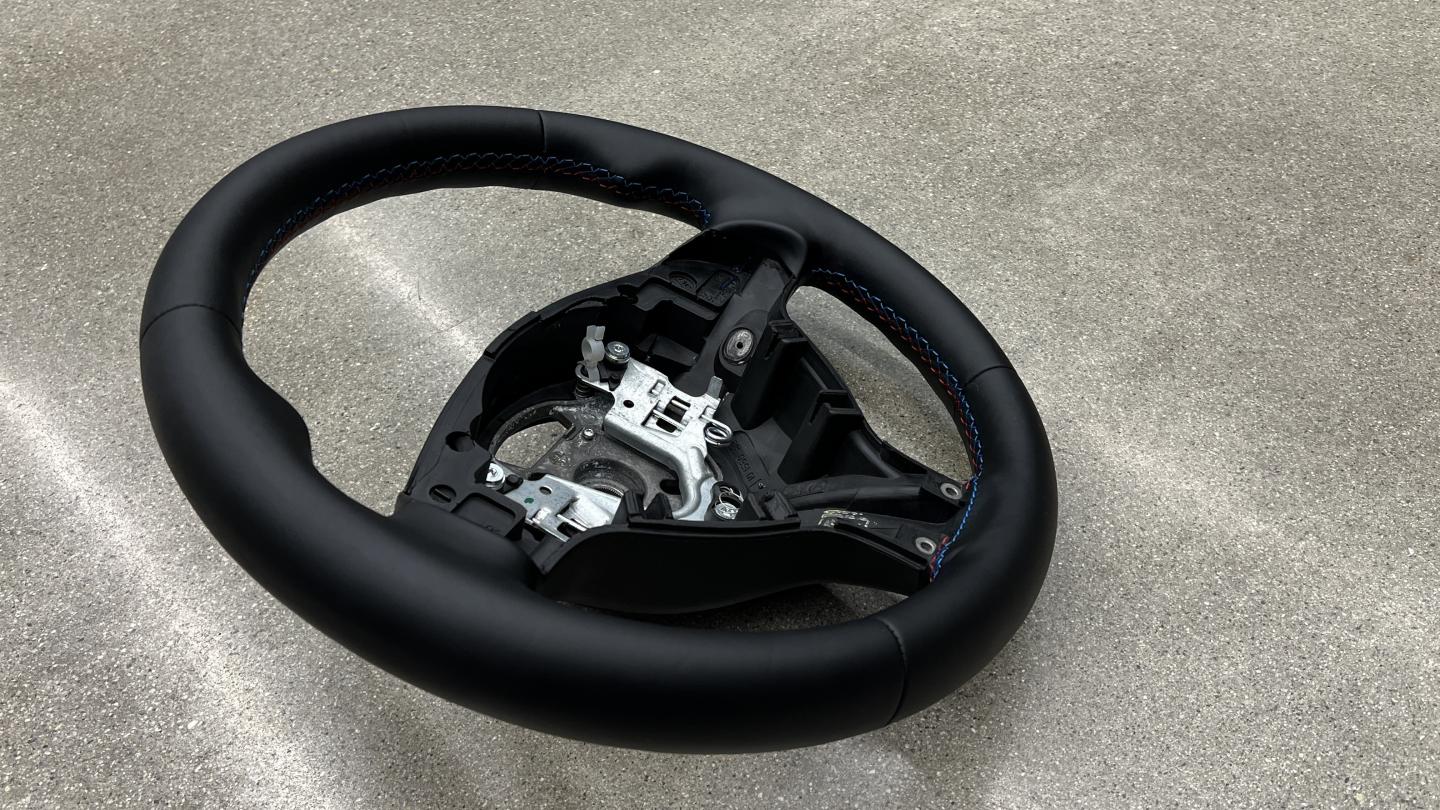

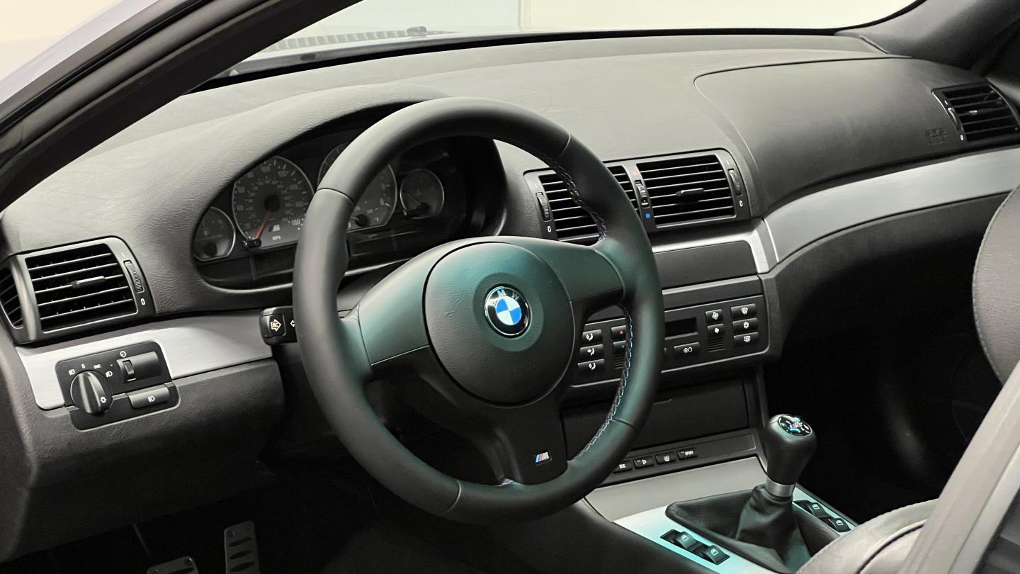

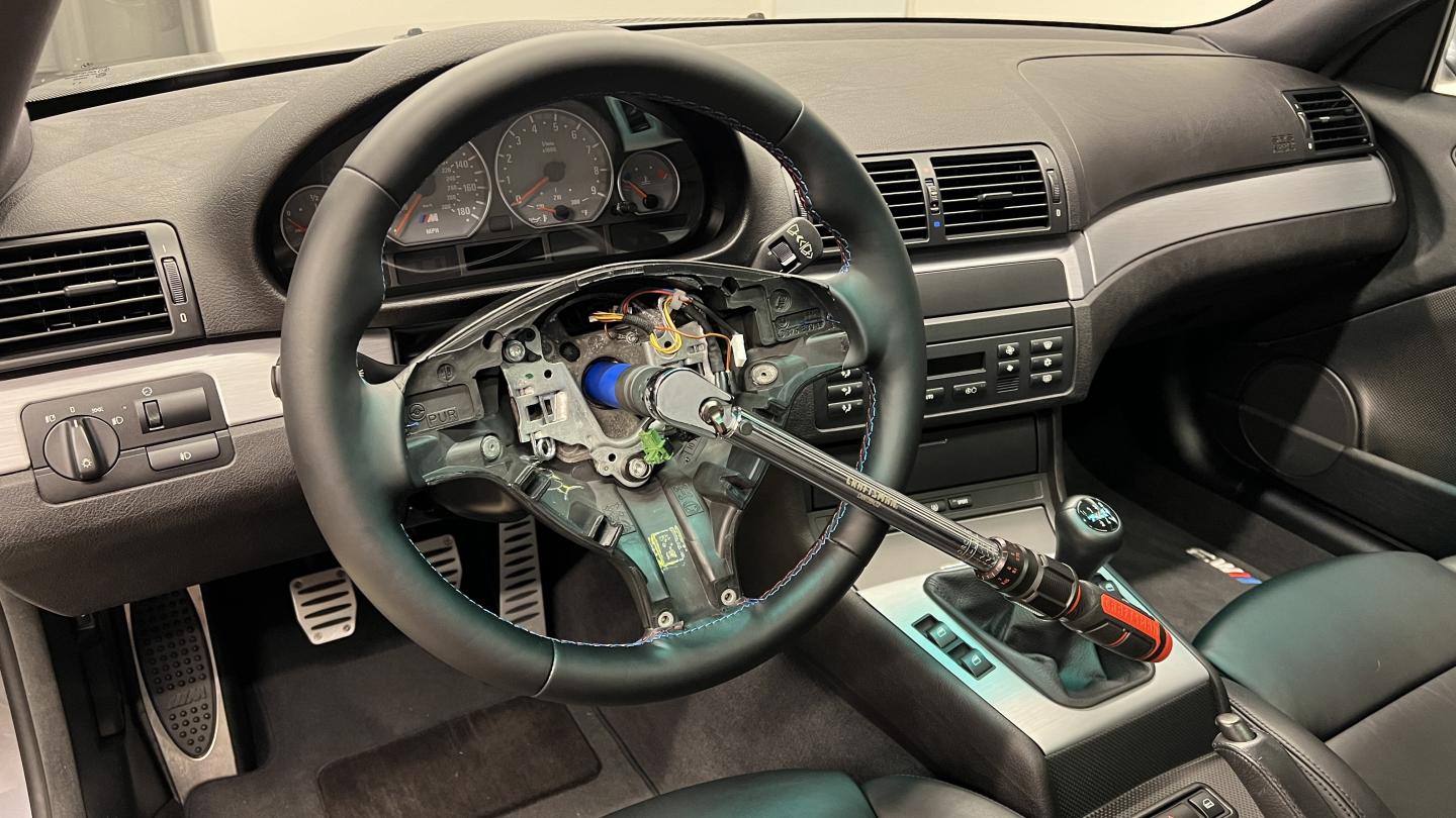

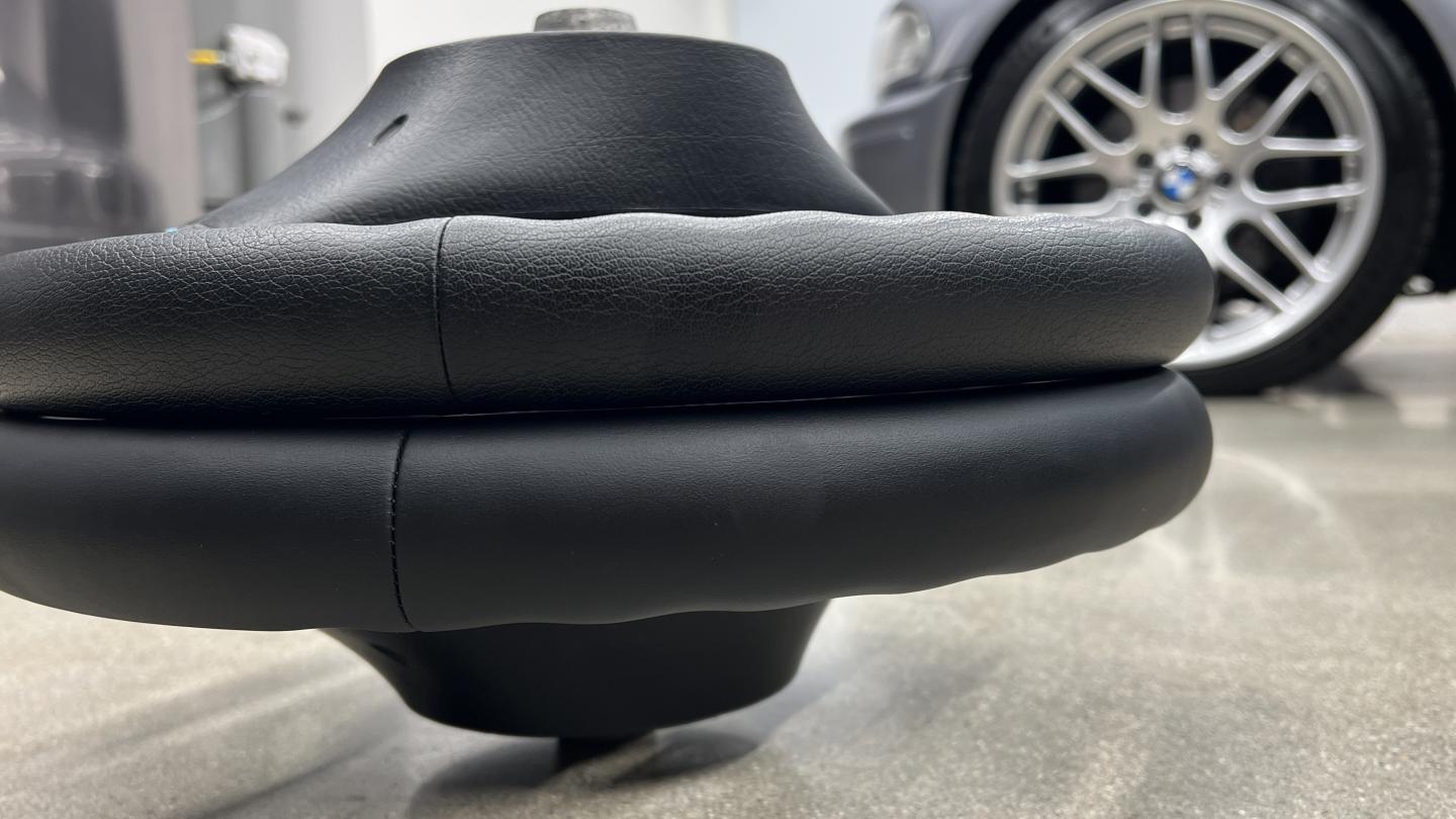

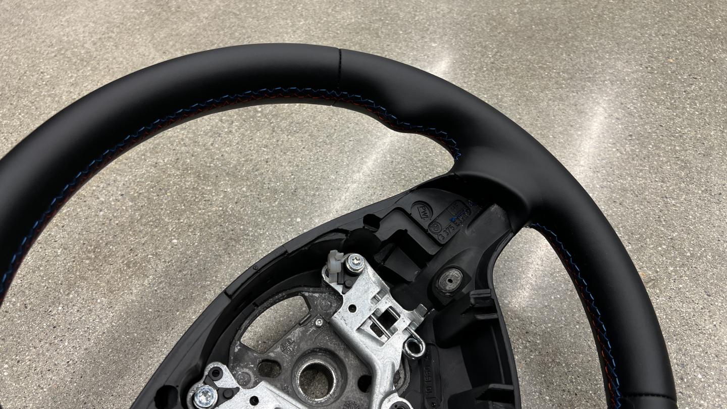

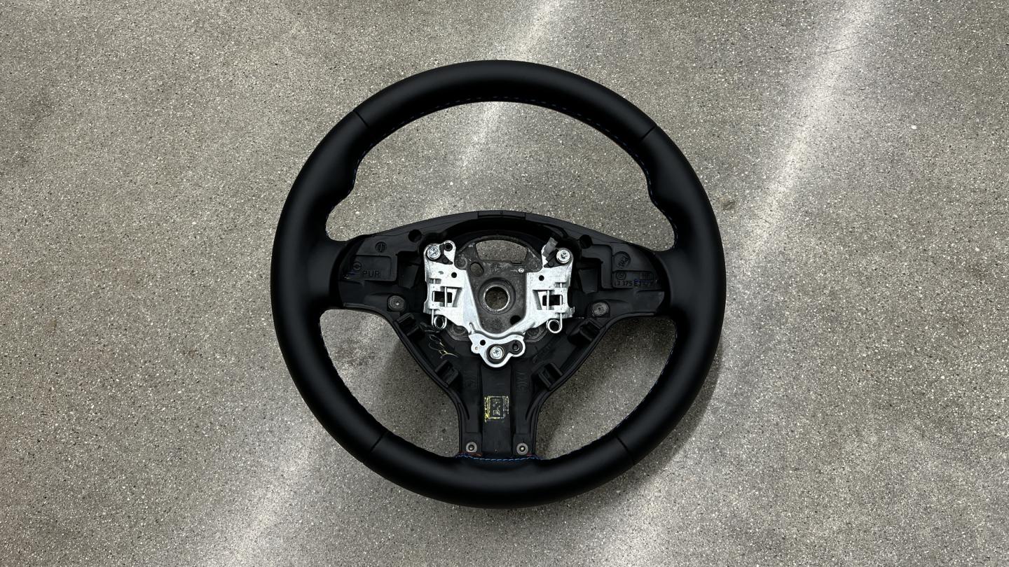

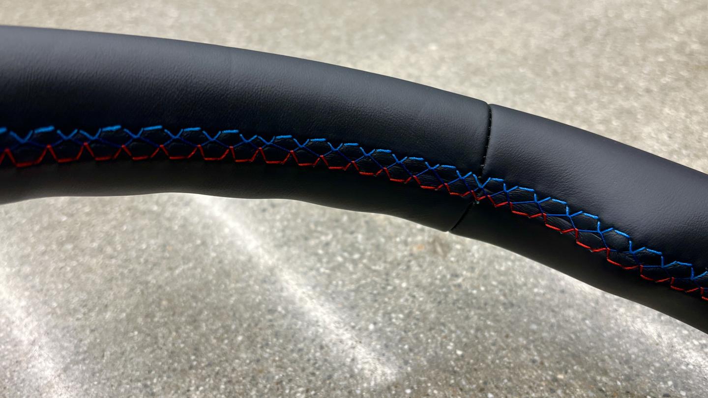

                          While browsing through member's build threads, I saw a quality OEM+ (thicker) steering wheel posted in SQ13 thread. I reached out to him and he provided me additional information on the seller and the wheel itself.
                          I currently have a F30 335i and G07 X7 as my daily drivers. Both of those cars have thicker steering wheels. I don't drive my M3 very often, but when I do, the thinner diameter of the steering wheel stands out to me. Part of me feels like it's nostalgic, adding to the overall driving experience. The other part of me feels that it's too thin, detracting from the driving experience. I wanted to try out a thicker wheel to see how I would like it in the M3. Rather than wrap my current wheel, I chose to replace it. This way if I ever wanted to go back to stock, I'd simply swap the steering wheel back.
                          The steering wheel was purchased from GS Specialties who sells both on eBay and Instagram (LINK). The seller takes an original used steering wheel, strips off the leather, adds new thicker padding, and wraps the wheel in a smooth Nappa like leather. The wheel is ~1cm thicker in diameter but otherwise identical design wise. The 1cm difference in diameter doesn't sound like much on paper, but it makes a huge difference in feel. The seams and stitching are perfect, and the overall craftsmanship is excellent for a very reasonable cost. It shipped from Poland and arrived in a week without issue. I would highly recommend the seller if anyone is looking for custom steering wheel work.
                          Click image for larger version  Name:	IMG_7594.jpg Views:	0 Size:	321.9 KB ID:	269498
                          Click image for larger version  Name:	IMG_7595.jpg Views:	0 Size:	256.5 KB ID:	269497
                          Click image for larger version  Name:	IMG_7593.jpg Views:	0 Size:	224.6 KB ID:	269496
                          Click image for larger version  Name:	IMG_7596.jpg Views:	0 Size:	128.2 KB ID:	269495

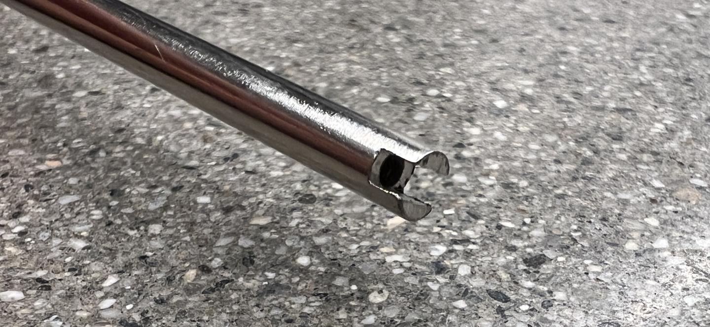

                          I also picked up this extra long valve stem tool after seeing it recommended by sleeks. The tool fits perfectly into the hole in the back of the steering wheel and cradles the airbag retention spring. This makes depressing the spring a little easier than using a flathead which tends to slip as you apply pressure.
                          Click image for larger version  Name:	IMG_7613.jpg Views:	0 Size:	249.5 KB ID:	269500
                          Click image for larger version  Name:	IMG_7611.jpg Views:	0 Size:	187.3 KB ID:	269499

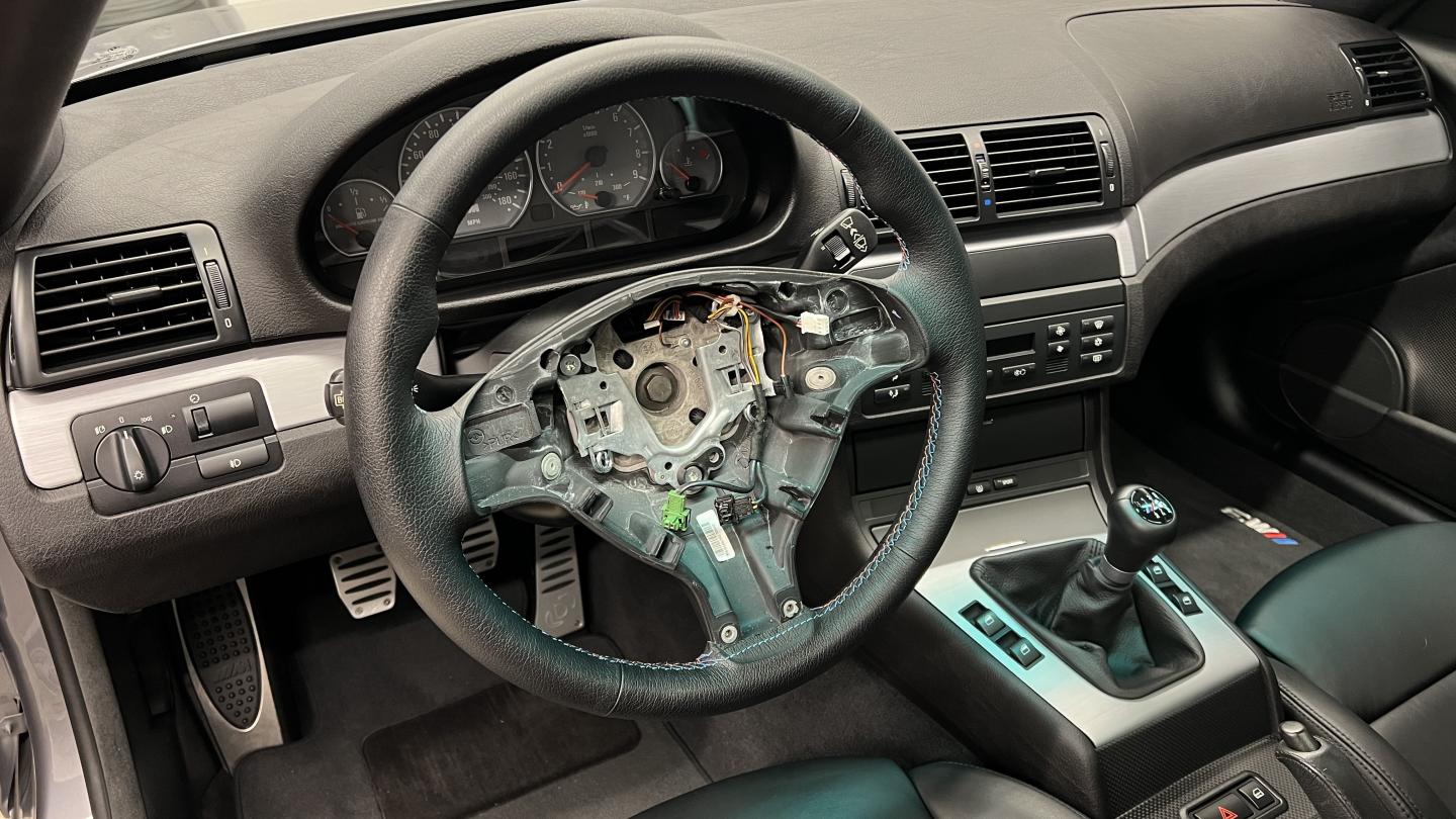

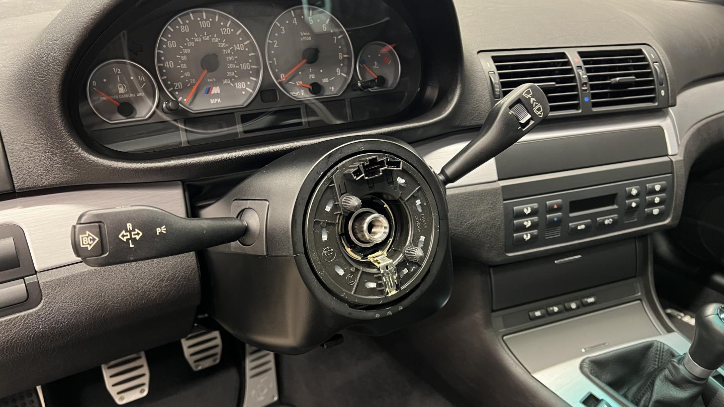

                          Onto the installation itself. First the battery was disconnected, then airbag and trim were removed.
                          Click image for larger version  Name:	IMG_7591.jpg Views:	0 Size:	193.9 KB ID:	269503
                          Wheel removed.
                          Click image for larger version  Name:	IMG_7592.jpg Views:	0 Size:	164.8 KB ID:	269501

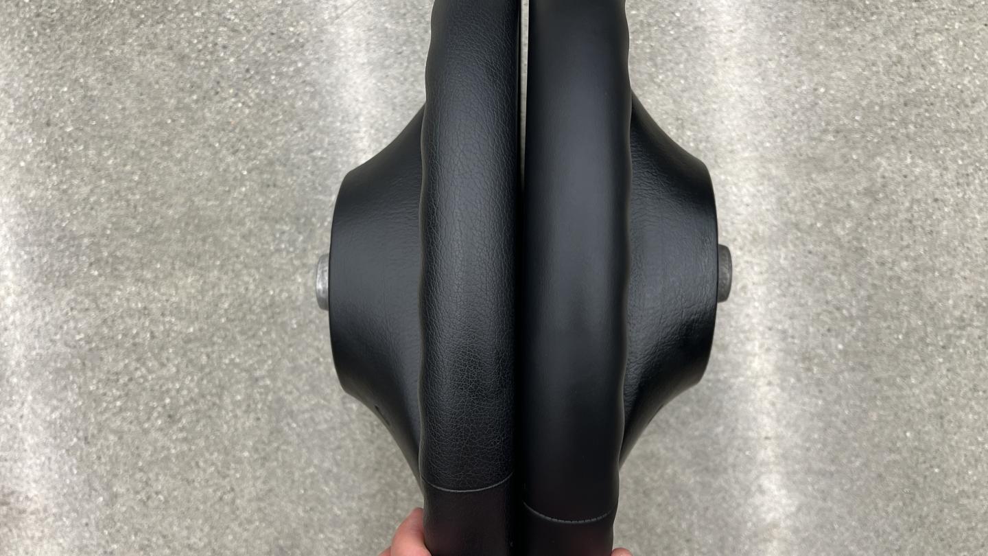

                          Prior to installing the new wheel I took some comparison photos to show the difference in both diameter and leather.
                          Click image for larger version  Name:	IMG_7597.jpg Views:	0 Size:	116.3 KB ID:	269504
                          Click image for larger version  Name:	IMG_7598.jpg Views:	0 Size:	147.2 KB ID:	269505

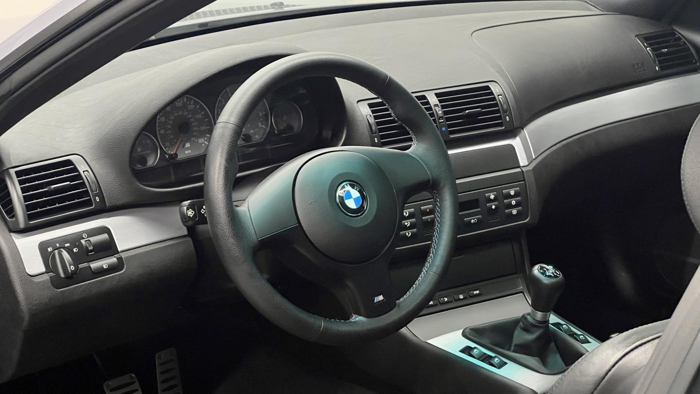

                          Wiring was transferred over to the new wheel then it was torqued to spec.
                          Click image for larger version  Name:	IMG_7599.jpg Views:	0 Size:	179.6 KB ID:	269502
                          Here is a before and after. Visually, it’s a very subtle difference, but feel wise, it’s a massive change. My plan is to keep an open mind as I drive the car for a few months, then revisit at a later date to see which wheel I like more.
                          Click image for larger version  Name:	IMG_7590.jpg Views:	0 Size:	131.3 KB ID:	269507
                          Click image for larger version  Name:	IMG_7600.jpg Views:	0 Size:	130.2 KB ID:	269506

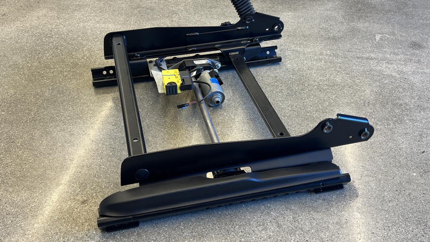

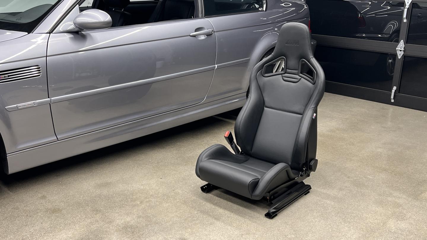

                            Seats arrived from AMX in Poland. The AMX purchasing experience was very mixed. It wasn’t a horrible experience, but for the premium price, it wasn’t good enough to do business with them in the future. I don’t want to go into details and turn this into a negative post, as this build thread, and the project itself are really positive outlets for me. We’ll leave it at that and move on.

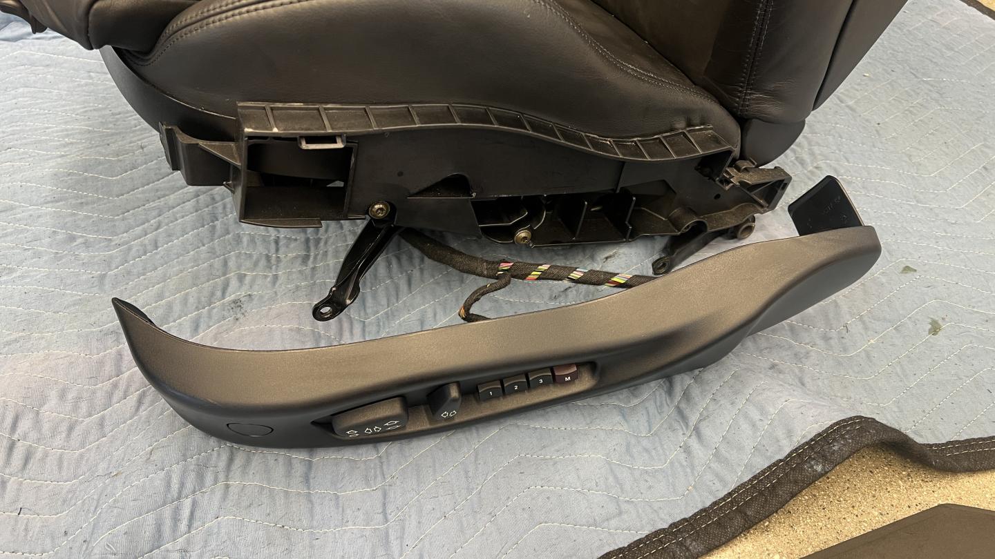

                            Factory seat coming out.
                            Click image for larger version  Name:	IMG_8378.jpg Views:	0 Size:	127.1 KB ID:	275465

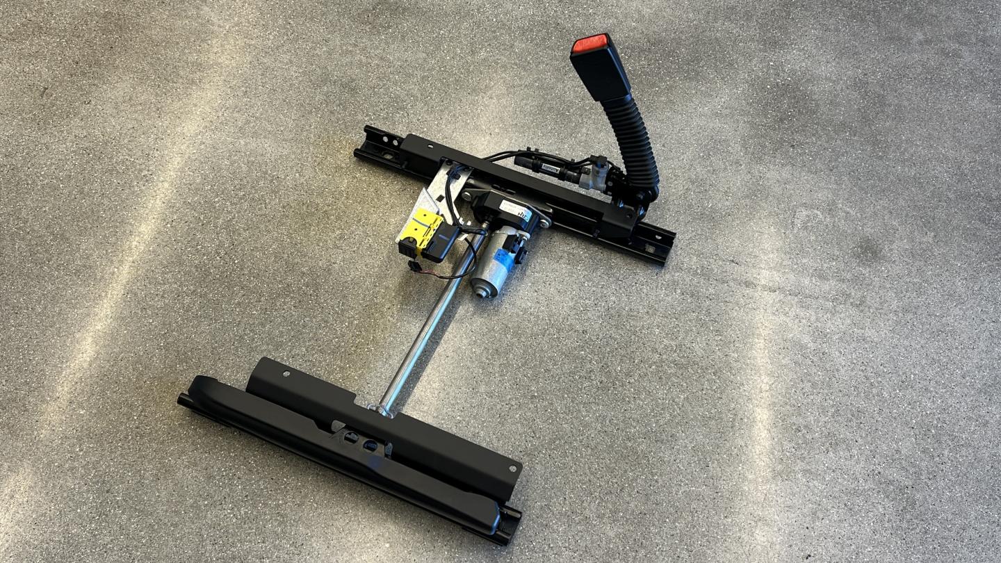

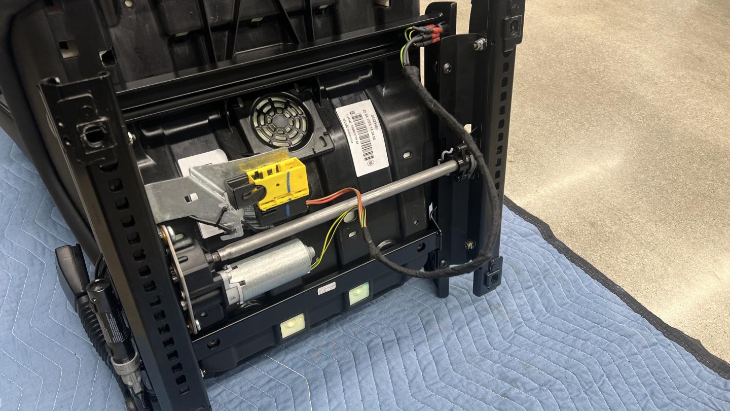

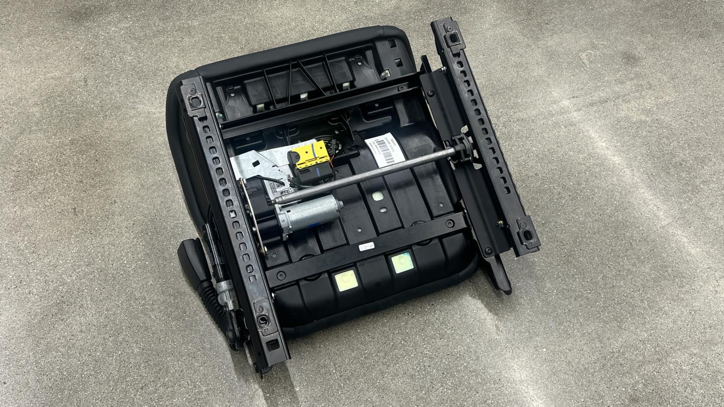

                            Seat rail and electric motor disconnected from factory seats.
                            Click image for larger version  Name:	IMG_8381.jpg Views:	0 Size:	217.2 KB ID:	275466

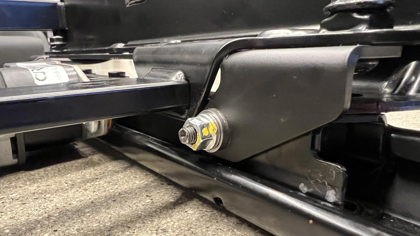

                            Bry5on custom seat mounts mocked up. These things are incredibly well thought out.
                            Click image for larger version  Name:	IMG_8389.jpg Views:	0 Size:	327.8 KB ID:	275468
                            I got about this far before I realized I needed to stop and shift my order of operations. Everything came back apart so that I could make a few adjustments then rebuild in the correct order.
                            Click image for larger version  Name:	IMG_8392.jpg Views:	0 Size:	276.4 KB ID:	275467

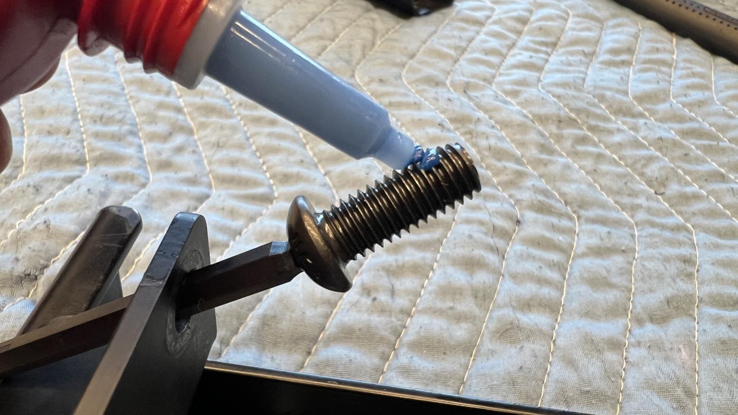

                            First, the seat harness mounting bracket was removed, placed in my vise, and given two subtle bends. The minor adjustment ensures there is no rubbing when the seat moves back and forth.
                            Click image for larger version  Name:	IMG_8397.jpg Views:	0 Size:	154.5 KB ID:	275472

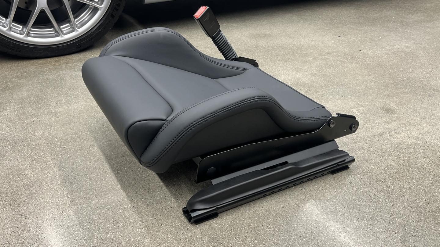

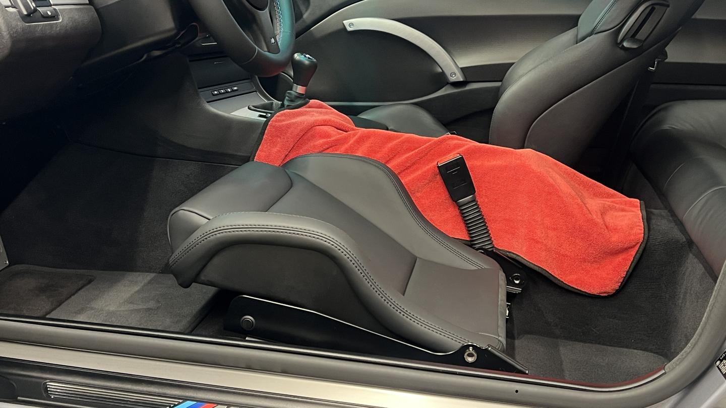

                            Next, the Recaro seat bracket was attached to Bryson's seat mounts. All the bolts received Loctite to ensure they don’t back out in the future. The factory seat rail has a threaded stud that passes through the seat mount. The stud is a strange shape with a stepped and shouldered shaft. This required a custom thickness washer combined with the original nut.
                            Click image for larger version  Name:	IMG_8398.jpg Views:	0 Size:	150.2 KB ID:	275471
                            Click image for larger version  Name:	IMG_8402.jpg Views:	0 Size:	141.0 KB ID:	275469
                            After that, the seat cushion could be reattached to the Recaro seat bracket. Bottom half complete.
                            Click image for larger version  Name:	IMG_8403.jpg Views:	0 Size:	283.1 KB ID:	275473
                            Click image for larger version  Name:	IMG_8405.jpg Views:	0 Size:	219.7 KB ID:	275474

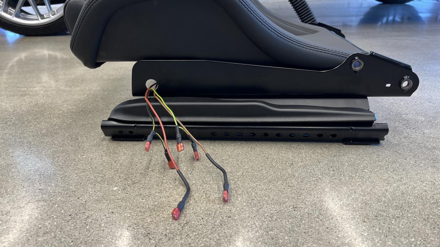

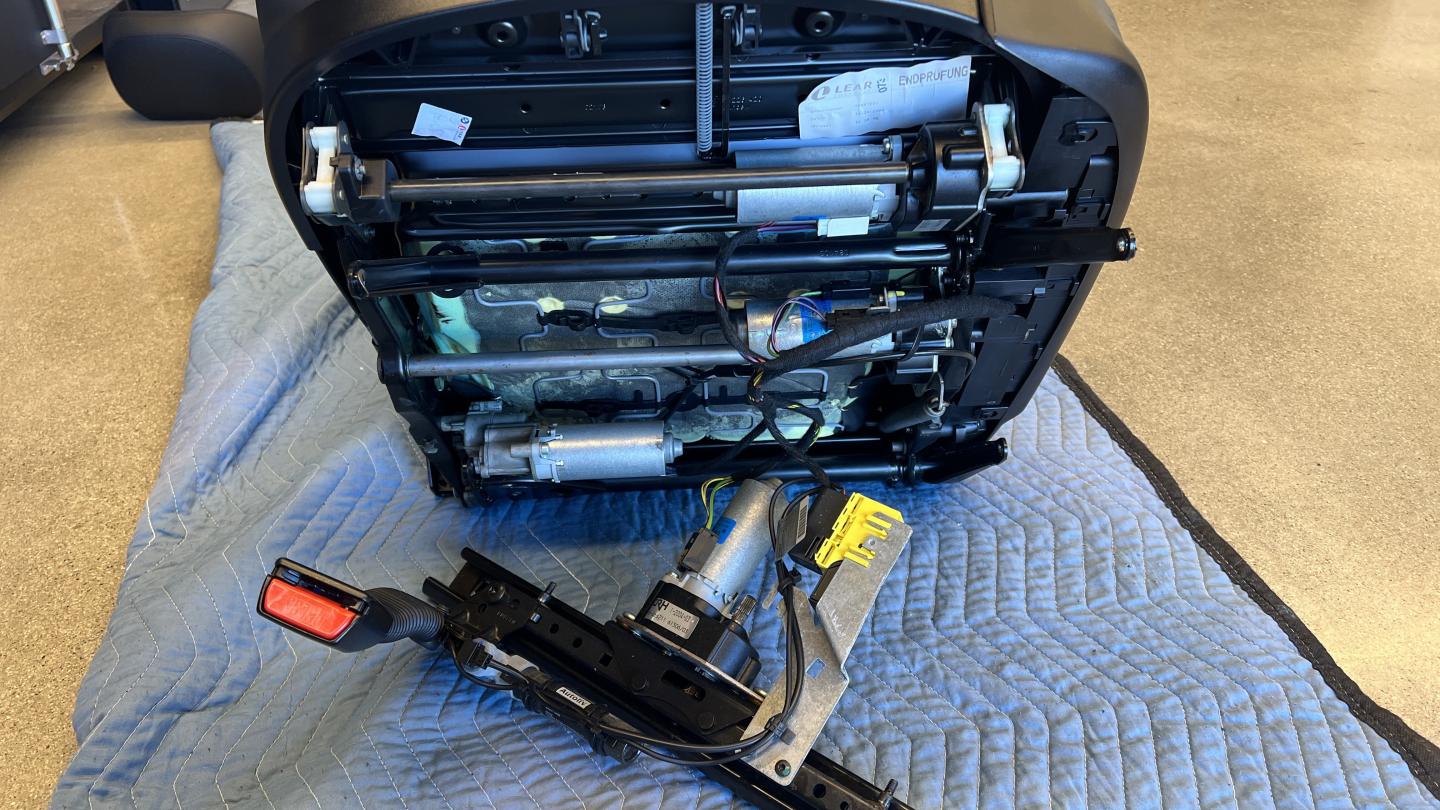

                            Next part of the install was the wiring. Again, I received some help from Bryson (I swear, I’m surprised he hasn’t started billing me). First I pulled the seat memory trim off the original seat.
                            Click image for larger version  Name:	IMG_8406.jpg Views:	0 Size:	182.1 KB ID:	275476
                            Click image for larger version  Name:	IMG_8408.jpg Views:	0 Size:	189.4 KB ID:	275475

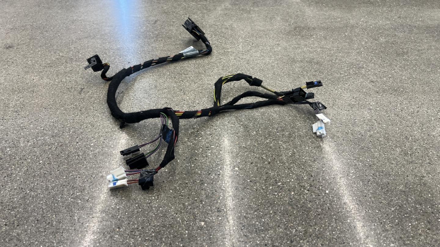

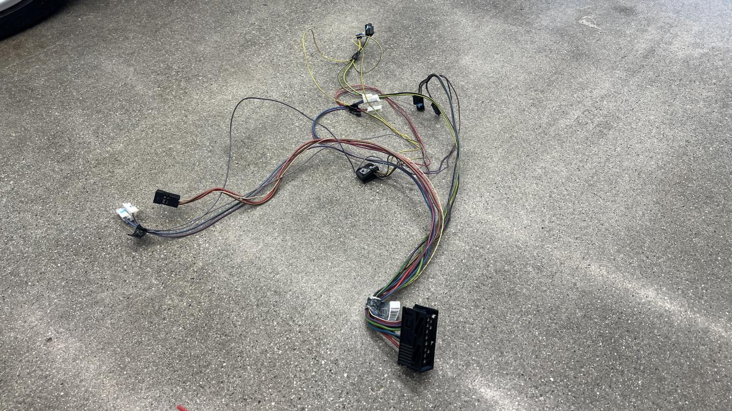

                            Then out came the wiring harness.
                            Click image for larger version  Name:	IMG_8412.jpg Views:	0 Size:	301.9 KB ID:	275477

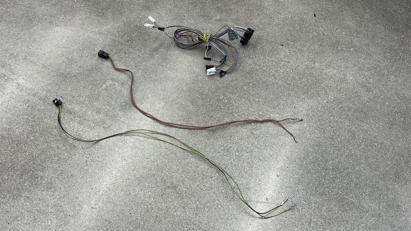

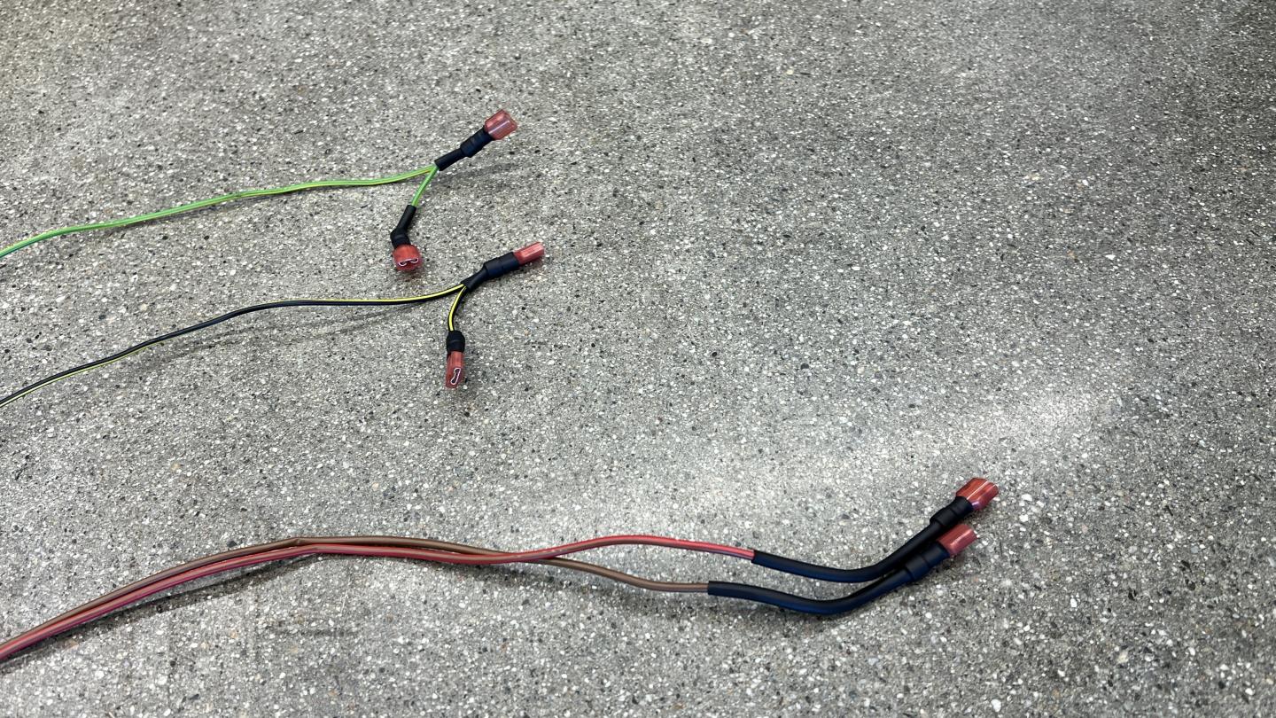

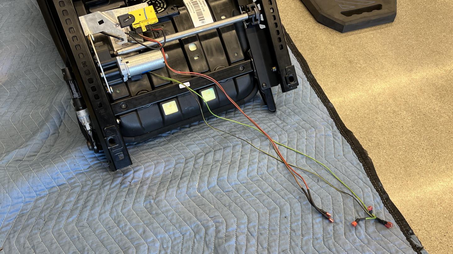

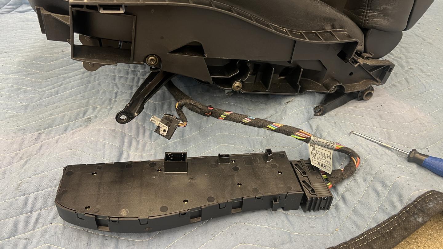

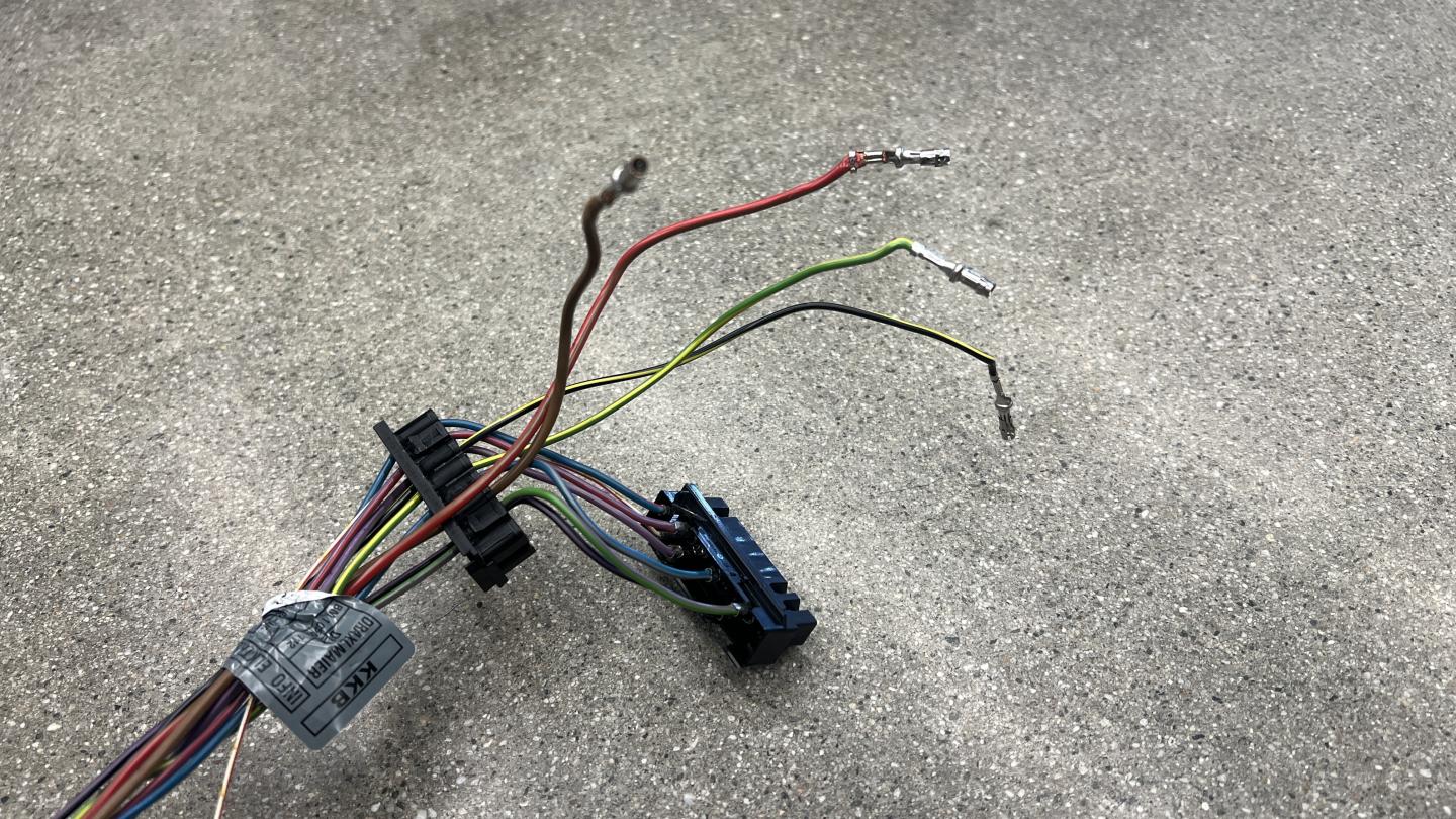

                            There were a lot of wires, but I only needed four specific ones to wire a momentary forward and backwards switch. Off came the 20 year old Tesa tape which made a sticky mess. Old adhesive was cleaned off of the harness, then the wires were de-pinned and removed.
                            Click image for larger version  Name:	IMG_8413.jpg Views:	0 Size:	362.1 KB ID:	275480
                            Click image for larger version  Name:	IMG_8414.jpg Views:	0 Size:	309.0 KB ID:	275478
                            Click image for larger version  Name:	IMG_8415.jpg Views:	0 Size:	347.6 KB ID:	275479

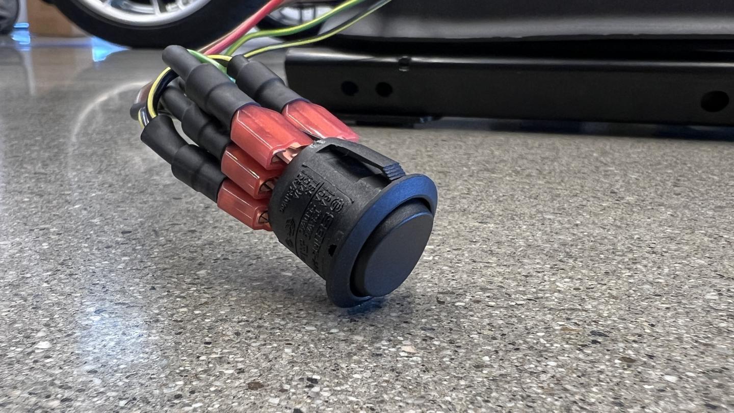

                            Old connectors were cut off, motor wires got a jumper cable for the momentary switch. Then I crimped on some spade connectors and finished with heat shrink for extra insulation.
                            Click image for larger version  Name:	IMG_8417.jpg Views:	0 Size:	373.1 KB ID:	275485
                            Test fit the wires onto the seat and momentary switch.
                            Click image for larger version  Name:	IMG_8419.jpg Views:	0 Size:	241.0 KB ID:	275484
                            Click image for larger version  Name:	IMG_8420.jpg Views:	0 Size:	198.2 KB ID:	275483
                            Click image for larger version  Name:	IMG_8421.jpg Views:	0 Size:	210.3 KB ID:	275482

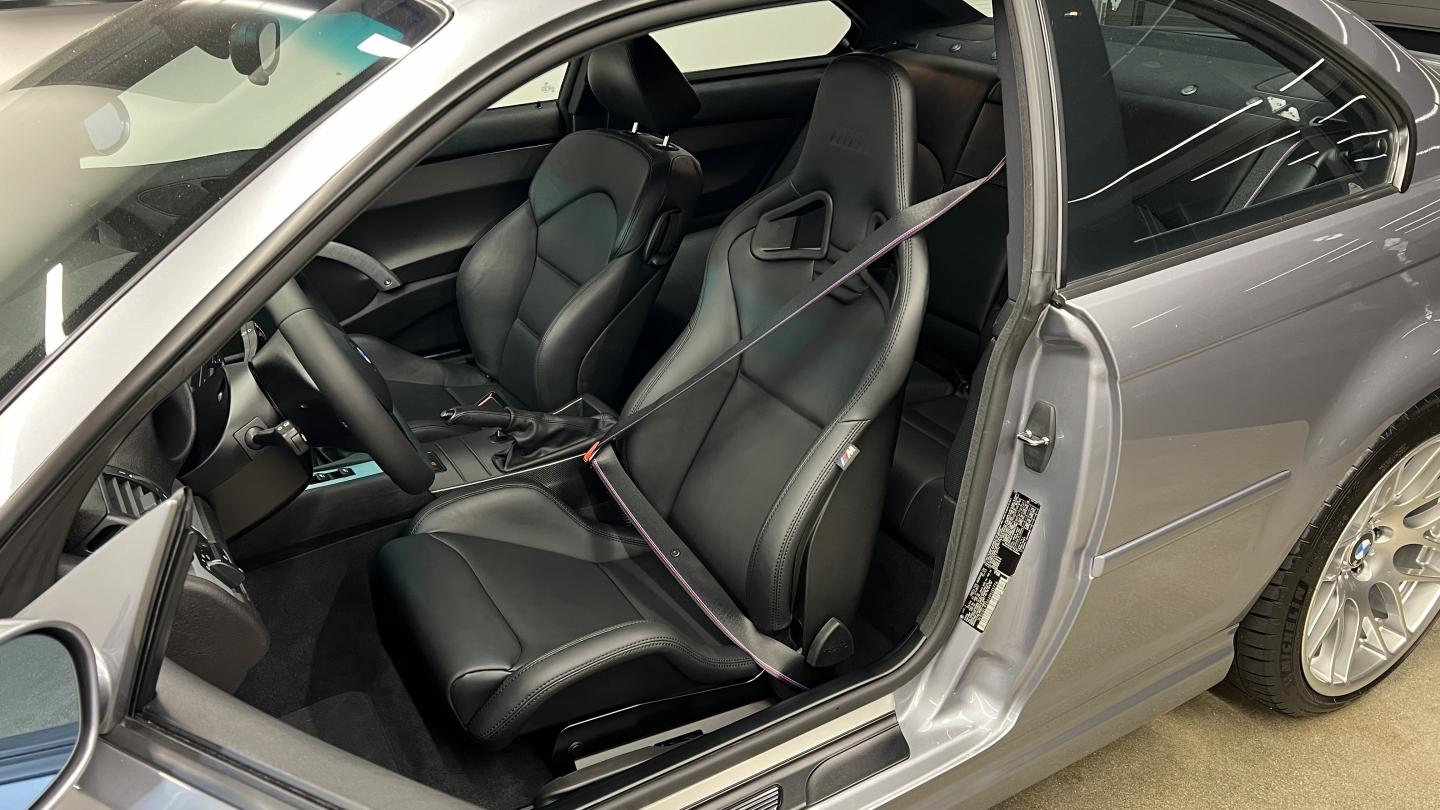

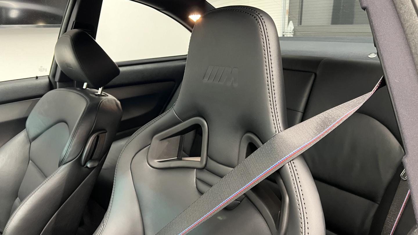

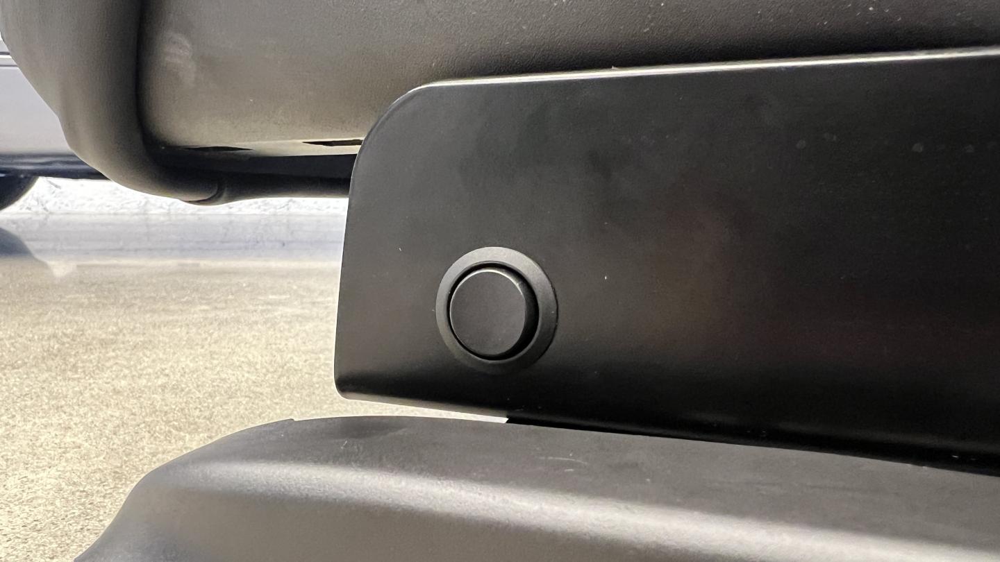

                            Here is the completed look. A lot of work for a little switch, but I’m incredibly happy with how clean it looks.
                            Click image for larger version  Name:	IMG_8422.jpg Views:	0 Size:	110.6 KB ID:	275481
                            Final test fit was done in the car to ensure the switch worked. Once I confirmed that, the seat came out one last time so that I could wrap the new harness in Tesa tape and install the upper portion of the seat.
                            Click image for larger version  Name:	IMG_8426.jpg Views:	0 Size:	183.6 KB ID:	275487
                            Click image for larger version  Name:	IMG_8427.jpg Views:	0 Size:	140.8 KB ID:	275486
                            The upper portion of the seat was attached. It was starting to look like a finished product, so I stopped to take a few photos.
                            Click image for larger version  Name:	IMG_8460.jpg Views:	0 Size:	154.9 KB ID:	275489
                            Click image for larger version  Name:	IMG_8459.jpg Views:	0 Size:	118.3 KB ID:	275488

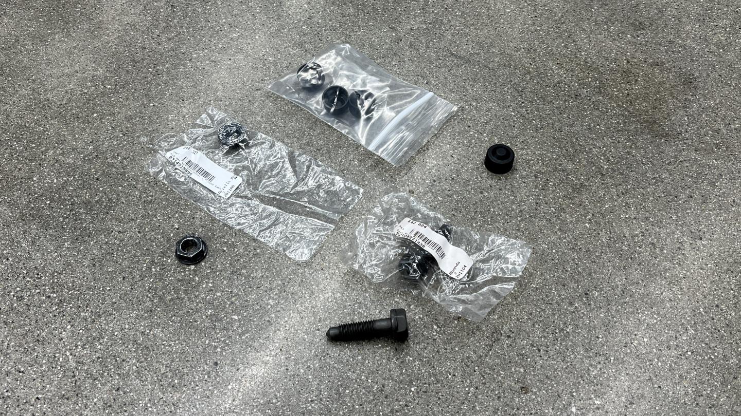

                            New bolts, new nuts, and new covers for a finished OE look.
                            Click image for larger version  Name:	IMG_8462.jpg Views:	0 Size:	379.9 KB ID:	275490

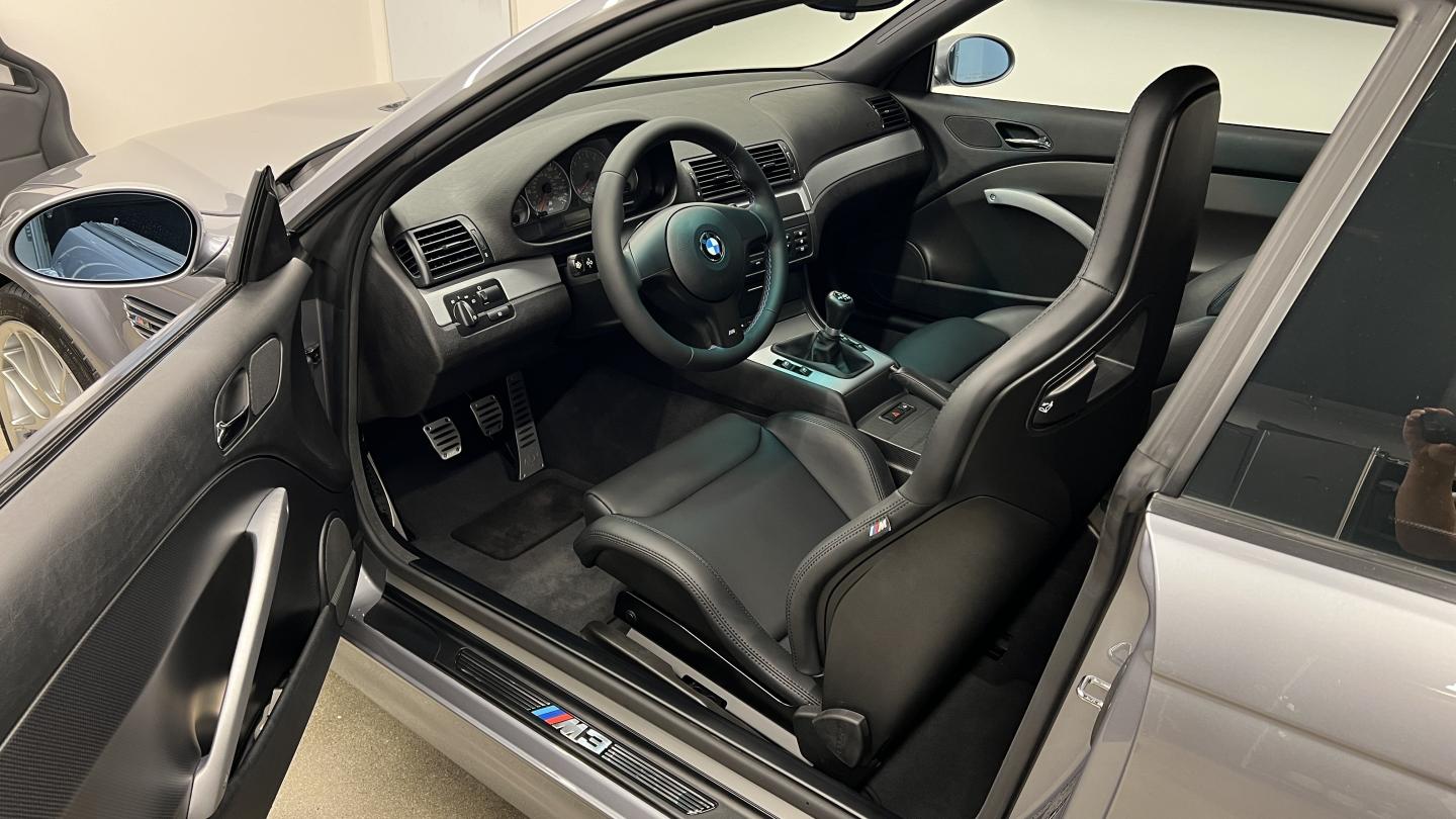

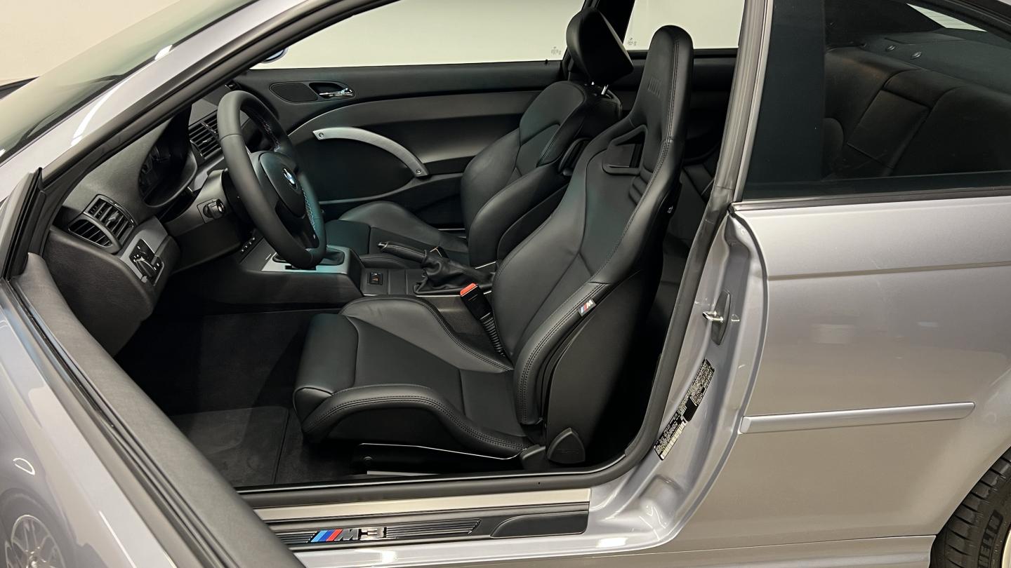

                            The fully assembled seats were weighed (50.4 lbs) then installed in the car. For reference the factory passenger seat weighed 63.2 lbs The seats look like they could have been a factory option for a "CS" model if BMW ever made a proper CS for this generation. Really happy with how this project turned out.
                            Click image for larger version  Name:	IMG_8463.jpg Views:	0 Size:	128.5 KB ID:	275491
                            Click image for larger version  Name:	IMG_8464.jpg Views:	0 Size:	163.6 KB ID:	275493
                            Click image for larger version  Name:	IMG_8465.jpg Views:	0 Size:	122.2 KB ID:	275492
                            Click image for larger version  Name:	IMG_8467.jpg Views:	0 Size:	157.1 KB ID:	275494 Click image for larger version  Name:	seat.jpg Views:	15 Size:	114.6 KB ID:	275685
