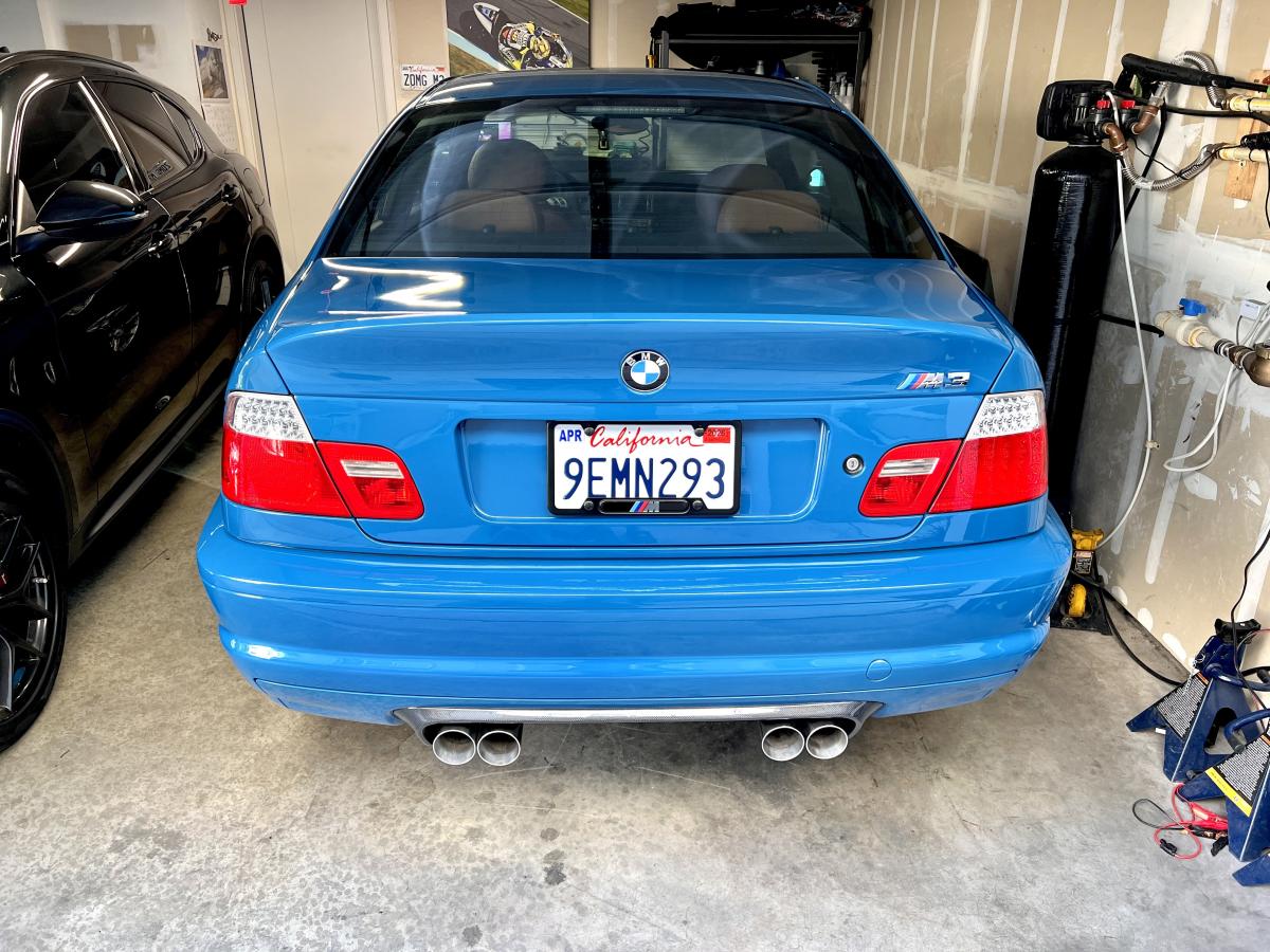

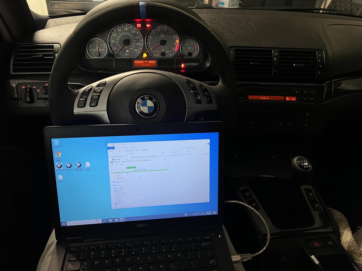

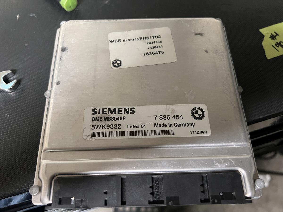

    Tackled the tail lights next. Early models require some mild effort to install LED tails properly. There's nothing worse than seeing those aftermarket LED tail lights with the black outline. The process is really quite simple.
    First acquire a newer version LCM. Unfortunately this does add a useless auto headlight switch state without the proper windshield.
    Then a couple easily sourced adapters to mount the early model harnesses to the led lights.
    Then just follow the coding process(also easily sourced) to rewrite the new LCM using PA soft 1.4. Actual process took like 2mins.
    Now enjoy your new genuine taillights with no dash lights or flickers, and go get a smog.

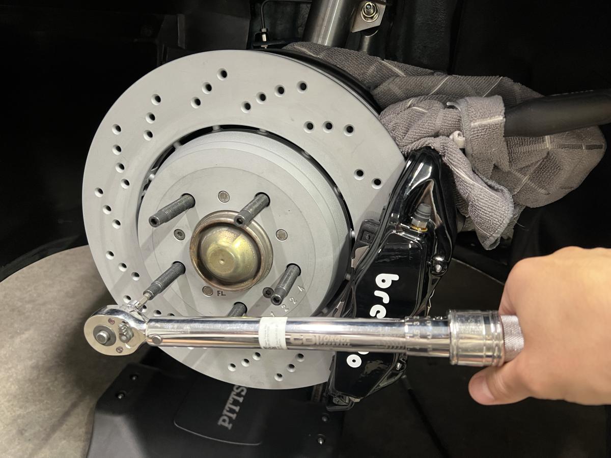

          Megane RS, 996 Brake Retrofit
          It's been 2 months since I last posted, but as usual things are always in motion. Next up was to overhaul the brakes.
          I went back and forth on all kinds of setups, even purchasing retrofit brackets for Alfa Romeo Quadrifoglio calipers. In the end, due to the weight reduction, brake bias, look and feel, I decided to go with Megane RS fronts and 996 rear calipers.
          The Megane RS come new in box with brackets and lines from freakyparts.co.uk. 996 came from ebay for a steal of a price in decent shape. Rallyroad was used for brackets and lines.
          Click image for larger version  Name:	IMG_0893.jpg Views:	0 Size:	172.3 KB ID:	309318​

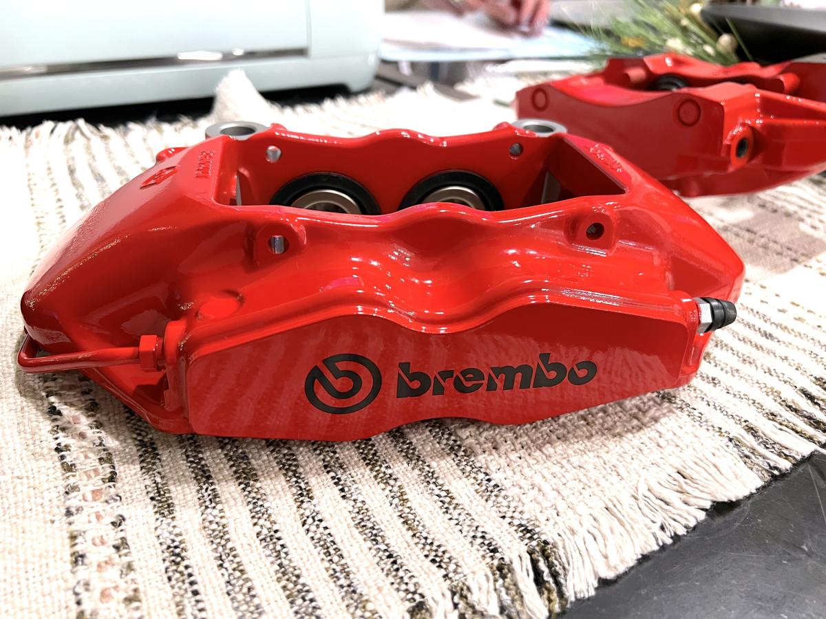

          I thought about running them red, even to the point of refinishing the rears. As soon as I tried them on though, I knew it wasn't the look I was going for.
          ​Click image for larger version  Name:	IMG_1782.jpg Views:	0 Size:	90.0 KB ID:	309319​

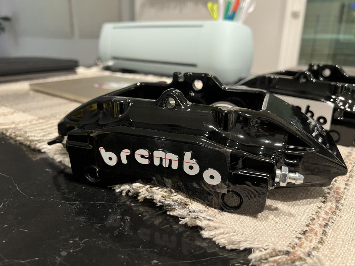

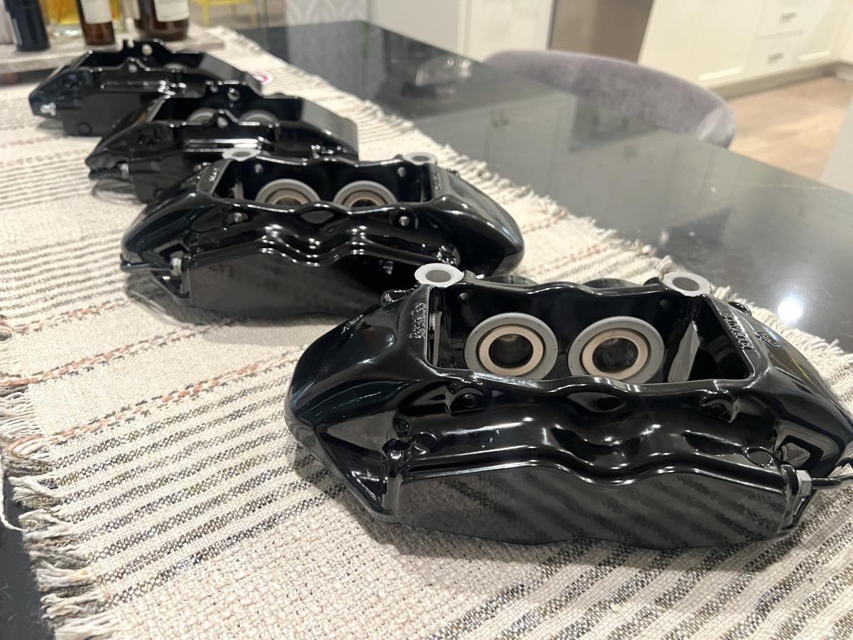

          Knowing what a pain refinishing is, and not having the means to spray 2k clear, I found a powdercoater to take them on for a good deal.

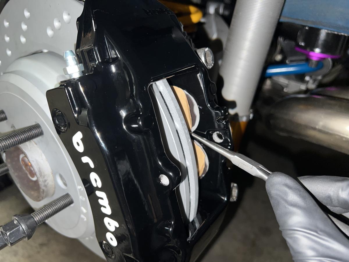

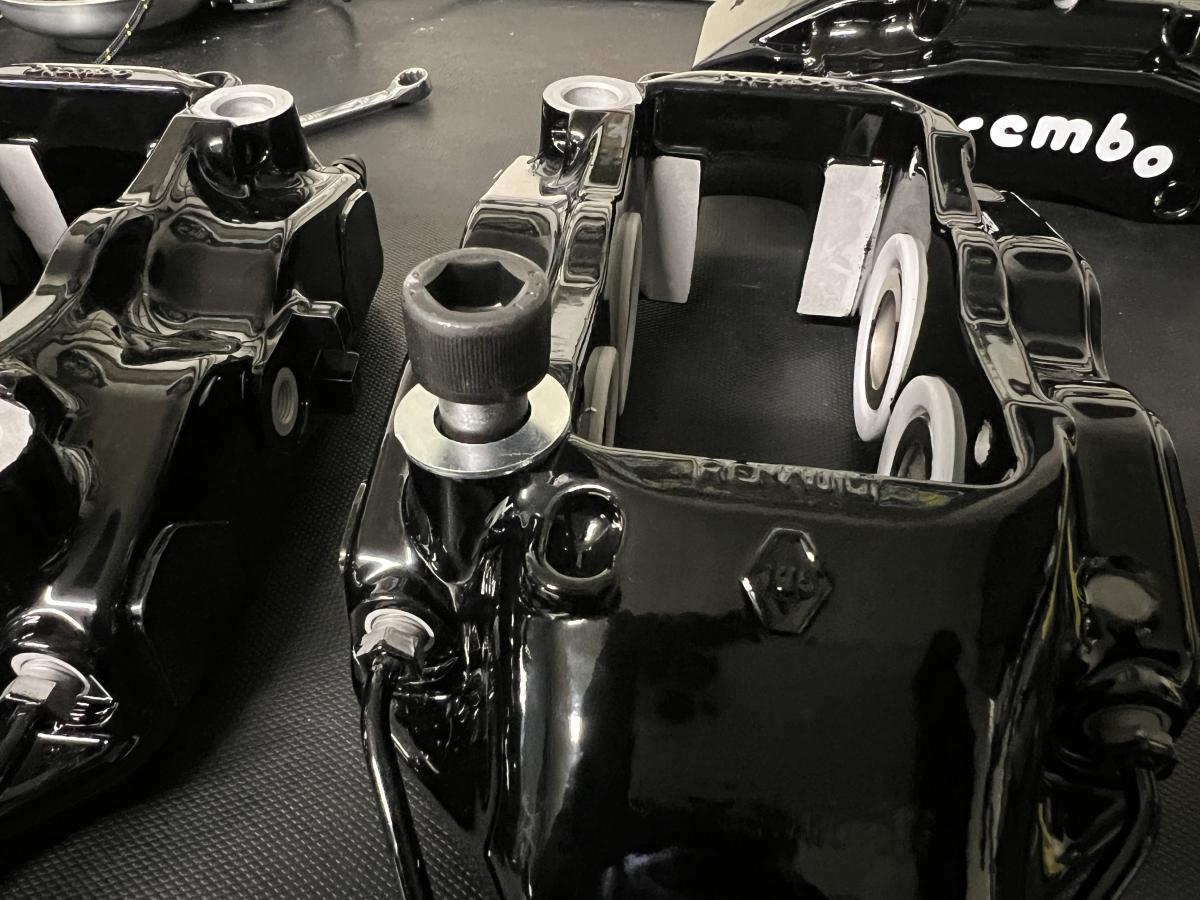

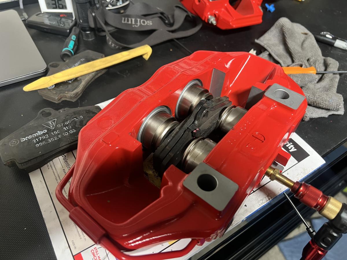

          So I got to disassembling. I knicked a couple 996 pistons and seals in the process, and decided to just purchase full rebuild kits from OPS while everything was out.
          Click image for larger version  Name:	IMG_1965.jpg Views:	0 Size:	144.2 KB ID:	309320​

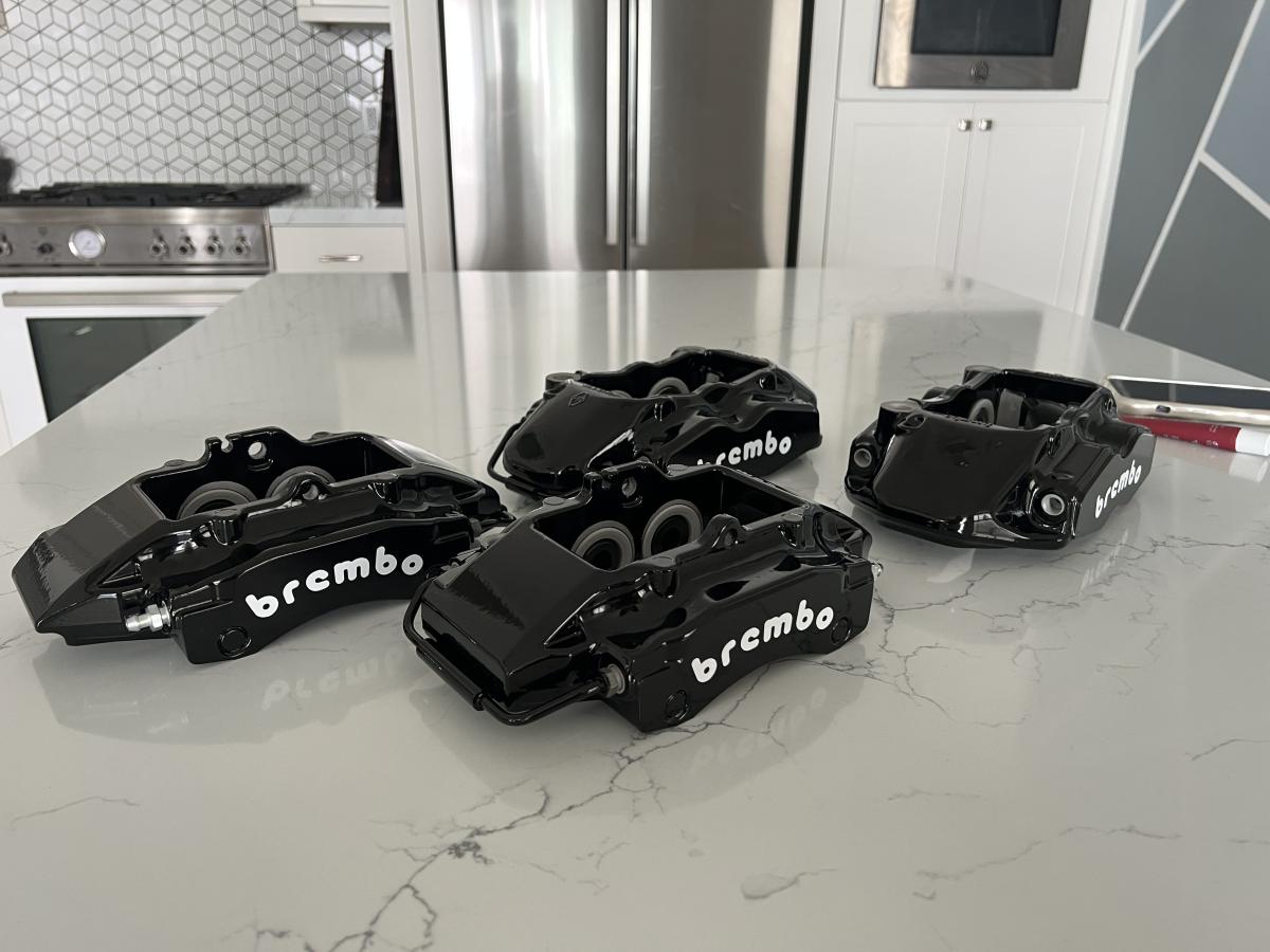

          They came back looking so good. I went with simple gloss black, as you can see. Here they are all refinished with powdercoat, seals, and pistons.
          Click image for larger version  Name:	IMG_2071.jpg Views:	0 Size:	183.7 KB ID:	309322​
          Click image for larger version  Name:	IMG_2077.jpg Views:	0 Size:	179.9 KB ID:	309321​
          Don't forget stickers. Conveniently get a gf that has a cricut with existing vinyl cutting skills. We mocked up the brembo motorcycle logo and she somewhat-gracefully made various test pieces to eventually get it where I wanted. The fun part is these can always be changed.
          Click image for larger version  Name:	IMG_2351.jpg Views:	0 Size:	124.1 KB ID:	309323​Click image for larger version  Name:	IMG_2354.jpg Views:	0 Size:	100.8 KB ID:	309324​
          Everything ready to go. I went with Zimmerman zcp rotors. Don't mind the other stuff in the background...
          Click image for larger version  Name:	IMG_2373.jpg Views:	0 Size:	269.4 KB ID:	309325​
          The install was one of the most rage inducing processes I've done. To be frank, feakyparts included hardware was poorly selected. Insufficiently lengthed bolts, poor fitting or completely missing washers, etc.

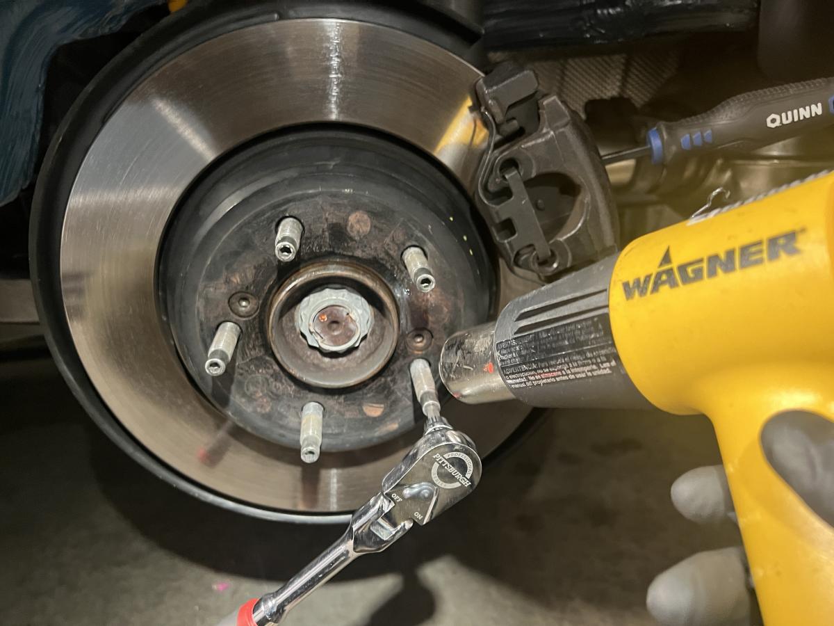

          Good opportunity to remove all the old crap including studs. These came out easily with a little heat. The hex bit removed them fine even though they're "not for removal"
          Click image for larger version  Name:	IMG_2396.jpg Views:	0 Size:	107.6 KB ID:	309326​
          Front looking good, after much pain and waiting on hardware orders.
          ​Click image for larger version  Name:	IMG_2523.jpg Views:	0 Size:	117.0 KB ID:	309329​

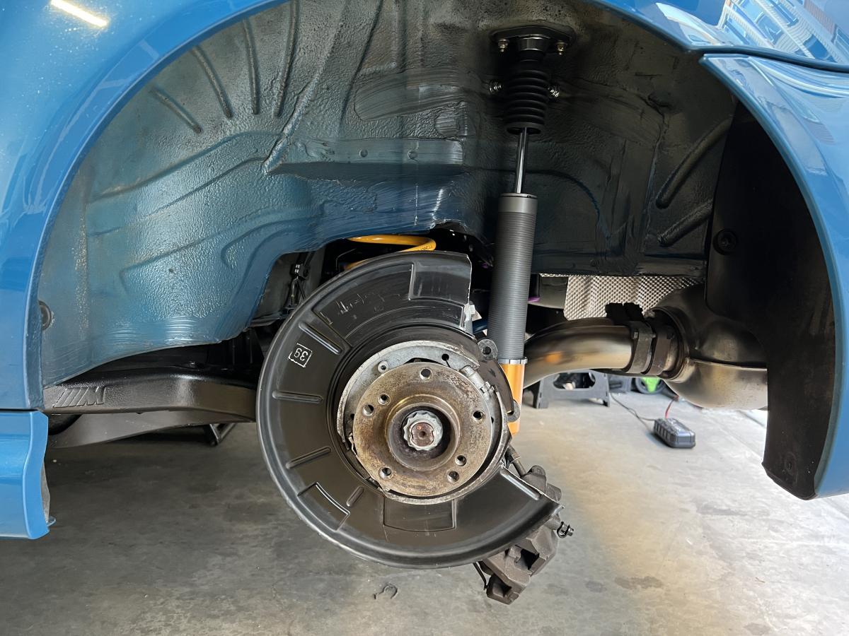

          Trimming the rear shields wasn't too bad with snips. I think I removed more after this pic. Also painted exposed edges and gave the hubs a good scrubbing after.
          Click image for larger version  Name:	IMG_2411.jpg Views:	0 Size:	155.9 KB ID:	309327​
          I used all new piston shims on the rear, hoping to avoid squeal.
          Click image for larger version  Name:	IMG_2541.jpg Views:	0 Size:	107.7 KB ID:	309328​

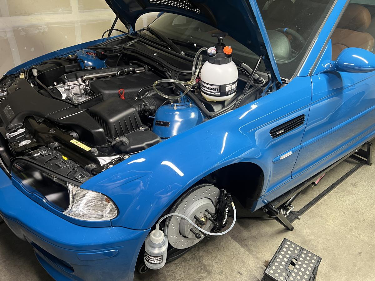

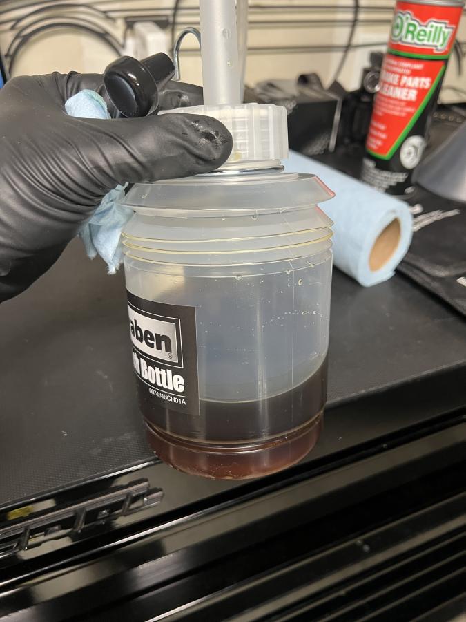

          Finally everything was in and ready for bleeding. The Shwaben power bleeder was amazing at this.
          Click image for larger version  Name:	IMG_2556.jpg Views:	0 Size:	181.4 KB ID:	309330
          Looks like the fluid was due for a change. Cola?
          Click image for larger version  Name:	IMG_2567.jpg Views:	0 Size:	71.2 KB ID:	309331​

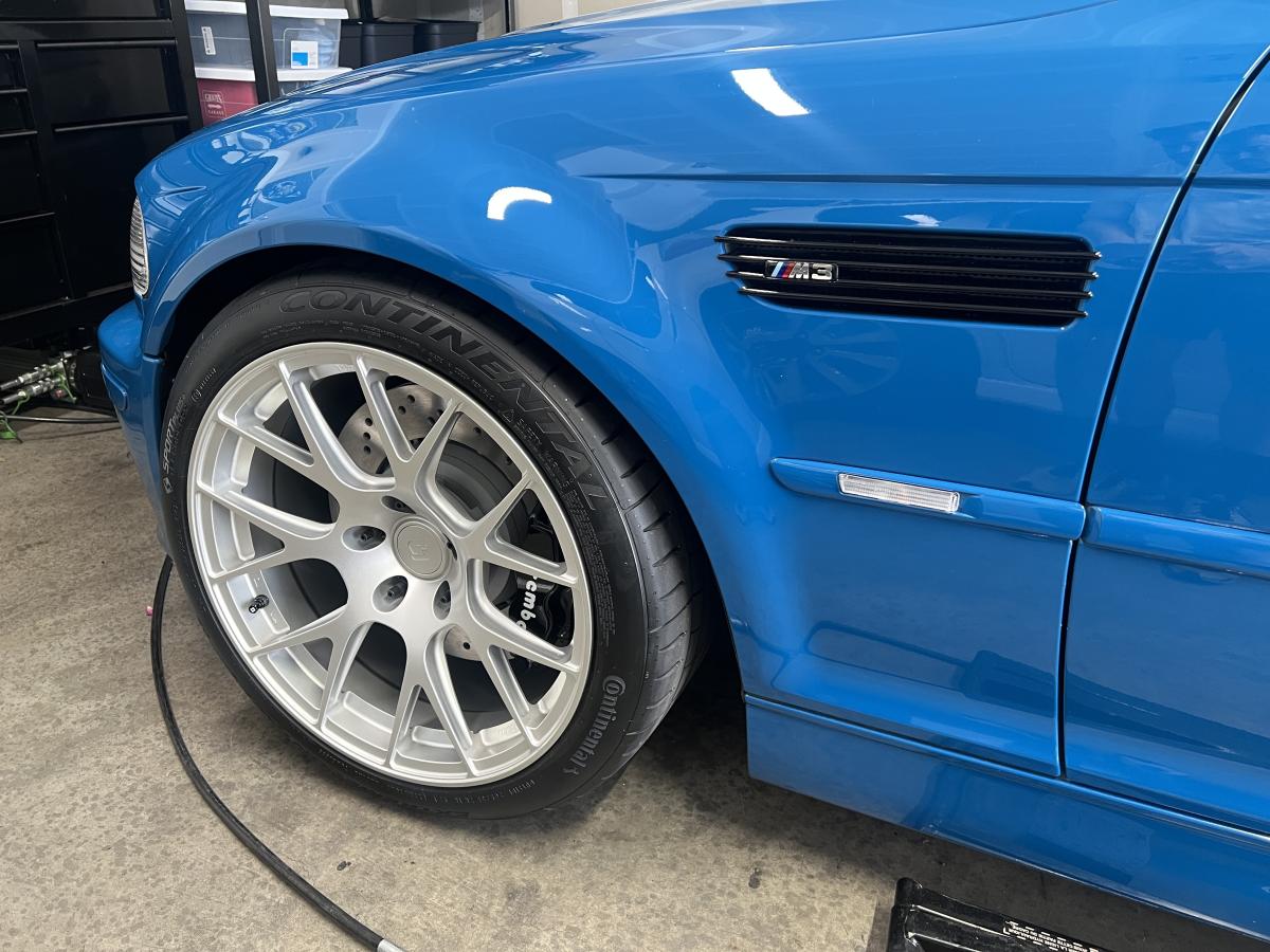

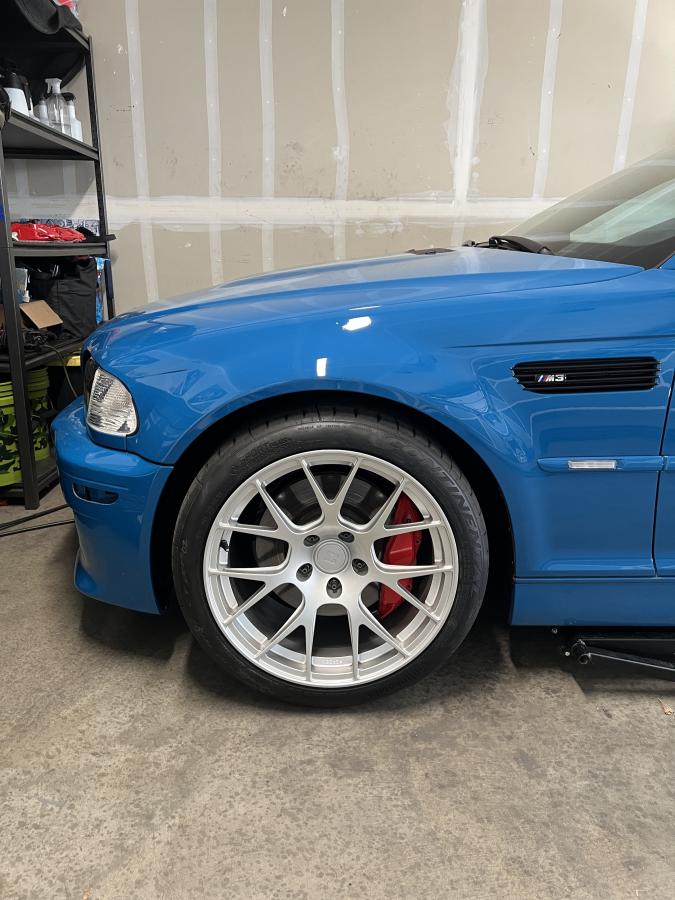

          Went out and bedded the pads in, and gave the car a much needed wash.
          Click image for larger version  Name:	IMG_2597.jpg Views:	0 Size:	148.8 KB ID:	309332​
          Click image for larger version  Name:	IMG_2609.jpg Views:	0 Size:	151.9 KB ID:	309333
          Thoughts - So, I have a squealing issue with the pads on the front and rear. I will continue troubleshooting this, but outside of that wow! The brake feel is amazing, and the car really flies with more unsprung weight knocked off. The look with the black calipers and new rotors is just what I was going for too. Subtle but so much better than stock.
          It's too bad the pads will likely need to be changed as the dust is low, and I'm perfectly happy with their performance.
          Stay tuned for those other parts to get installed. I swear once those are in I'll get some proper pics of the car, I might even drive it a few miles.

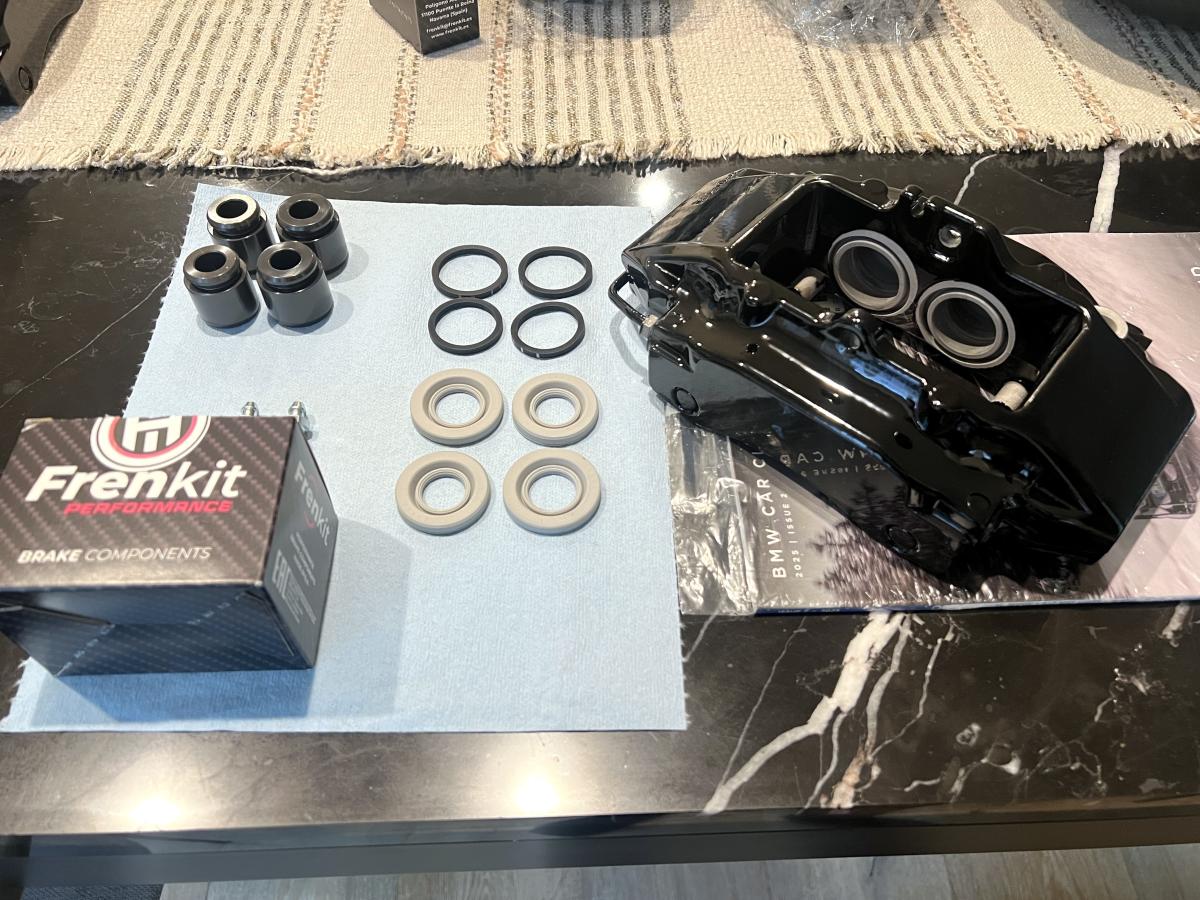

            bavarian3 Your calipers were done extremely nice! I love to see them nice and fresh and I agree once you get to feel a fixed caliper compared to a sliding caliper there is no going back! And I always like to remind folks dust boots should always go on dry like you did. Bravo!
            High Temp Caliper Rebuild Kits For Brembo/Stoptech/Akebono
            www.ohioperformancesolutions.com
            2007 C4S F77 Aerokit / 2004 E46 M3 / 2018 M3 comp​
                Thanks for the great service! The parts are working exceptionally well.

                On the topic of brakes, the squeal ended up being the pads. Whatever is in the compound of the powerstops did not agree with the rotors despite all anti-squeal measures taken.
                I changed to Brembo ceramics per maupineda data point. Problem solved. Yeah the bite is lackluster when compared to true performance pads, but dust is low and overall the setup feels A++. Very happy with everything.

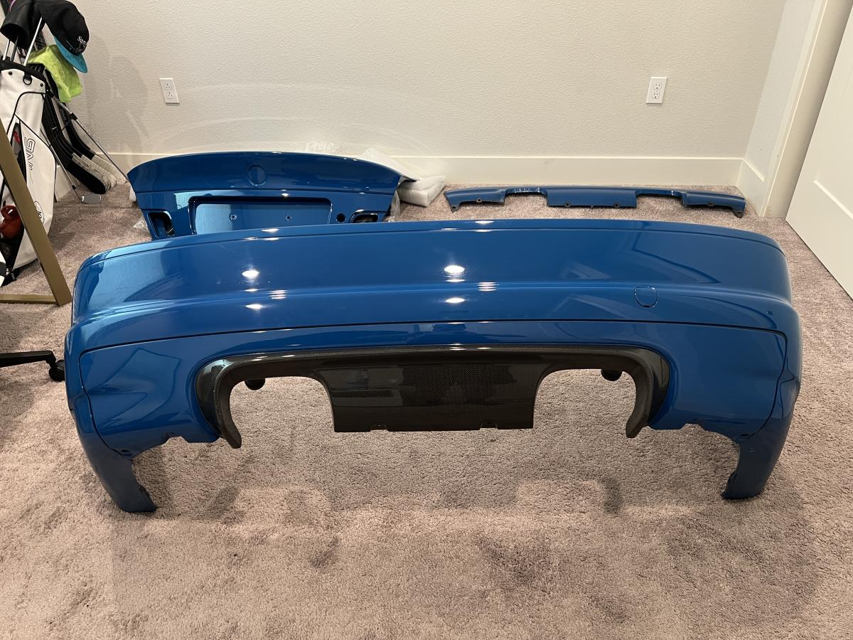

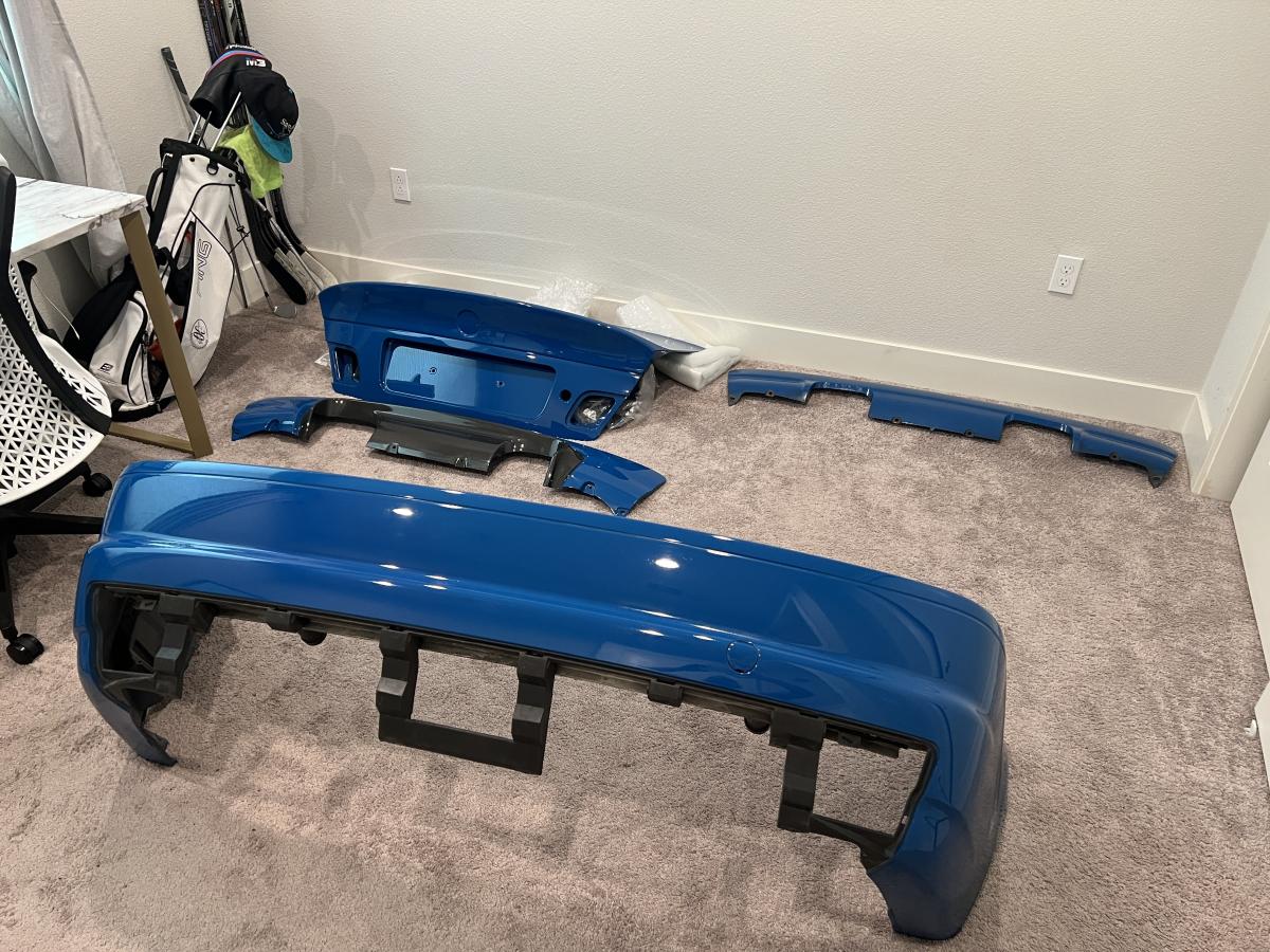

                  Another major project complete as I finished some exterior enhancements on the rear. This took a while as I worked with the painter to get the color match right. TLDR - We initially sprayed PPG paint which matched poorly. We resprayed with Glasurit and the match was excellect, and IMO had better quality clear coat.
                  A shot of the completed parts ready to go on. Super happy with the results. These were painted separate from the car as I'll of course be doing the fitting, and no touching the factory paint for blending.
                  Gt4 / Mile End Composites Diffuser
                  ​Click image for larger version  Name:	IMG_1836.jpg Views:	0 Size:	224.4 KB ID:	314426​​​

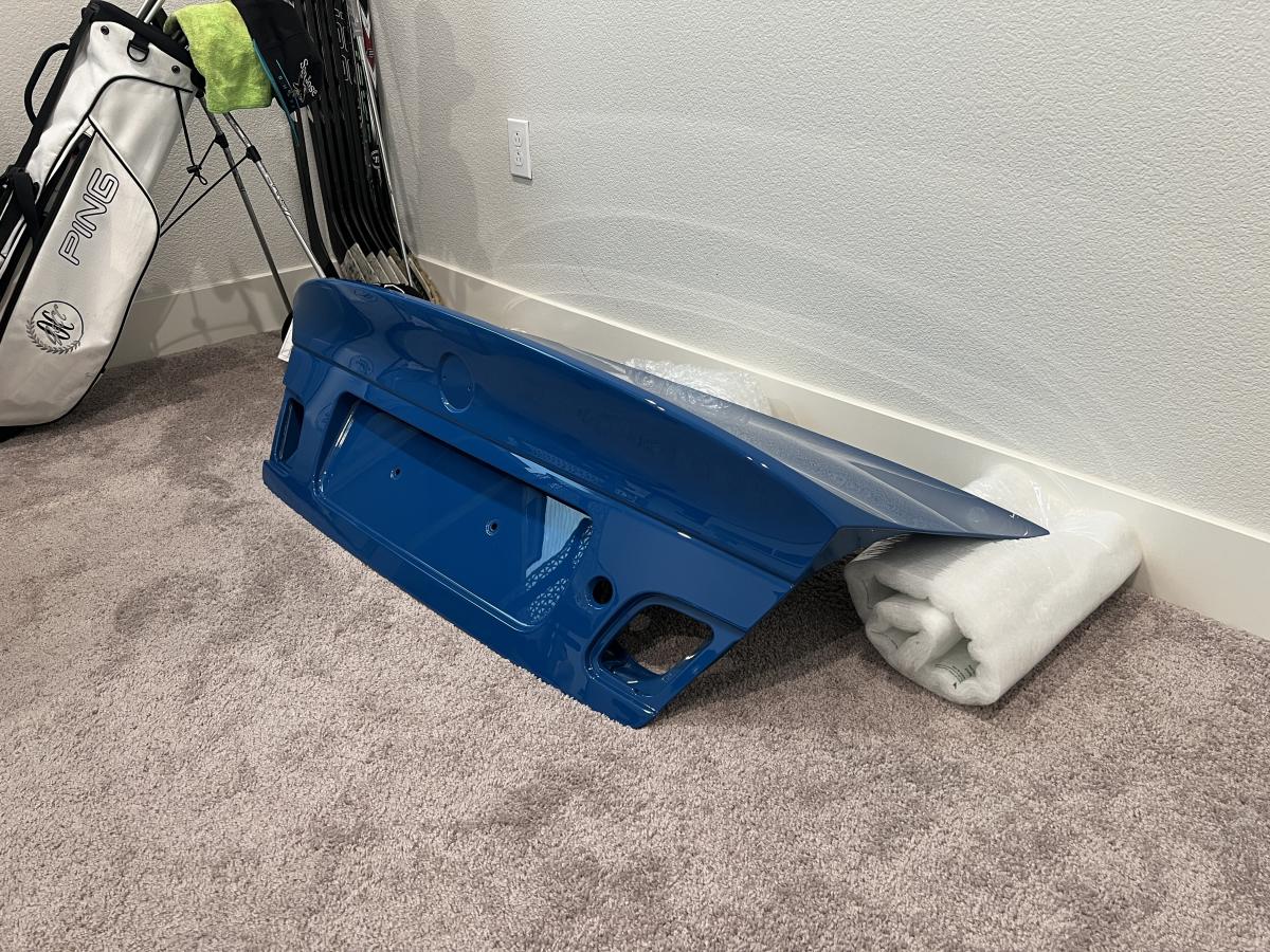

                  Genuine CSL trunk.

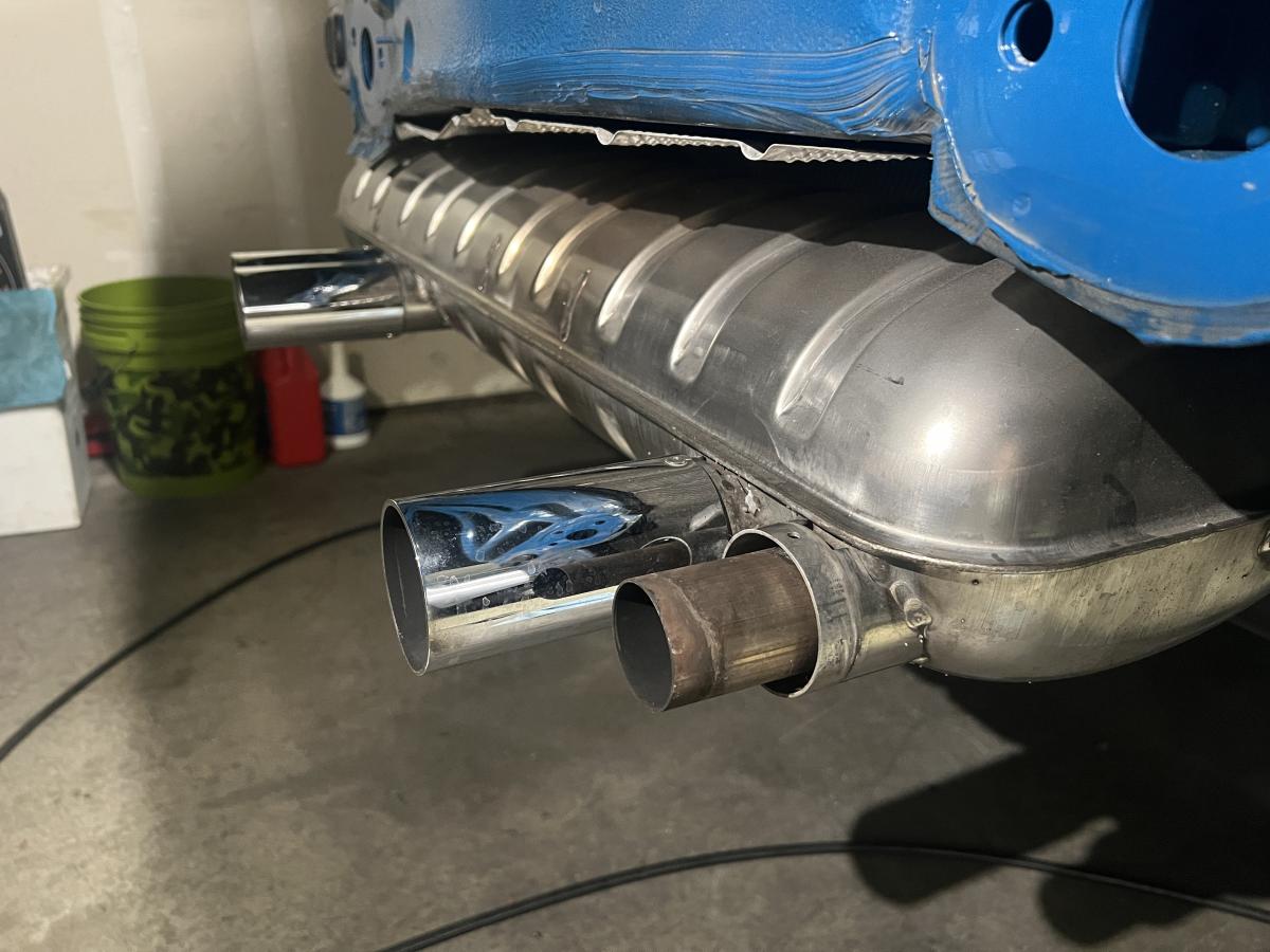

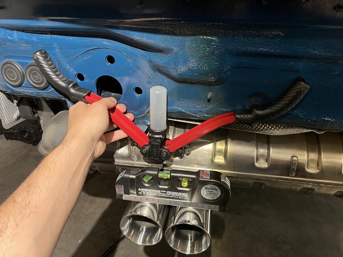

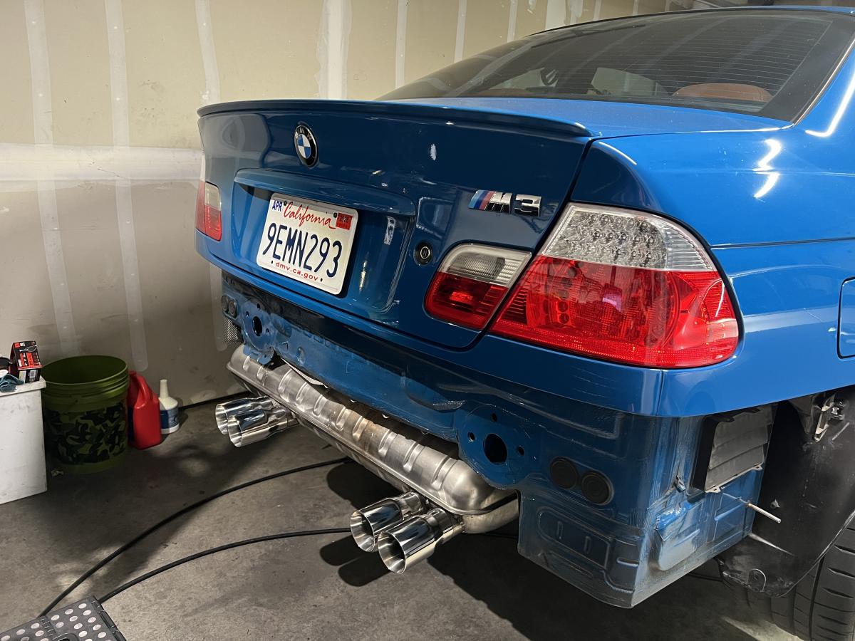

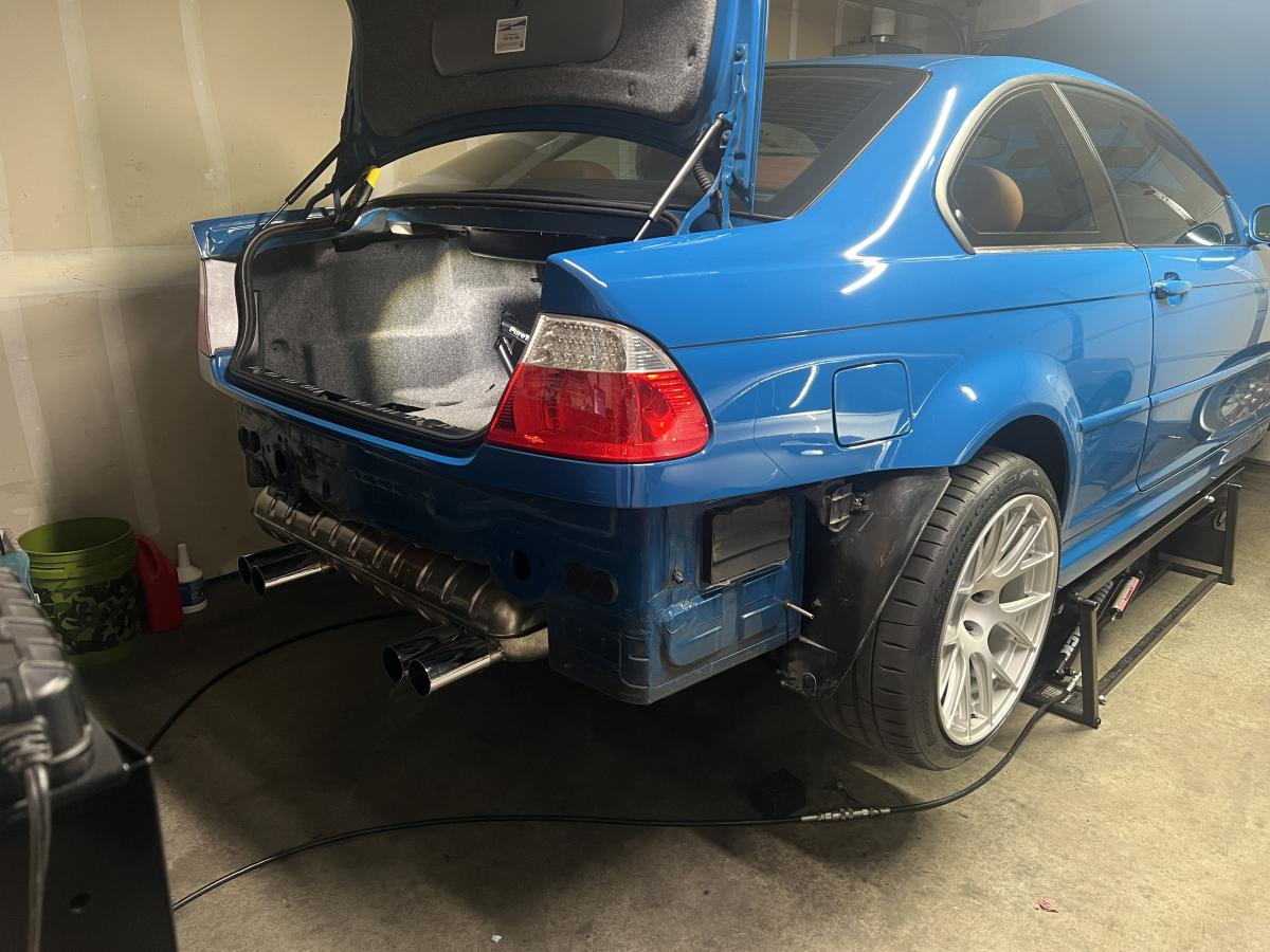

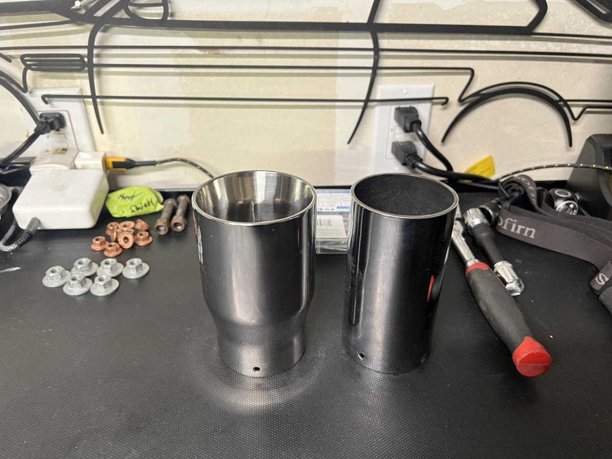

                  First step I removed the rear bumper and took the opportunity to install some new tips. Maybe I'll do a muffler down the road but I'm pretty happy with the stock muffler note with euro headers and HJS catted section 1.
                  Click image for larger version  Name:	IMG_2934.jpg Views:	0 Size:	136.5 KB ID:	314428​​​
                  Once you figure out the right drill bit size the rivets come out easily
                  Click image for larger version  Name:	IMG_2936.jpg Views:	0 Size:	111.6 KB ID:	314429​​​
                  The tips were sourced from a community seller on FB groups from UK. Great suggestion from. Avedis​
                  New on left, stock on the right
                  Click image for larger version  Name:	IMG_2940.jpg Views:	0 Size:	133.5 KB ID:	314430​
                  You don't really need the level, but I was curious. Had to source some rivets in 5/32x1/4" and in stainless steel to avoid any galvanic corrosion.
                  Click image for larger version  Name:	IMG_2972.jpg Views:	0 Size:	140.5 KB ID:	314431​​​

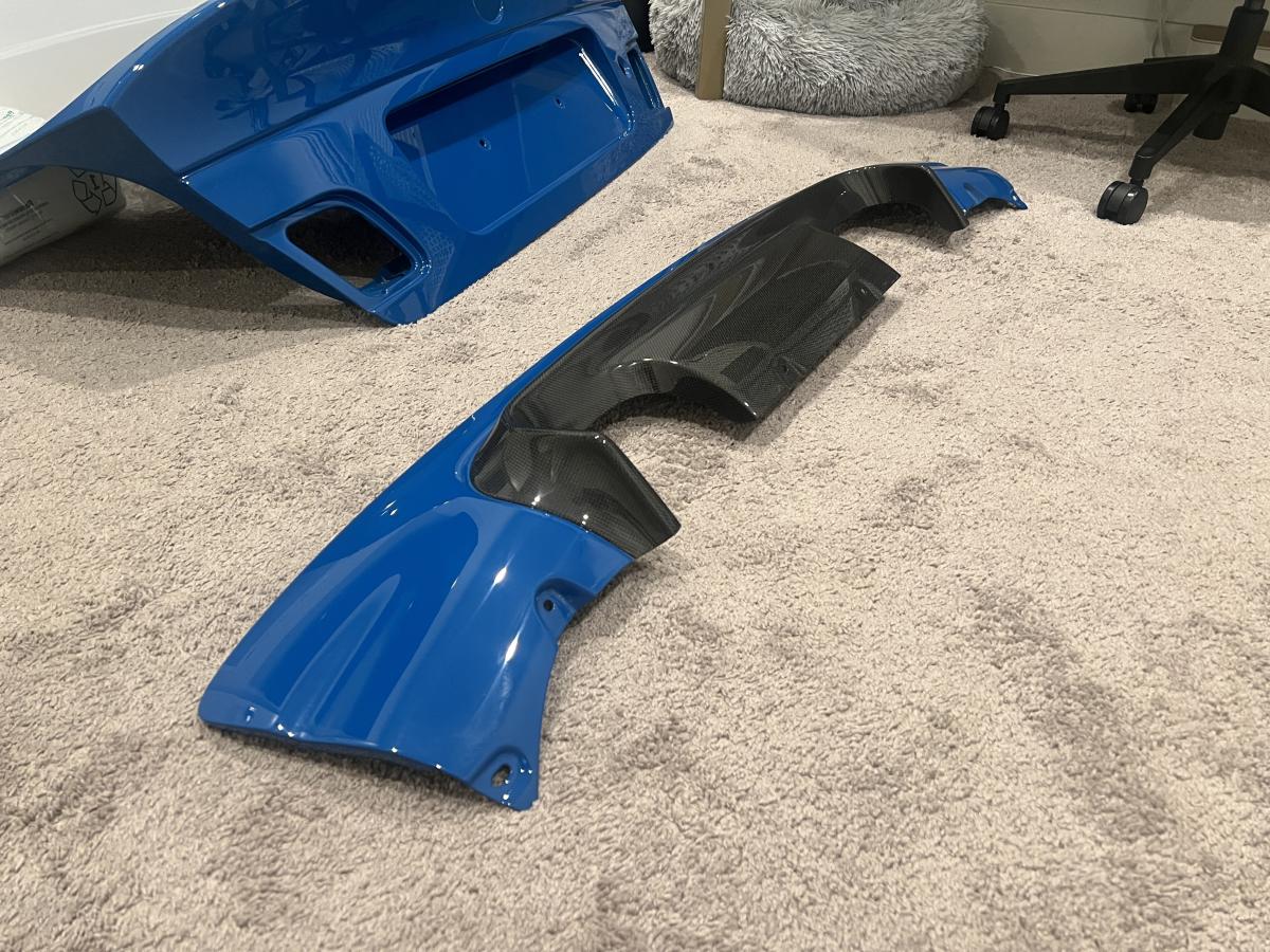

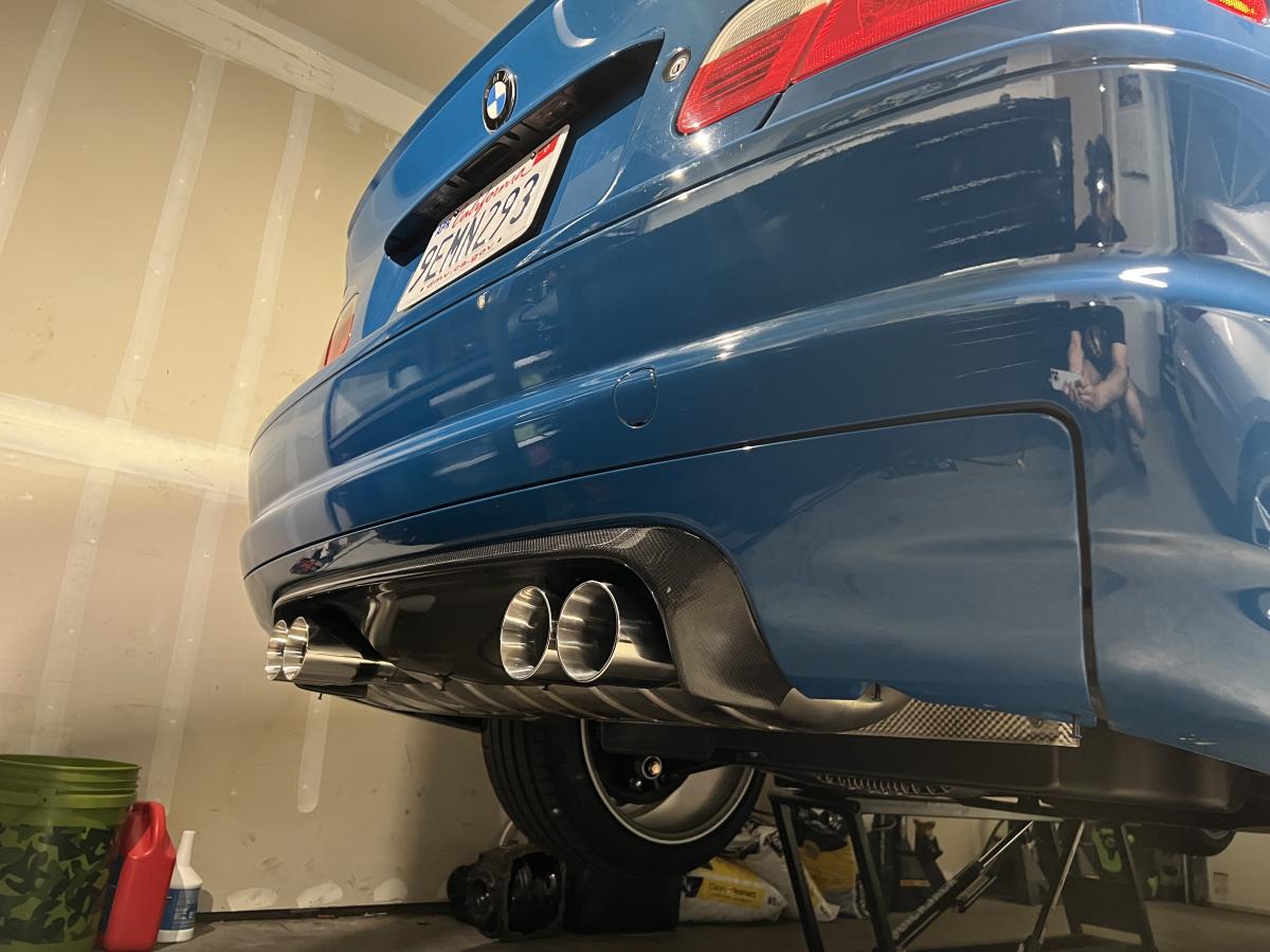

                  Then I worked on the bumper. There really wasn't much work to do here. The MEC diffuser is so good, you literally just pop it on like the stock one. I have no experience with any of those ebay examples, but I feel this is one of those you get what you pay for situations.
                  Click image for larger version  Name:	IMG_2950.jpg Views:	0 Size:	206.4 KB ID:	314433​​​
                  I really can't ask for more with an aftermarket carbon part.
                  Click image for larger version  Name:	IMG_2951.jpg Views:	0 Size:	213.9 KB ID:	314434​
                  Test fitting going well. I went ahead and polished and ceramic coated the piece. The tips and diffuser couldn't have fit better.
                  Click image for larger version  Name:	IMG_2978.jpg Views:	0 Size:	114.0 KB ID:	314435​​​

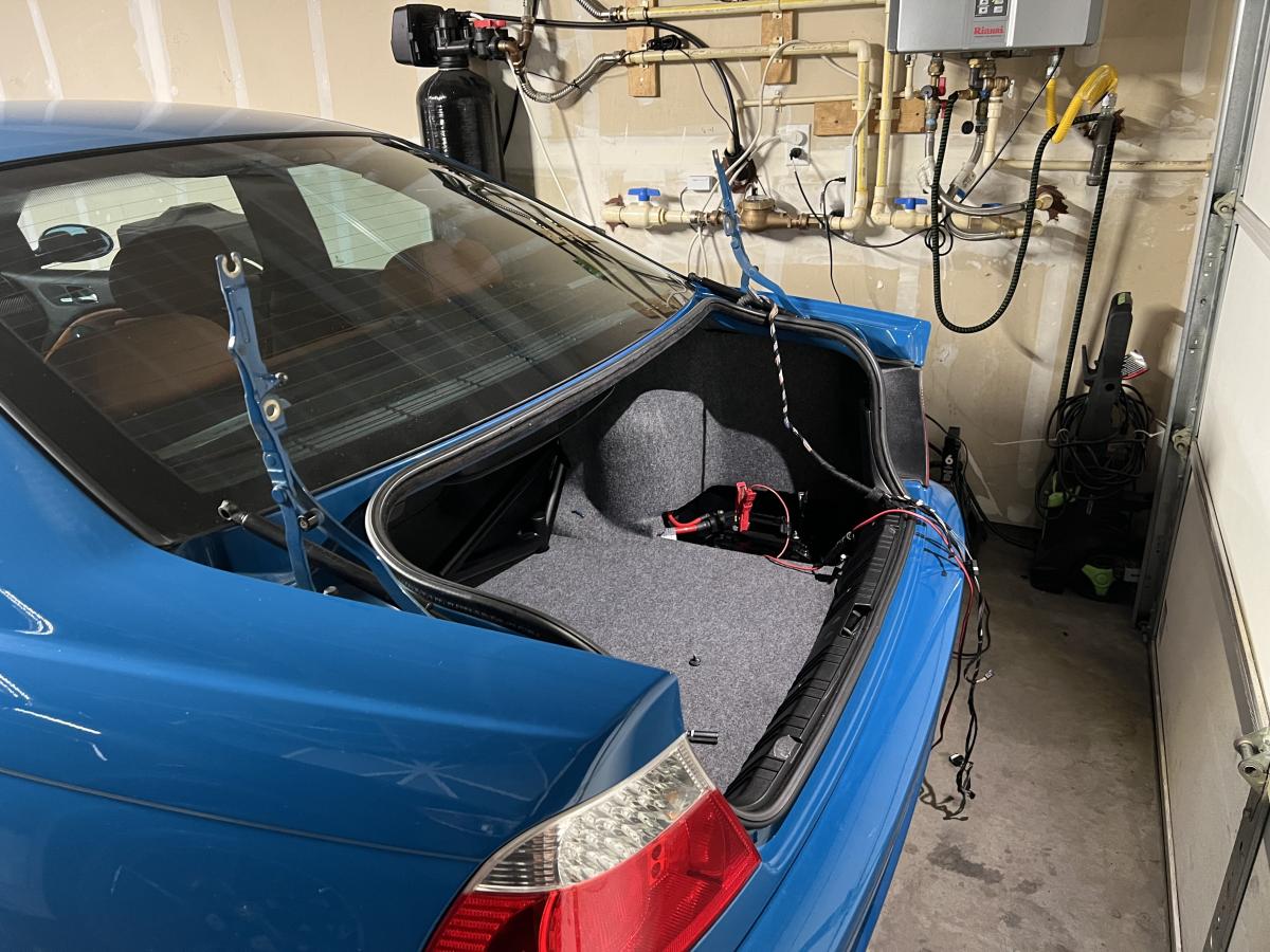

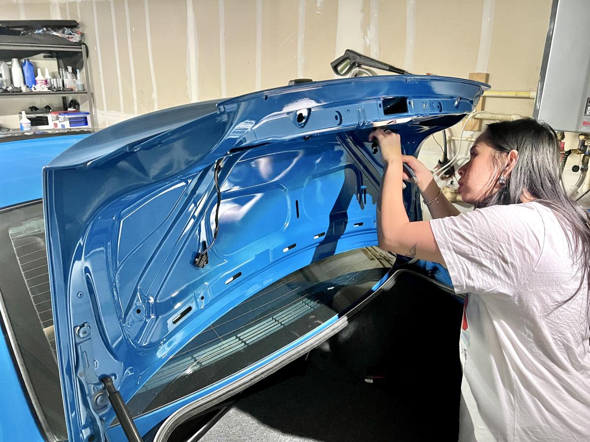

                  Moving on to the trunk. This was actually more involved than I thought. The genuine part made it an enjoyable experience though.
                  Click image for larger version  Name:	IMG_3026.jpg Views:	0 Size:	167.5 KB ID:	314446​
                  Got some help to feed the trunk onto the hinges. As a bonus, turns out she could just walk the wiring harness through the new trunk by hand. 🤣
                  Click image for larger version  Name:	IMG_3030 2.jpg Views:	0 Size:	181.1 KB ID:	314436​​​

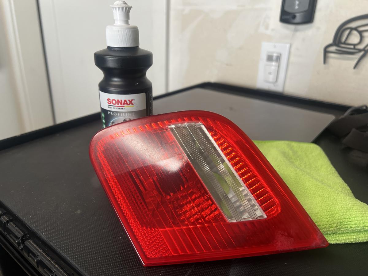

                  Prepped the donor inner lights with polish and ceramic. You can see the difference where I taped the line.
                  Click image for larger version  Name:	IMG_3045.jpg Views:	0 Size:	111.1 KB ID:	314437​

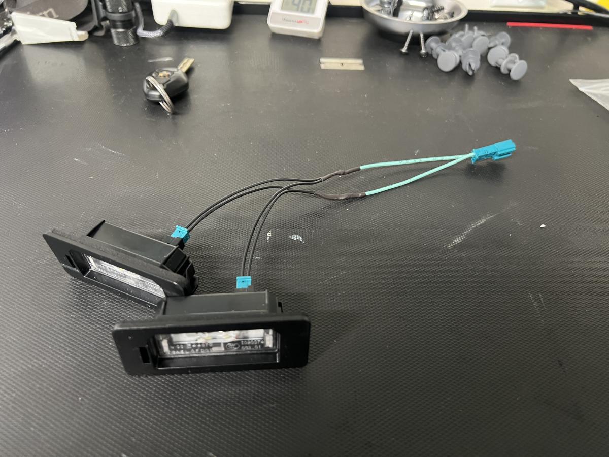

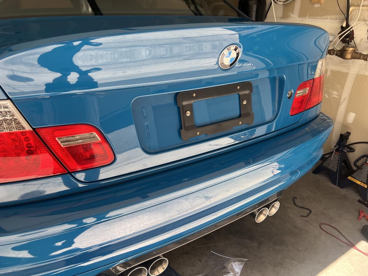

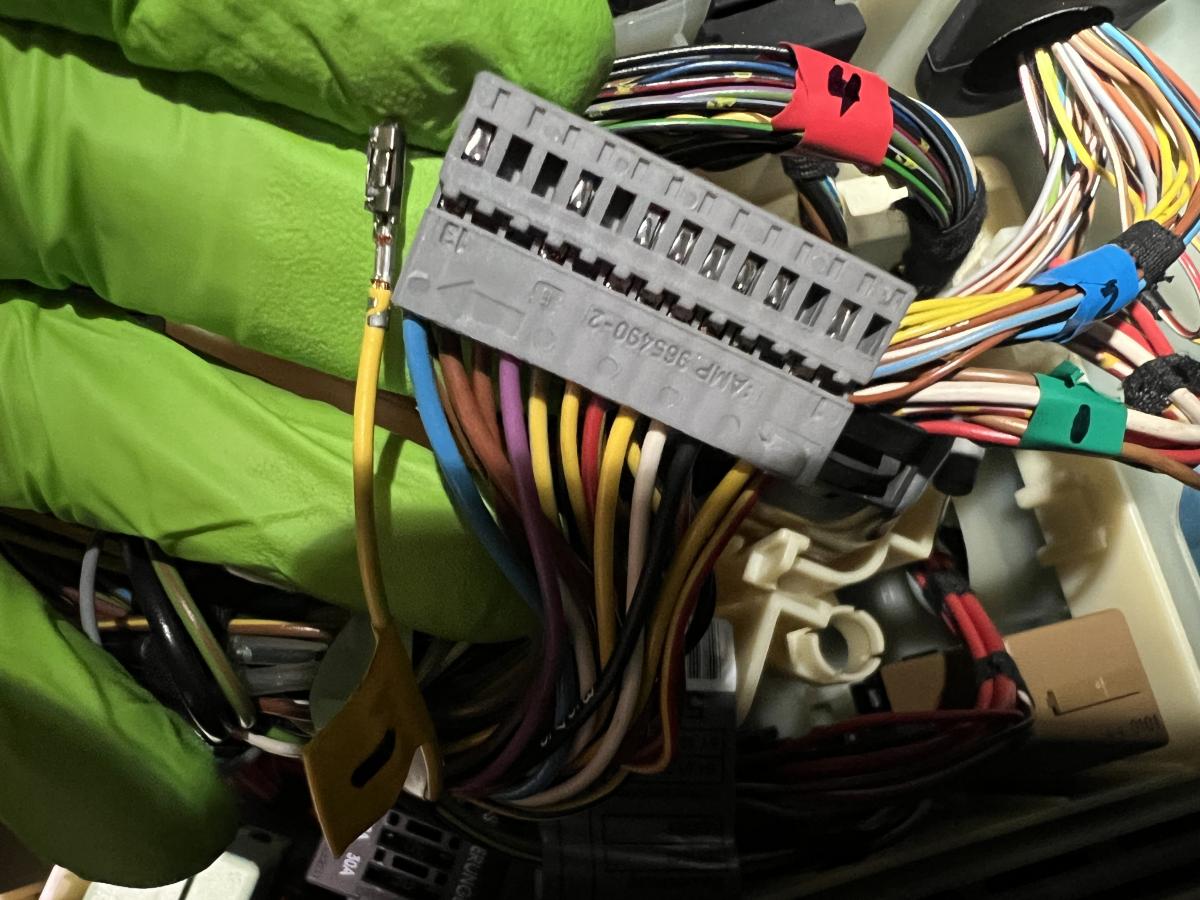

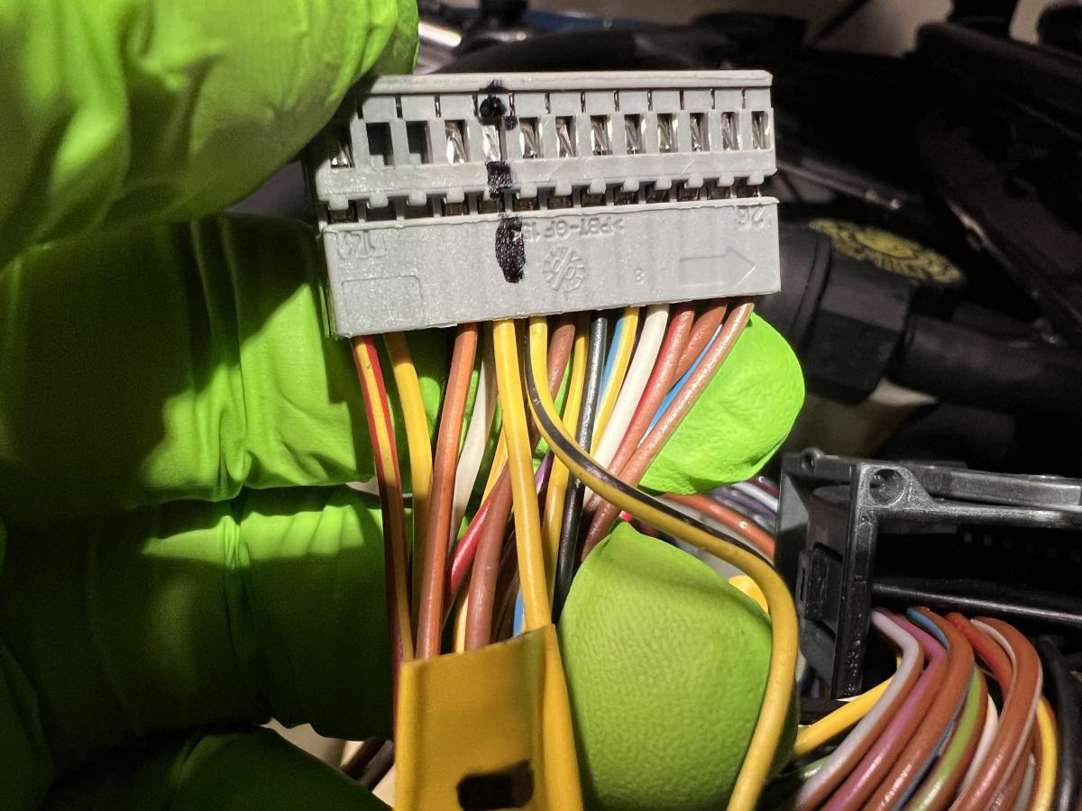

                  Prepped the wiring of the LED license plate harness. Many make the same mistake I did and measured this out too short. The reason is because how the power and ground split to each light isn't accounted for. Instead folks measure from the bigger blue harness shown below, instead of where the black wires split.
                  Click image for larger version  Name:	IMG_3050.jpg Views:	0 Size:	139.5 KB ID:	314438​
                  The lights themselves were a pain to fit, requiring some dremel work(on the lights themselves) to squeeze on, but they eventually fit and look fantastic.
                  Click image for larger version  Name:	IMG_3051.jpg Views:	0 Size:	86.1 KB ID:	314439​

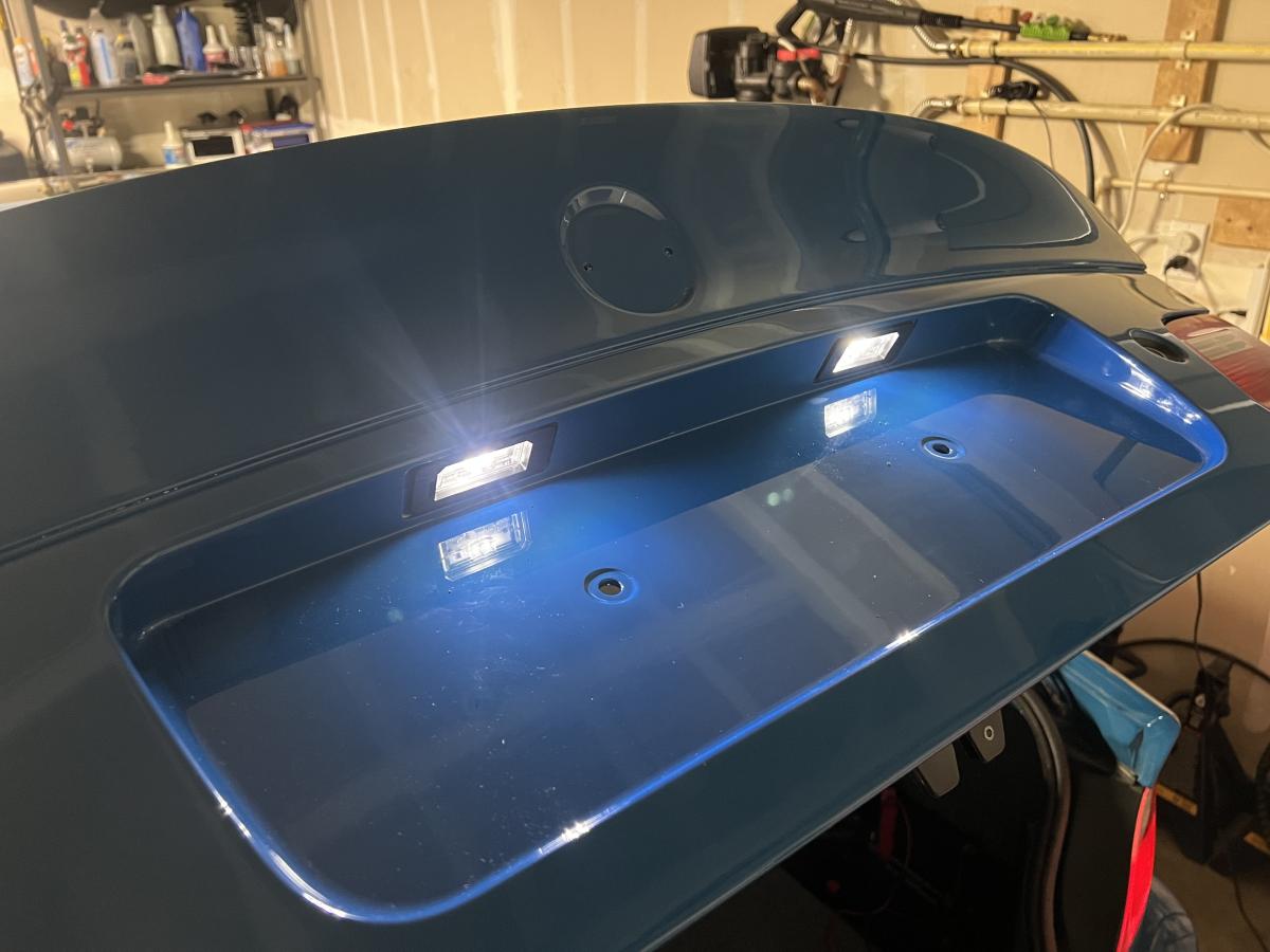

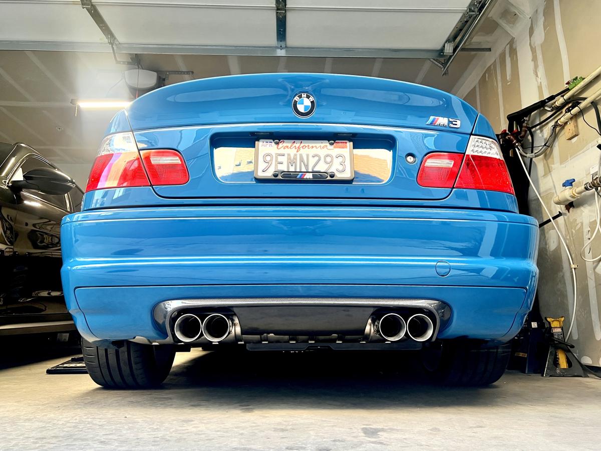

                  Roundel and license plate base fitted. I used genuine well nuts for the plate base, then a bunch of trips to the hardware store to get the screws right for the license plate framing. Roundel also didn't fit without some dremel work. Oh that key tumbler was a slight pain to get right as well. The gasket is a little fussy.
                  Click image for larger version  Name:	IMG_3104.jpg Views:	0 Size:	148.9 KB ID:	314440​

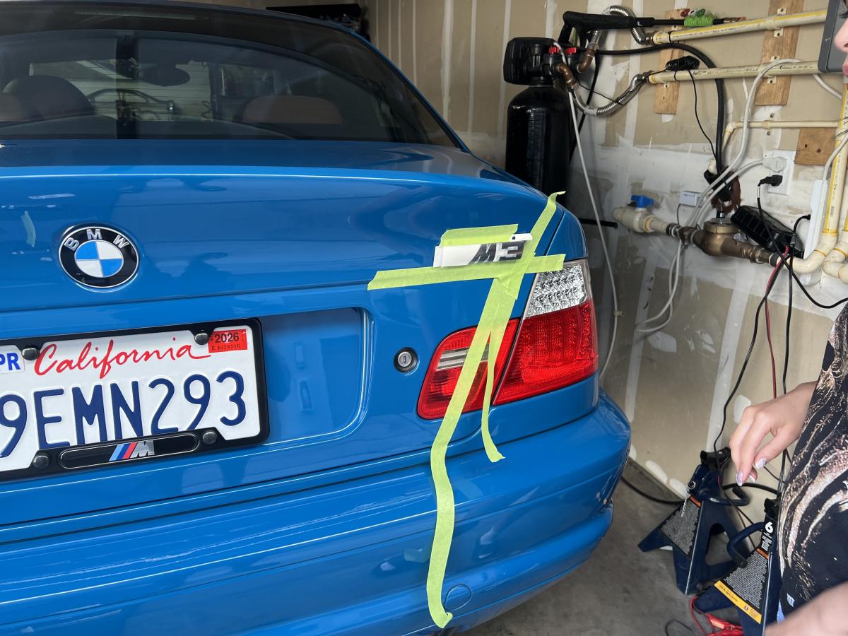

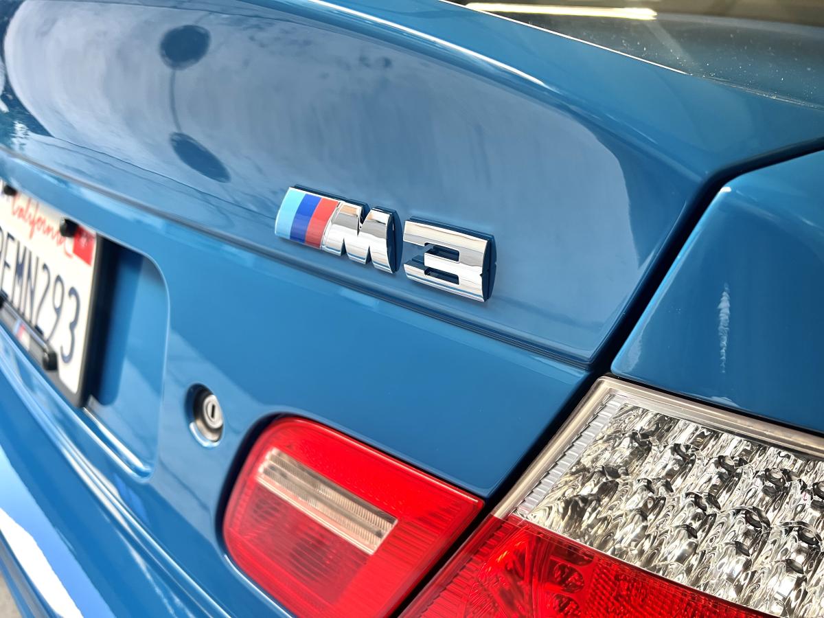

                  Fitting the M badge took some precision to make sure I didn't go crazy after sticking it on. I basically measured and drew out some spacing as outlined from this image. The csl badge didn't matter, just getting the padding right from the bottom and right lines.
                  Click image for larger version  Name:	art-mg-bmwe46m3csl04.jpg Views:	0 Size:	75.0 KB ID:	314423
                  Overanalyzed for a while till getting it what I hoped would be just right.
                  Click image for larger version  Name:	IMG_3167.jpg Views:	0 Size:	154.3 KB ID:	314424
                  Bang on. Not too close, not too much gap.
                  Click image for larger version  Name:	IMG_3176.jpg Views:	0 Size:	138.3 KB ID:	314425​

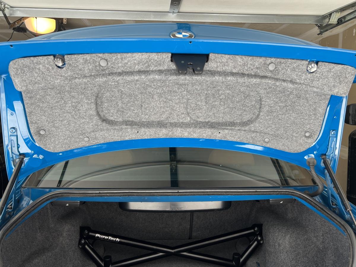

                  Last step was to fit the inner liner. This also required some dremel work as the holes didn't all want to fit.
                  While it may seem incomplete, I won't be installing the tool kit at the moment. I'm happy with how it looks as is.
                  Click image for larger version  Name:	IMG_3109.jpg Views:	0 Size:	181.6 KB ID:	314441​
                  And there it all is. A whole new look.
                  Click image for larger version  Name:	IMG_3173.jpg Views:	0 Size:	187.6 KB ID:	314442​
                  I'm not the first to do this look, but it never gets old to me.
                  Click image for larger version  Name:	IMG_3175.jpg Views:	0 Size:	158.3 KB ID:	314443​
                  This work was completed a month ago and I've been enjoying driving it, making some summer meets here n there. Here are a couple shots from a photographer that posts up on a local mountain.
                  Click image for larger version  Name:	BMP-07202025-3445-Original File.jpg Views:	0 Size:	170.8 KB ID:	314444​

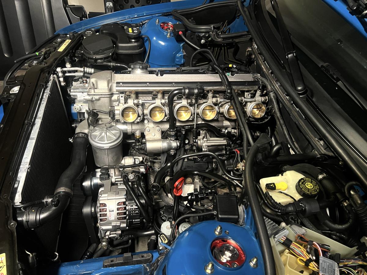

                            I planned on waiting till winter for this, but I figured with CA smog I better enjoy this as long as possible till it has to come out again. I was lucky to come across a nice deal on a Karbonius Race from a forum member looking to quit having to swap for smog purposes. I won't mind the hassle, so let's go.

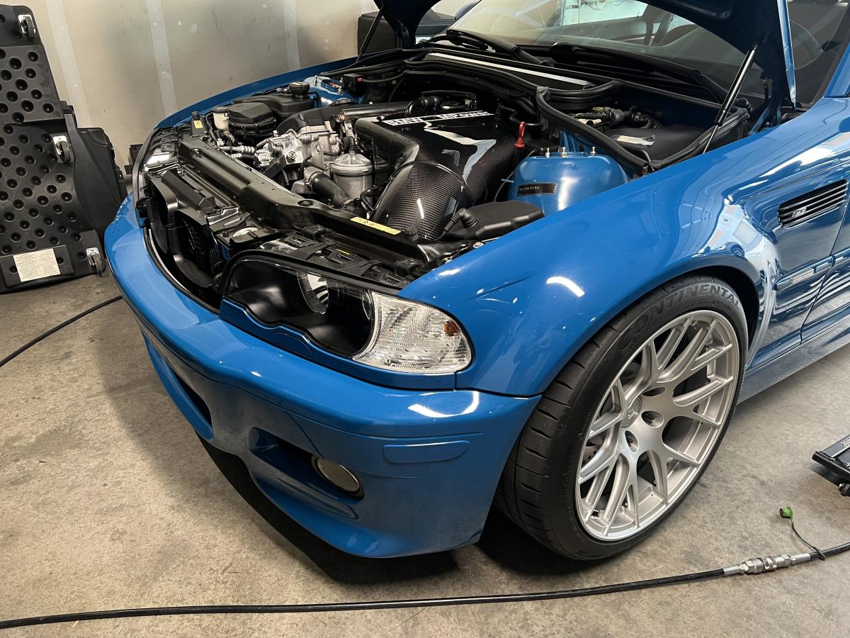

                            Out goes some parts. This was my first time pulling the intake, so it opened up a new area for cleaning. This was post manicure.
                            Click image for larger version  Name:	IMG_3425.jpg Views:	0 Size:	205.4 KB ID:	320228​

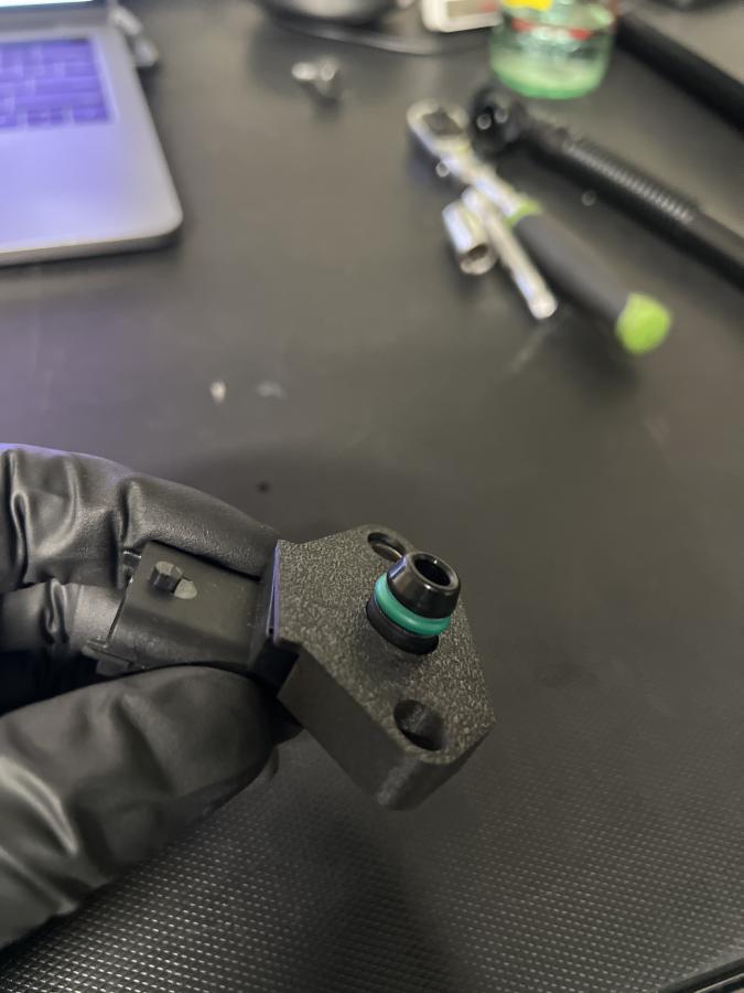

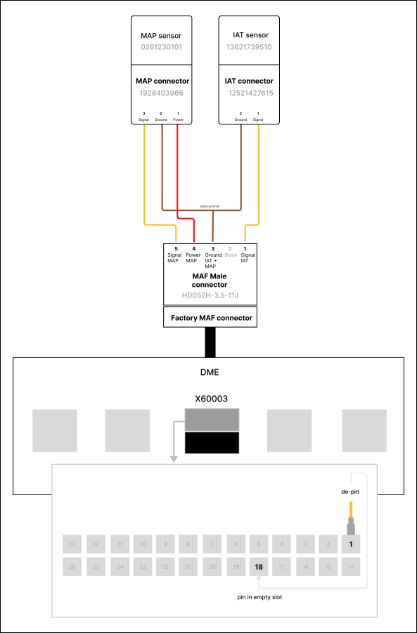

                            Everything was quite simple on removal, figuring out the best way to wire the MAP sensor gave me more of a headache. Some amazon and some awesome heinzboehmer provided bits would help get me to where I eventually wanted to go.
                            Click image for larger version  Name:	IMG_3379 2.jpg Views:	0 Size:	185.5 KB ID:	320229​
                            The issue wasn't how to wire the MAP. It's only a few wires. The issue was how to do it without splicing into the factory wires. I wanted it to be completely reversible without leaving traces of tampering. To my luck, I found an amazing writeup from karter16 which was exactly what I was looking for: link.
                            The gist of it is you wire the MAP and IAT lines straight into the now open MAF connector. Then you just re-pin one slot in the x60003 DME harness. I drew up a diagram for those confused, and even included the part numbers for each primary component(you still need little bits like grommets and pins which Karter covers in detail).
                            Click image for larger version  Name:	image.png Views:	0 Size:	41.2 KB ID:	320230​

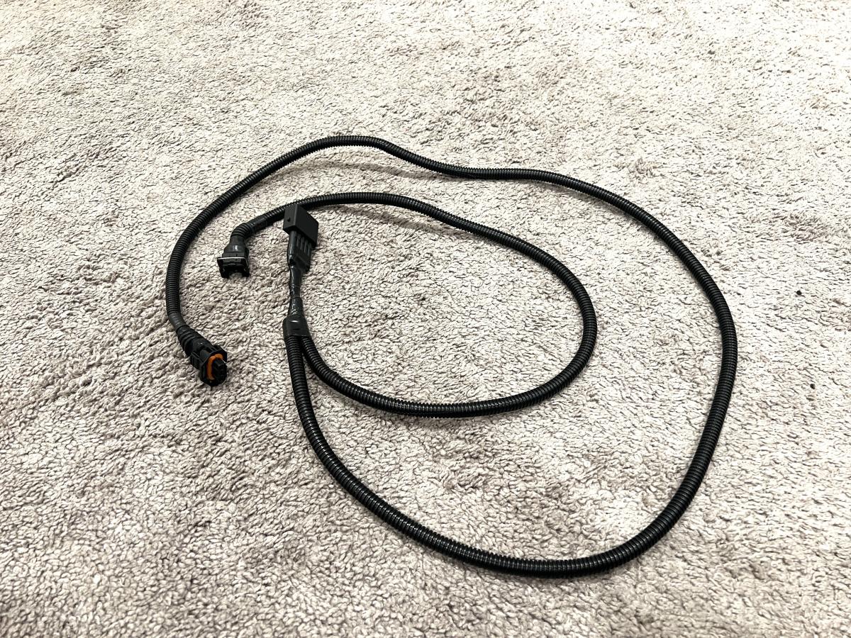

                            This is what the final harness is like. Left is MAP harness, middle is to IAT, and right goes into the MAF connector. Go into the X60003 harness and re-pin slot 1 to slot 18. The best part is it's completely reversible and will leave no trace of tampering, and no need to feed any wires through the harness weatherproofing.
                            I will redo this when I take things apart for smog to optimize the length, and put some proper sealing on the MAP connector end.

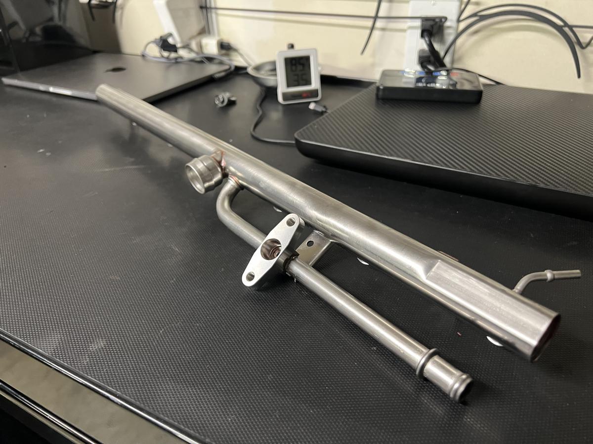

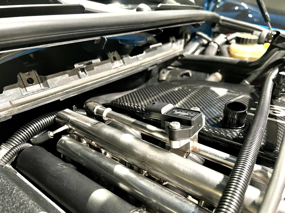

                            Another annoyance with the 2001's is the vacuum line many use the covid-19 kit for doesn't seem to fit too well. Besides, this also helps avoid tampering with factory equipment(not that a hose is a big deal). Other solutions(kassel) seem to have question marks around them, so there was only one fool proof solution that I figured I'll buy while I still can.
                            Genuine CSL air rail.
                            Click image for larger version  Name:	IMG_3499.jpg Views:	0 Size:	150.5 KB ID:	320234​

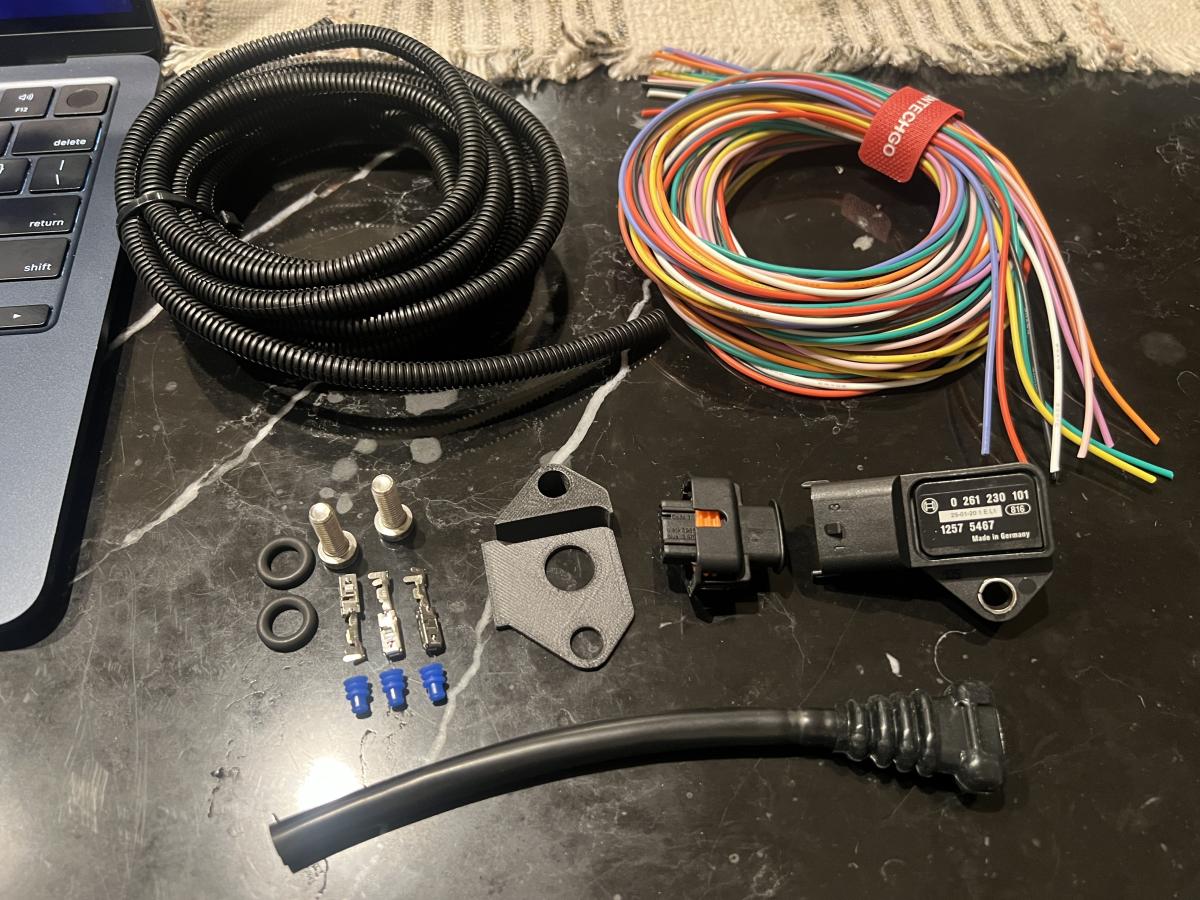

                            This is where a 3d printed parts comes in handy with Karter and Heinz's awesome contributions. The adapter in the pic above with the wiring loom is glued(I used epoxy) to the map sensor for proper fitting to the CSL air rail. This is necessary to get a nice fitment with the Saab MAP sensor(0261230101).
                            Click image for larger version  Name:	IMG_3501.jpg Views:	0 Size:	51.0 KB ID:	320235

                            With that set I can move to the DME for the re-pinning as previously mentioned. Straight forward as can be. You can actually see on the far right where it has a "1" marked.
                            Click image for larger version  Name:	IMG_3505 3.jpg Views:	0 Size:	142.9 KB ID:	320237​
                            In to 18 it goes. You can count as it's marked 14 on the left, 26 on the right. With that done I dropped the new DME in and continued with the intake.
                            Click image for larger version  Name:	IMG_3509.jpg Views:	0 Size:	134.9 KB ID:	320238​

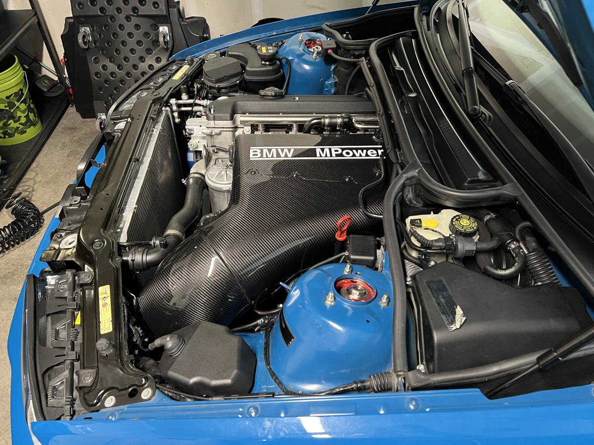

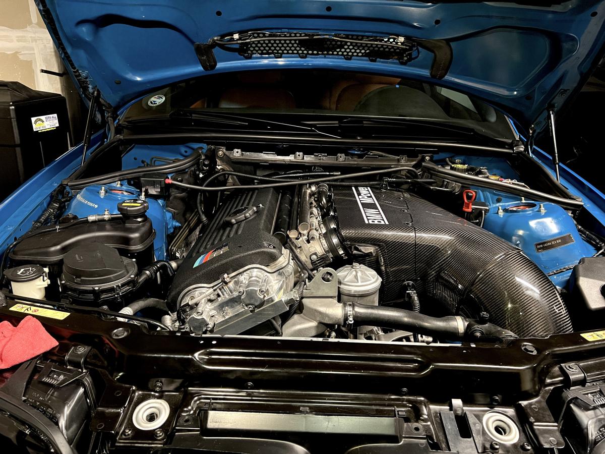

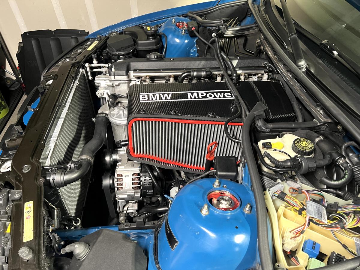

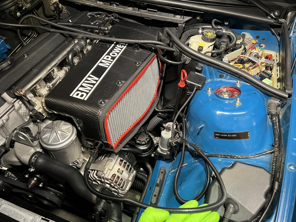

                            After fitting the second half of the intake. Starting to get excited. The airbox also came with the csl air shutoff valve fitting and extended crankcase hose.
                            Click image for larger version  Name:	IMG_3517.jpg Views:	0 Size:	217.3 KB ID:	320240​
                            I was amped to get this running. Based on positive feedback I went with the Bry5on tune. TLDR, no regrets. Do it and don't look back. More on this later.
                            Click image for larger version  Name:	IMG_3527.jpg Views:	0 Size:	97.0 KB ID:	320241​
                            Some close to final shots after firing it up and making sure everything runs.
                            Click image for larger version  Name:	IMG_3531.jpg Views:	0 Size:	210.4 KB ID:	320242

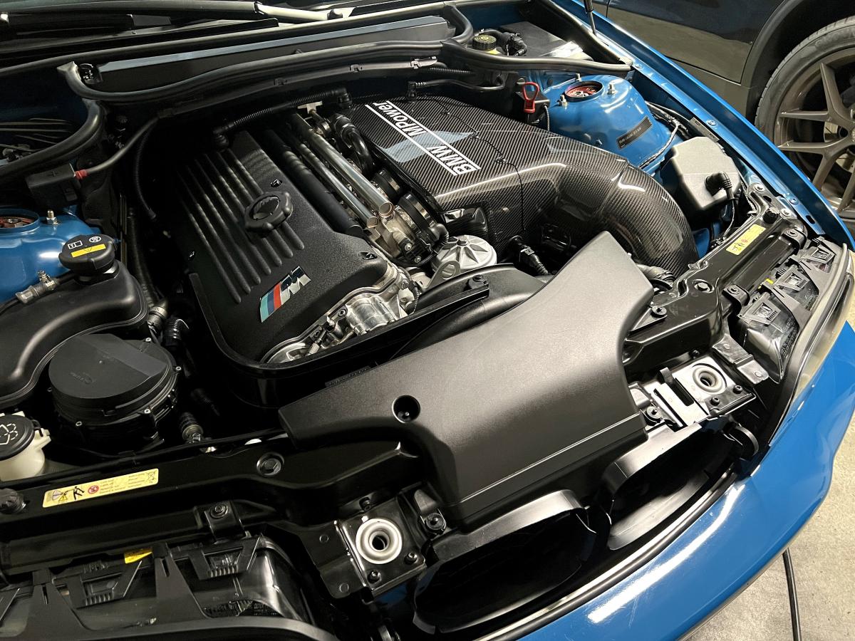

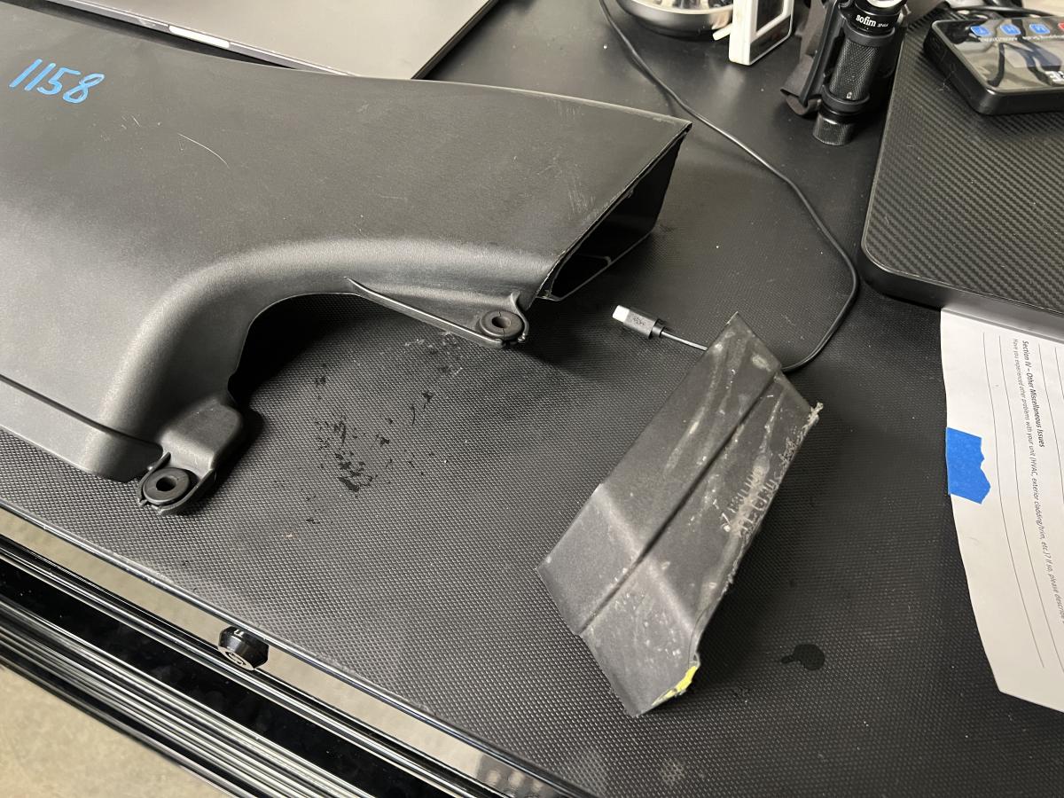

                            If you noticed the air duct panel that connects to the stock intake is missing. I had an idea to make things more CSL like. I picked up an extra panel and trimmed away the extended part that's no longer needed.
                            Click image for larger version  Name:	IMG_3709.jpg Views:	0 Size:	204.2 KB ID:	320244​
                            After more filing and some trim black solution now everything is buttoned up and looking how I want. I did intentionally remove the drive side shroud. The CSL omits it(due to the snorkel iirc), and I despise the part. Classic troll move by the BMW engineers to route the cooling hose through it.
