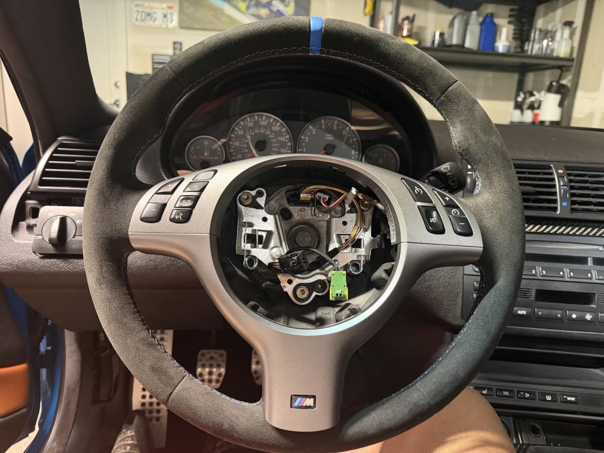

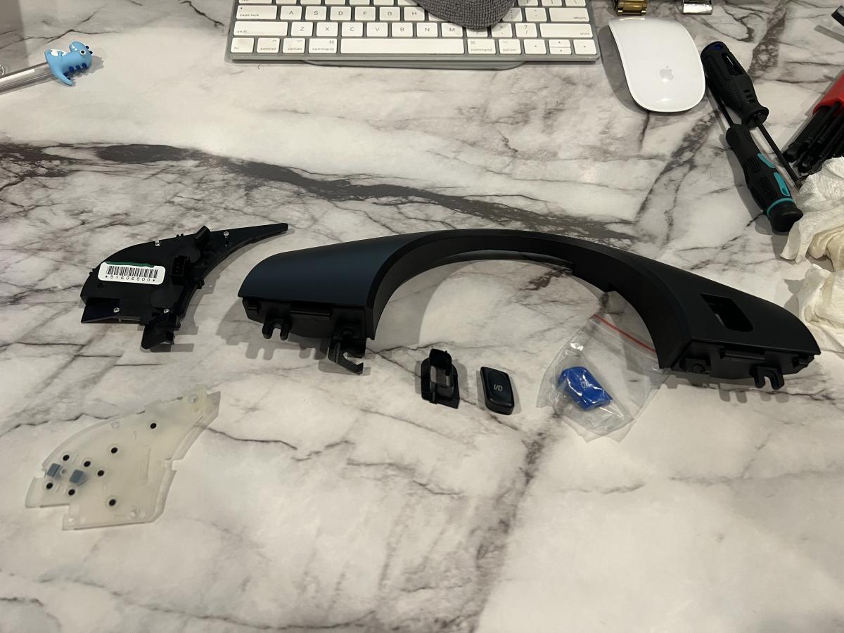

              ZCP steering wheel trim retrofit
              The titan grey steering wheel was part of the plan to go with black interior. As I switched gears to cinnamon, I preferred more black accents to go with it.
              I got a cheap set of beatup zcp trim on ebay and immediately sent it out to our trusty TexaZ3 for refinishing.

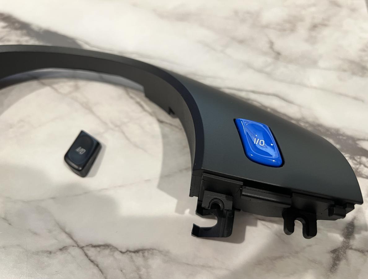

              Removing and assembling the NOS button.
              Click image for larger version  Name:	IMG_4405.jpg Views:	12 Size:	119.9 KB ID:	346673​
              Ebay special
              Click image for larger version  Name:	IMG_4408.jpg Views:	12 Size:	64.7 KB ID:	346676​
              Nice!
              Click image for larger version  Name:	IMG_4412.jpg Views:	12 Size:	91.3 KB ID:	346677
              The nice thing is I don't have to pull the steering wheel. Just unplug the battery, wait 30mins, then pull the airbag. The trim can then be removed. A look at the old, which I'll keep around if things change.
              Click image for larger version  Name:	IMG_0456.jpg Views:	12 Size:	159.0 KB ID:	346674​

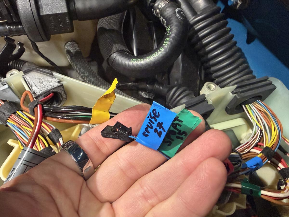

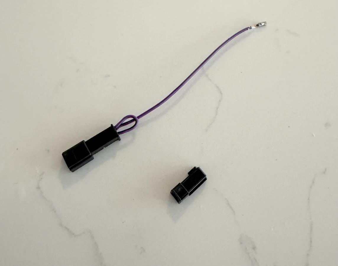

              Now the tricky part. Wiring this up was a bit of a brain exercise. So heinzboehmer was gracious as always to help me problem solve a perfect solution. The reason for the added difficulty is I wanted to avoid splicing into factory wiring.
              The TLDR of the solution:
              Tap into the sport button ground at the DME side into the cruise control ground. To avoid splicing anything, you can simply use a Y connector harness solution as shown. So to be clear if you were splicing you would depin the cruise control wire from the dme, then splice it into the sport button wire at the dme.
              ​The harness is simply to avoid splicing, acting as a y connector.
              Click image for larger version  Name:	IMG_0601.jpg Views:	12 Size:	40.2 KB ID:	346675​
              Click image for larger version  Name:	IMG_0621.jpg Views:	12 Size:	148.0 KB ID:	346678​
              Click image for larger version  Name:	IMG_0628.jpg Views:	12 Size:	146.1 KB ID:	346679

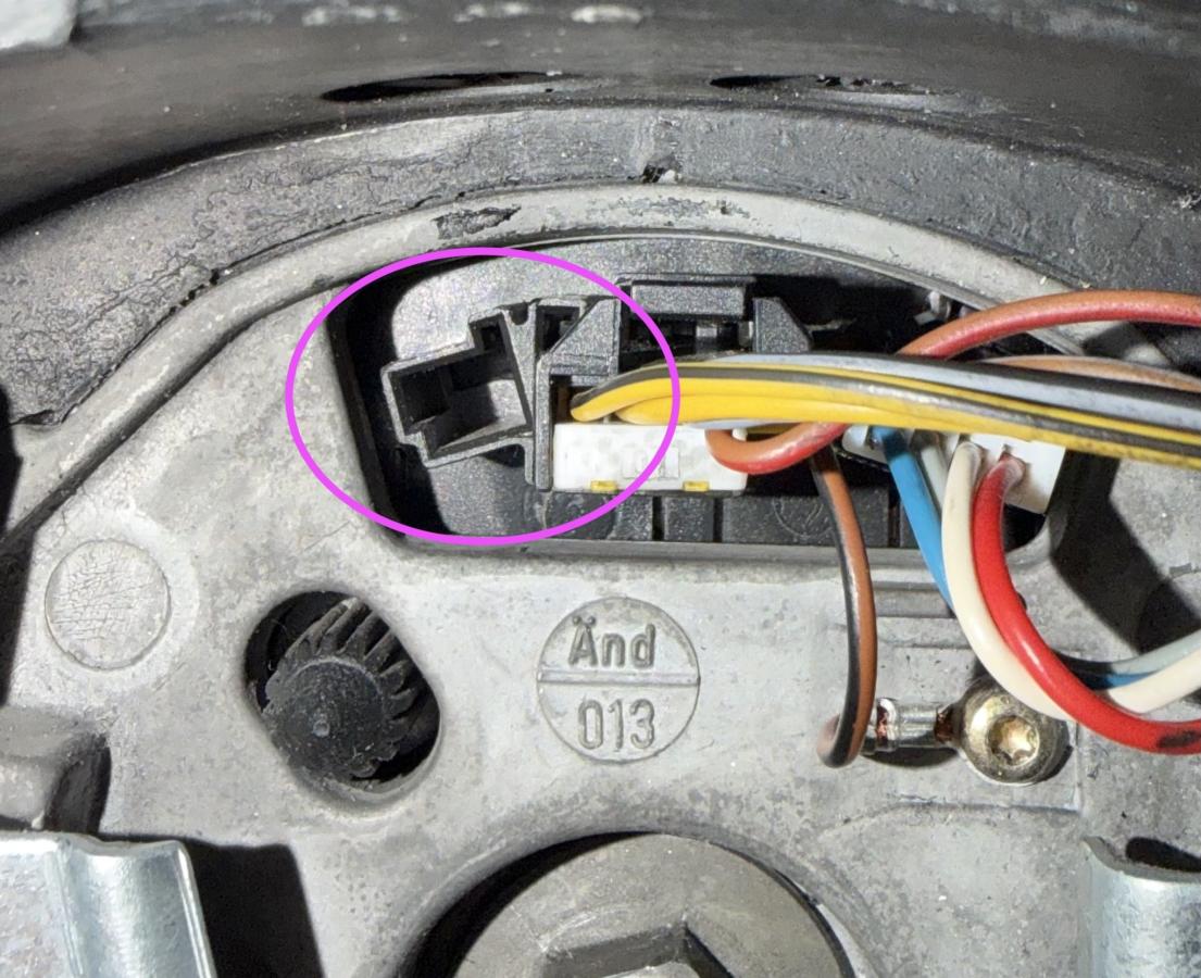

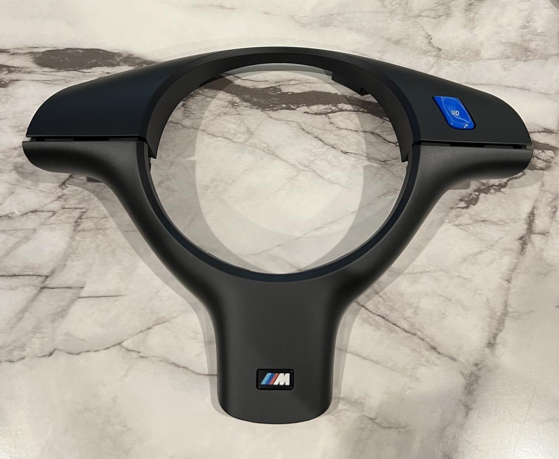

              Just for reference - For non-smg cars, another solution is you could splice into the control center sport button ground(or any button you wish to activate with the i/o button), and the run a wire into the empty slot in the clock spring. This is a reasonable and easy solution, but if you have an early model like mine, the slot is actually blank with no pins!
              All other models should use the same clock spring for cars that have smg or manual, but only smg cars will utilize it for the paddles I believe.
              Click image for larger version  Name:	IMG_0481.jpg Views:	12 Size:	155.4 KB ID:	346680​
              Looking good!
              Click image for larger version  Name:	IMG_0496.jpg Views:	13 Size:	104.1 KB ID:	346681​

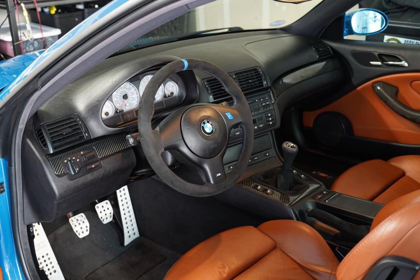

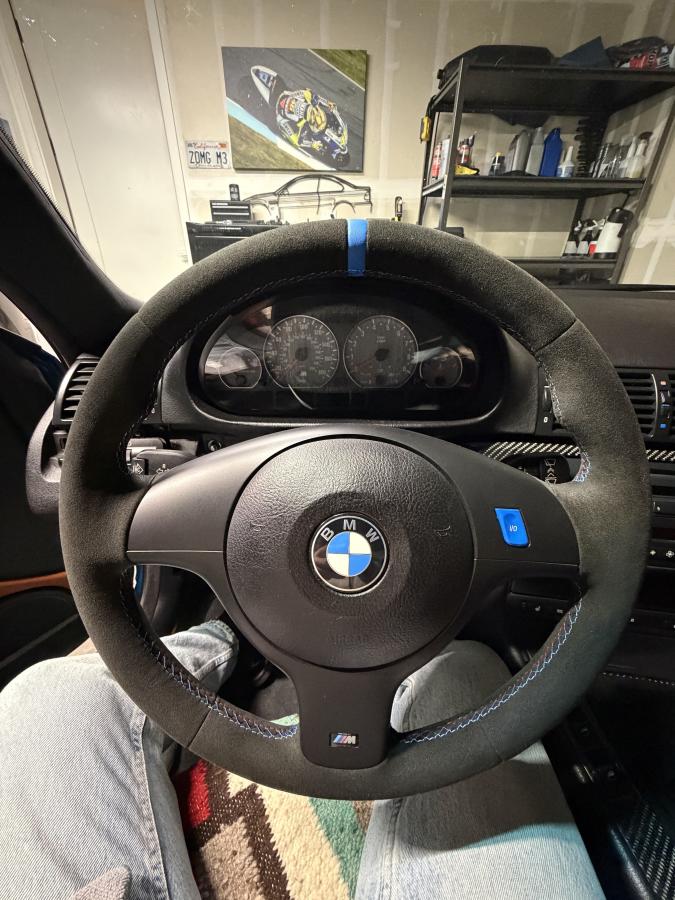

              Everything works great. Now when I want a big NOS power boost I have it at the tip of my fingers. In all seriousness, hope this helps non-zcp folks that also want to wire their i/o button to something.
              The one caveat to this is you won't have cruise control(well obviously since I won't have the button controls anymore), and if I did the Z4 stalk retrofit I would need to run another wire from the clock spring to the DME (no big deal). For whatever reason I rarely touch cruise control, even on road trips. On this vehicle cruise control would be used 0% of the time, so I'll opt to not do the retrofit.
              A couple more shots with my cam even though the forum butchers quality.

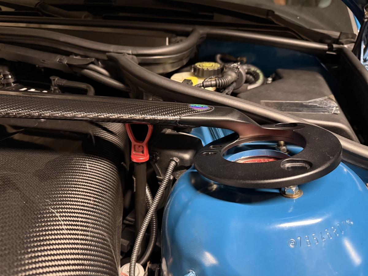

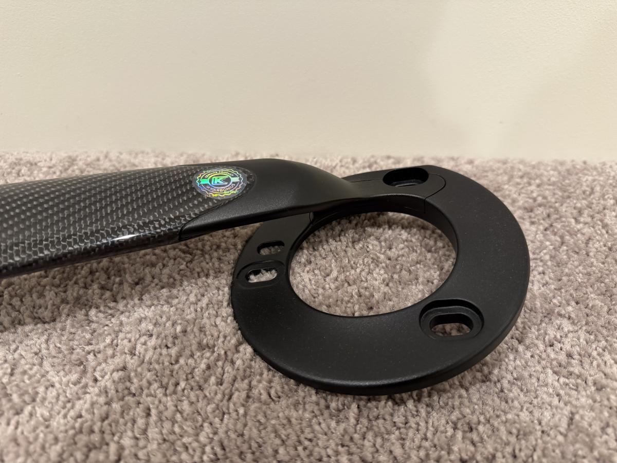

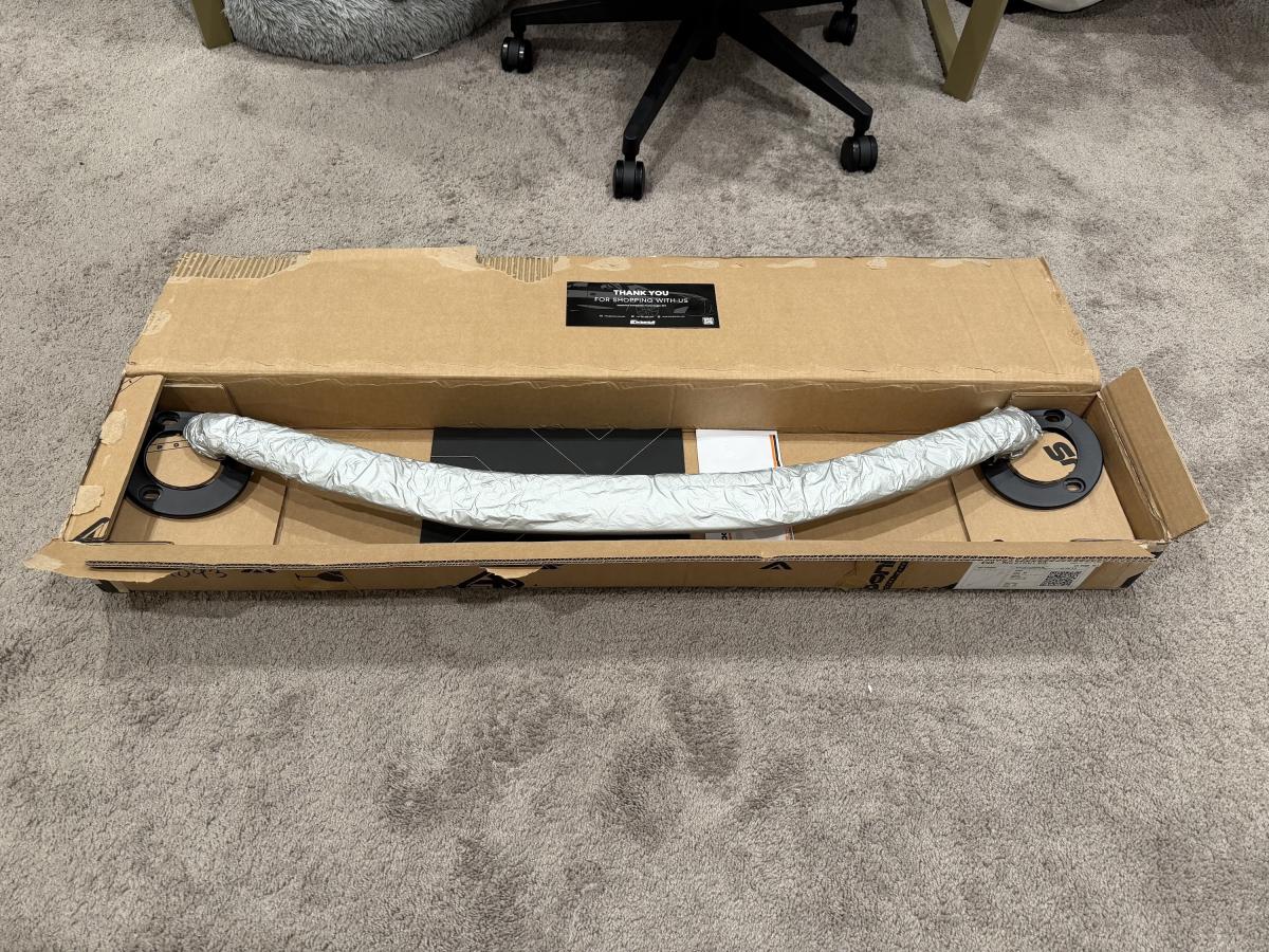

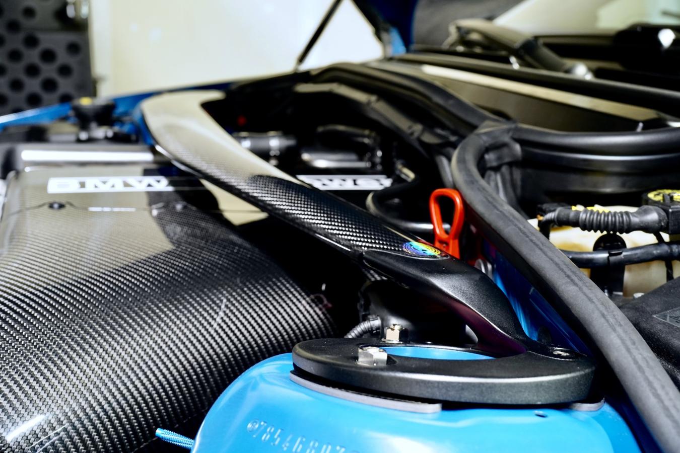

                          Strut brace install

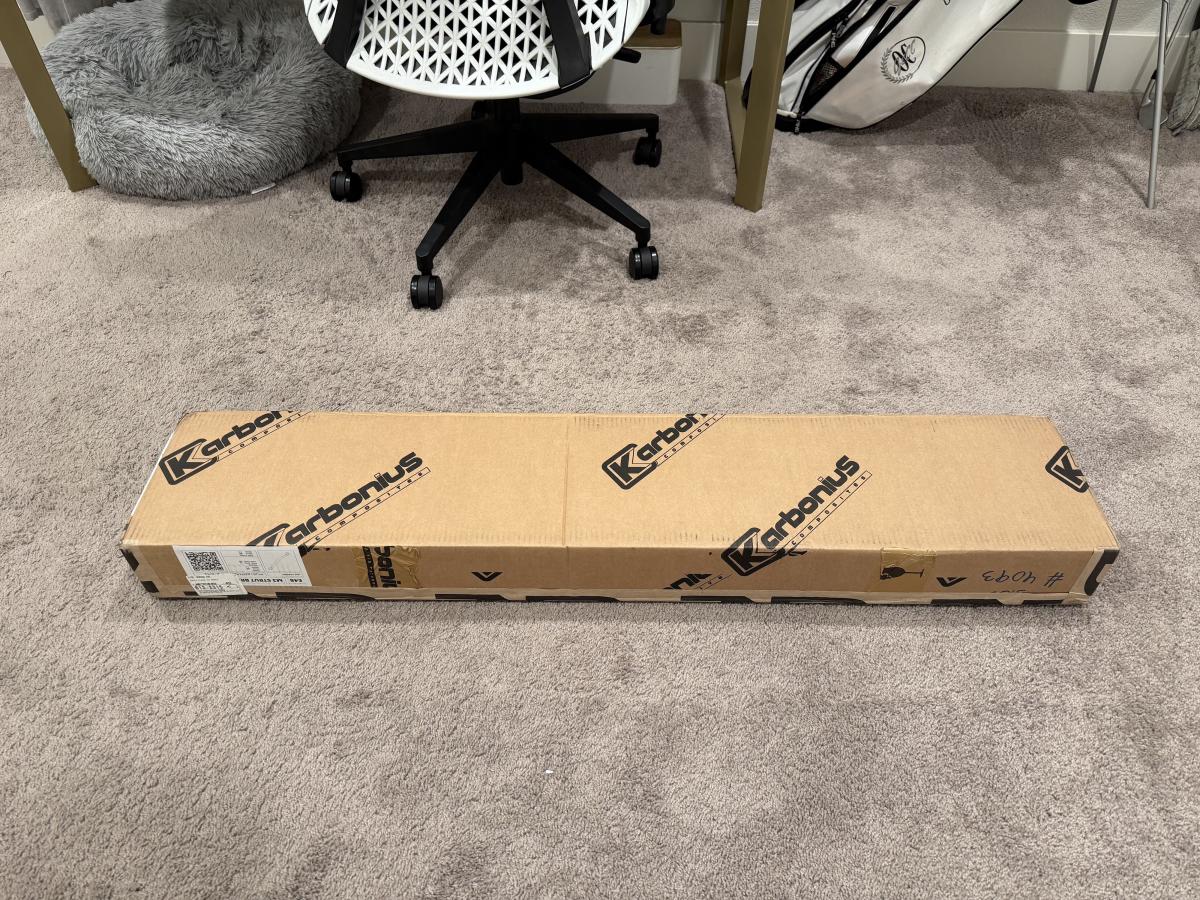

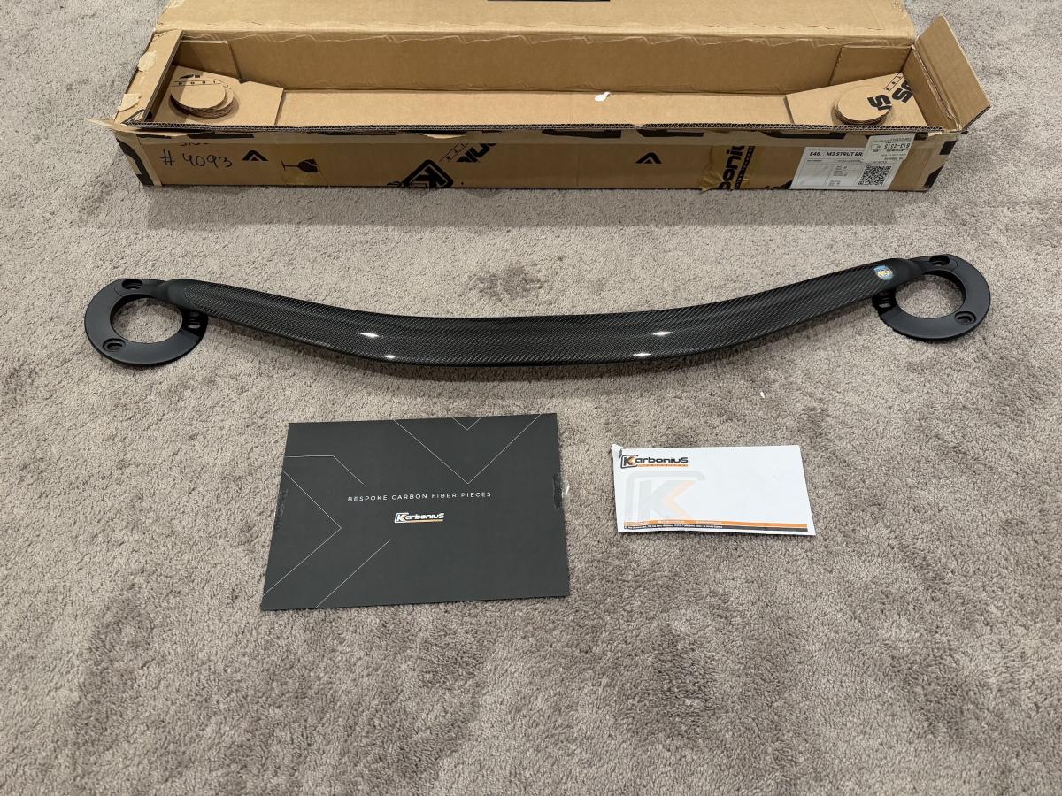

                          Given that I have an early 2001 model, these actually came without a front strut brace from the factory. This left some structural rigidity on the table. I wasn't expecting this to transform the handling obviously, but I have seen some folks with cracks in the surrounding areas of the chassis due to not running one.
                          I thought about a bunch of options, ultimately ruling it down to the Karbonius, and Slon triangulating brace. I actually found a Slon second-hand for a price I could stomach, but it turns out due to the early model bumpy strut towers Slon has a different design for these models. I figured with Heinz refining his design perhaps down the road we'll have a more plug and play consumer ready solution, or maybe a more accessible tuner(than Slon) will come out with their solution.
                          So I went with the Karbonius, while I got it on sale it's still an excessive amount to pay for a strut brace. Unboxing:
                          Click image for larger version  Name:	IMG_0512.jpg Views:	0 Size:	263.9 KB ID:	353443​
                          Click image for larger version  Name:	IMG_0513.jpg Views:	0 Size:	269.0 KB ID:	353442​
                          I had to wait a a month IIRC as I wanted it with the black mounts...

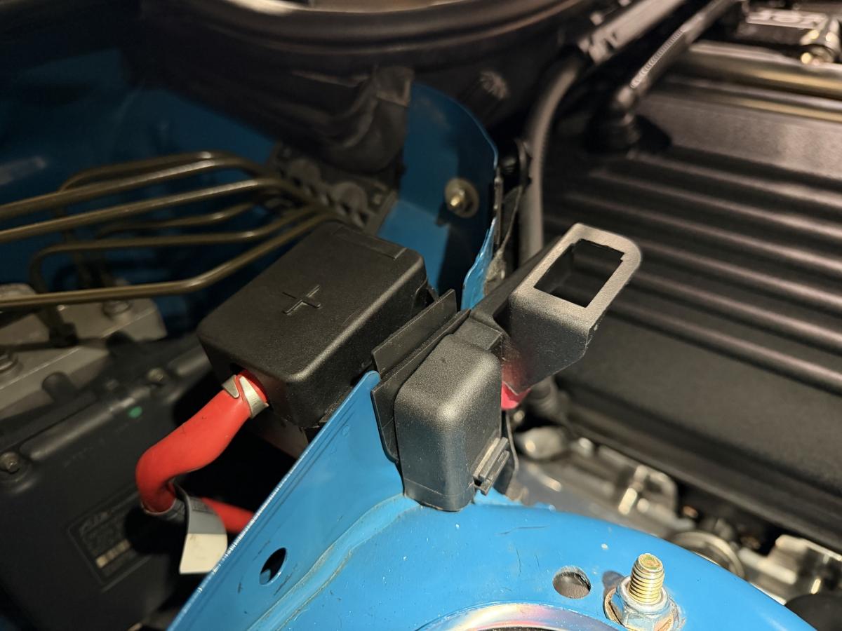

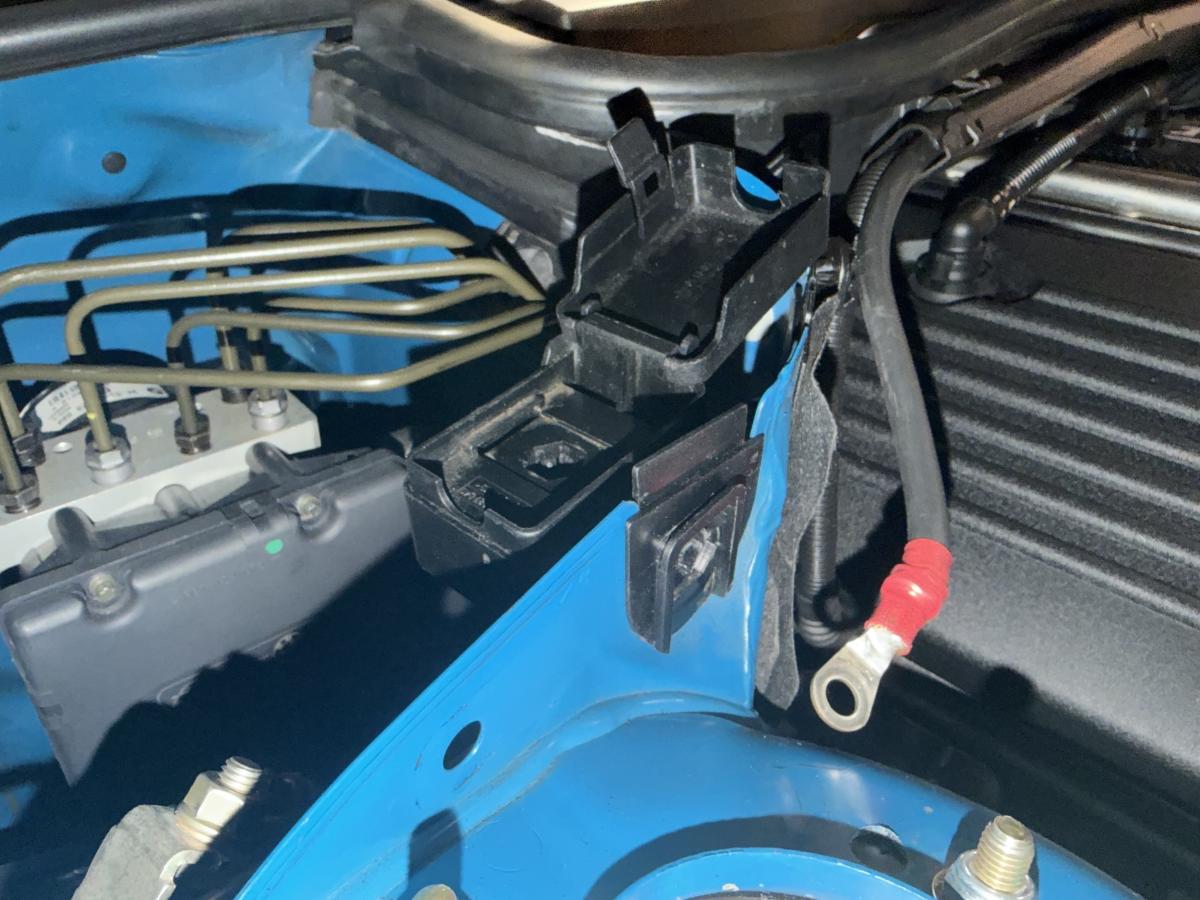

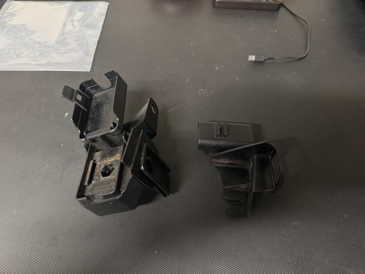

                          First you have to pull the positive terminal housing and hood sensor off. TLDR these get in the way and need to be basically rotated to opposite sides.​
                          Click image for larger version  Name:	IMG_0531.jpg Views:	0 Size:	135.2 KB ID:	353446​

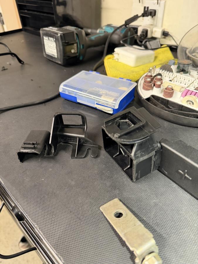

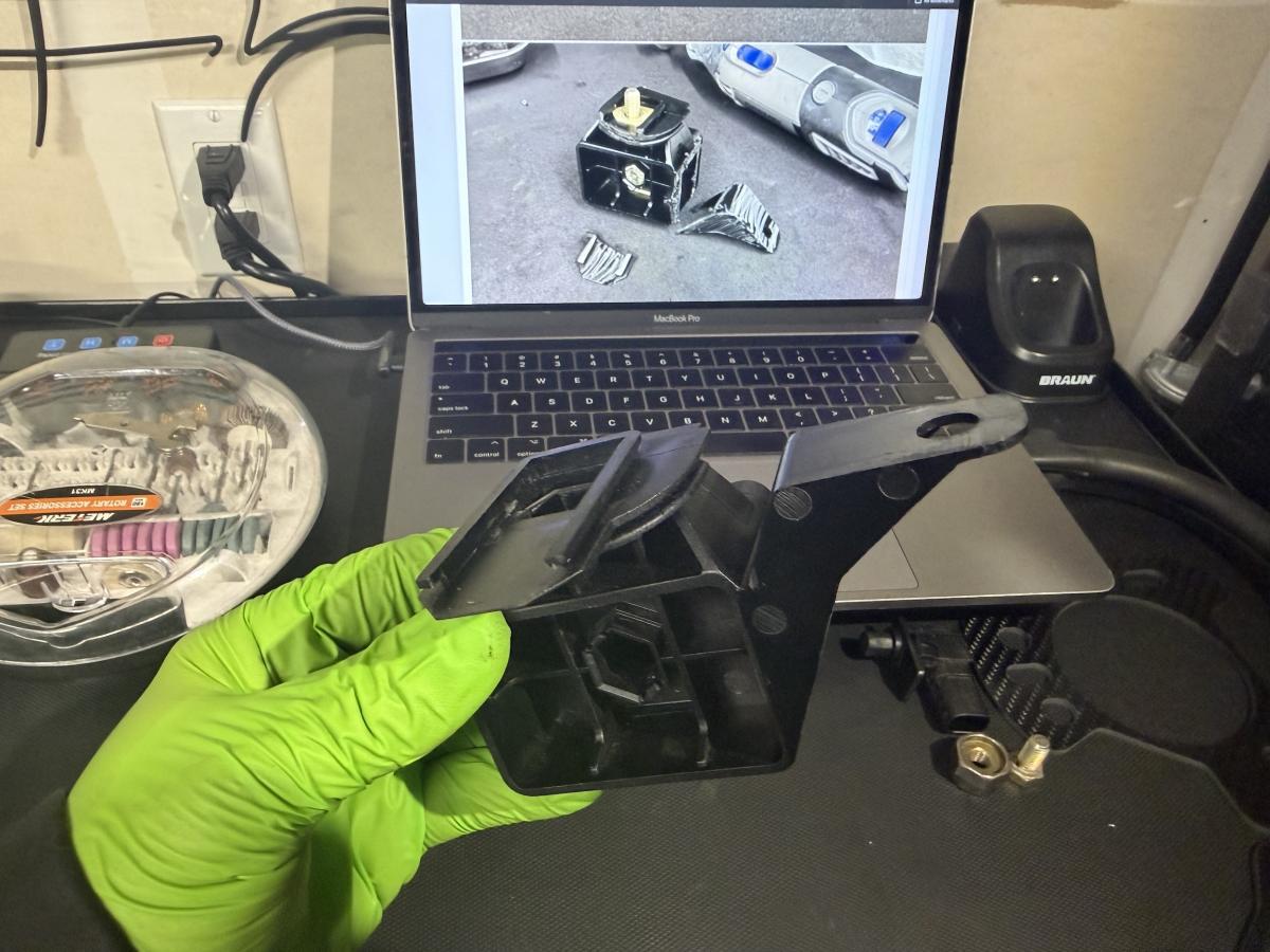

                          In order to rotate them they have to be modified. Me figuring out how the heck to cook this thing with Avedis journal as a guide.
                          Click image for larger version  Name:	IMG_0533.jpg Views:	0 Size:	134.4 KB ID:	353445​
                          After repeating dremeling and test fitting you get something like this:
                          Click image for larger version  Name:	IMG_0539.jpg Views:	0 Size:	109.2 KB ID:	353447​
                          You can then slide it on so it fits on the drug big side.
                          Click image for larger version  Name:	IMG_0535.jpg Views:	0 Size:	131.3 KB ID:	353448​
                          Click image for larger version  Name:	IMG_0543.jpg Views:	0 Size:	100.2 KB ID:	353449​

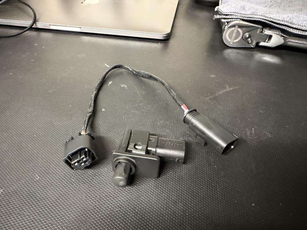

                          Then you have to extend the hood sensor, to avoid cutting into the factory wiring I just created a harness:
                          Click image for larger version  Name:	IMG_1163.jpg Views:	0 Size:	181.3 KB ID:	353450​

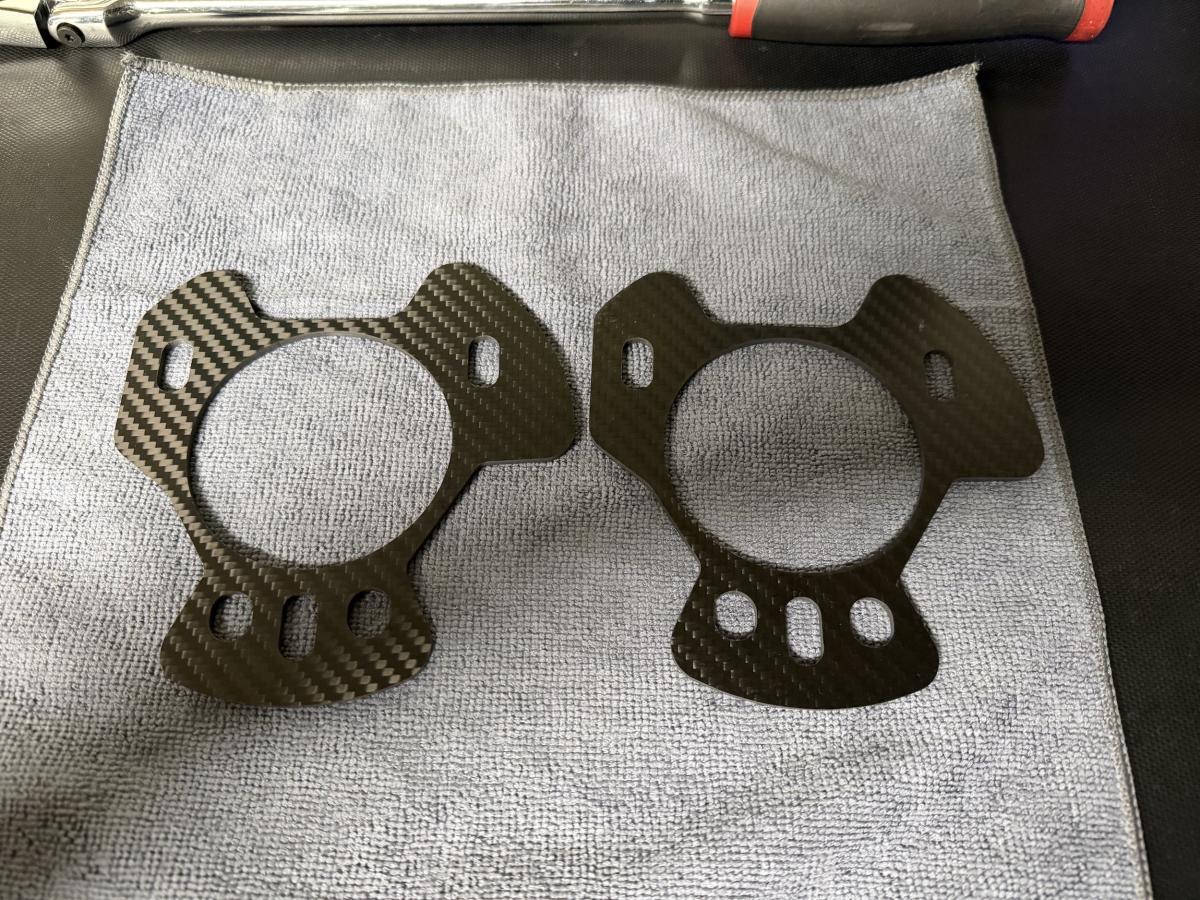

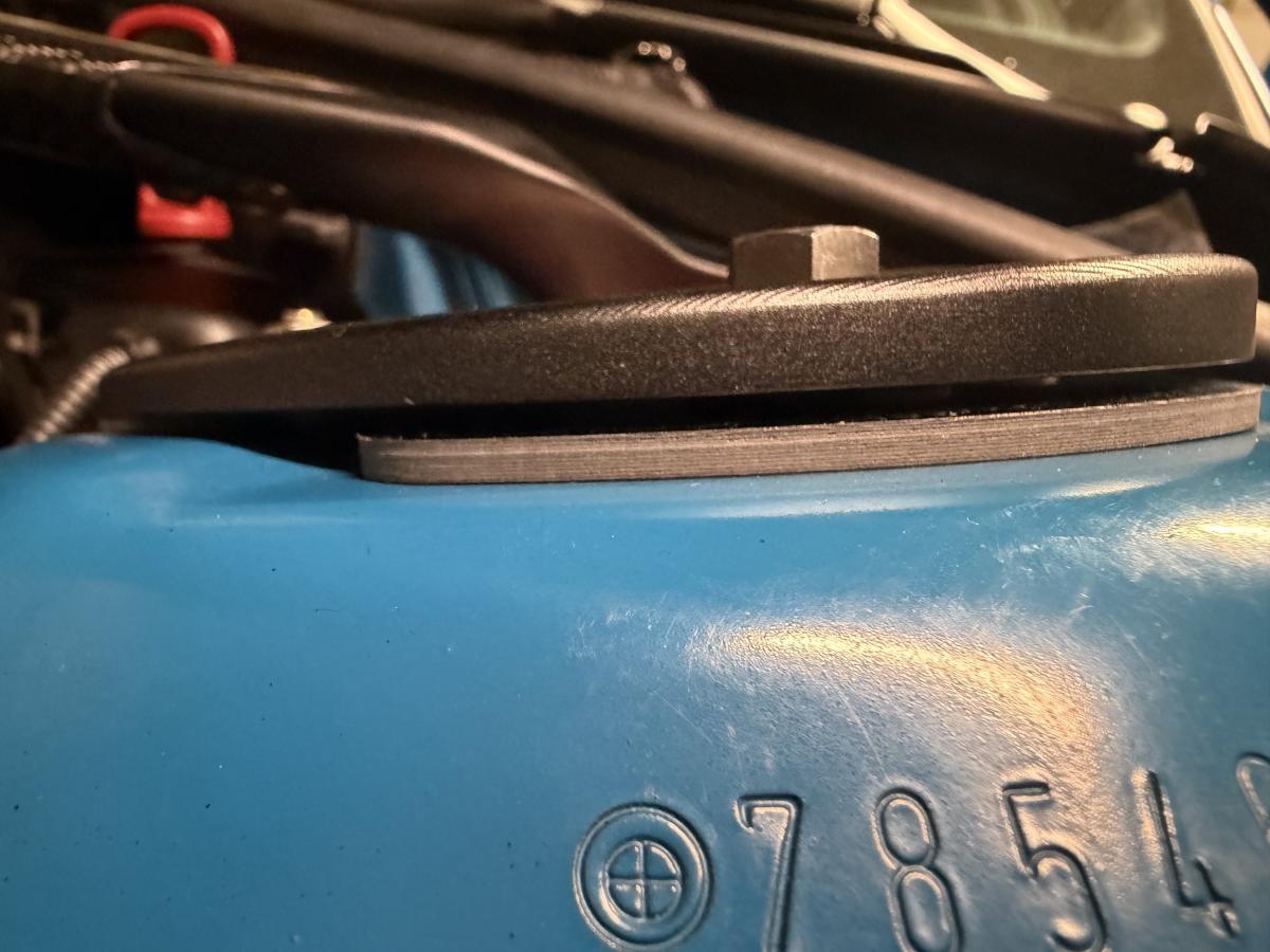

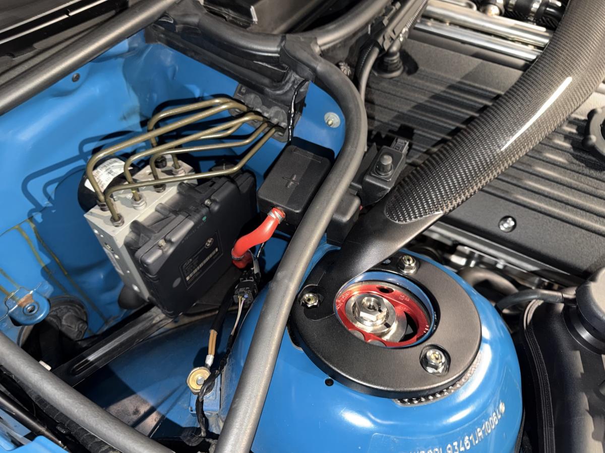

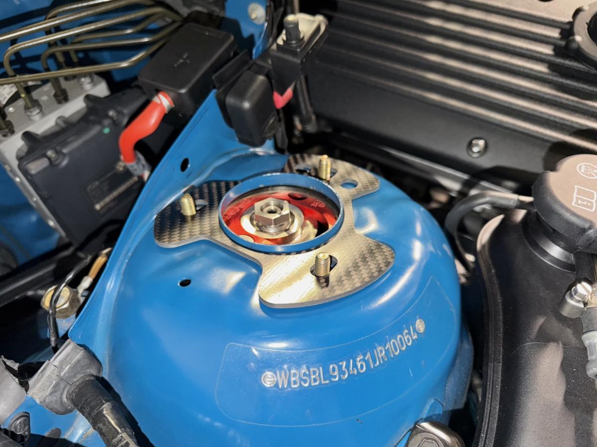

                          More fun things to worry about. As mentioned early MY's have bumpy strut towers. This creates an uneven surface causing a mounting problem for strut braces.
                          To solve for this, I used Rogue's strut tower spacers. These had an added benefit as they protect the paint and spread the load out at the mounting points.
                          Click image for larger version  Name:	IMG_0556.jpg Views:	0 Size:	253.7 KB ID:	353451
                          Click image for larger version  Name:	IMG_0560.jpg Views:	0 Size:	132.1 KB ID:	353452​

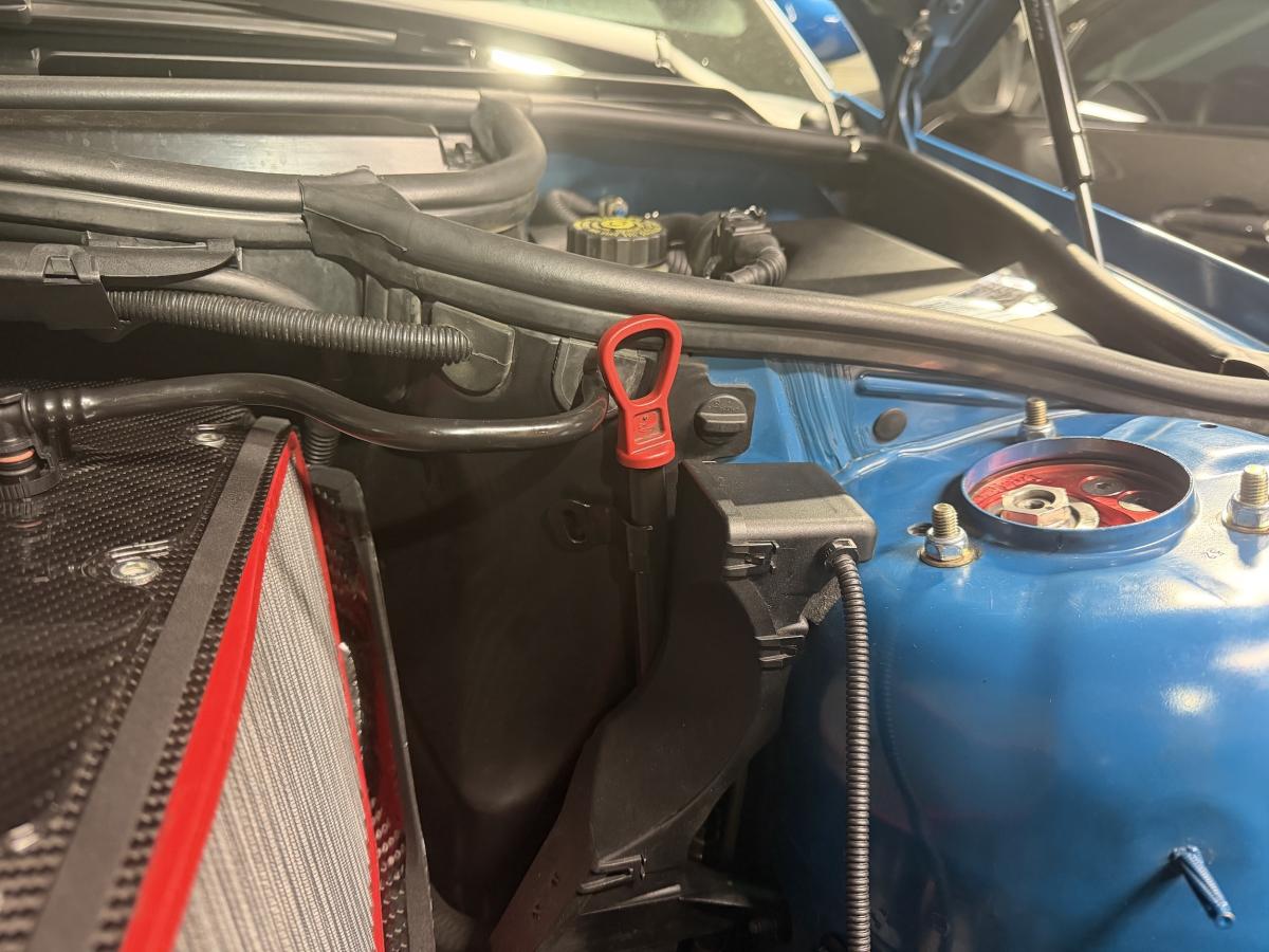

                          Now it's time to install the brace, but wait, more fun. The airbox relocated dipstick now is in the way too!
                          Click image for larger version  Name:	IMG_0562.jpg Views:	0 Size:	146.1 KB ID:	353453​
                          This was a dilemma as bending it didn't seem to be as easy as it looks with a pipe bender, and I didn't want to modify the part if it's not needed.
                          Off came the intake half, and here's where I ended up with. It's not perfect as there's some slight stress near the dipstick pull.
                          Click image for larger version  Name:	IMG_0572.jpg Views:	0 Size:	133.2 KB ID:	353454​

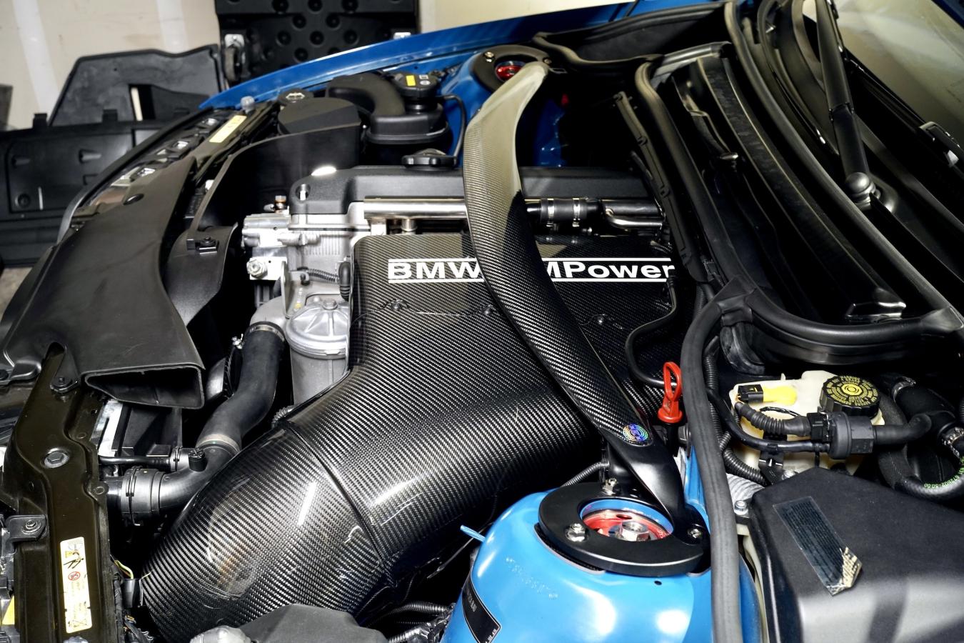

                          Alright finally room has been made and it can be installed.
                          The camber plate studs barely have enough threads after the reinforcement plates(on top the camber plates) and rogue spacers.
                          Click image for larger version  Name:	IMG_1164.jpg Views:	0 Size:	162.7 KB ID:	353455​
                          Later on I'll improve this by trimming space from the spacers around the strut braces mounting feet to give this a flush sitting.
                          Click image for larger version  Name:	IMG_0589.jpg Views:	0 Size:	109.9 KB ID:	353456​

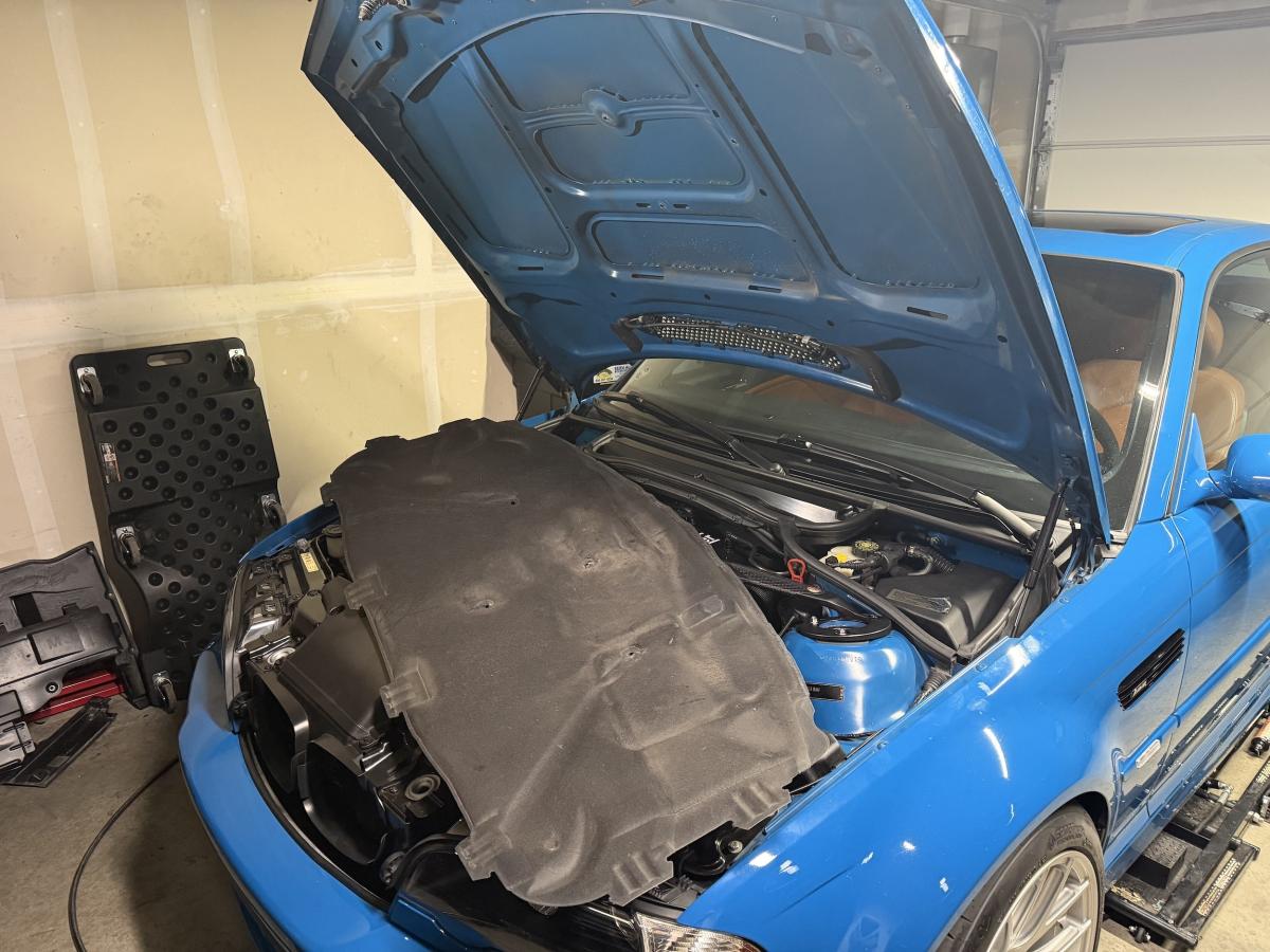

                          Lastly the hood insulation is called to be trimmed to fit the strut brace. I decided to toss it in the storage pile. More intake soundz.
                          Click image for larger version  Name:	IMG_0592.jpg Views:	0 Size:	144.5 KB ID:	353457​

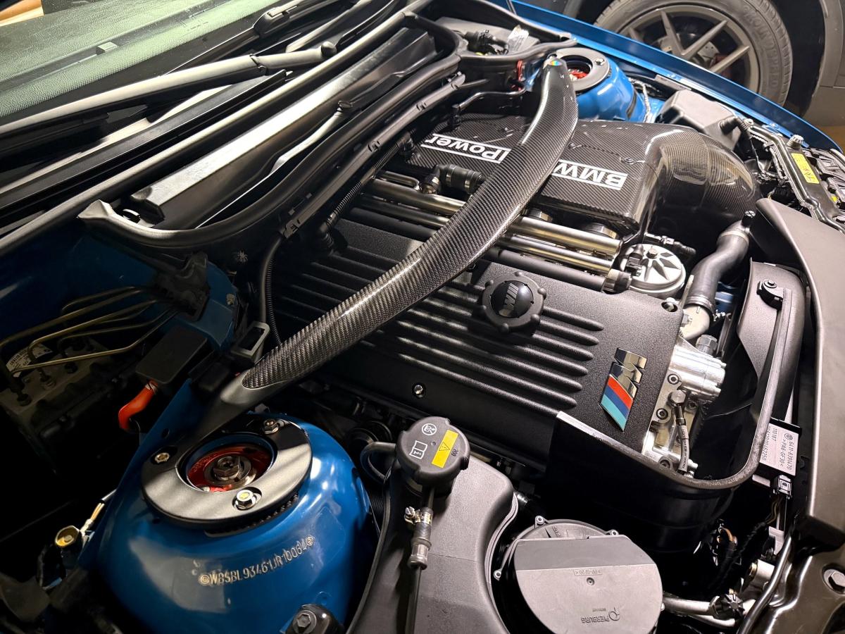

                          Final shots:
                          Click image for larger version  Name:	IMG_0584.jpg Views:	0 Size:	196.8 KB ID:	353460​
                          Click image for larger version  Name:	DSC09529.jpg Views:	0 Size:	163.9 KB ID:	353458​
                          ​Click image for larger version  Name:	DSC09526.jpg Views:	0 Size:	219.9 KB ID:	353459​
                          Oh and some driving impressions. Perhaps in my head, but I noticed an ever so slight increased rigidity. Keep in mind I went from no strut brace ever to this. The engine bay is looking good now.

                            The camber plate studs barely have enough threads after the reinforcement plates(on top the camber plates) and rogue spacers.​
                            Are you using the stock strut bar nuts (51717895241)? They have an extended threaded collar for more thread engagement.
                            Don't think they're necessary here though, looks good as is!
                              Ah nice tip! I wasn't aware of these. Naturally my car came with these: 31316769731.
                              But I'm using the nuts that came with the Karbonius brace. They have a nice finish to them but are standard flanged nuts. The threads go all the way through, but no extra past the top of the nut.

                                And yes that box under there is what ya think. Stay tuned!
