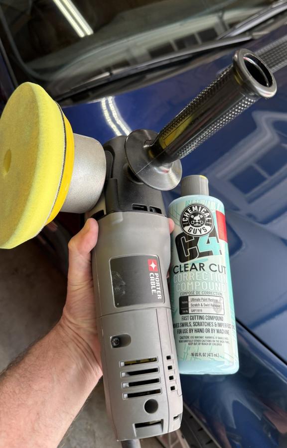

    I enjoy detailing and I can't stand a dirty car, so up first is a minor paint correction. I'm not looking for a show car, but I want the paint glossy and contaminant free. I sprayed the entire car down with Adam's Iron remover, hosed off, and then continued on with a clay bar. Barely made a dent. Which meant it was time for a buff job.
    If you haven't tried harbor freights Grant foam pads then do so. They are $10 each and come in four flavors (white, blue, yellow, black). The foam pads are good quality and one of the few things I routinely buy, plus they aren't going to get me killed. Keeping with the bargain theme since Kevin now has all my money (you're the best Kev), I went to Advance auto parts and lo and behold they had Adam's P4 polish and C4 cut for $1.99 each. So two pads (yellow and black) and some Adams for a grand total of 24 dollars plus tax.
    A $1.99 each and I was impressed, completely useable.

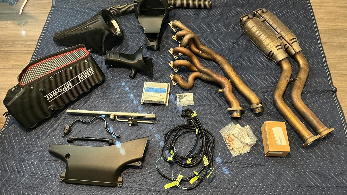

      Looking forward to getting started on all this:

        #33
        Love it. Is the shortened air duct cover just a trimmed standard part? this is what i did with mine, but was curious.

          Very nice! I need some Euro cats LOL

            It's like Christmas. We're all vicariously planning the build

              NOT looking forward to packing and boxing all that up lol
                Yep

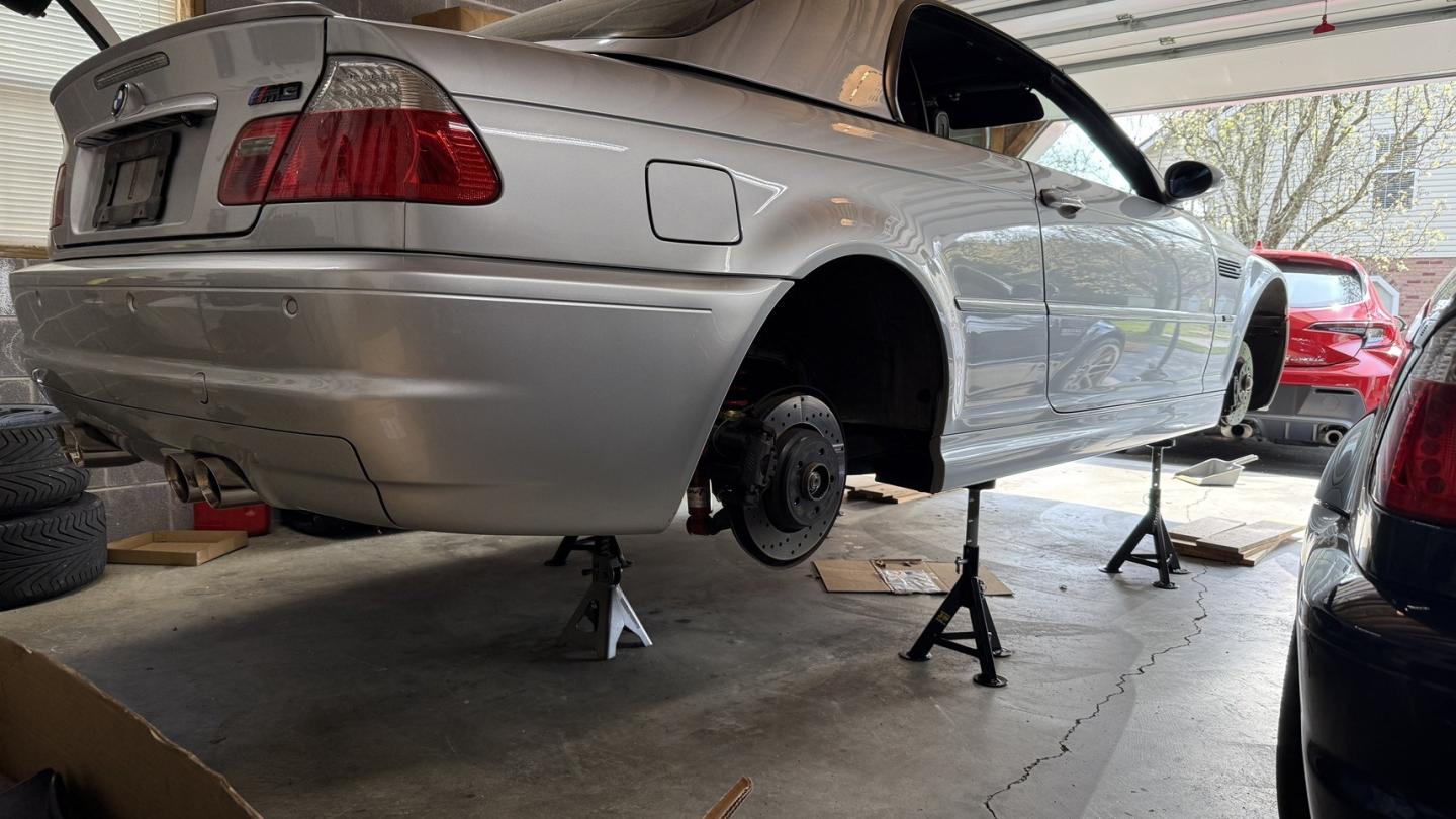

                  Today I begin. Dropping the rear end on the convertible so I can swap the new 3.91 into the coupe. I have quick jacks but I need both cars up in the air for the swap and I forgot what a PITA it is to get a car this high on jack stands.
                  To Do:
                  1. Swap diffs
                  2. Move ARCAs from convertible to coupe.
                  3. Install factory rear control arms on the convertible.
                  4. Remove the CMP subframe bushings from the convertible and put in non raising solid bushings like Turners
                  5. Remove the coilovers from the convertible and install on the coupe (maybe, might go a different direction).
                  6. Install new stock suspension on convertible.
                  7. Remove supercharger from the convertible and return to stock.
                  8. Swap fuel pumps as the convertible's is brand new.
                  9. Inspect bushings and ball joints on the coupe while its up.

                    #39
                    Might want to swap that subframe over rather than hammer out the solid bushings
                      #40
                      You know I'd say that's a reasonable suggestion 🤣

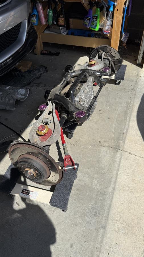

                            Rear end is out.
