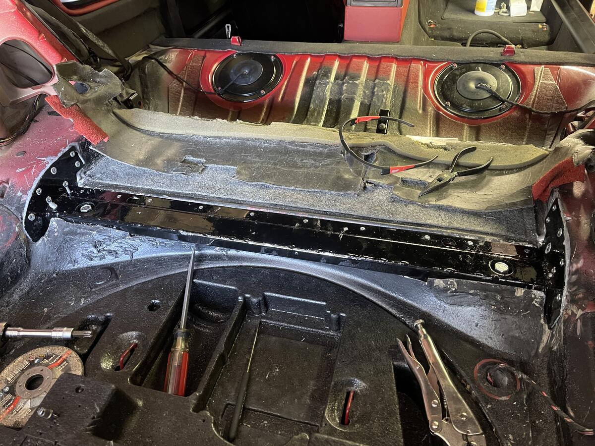

    Scary part of the Vincebar install complete. All glue, rivets, and paint from here.
    Click image for larger version  Name:	IMG_0889.jpg Views:	0 Size:	240.7 KB ID:	89147
    Great job 👍 did mine Vincebar 6 years ago with this glue, rivet method as well, holding up very well up this day no issues after all track day abuse.
      Well, the scary part is done. Just seam sealer, paint, and reassembly to go. Well, and the Slonik plate.

      ^the missing rivet in the first picture was added right after I took the photo.
