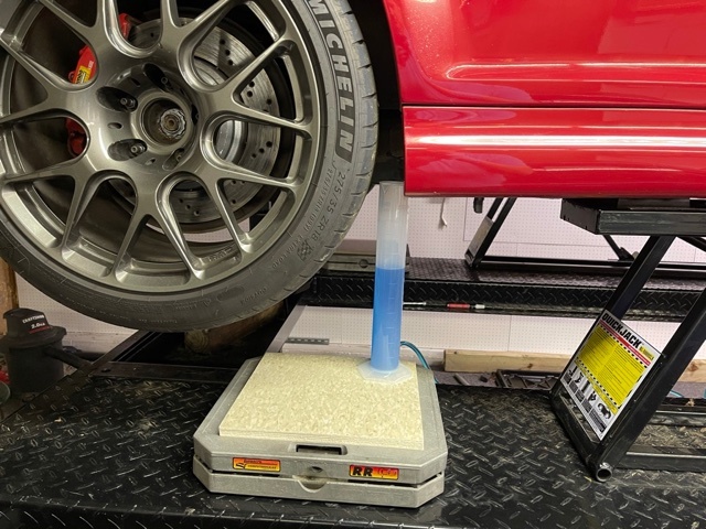

          Leveled the scales:

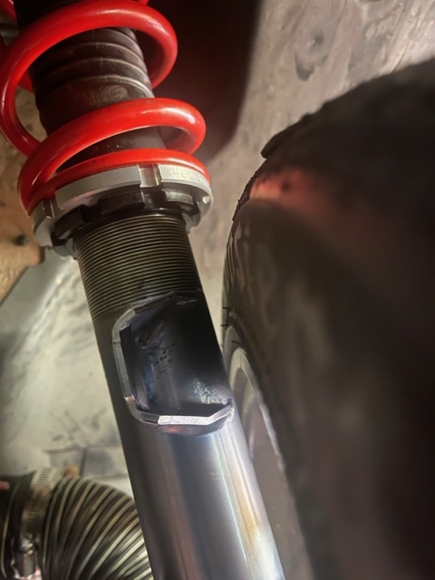

          Installed the Fat Cats suspension, much primary colors:

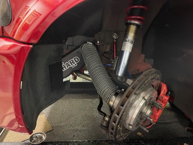

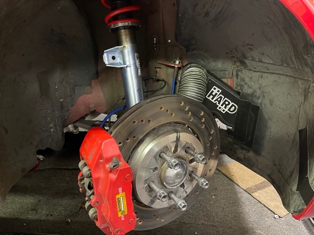

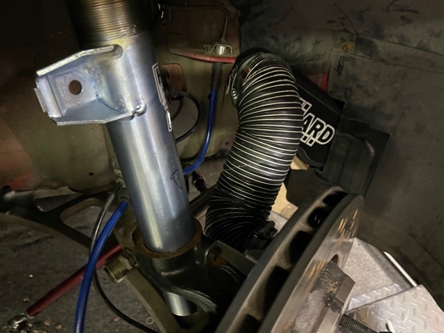

          Installed the final tube of the brake ducting, and confirm it fits without issue in all positions:

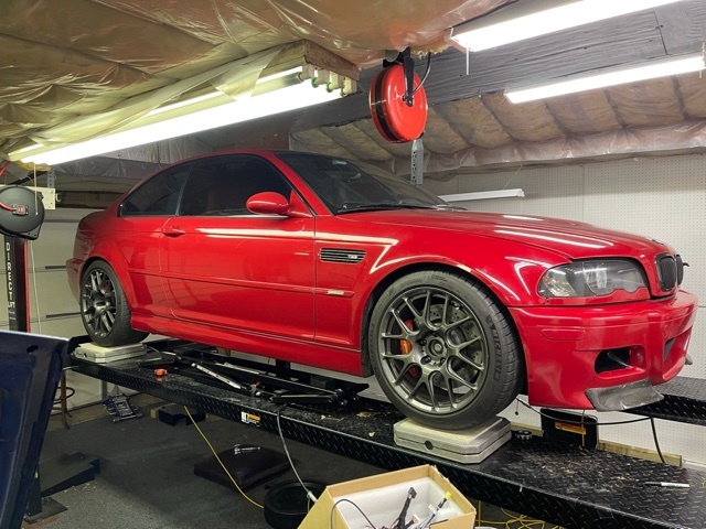

          Aligned and corner balanced the car:

            Can you explain a bit more how you leveled your scales? Mainly, how did you shim to adjust the height and how did you set up the graduated cylinders?
              Originally posted by S14 View Post
              Looking good, I like your brake caliper stickers!
              Ha. The stickers have double purpose-- hide the Porsche logo and tell me the caliper temperatures :P
              I have two graduated cylinders, connected by a tube at the bottom with 1/2" rubber fish tank line. I put water with food coloring (to make it easier to see) in there, and fill them both ~3/4 full. I shim under till both cylinders read the same, at which point I know they're level. I try to figure out which scale is the highest, and then use all the others to compare to that (shimming the others up). Once everything is shimmed up, I zero the scales so they don't contribute to corner weights.
              As shims, I use whatever the cheapest vinyl floor tiles I could find at Home Depot were (IIRC it was like $30 for 100 of them). They're ~1mm thick, so I can get reasonable leveling, and they're slippery-- so when I raise/lower the car, it doesn't get stuck high with the camber curve, and if I, say, adjust camber, I'm not fighting the friction of the tire on the scale-- the floor tiles just slide against each other.
