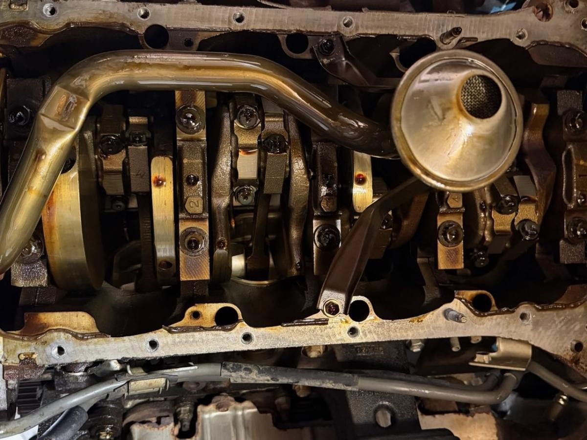

              I drew the line at rod bearings, even though I was staring right at them and it went against my every instinct not to replace them
              (on an engine that people have driven over 1,000,000 miles on without replacing them)

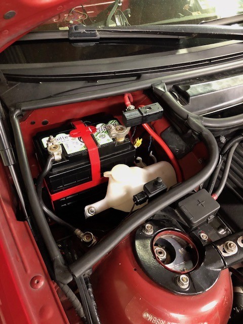

                Not all of these pictures are loading for me, I'm interested in the battery solution you have. I'm cutting out my spare tire tub (e46 sedan) and battery tray. If you could reupload those pictures or drop me a DM with them. Thanks
                  Here you go 332
                  Click image for larger version  Name:	IMG_4147.jpg Views:	0 Size:	95.8 KB ID:	343493
                  Obioban I searched everywhere for what you did exclusively for the battery mod, and remember you posted it once but I can’t find it. Any chance you remember the part numbers and stuff? Thanks!

                      Here you go 332
                      I made them.
                        I'd like to duplicate that mod but I'm curious how small I could go with the battery. What battery are you using? Does it need a tender for a car driven once or twice a week?
                        It seems like an easy and fairly cheap weight loss/$ ratio with the cable delete.
                        2003.5 SG/Grey
                          It’s a braile GU1R— lithium battery that’s 5.X lbs.
                          I’ve been running it (same one) for 11 years now. I plug in the car if I won’t be driving it for >2 weeks. Never had an issue of any sort.
                          In terms of wiring, used the wiring from 4 cylinder e46s, that have the battery there stock.
