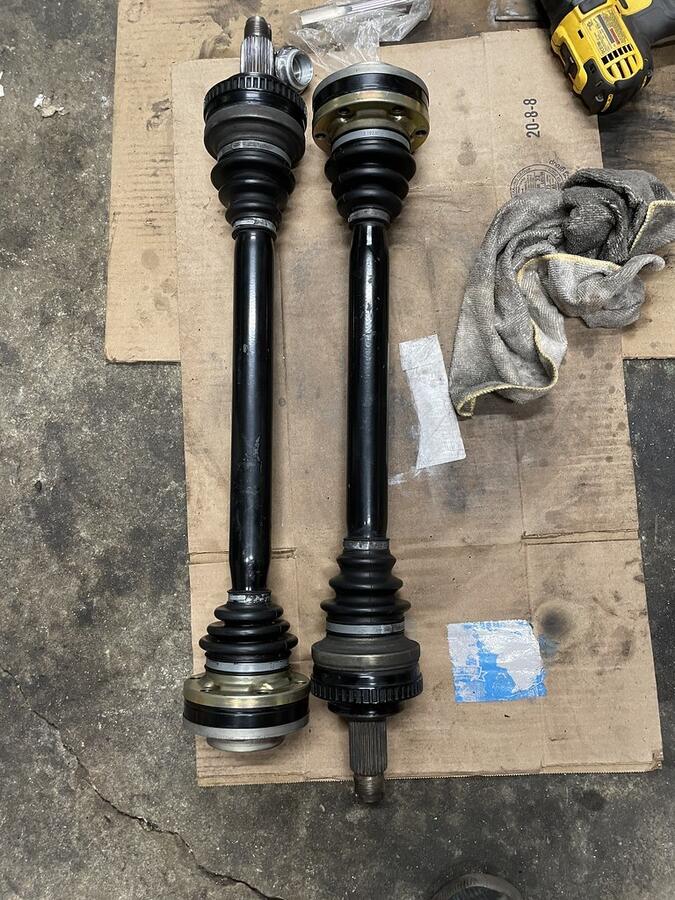

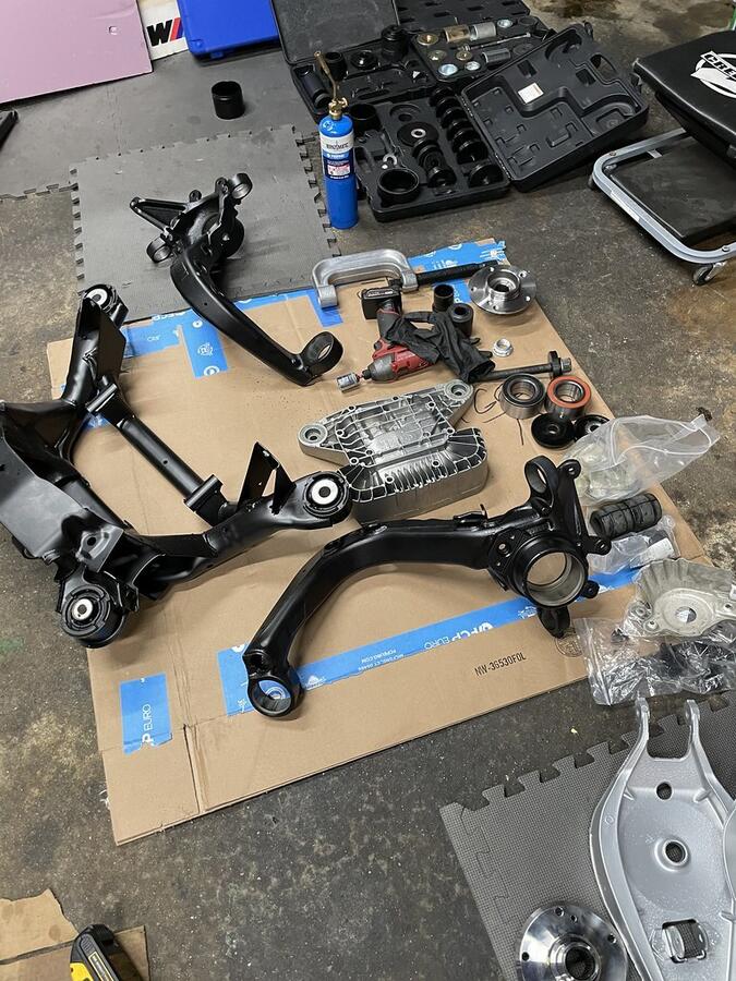

                    I've also started to ramp up prep for my rear sub frame rebuild. I keep waffling on what bushings I want to use. I do not want to add any NVH but I can also tell a lot of difference between this car and my silver track car. So looking for a happy medium. Currently my plan is the following:
                    • Rear Trailing Arms - Turner Motorsport Sealed Monoball (Currently installed and love them)
                    • Outer Control Arms - Rogue Engineering Bearing (These are installed on my track car for last 5 years no issues and no NVH)
                    • Inner Control Arms - Rogue Engineering Bearing (These are installed on my track car for last 5 years no issues and no NVH. Additional bonus, they can be torqued down while not at ride height which means I can assemble the sub frame off the car)
                    • Sub Frame Mounts - OE (alternative would be solid or Ply 95A but lot of conflicting info on NVH...)
                    • Diff Mounts - OE (will match sub frame)
                    I have a spare set of half shafts so I can pretty much build the entire subframe in advance and just swap in the diff! Going to replace the boots on the half shafts as well as the hubs and wheel bearings. I'm also going to try treating the hubs with black oxide to fight rust.

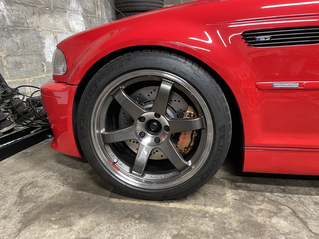

                    Plus another pick of the brakes just 'cuase I like looking at them

                                Hi Rob,
                                Just curious…
                                Do the Inner and Outer RE Bearings create a significantly harder Ride Quality?
                                I’m currently using Powerflex Black Series Bushings (95A hardness).
                                I was thinking of going to new OEM ball joints which are now prescribed in this area, however I was always curious on the RE bearings for use on a street car, especially with our harsher winters for street driving.
                                Also, How often do you have to service the bearings?
                                Thanks in advance for your feedback!
