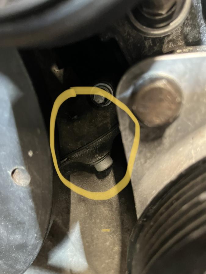

      Pro tip. I stripped the threads for an oil pan bolt that goes into the bottom of the front timing cover. I was about to throw on another cover and found that the hole is NOT a blind hole. In goes a slightly longer bolt!

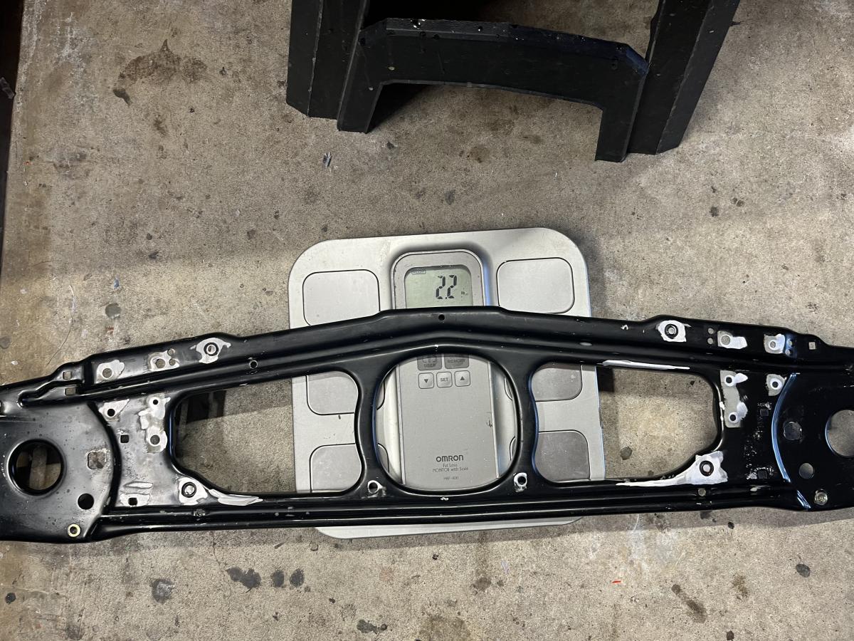

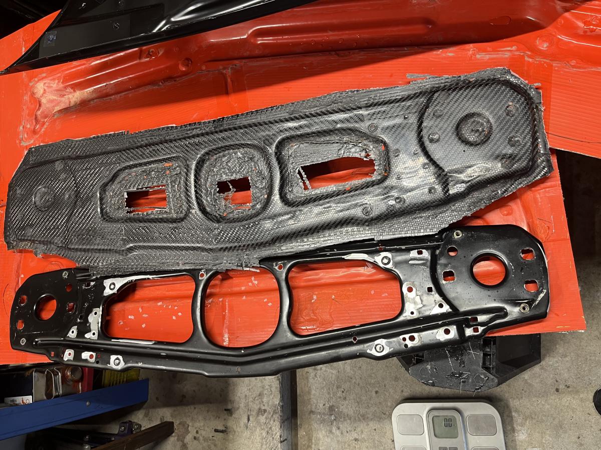

        I need to get as much weight off the front end as possible. I’ve been looking at ways to improve oil cooling while using a smaller cooler.
        I think I’m going to mount my secondary cooler on the back of the radiator. It should warm up the oil quicker so I can delete the external thermostat and provide more efficient air flow than my current setup.

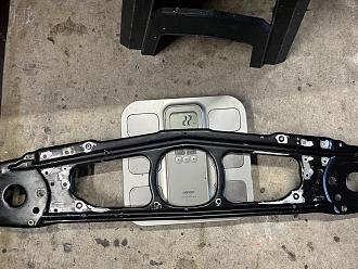

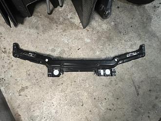

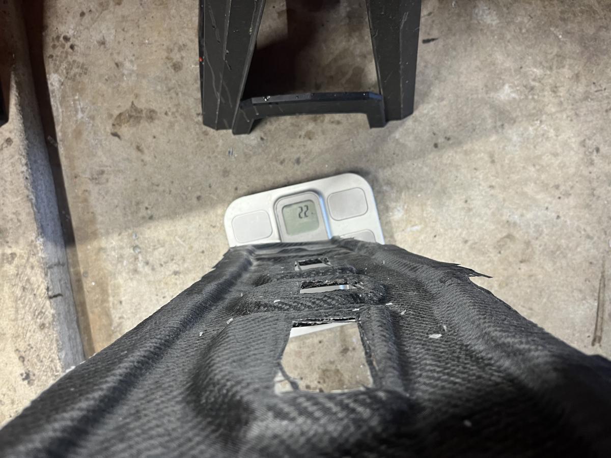

        With everything apart and brainstorming…I came up with the idea to make the front crossmember out of….drumroll…carbon fiber. I can cut about 2-3lbs.

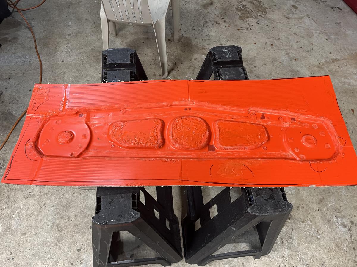

        The lower mold is complete…

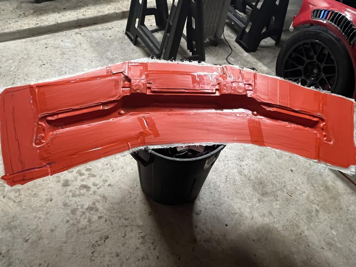

          Working on the upper half.

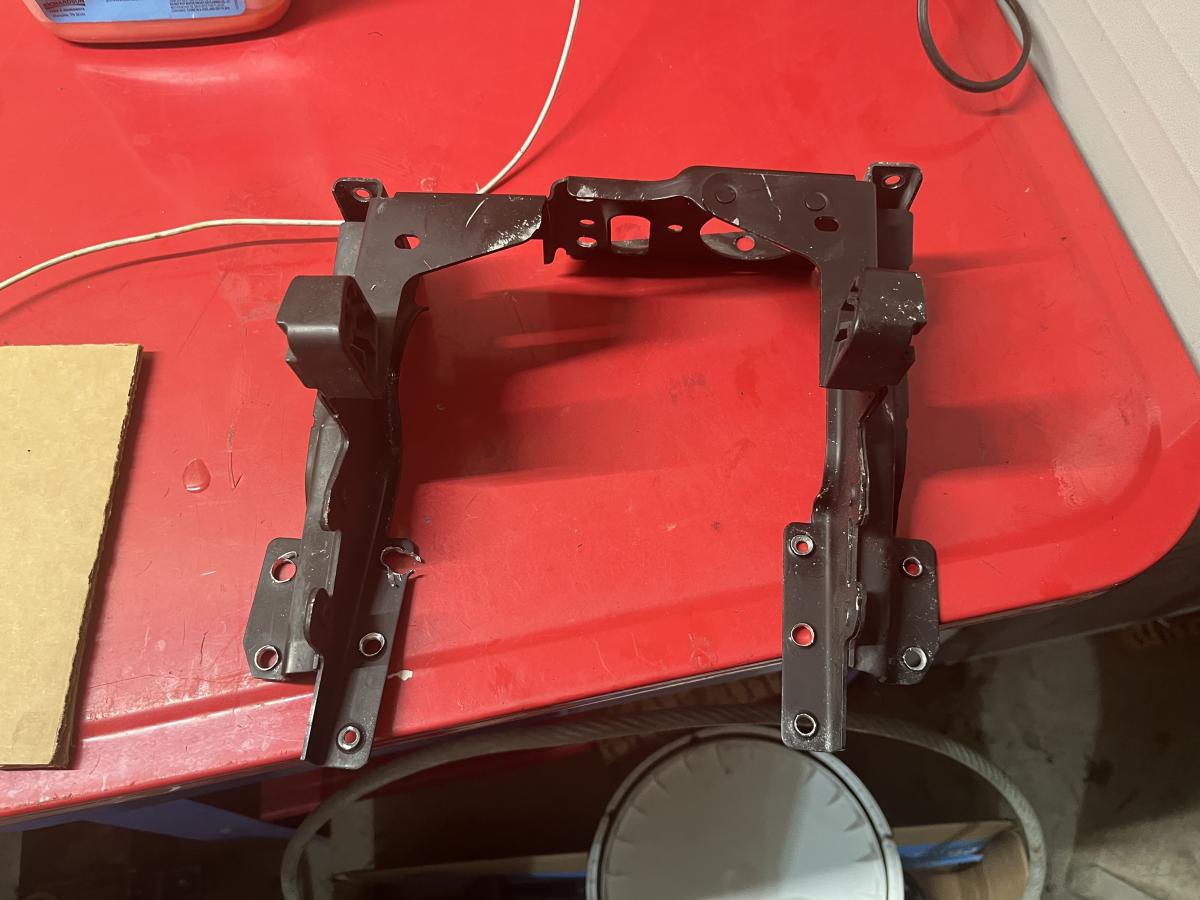

          I really don’t need these since I use hood pins.
          Click image for larger version  Name:	921D7EF3-A5C4-4D07-AFF3-E802C596DE35.jpg Views:	0 Size:	95.9 KB ID:	201508
          Just drilled out the rivets. The carbon parts should be much stiffer so I don’t see a downside. I can always rivet them to the carbon parts…worst case. But these weigh 1lb.

          I am going to make this really stiff (that’s what she said). I’m not sure how much weight I am going to save here. I am willing to make it heavier.

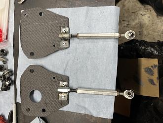

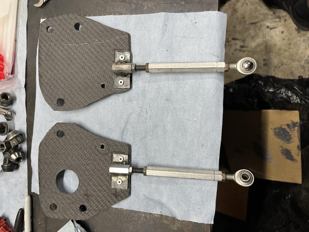

            Finished the carbon splitter mounts. Saved 1.8 lbs!
            Click image for larger version  Name:	20C9B98B-1442-462B-8033-1FBAA83C6226.jpg Views:	19 Size:	178.4 KB ID:	204352

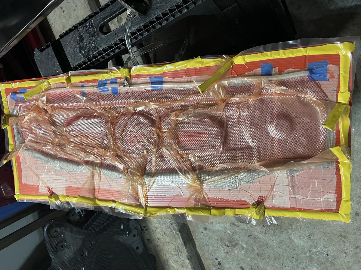

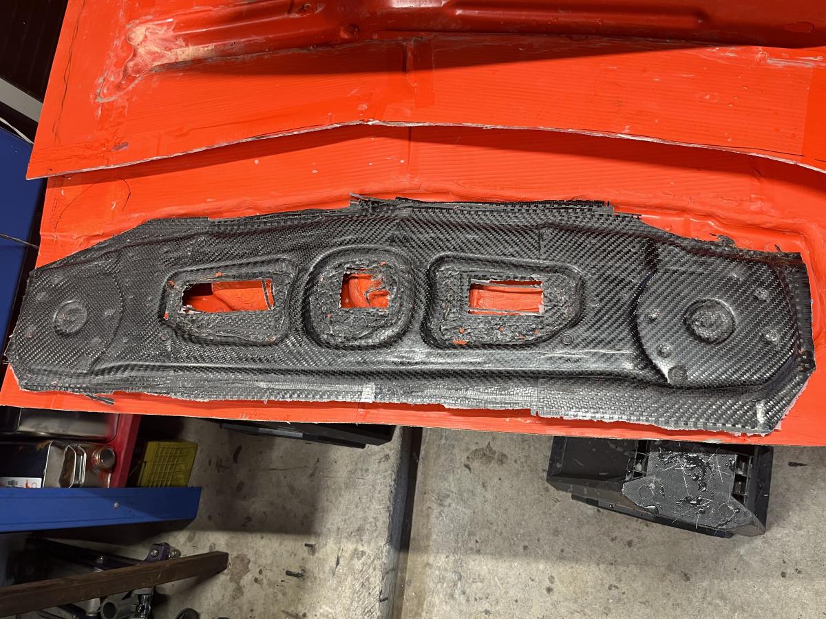

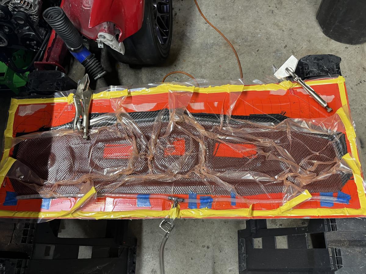

              Infusion completed!
              Came out pretty good! Used scrap pieces of carbon and core. It came out to the same weight before trimming. Should be closer to 1.8lbs. More importantly the structure adds stiffness for my splitter mounts.

              The mold for the top half is done. Hopefully will have a carbon part by Sun.

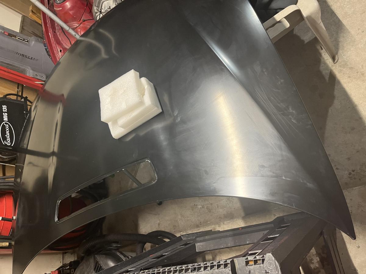

                    The carbon hood saga...the goal is to make the lightest hood possible. Which...I now think is 8lbs.
                    I will not be defeated. At this point...I could have just bought a nice CF hood but that's not the point.
                    Attempt 1 It fit! I lose vacuum and it came out WAY too heavy - 16lbs! An $800 f' up right here...
                    Attempt 2 Now I'm on the other end, way too light. 4.5 lbs but I don't think its stiff enough. Also had an issue with the mold...had to damage the CF part to get it out. Not as bad...$450 f' up this time.

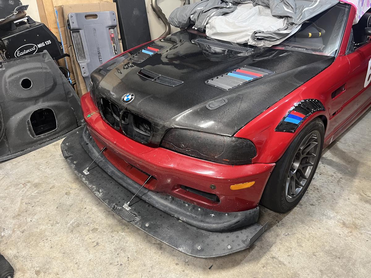

                              I'm also working on some carbon headlight blanks - in the process of making the molds. I've been thinking about adding some ricey goodness to my carbon work - make some M stripes that are infused into the part.
                              I got some samples.
                              This is more subtle. It has colored tracers woven into the fabric
                              Here is what red looks like...
                              This is just solid colored carbon which is much more visible.
                                #75
                                Carbon headlight blanks are done! The pair weighs 1 lb vs 4 lbs for my gutter headlights.

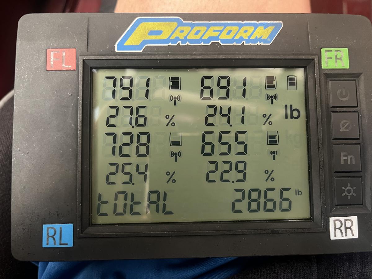

                                Got the car on the scales. Happy with 2866! No passenger and fuel puts me at 2600. Shuddup! 😡I know I’m fat!🫃
