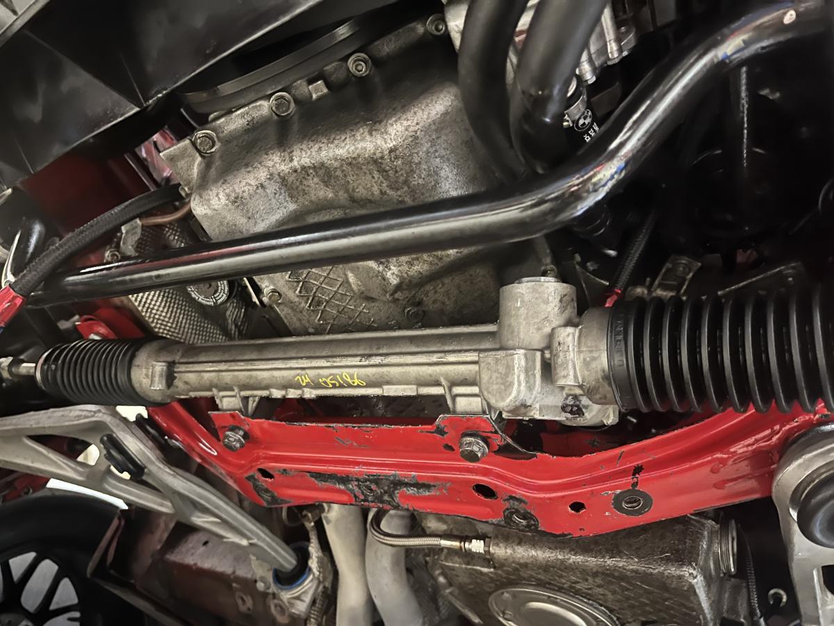

            Im going to try this PS delete…again. Last time I used one of those crossover blocks - crap - waste of time and money.
            The first gen Z4 has a manual rack with electric power assist in the steering column. I’m hoping that it will be decent through the slower turns.
            I found an eBay coupler that fits the Z4 rack. The problem is the pinion sticks out more than the hydraulic rack. Hoping I don’t have to cut down the steering shaft.

            And it fits!!! Perfectly…the pinion and shaft sit just deep enough in each end so it doesn’t interfere with the joint articulation.

            So I am working on removing the PS system. The PS system is always getting in my way and would be awesome to drop some more weight on the front end.
            I will drill an indent on the steering shaft for the set screw in the coupler to prevent them from separating. Then I need to degrease the car and then I can take it for a spin!
              #81
              Took it for a test drive, the Z4 rack worked...just the same as a stock rack with the crossover block except it was even worse at low speed from my memory. So I will finally put my dreams of manual steering to rest. I guess I could do electric steering but I don't think it nets me very much in terms of weight savings. I like the feel of my steering now with the relief shims.
              Looks like this is a case where I should leave well enough alone.

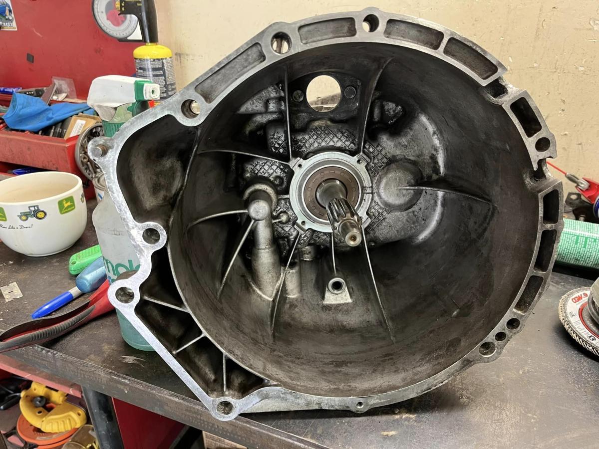

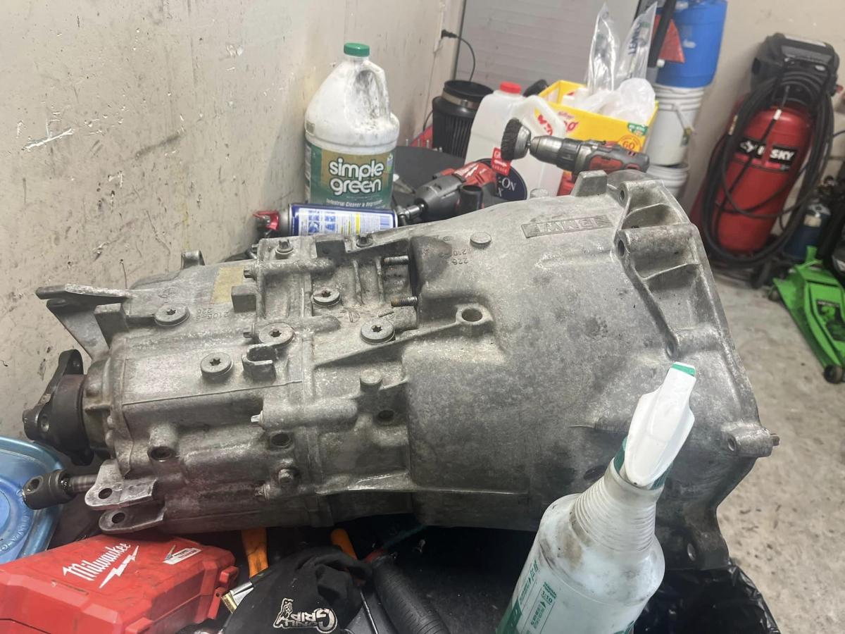

                Well...blew up my transmission. Just driving and heard a loud bang followed by rattling. The tranny shifted fine into all of the gears. First step, drain the oil and see if there's a clue.
                So something broke. Found a used ZF310 locally. As per usual they come covered in oil and clutch disc material. Got it cleaned up. It was from an E46 and shifts great! Only downer is the output shaft seal leaks. I needed to get the car ready for COTA so in it went. I'll deal with it later.

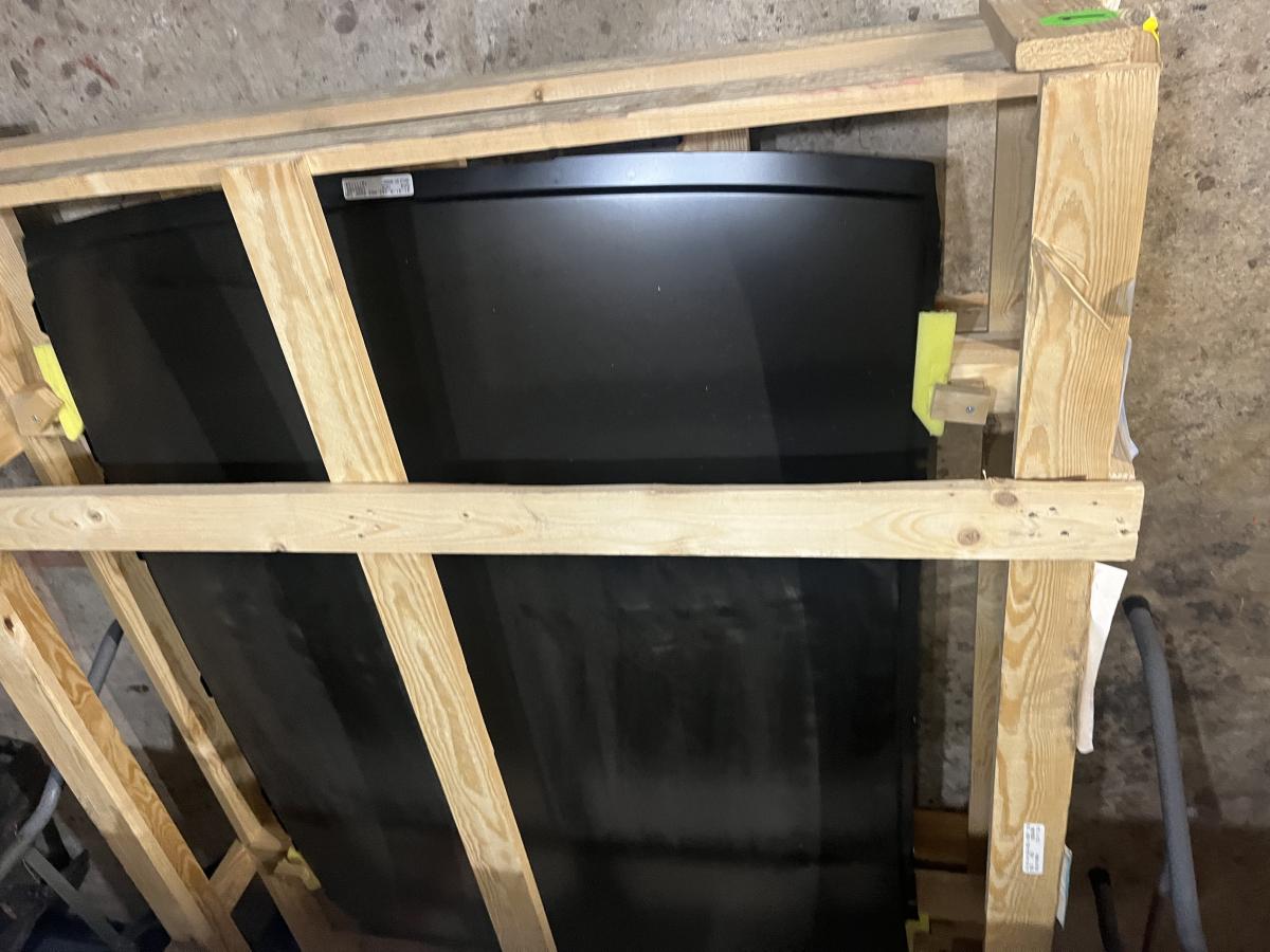

                                Here we go. OEM slick top roof panel. Only
                                took 3 attempts and then 3 months to get it.
