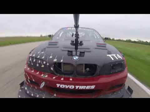

            I need to figure out how to capture flow on the front bumper. Thinking of using a gopro on the front straight pit wall.
            ​Leafblower? Should at least give you a good idea of what the air is doing.
              #96
              tried that and an industrial fan. The tufts don’t start moving until about 40mph.

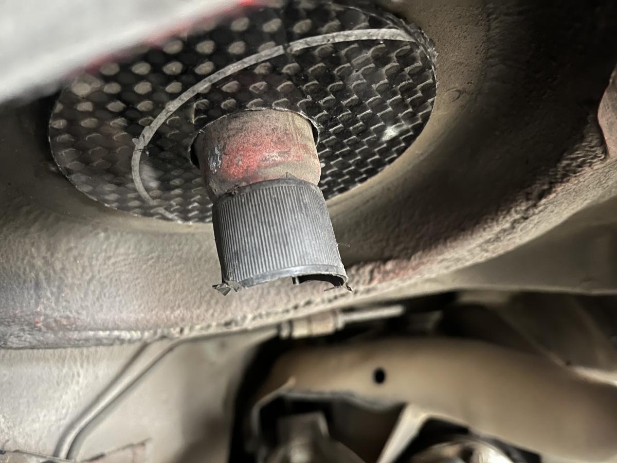

                Then this happened...
                Came out as good as I could expect. Car was still drivable, no noises or issues but the car felt sick. Got it home, found a damaged splitter mount and control arm. The ball joint blew up yet it made zero noise. Fixed and ready for more!

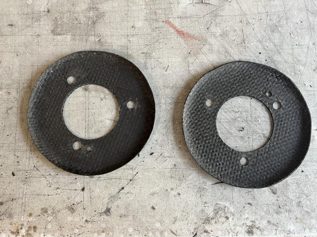

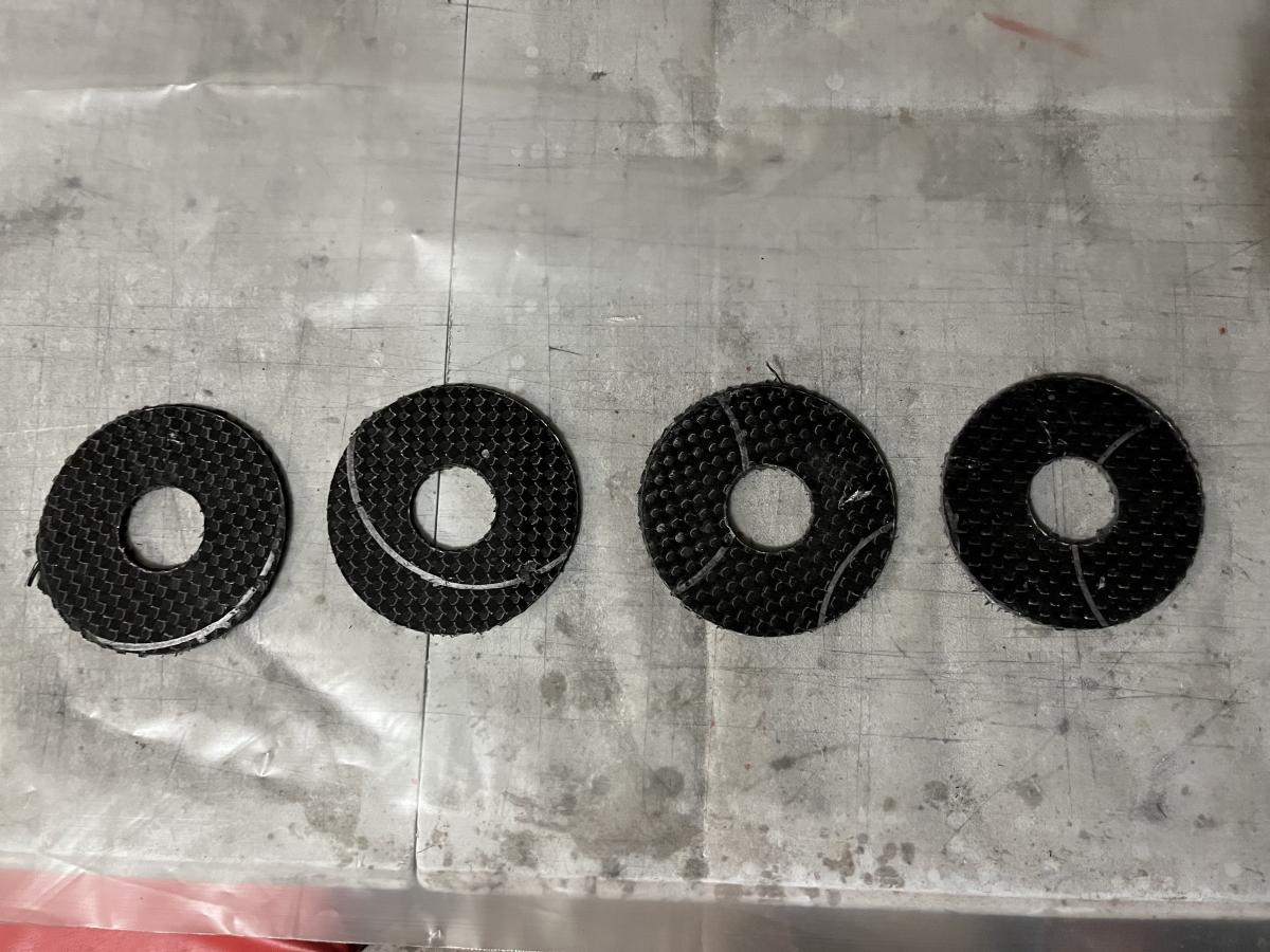

                  And some rear spring plates - top and bottom. I don’t really need the weight jackers. Its not too
                  difficult to mess with the rear ride height.

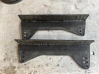

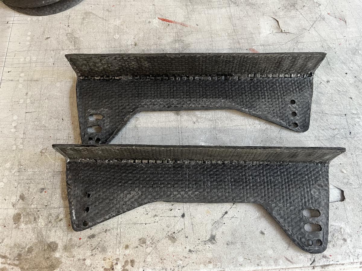

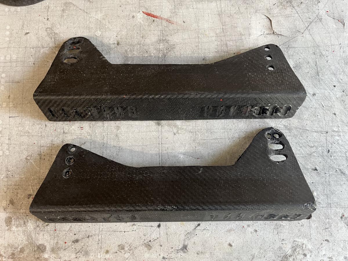

                  Carbon seat mounts…eh…need to make some changes to the layup. 4mm thick is challenging to cut. Also, I don’t think the top holes are usable. I started drilling the holes but it is too close to the edge. Not sure I’d use that hole with a steel mount.

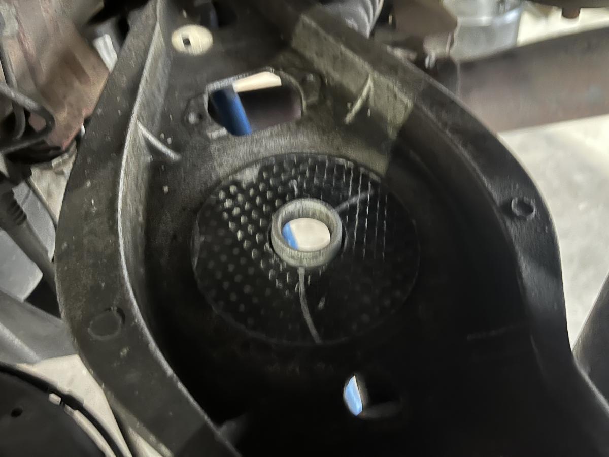

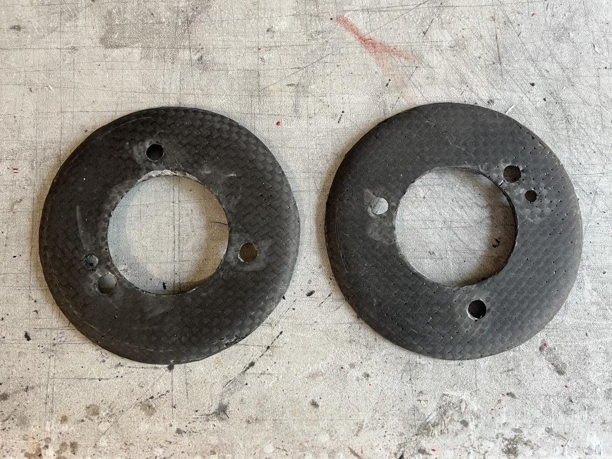

                    The front strut and rear spring reinforcements worked! No pics of the strut plates.
                    Here are the rear spring plates. I used a 1.5” hole saw. The upper plates don’t stay up but not sure if 1.375 will fit. Might just put some double sided tape on it.

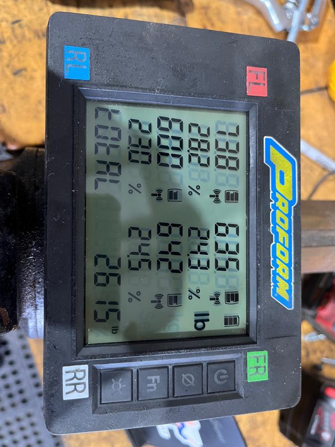

                      Not sure if I mentioned it but the goal for 2025 is to set TT4 NASA track records for the TX region. I'm 90% confident that the car can do it as is. But I do want to run TT3 where my car is at a significant tire disadvantage. My car is lighter (duh) but there will be a HP and tire deficit. So I have to out drive other cars with stickier tires and more power. The power disadvantage becomes obvious on long straights - the car just runs out of steam over 120mph due to drag. So I will continue to optimize the weight - first step is to get below 2500lbs. I'm getting closer, an estimated 2525lbs right now (2615 minus 15g of gas - 90lb = 2525). 2nd half of the year - work on drag reduction and hopefully a suspension upgrade.

                      Impressive.
                      Is the 2615 with driver??
                        Originally posted by AXDB View Post
                        Impressive.
                        No, just car with fuel

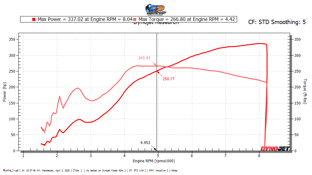

                          Got the dyno sorted out. It was an adventure. Home coding caused issues and a delay. Got it done.
                          337hp/266tq - quite happy!

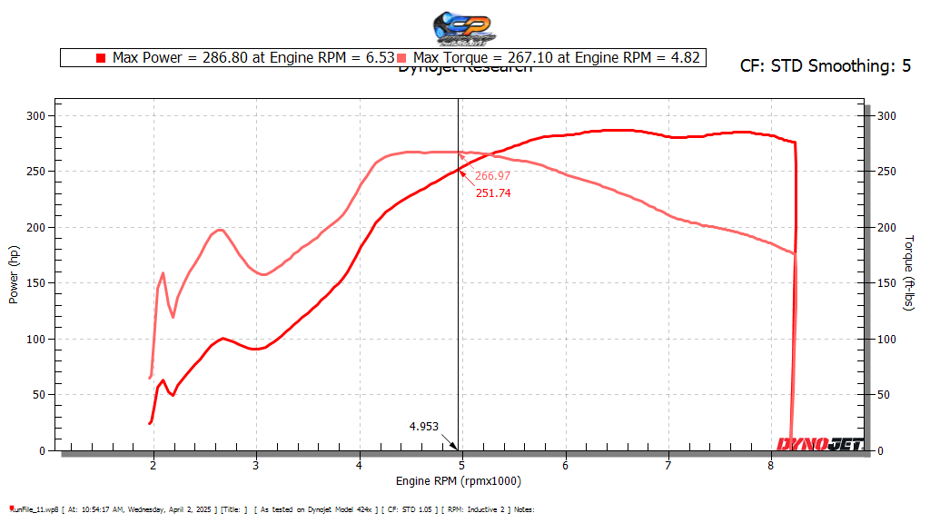

                          Then the detune. I was running out of time on the dyno, power kept going out, and it was an all around shit show.
                          Got it down to 286. Needed to be at 280. Not going to run the detune until the fall anyway.

                                I like the idea of learning about the airflow around the car to get data instead of blind guessing. The hood, trunk, and roof are easy. Not so simple for the front, back and sides. So I'm experimenting with one of the long arm suction cup mounts and it worked great. Well, just well enough for the GoPro stabilization to make the footage usable. Over the summer I do plan to collect better baseline data especially on the front end. The last thing I need to figure out is getting video from the under the car.
