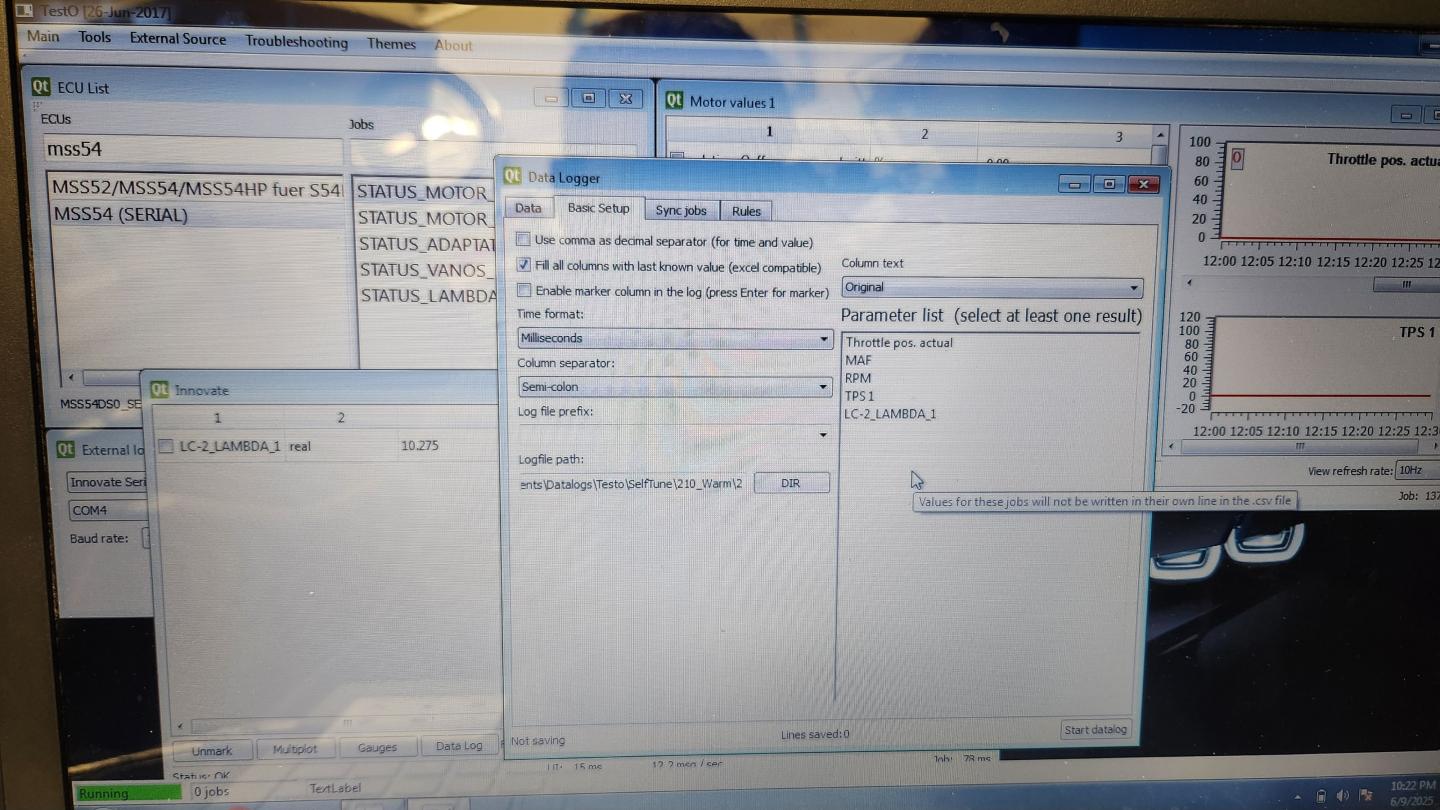

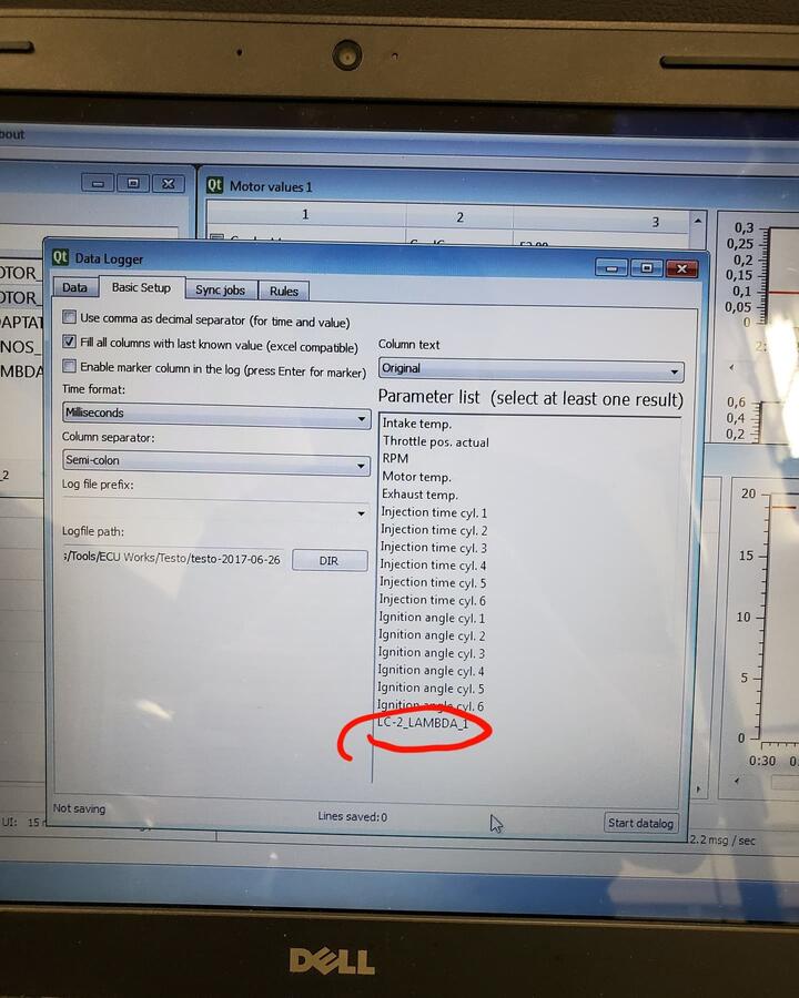

    I just installed an Innovative LC2 and am able to pull up the AFR using the "external device" feature in the drop down menu up top.
    I would like to have the AFR data in the same "list" of parameters like RPM/IAT/Ign. Timing, etc. And not in it's own separate window logging separately from the other data.
    Any help would be appreciated. And on a side note I have BMWlogger and have no idea how to integrate AFR into that program, it says "wideband" up on the top of the list but I can't find any way to get it to show the AFR or connect to the LC2.
    EDIT: Figured it out after watching a YouTube video...loving testo.

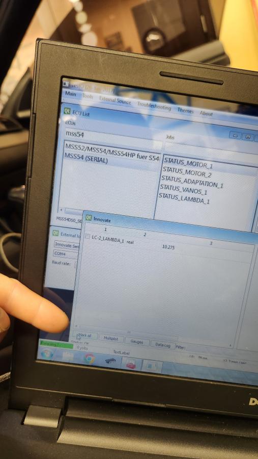

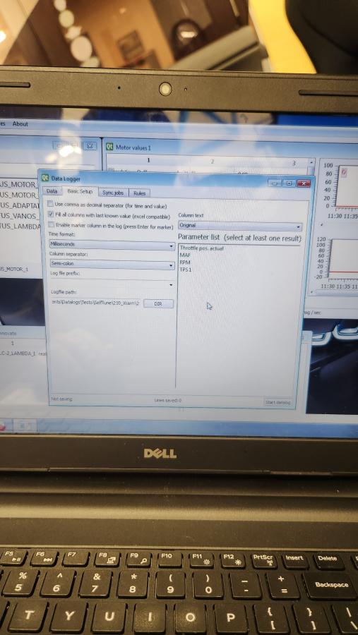

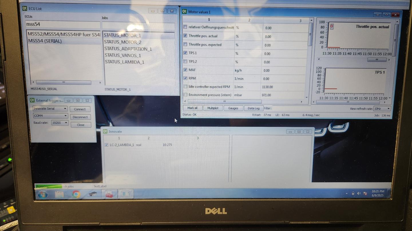

              Edit: Fixed the driver issue and found out how to log AFR again.
              When the LC2 is opened via external device it is on its own and will not show up in the "datalog list" until you click the "mark all" button ONLY in the LC2 windows.
              These photos show the general layout, the datalog list before and after clicking "mark all" in the LC2 window.
