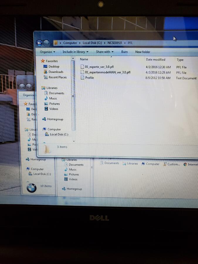

      Hey terra , I downloaded and installed the software from bimmergeeks, INPA works and I can read codes etc. but I can't seem to load NCS properly, the profile you use is not attached. Here is a screenshot of my C:>NCSEXPER>PFL folder

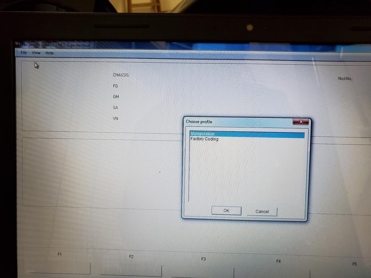

ID:	31149 And here is a screenshot of what happens when I choose File>Load Profile within NCS. I am just not getting this.

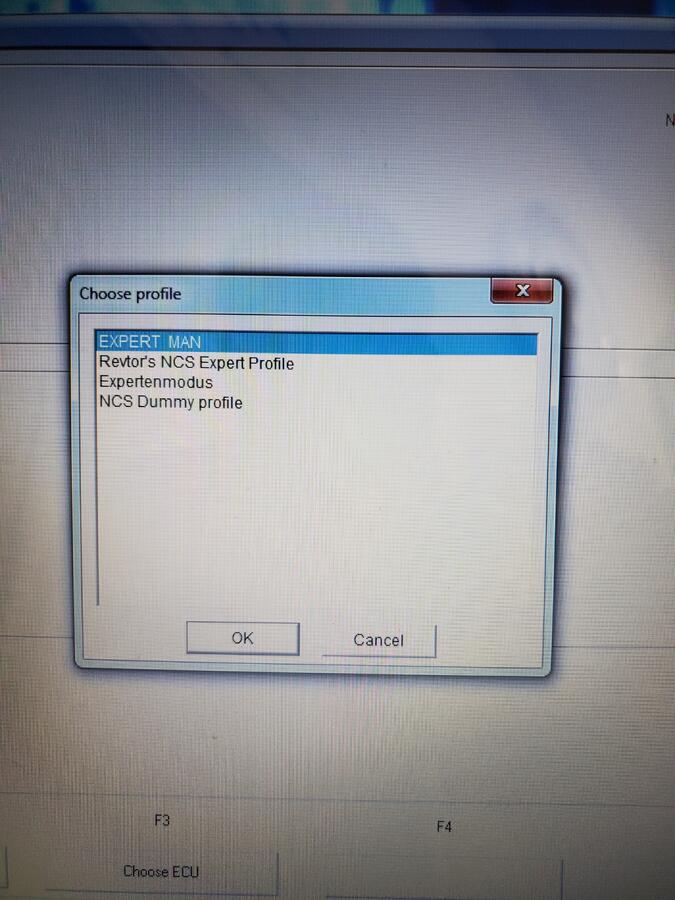

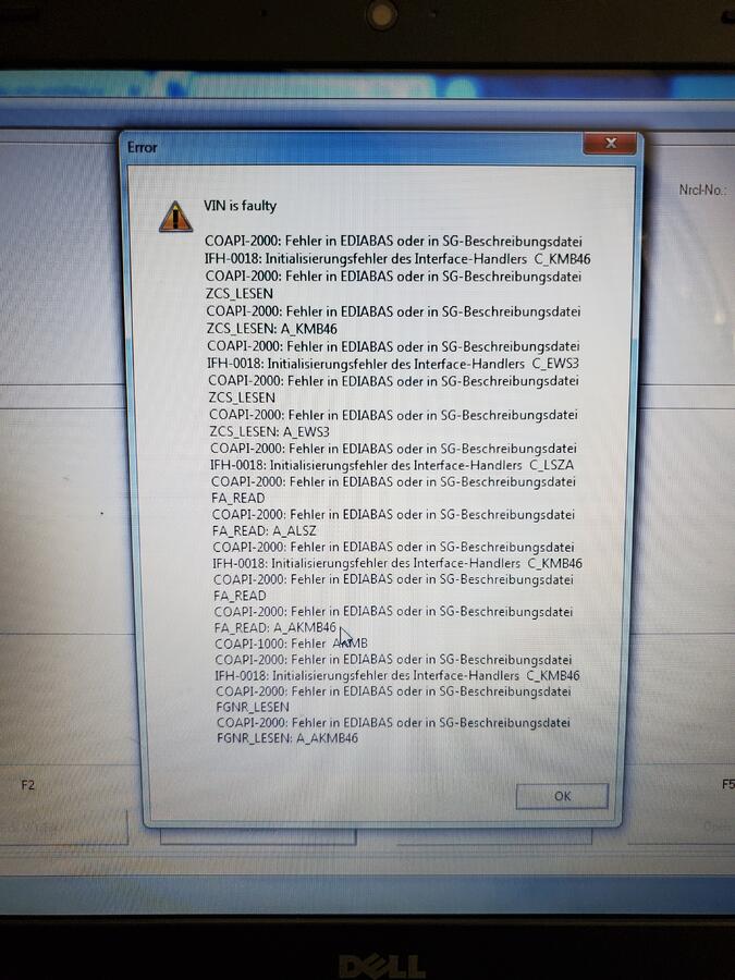

        Ok...so I went online in search of NCS profiles, I grabbed a few and copied them into the PFL folder, when I load NCS I now have this. I Also got a bit further in and received a "VIN is faulty" message, I am LOST.. Click image for larger version

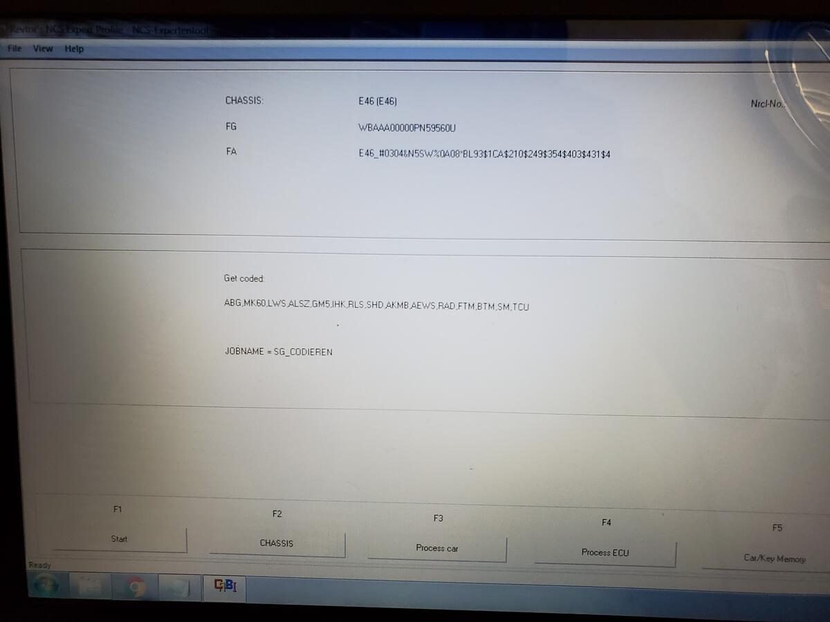

          Getting somewhere, I did not have the car plugged in on my previous posts...the last 7 digits match my VIN.
          Stopping here before I do anything wrong, taking a big step back and need to do some research.

            Looks like everything is set up. You should be able to follow the rest of the guide now. Basic process is click process ecu, choose the module you want, read, use ncsdummy to edit, and write back to module.

                          Sorry for newb question - there is no profile link in the sticky. Will this one work? I found it and added to the folder - Revtor's NCS Expert Profile

                              What did you do to fix it? I am getting the same ‘vin is faulty’ message and i have my cable plugged in and ignition on. My cable works fine, it’s been used for ECUWORX coding and Hassan’s remote tune. I just can’t get NCS Expert to work.
                                I honestly forgot it's been so long, it was something very simple though like the COM/Latency settings.
