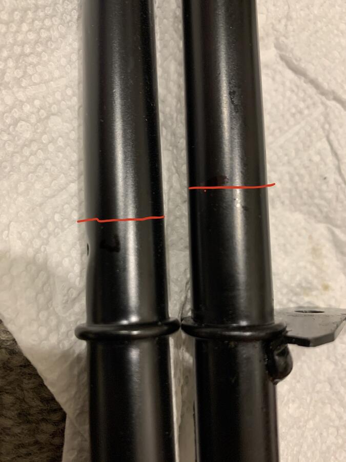

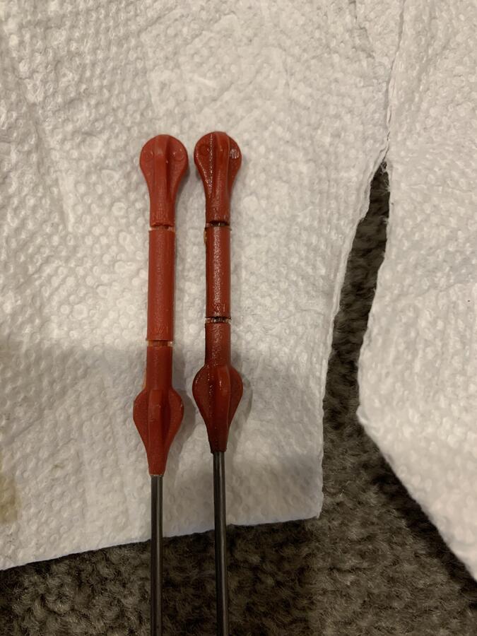

          Click image for larger version  Name:	BD8B3211-2F56-4657-BF1D-9F171062D088.jpeg Views:	0 Size:	82.0 KB ID:	97269 Click image for larger version  Name:	9AFB4DA9-9EFE-40F6-8684-A1D7EE913E13.jpeg Views:	0 Size:	59.1 KB ID:	97268
          The CSL oil dipstick is different the maximum and minimal reading on the dipstick is lower compared to the stock M3
          right side CSL left side M3 in all photos above
          It is roughly 4mm lower measured from top and bottom of the tube.
          I would say the digital oil level reading has been set to be more conservative and to trigger earlier than the stock M3 software versions so it makes no sense to change it.
            Interesting, thanks for the information!
              Thats great info. Thanks.
