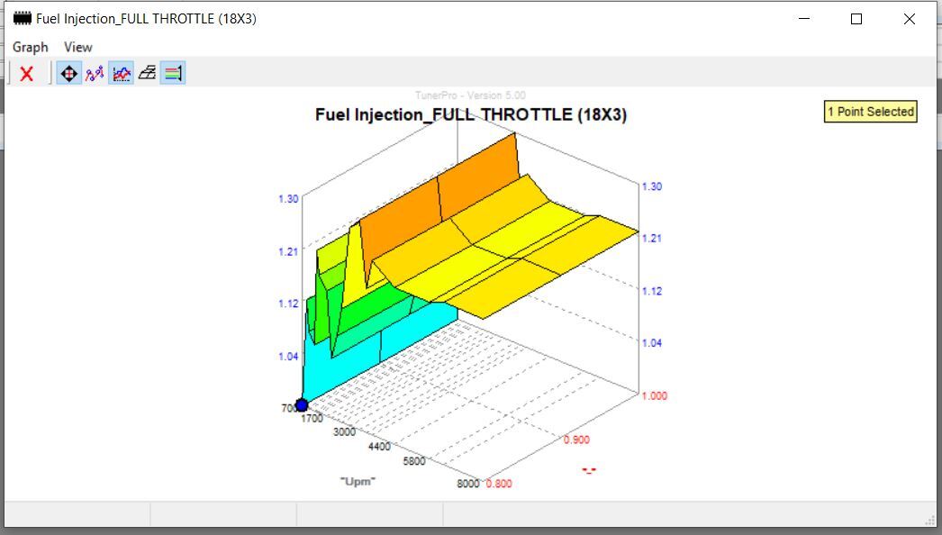

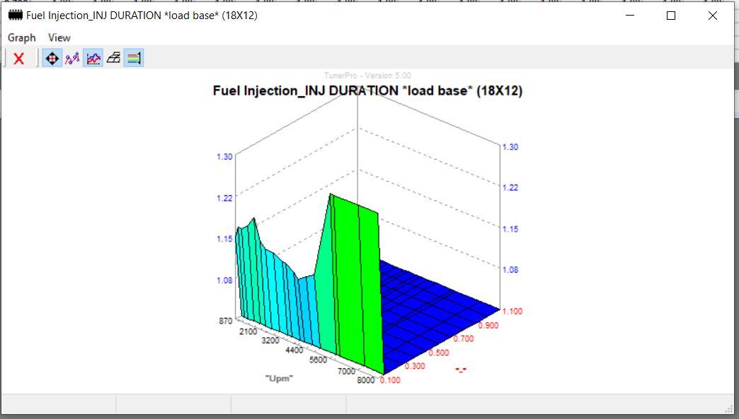

                            Do these maps look right? This is from a 0401 csl tune hosted this github modified for stock US m3 cams: https://github.com/YulCmr/MSS54_HP_C...info_gathering
                            Load base map
Name:	load base fuel map.JPG
                            Full throttle map
Name:	full throttle map.JPG
