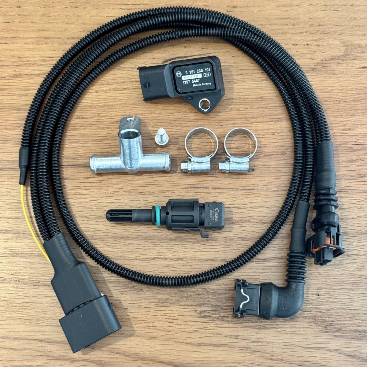

                              Okay, so as I said it is possible, with a CSL airbox install, to route the wiring for both the IAT and the MAP sensor to go via the MAF connector. This is the approach I went with as I wanted the ability to fairly easily swap back if desired.
                              For reference the end result of the extension loom looks like this:
                              Click image for larger version  Name:	IMG_0408.jpg Views:	0 Size:	184.5 KB ID:	311165

                              So what does our extension harness look like?
                              CSL IAT Sensor
                              Pin 1 (IAT signal) -> MAF connector pin 1
                              Pin 2 (Ground) -> MAF connector pin 3
                              CSL MAP Sensor
                              Pin 1 (+5V) -> MAF connector pin 4
                              Pin 3 (MAP signal) -> MAF Connector pin 5
                              IMPORTANT! Remember that when you do the install you also need to re-pin X60003 pint 1 to pin 18. I recommend putting a label in the ECU box as a reminder as to what you have done so that it can be reverted in the future.
                              In terms of the construction of the extension loom you need the following parts:
                              1x Bosch 3 pin connector (1928403966) - I recommend buying genuine Bosch. Also make sure that you buy a kit that comes with the pins and seal plugs.
                              1x boot for Bosch 3 pin connector (1928300527) -
                              1x IAT connector (12521427615) - Make sure that you purchase a kit that comes with the pins and seal plugs.
                              1x boot for IAT connector (12521732635)
                              4x 3m of 0.5mm2 insulated wire - I recommend different colours for each pin as you need to know which is which after passing it through the corrugated tube. If you want to go super fancy you can purchase in the original wiring colors for each pin.
                              3m of 4.5mm corrugated tube. Genuine stuff is order-able in 1m lengths as (12517508831). I wanted longer length so bought some knock off from AliExpress which, except for the lack of writing on the outside, is exactly the same.
                              1x male MAF connector kit (see here for how to purchase)
                              Braided heat-shrink tubing for the MAF connector to 2x corrugated tubing
                              Tools required
                              - soldering iron
                              - solder
                              - side cutters
                              - tape (to aid in pulling wires through corrugated tubing)
                              - crimp tool for terminals (or do what I do and tack with a small amount of solder and use needle nose pliers to crimp the terminal
                              - exacto knife (for cutting corrugated tubing)
                              General approach
                              The general approach I followed was to:
                              1: use scrap wire to lay out my desired routing of the extension harness in the engine bay (to work out lengths)
                              2: cut wires and tubing longer than you've measured so you have spare room to work
                              3: make up the MAF connector end first (don't forget the waterproofing plugs!)
                              4: thread the wiring through the 2x corrugated tubings (making sure you get the right wires in the right tubes)
                              put it back in the engine bay and route it, temporarily fixing in place to get the exact lengths you need for the corrugated tubing
                              5: cut the corrugated tubing to length (don't cut the wires)
                              6: work out exactly how much length of wire you need to account for the terminals, position and orientation of the connectors, etc. and cut wires to length
                              7: Don't forget to thread on the waterproofing plugs and your connector boots
                              8: assemble the connectors making sure the end result for both is at the correct orientation
                              9: heat shrink the MAF connector end where the two corrugated tubes meet it
                              10: enjoy your handiwork!
