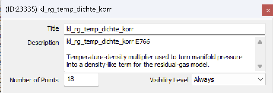

    I've put explanations in the descriptions of the ones I've worked out:
