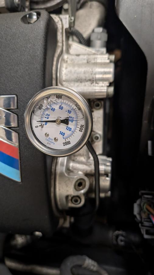

                Here's the latest update,
                Made a VANOS pressure reading apparatus.
                My suspicion is right:
                - Low pressure reading to the tune of 3 bars (essentially engine pressure) -> refer to picture.
                - Info on the adapter: I ended up cutting 7mm from the thread start to match the OEM banjo bolt.
                Plan (with status)
                - VANOS test (using toolset32) -> FAIL (times out)
                - valve block swap -> Done (PASS) Beisan
                - solenoid valve replacement -> Done (PASS) Beisan
                - DME to solenoid resistance check -> Done (PASS)
                - VANOS pressure test -> FAIL

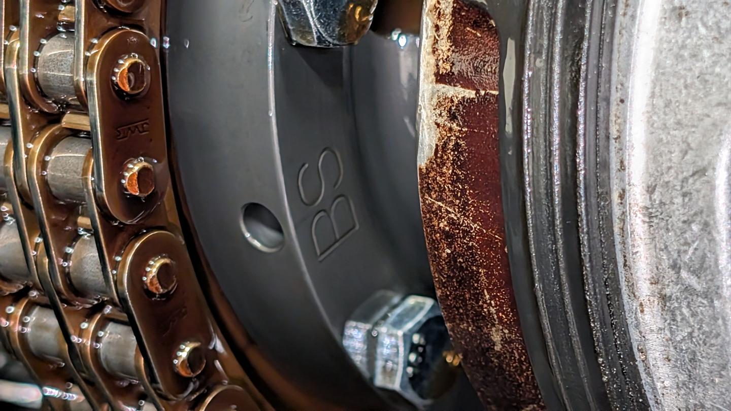

                - Check the exhaust sprocket hub -> not broken (Beisan)
                - Check the exhaust upper chain guide -> not broken (Beisan)
                - Check cam sprockets bolts -> not broken (at the least the hex head ones)
                Next:
                - VANOS high pressure line -> RE replacement in the mail
                - VANOS Accumulator -> OEM replacement in the mail
                - Confirm proper timing
                Any ideas on what to check is greatly appreciated!

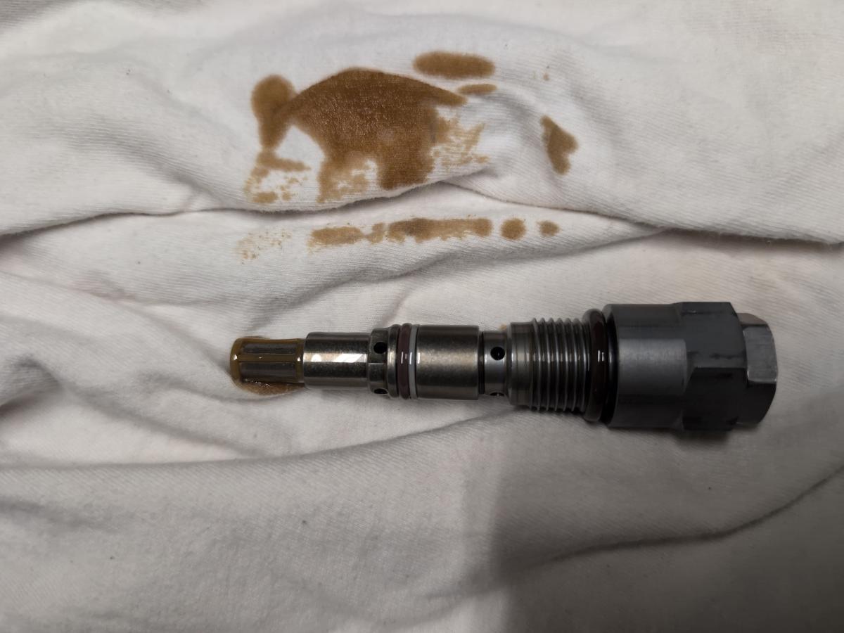

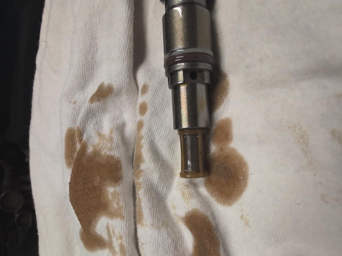

                        This is a refurbished valve block from Beisan.
                        It included the high pressure regulator. Picture attached after I removed it to check if it was the root cause behind the low pressure
                          remove the strain filter as in Pelican pics, and push down the valve nose to see if it move against the strong spring.
                            I did just that and I could NOT move the the valve.
                            I loosened the nut and moved the Allen head screw. I can feel the spring move in and out but I couldn't move it.
                              Learnt a lot from thread
                                Heads up,
                                I removed the nut, backed the screw out all the way to reveal the shaft with oring, spring and needle valve.
                                Read that there's a captive washer inside that supposedly should rattle freely when you shake the valve body. Mine is now (maybe from some thick oil).
                                Cleaned it out until things moved freely.
                                Reassembled, and assembled back.
                                I'll let the group know what's next progress wise.
