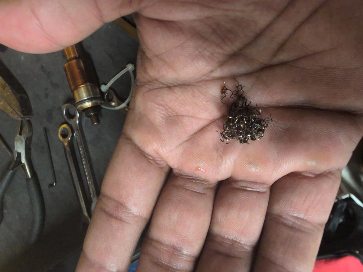

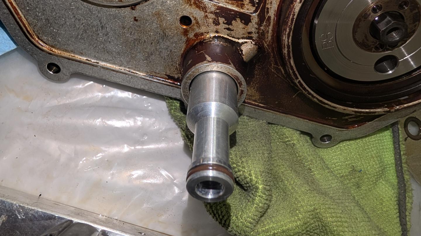

      Where did the stuff in the palm of your hand come from?
        It was shoved in the inlet portion on the oil flow regulating valve.
          Was made of metal?
          Was it the regulator that supplies the vanos assembly or the regulator in the vanos valve block?
            Was made of metal? Yes. Think of the stainless steel scrubbers for pots and pans. It was shoved in the inlet hole (small OD)
              Yes, which?
                Yes, which?
                My reply got buried in the "quote thing"
                Was made of metal?Yes. Think of the stainless steel scrubbers for pots and pans. It was shoved in the inlet hole (small OD)
                Was it the regulator that supplies the vanos assembly or the regulator in the vanos valve block? Vanos assembly
                Picture is new replacement. I swapped my beisan o-rings.
