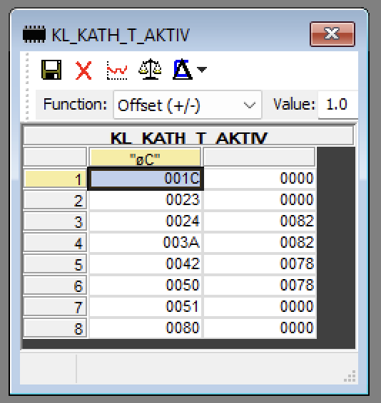

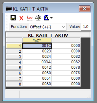

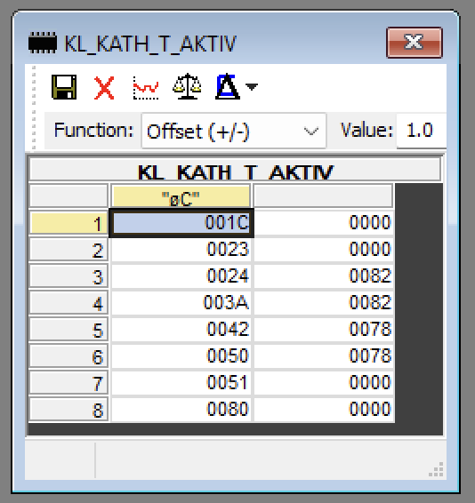

    4. Search for 00 00 00 00 00 82 00 82 00 78 00 78 00 00 00 00 and change to 00 00 00 00 00 00 00 00 00 00 00 00 00 00 00 00​
    KL_KATH_T_AKTIV- set kath heating time to zero
