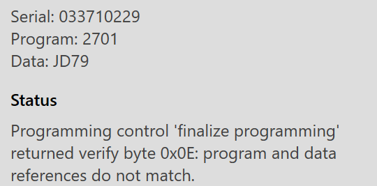

              got an error, using community patch
              Click image for larger version  Name:	image.png Views:	0 Size:	29.3 KB ID:	364331​
                okay i think flashing the partial fixed it. now onto figuring out how to change vanos offset
