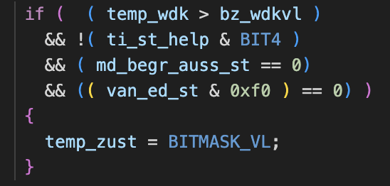

      B_VL is determined from the following:

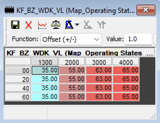

      bz_wdkvl which is a table lookup to KF_BZ_WDK_VL with n and tmot as inputs:
Name:	Screenshot 2026-08-27 at 3.22.32 PM.png

      The other conditions are just diagnostic status byte checks.
      Note that wdk is throttle valve, not pedal.
