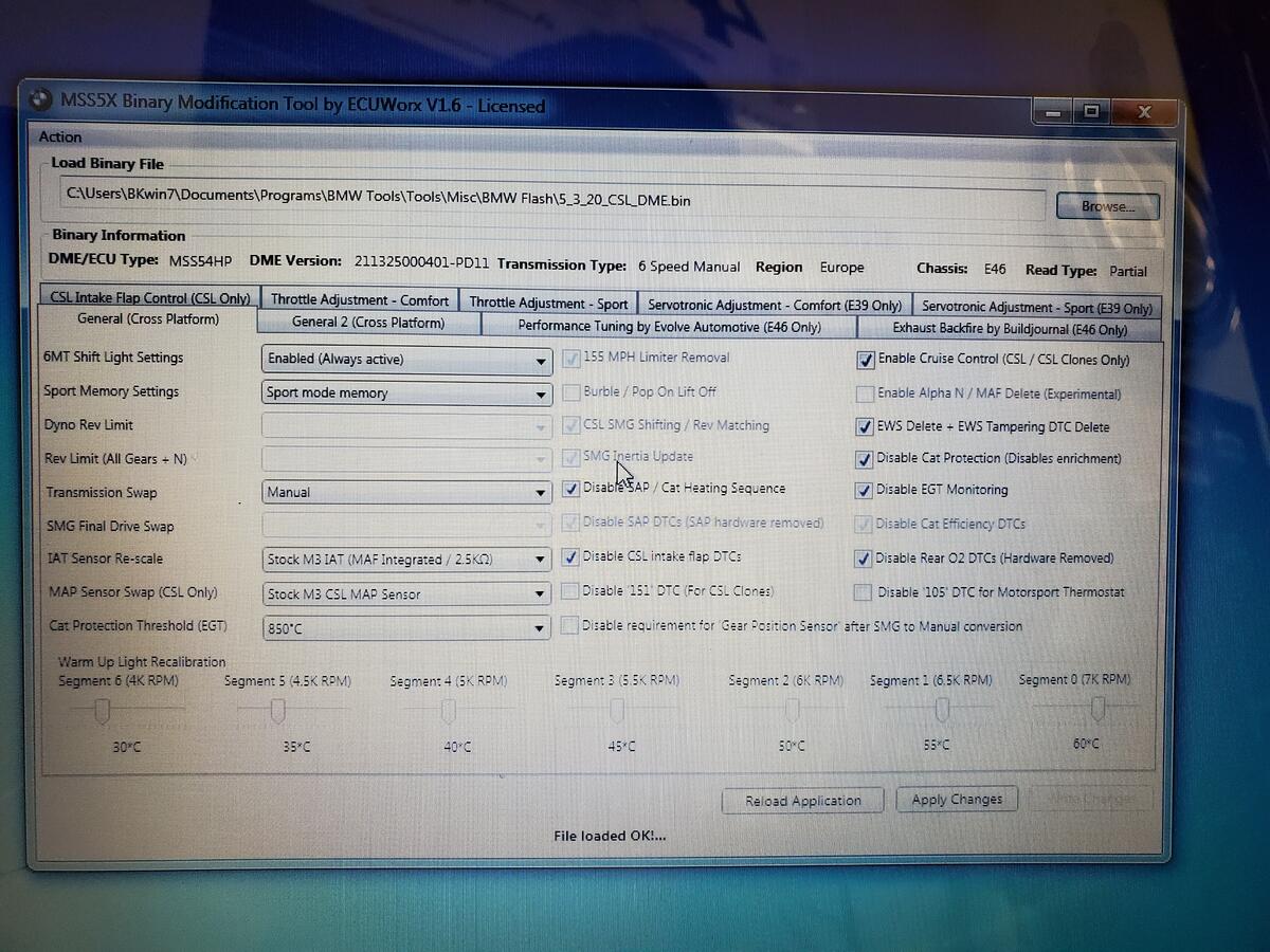

    Hey Martyn ,
    Why would the burble/pop overrun be greyed out with my new CSL flashed DME and was not greyed out when I had my stock DME installed?

      #62
      I broke it accidently, grab the latest version (1.6.4) and see if that sorts you out.
        #63
        So when I load my bin in the tool, the "idle speed" option is greyed out. Can i not adjust this with CSL ecu?
        It's because your idle speed has already been adjusted outside of the tool.
          #64
          I've got a DME w/ CSL software and yet it displays "Stock M3 IAT (MAF Integrated 2.5k)."
          Should this by changed to the Stock CSL setting?
          My temp. Sensor:
            #65
            That's incorrectly set for the CSL type sensor.

                #67
                Just want to clear something up for myself, If I want to try the build journal stage 3 burble do I also tick the option for "Burble / Pop On Lift Off" in the main (General) section too? Or only the build journal option?
                Thanks in advance.
                  #68
                  Thanks in advance.
                  Just use the BJ option on it's own.
