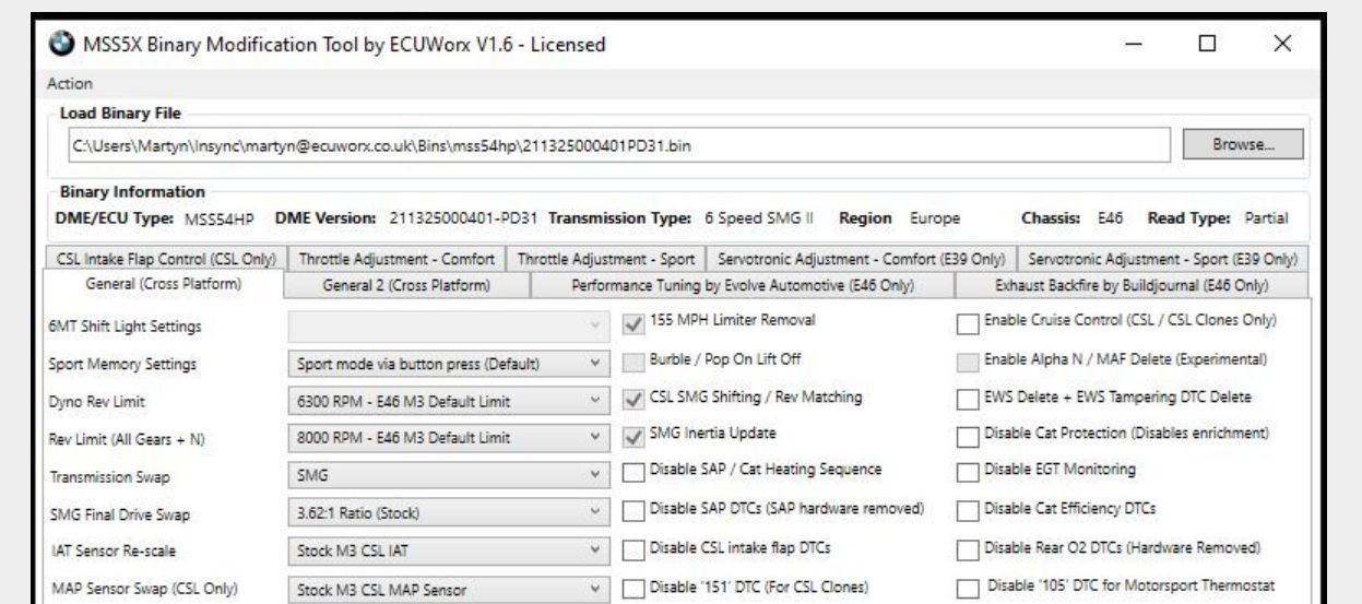

          It’s been a while since we updated the MSS5x Binary Modification Tool for the E46 M3 & E39 M5 so we thought it was time to add some of the top requested features.
          New features include:
          • Kess V2 reads are now support.
          • Burble & Pop added for the E39 M5.
          • AlphaN added for the E39 M5.
          • Idle Speed adjustment for the E46 M3 & E39 M5.
          • Cat Protection threshold adjustment for the E39 M5.
          • EGT Monitoring disablement for the E39 M5.
          • GPS/Clutch Switch reconfiguration for after SMG to Manual swaps.
          • GPS disablement for SMG to Manual swaps.
          • Z4M Electric Fan settings for the E46 M3 Aux Fan.

          As always updates for existing users are free of charge and the latest version of the tool can be found on the downloads page here.
          Feel free to post feature requests etc below.

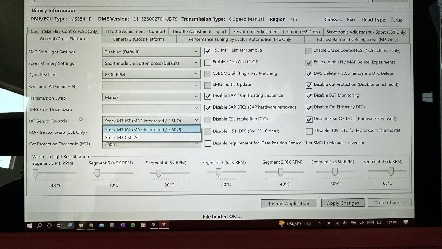

                My car currently has an AlphaN tune for a CSL airbox, and I was wanting to change the scaling of the IAT from the CSL IAT to the US IAT (relocating).
                Is this the correct setting to make that change? If so, the first option was already selected, so I’m guessing my tuner set my car up for the US IAT even though I told him I was running the CSL IAT hooked up to the stock CSL airbox location?​

                  If that was the option that was already selected when you loaded your bin file up into the program your good to go.
                  The US IAT is for the sensor that has the nut on it and more easily mounts where you want it.
