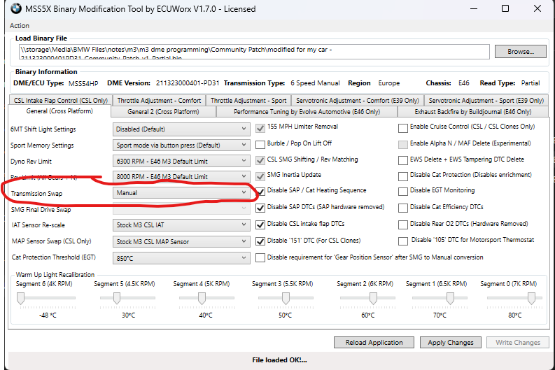

Is the Map sensor option in this tool active regardless of DME version? In other words, if I don't have my HP DME flashed as a CSL yet, can I still select for the Map sensor swap in this tool?
MSS5x Binary Modification Tool Update
I am not 100% sure how the tool will behave as I haven't used it, hopefully it prevents you selecting the MAP sensor swap, but unless you have the 0401 CSL software on your DME you cannot use a MAP sensor, the normal M3 versions of the software do not have support for one.Originally posted by Keith_MN View PostIs the Map sensor option in this tool active regardless of DME version? In other words, if I don't have my HP DME flashed as a CSL yet, can I still select for the MAP sensor swap in this tool?2005 ///M3 SMG Coupe Silbergrau Metallic/CSL bucket seats/CSL airbox/CSL console/6 point RACP brace/Apex ARC-8s
