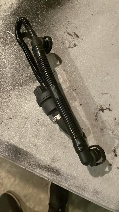

                                Is it possible to use this tool to disable code 221 (System Test, Crankcase Breather) caused by deleting this thing?
