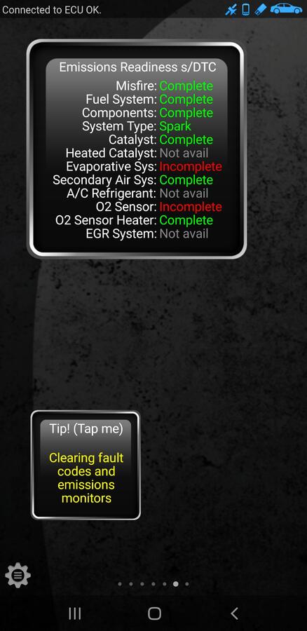

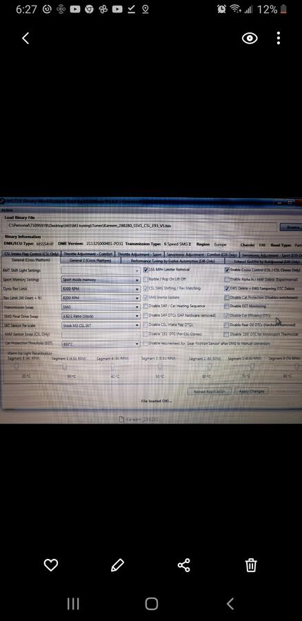

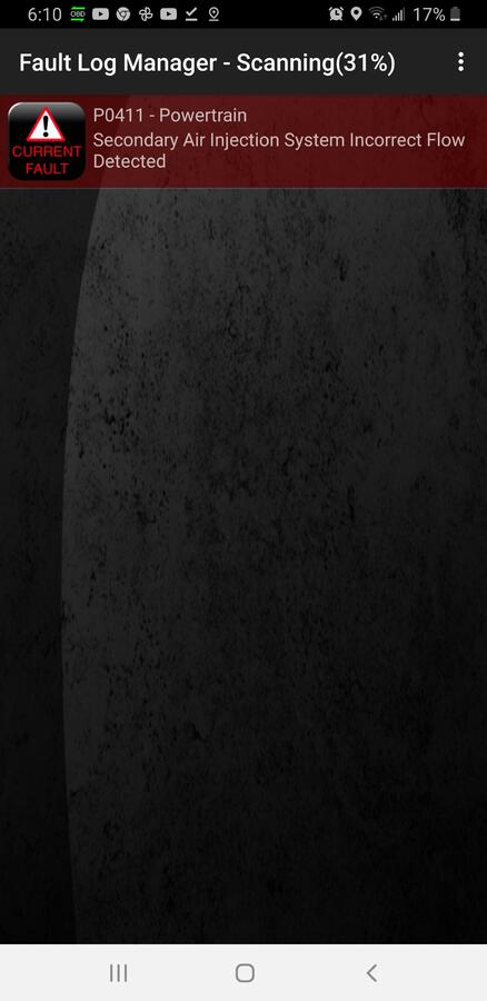

              Hey Guys,
              So I've been fighting with this Secindary Air Pump and I'm not sure how to get this readied up for emissions. I've allowed the cold start and the DTCs to show (I've deleted my SAP), as Terra said to let the check engine light show, then delete, and I should be good.
              I'm finding that when the CEL comes on, the SAP reads ready, but when I delete it, all DTCs go back to non complete (all tests are reset). I've included pics to illustrate the situation. So the CEL is on now, what should I do?

                  Hey Guys,

                  I was able to get mine to show as ready - I'll pull my config this weekend and let you know.
                  EDIT: I was able to check and I flashed cold start enabled but with the SAP DTCs turned off (I never let the CEL show) and my monitor is ready
