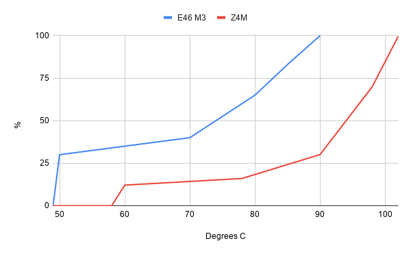

          #49
          What is the difference between the Z4M Electric Fan settings vs the E46 M3 Aux Fan settings?
          Evolve Eventuri
            #50
            Z4M on the left, E46 M3 on the right
              #51
              Interesting how the M3 fan ramp is actually more aggressive

                Originally posted by Martyn View Post
                Z4M on the left, E46 M3 on the right.
                Thanks Martyn. As Terra stated it appears the M3 values are more aggressive, wouldn't that work better in hotter climates? Are the Z4M fan values preffered for track use only? My M3 is my DD and the desert temps get up to 100-120 degrees, should I just keep the E46 M3 fan values?

                    Hmmm.... I was planning on switching to Z4M electric fan settings since I had heard it was more aggressive than the M3 - going to max DC at a lower temperature... guess not?
                    -Brandon
                    2005 M3 BMW Individual Sterling Gray / Imola Red 6MT
                      #55
                      Huh I also thought the Z4M values were more aggressive (more speed at lower temp). Made this to help visualize the differences based on the info Martyn provided.
Name:	E46 M3 vs Z4M Fan.png
                      Guess I'll stick with the M3 values?
