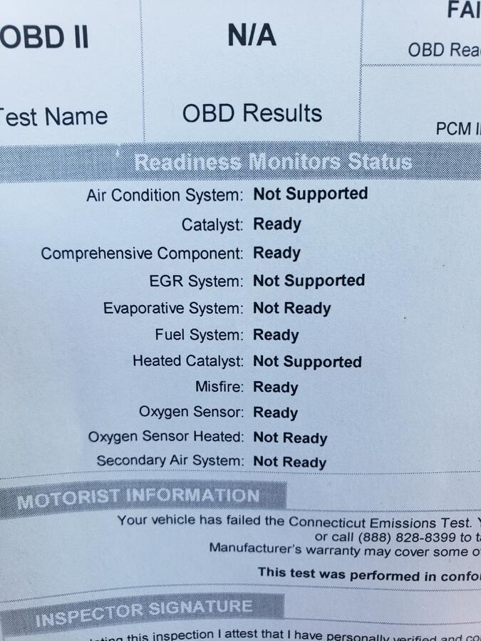

                  I'm currently trying to get this car to pass emissions now. Failed twice already, fml. Not sure how to ready the O2 sensor heater and evap. I've deleted my SAP, so that's my one allowed non ready. LolClick image for larger version

                    You in Cali? I had to "Disable Rear O2 DCTs" to pass.

                      And disable sap for the secondary air system

                        I'm in CT
                        SAP has been disabled, so this will always say not ready.
                          If you delete the error code without actually turning it off in the tune, it'll read as ready after your first cold start
                            #43
                            This is amazing, THANK YOU. So I can move my non ready to either the O2 heater or Evap.
                            I've been drive cycling my butt off , for a few days,and nothing seems to be working.
                            I downloaded Torque Pro on my phone, so I can the readiness without going to the actual emissions place..pantone know of a cheap compatible bluetooth adapter?
