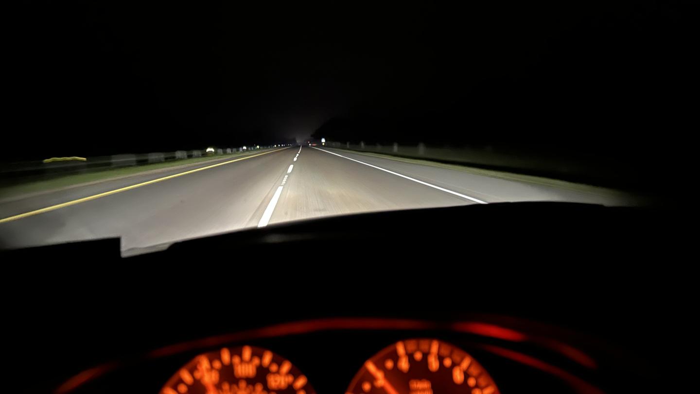

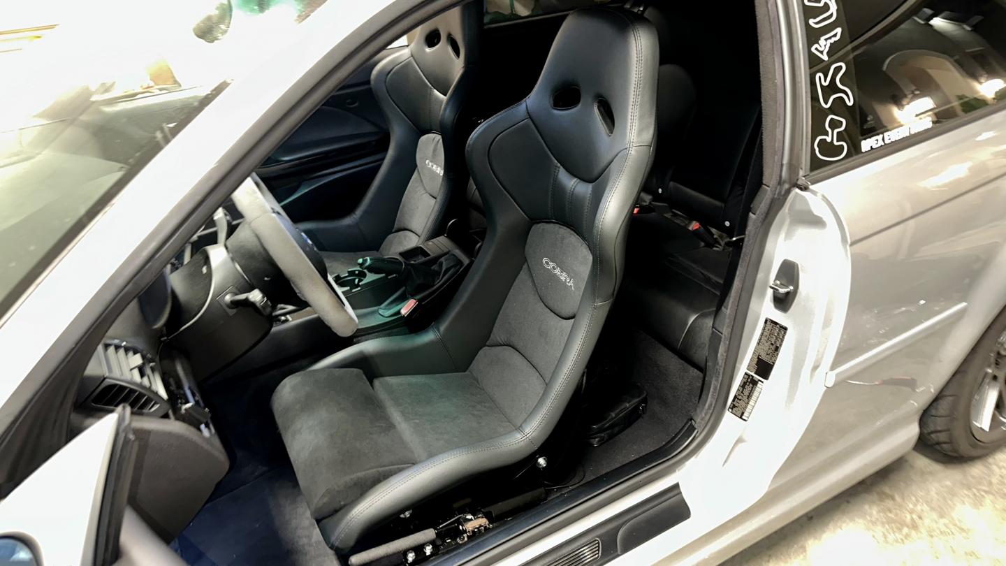

          Lol same. I got the full SSV1 setup and Nogaros installed, and CSL intake should be going on within the next couple of weeks. Since the car is at 107k miles, I’m going to refresh some stuff that’s probably due for replacement - TPS on throttle actuator, larger injectors, crankcase vent valve, spark plugs, and ICV hoses (if showing wear and tear). Already replaced front TPS and pre-cat O2 sensors in the last couple of weeks. Hopefully this’ll get the car dialed in for the AlphaN dyno tune. Also upgraded the HID projectors..should be able to see better at the COTA night event.
