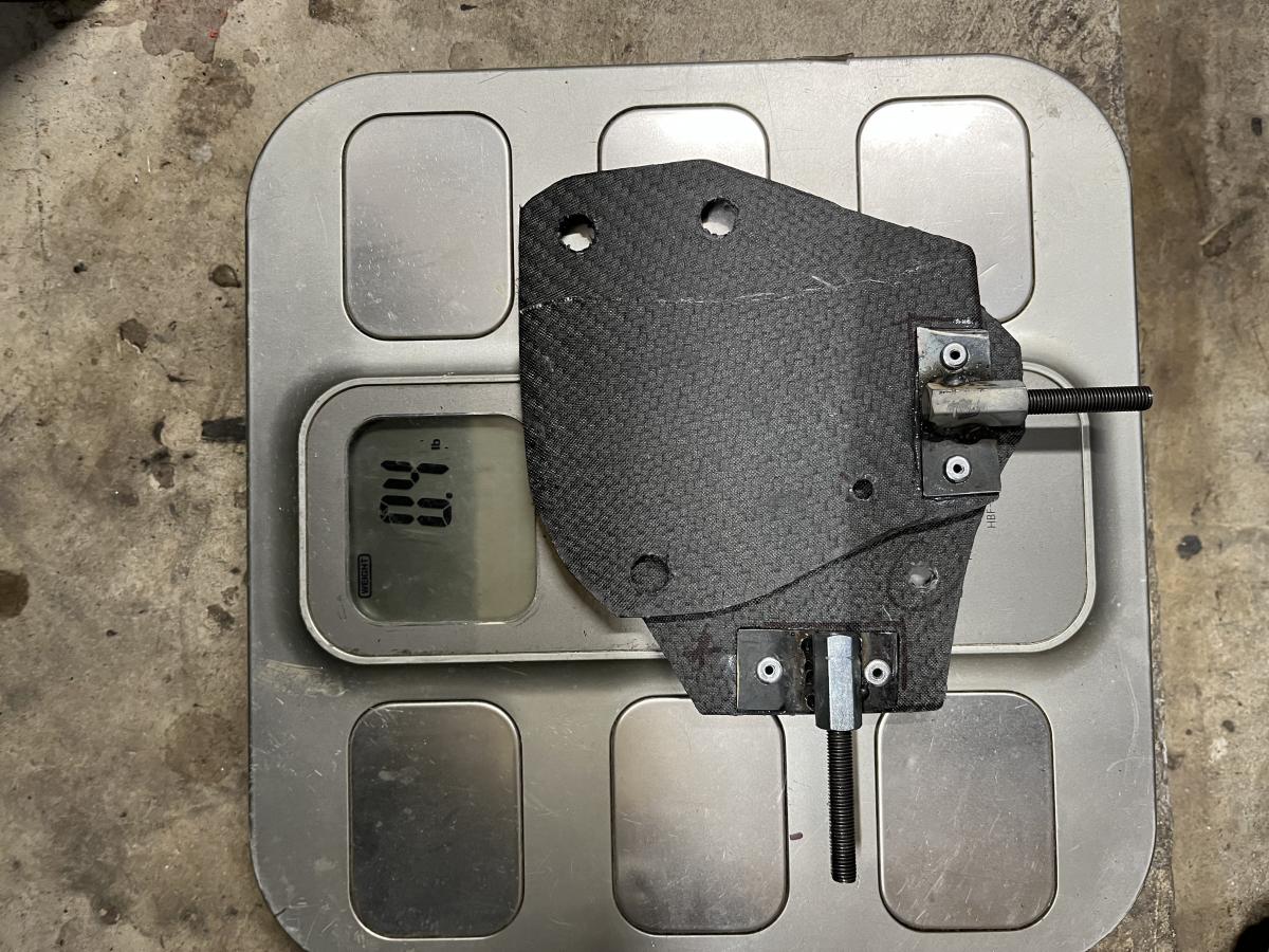

    Found a project. I have some extra material laying around. Gonna make these front splitter mount plates in CF. The plan is to weld the top coupler nut to a small steel tab and then bond and rivet steel tab to the CF plate.

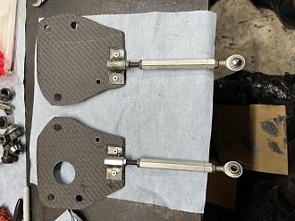

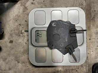

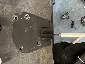

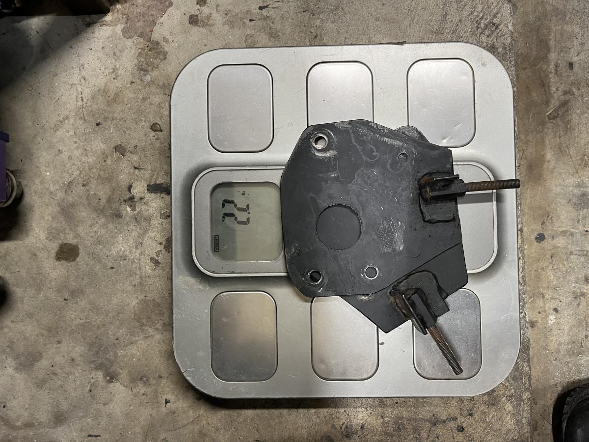

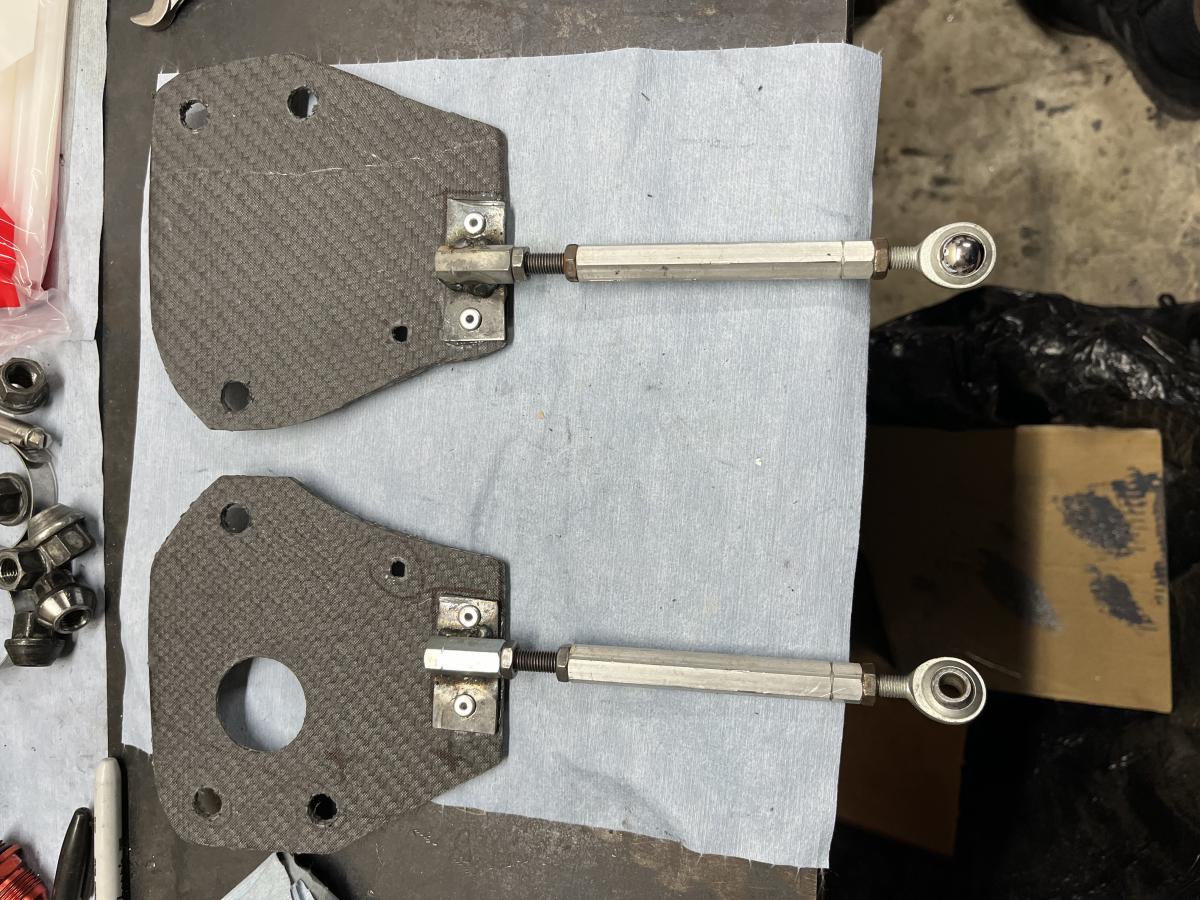

                              Finished the carbon front splitter mounts. I’ll do the jump up and down on the splitter test when I get the rest of the car back together. Saved almost 2 lbs!
                              Click image for larger version  Name:	0E5451D7-945B-4E40-BD06-6848D8D27462.jpg Views:	0 Size:	178.4 KB ID:	200643
                              1/8" steel plates
                              Click image for larger version  Name:	50667A17-802B-431C-8708-B815738E2685.jpg Views:	0 Size:	177.8 KB ID:	200644
                              CF plates
                              Click image for larger version  Name:	8EA92D74-FE46-4342-BE72-B7EADD03BAA7.jpg Views:	0 Size:	193.6 KB ID:	200645
