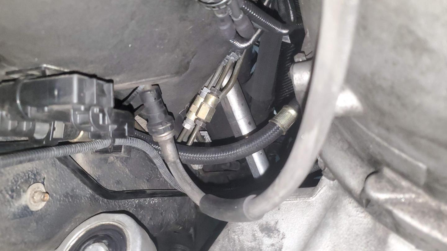

            The other way you can do this —without running all new brake lines— is to intercept the two rear brake lines by the steering column. They have unions from the factory, so you could unbolt the sections that go to the MK20 and run new lines to the MK60. Should just need to remove the intake for this, probably don't even need to get under the car. Pic below.
            Click image for larger version  Name:	20220828_175224.jpg Views:	0 Size:	113.9 KB ID:	186035
            You would still need to run two new front lines though. Probably also worth to swap out the booster and master cylinder is you're going that route.
