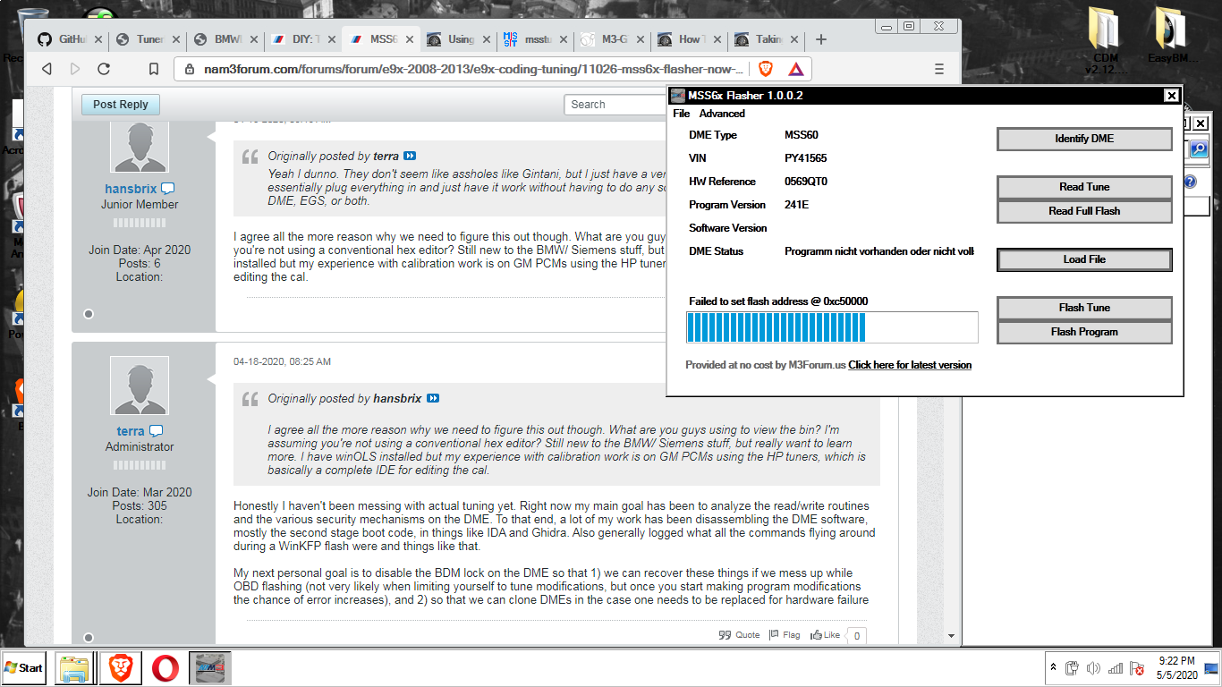

                      Had an error trying to flash the RSA Bypass fast. Using Bimmergeeks cable just bought. What should I do to recover or is my ecu permanently bricked? Should I try WinKFP to reprogram the ECU? Do I enter my full VIN in WinKFP or just the abbreviation?Click image for larger version  Name:	Failed to set flash address.png Views:	0 Size:	256.5 KB ID:	21275
                        Does the dme respond at all in tool32 or inpa or WinKFP? If so try reflashing with WinKFP. I’d just use the update function - it’ll figure out the VIN and such from there on its own.
                        If it doesn’t send me the backup file you made and I’ll clone it onto my dme and overnight that to you.
                        I don’t think it is bricked if it got to the step you’re at.

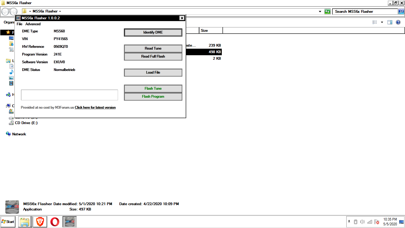

                          Update to my post above: Reflashed the ECU with WinKFP. Put in my vin. Reflashed without a problem. Started the car up without any issues at all.
                          Used the program to identify the ECU afterwards as well.

                            Thanks Terra for your response. It reflashed in WinKFP. I should note that I was using version 1.0.0.2. Should I update to 1.0.0.3 and try again flashing the RSA bypass fast?
                              Yeah I think the new version is worth a try. Seems like using the ftdi driver is a bit more stable for flashing.
