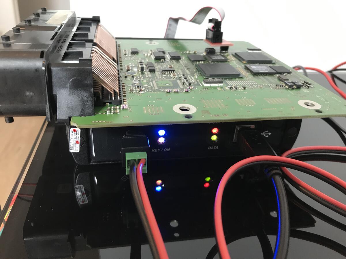

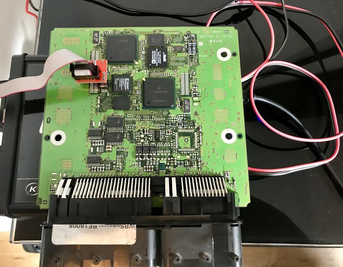

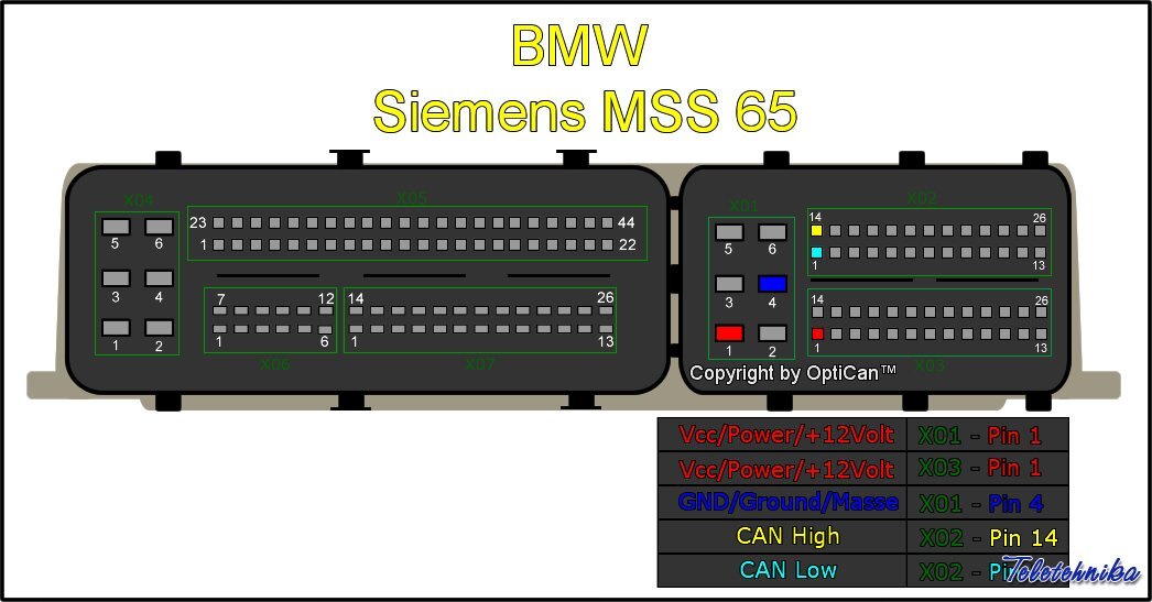

    The RSA BYPASS went well for my MSS65 on the bench,
    Now i can read the RAM and lSN Number

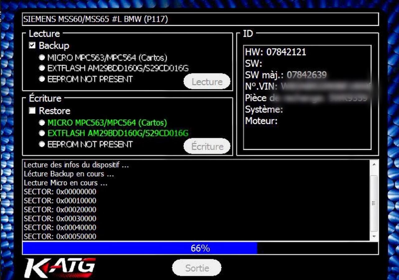

    Hi, no problem.
    Ive sent you processor l+r via KTag BDM via message.
    Regards and keep the job going on.
    For MSS60 the tools works awesome so far.
