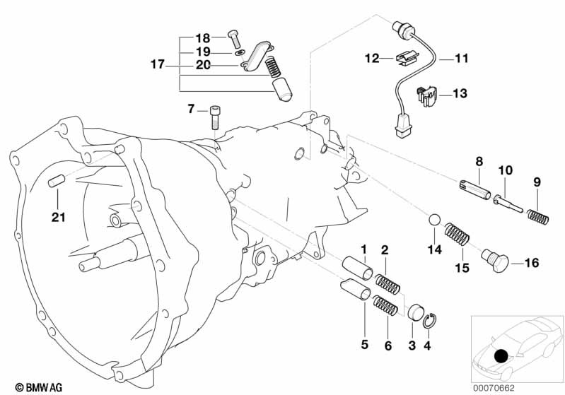

                      Here's a thread on the subject: https://nam3forum.com/forums/forum/m...ession-springs
                      This diagram and parts list from RealOEM helps, too. ​

                        Originally posted by 6speedS54 View Post
                        ...are there any symptoms to look for or is this just preventative? Also there pins and springs on the side of the transmission and on top, are you talking about all of them?
                        SMG transmissions break #15 pretty regularly so I always replace that even on 6MTs. I do 9 & 17 because I don't think it could hurt. Check the roller on #8 and make sure it still turns nicely.
                        Email to [email protected]

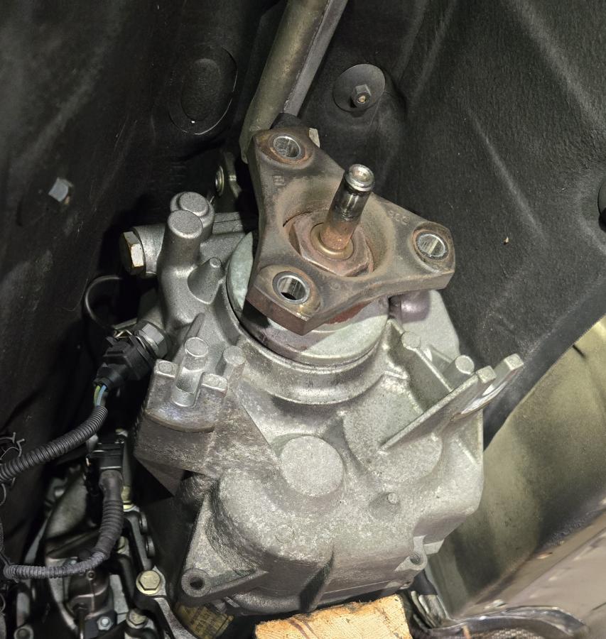

                            George Hill, you mentioned in a prior post that you haven't seen an output shaft that's leaked. With that noted, if the back of the transmission appears dry, should I leave the seal alone? I'd rather not create a leak if one doesn't exist. Seal is original (175K miles, ~23 years).
                              bimmerfan08 I'm a big fan of letting sleeping dogs lie on a part that is relatively easy to access.
