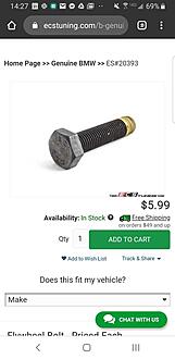

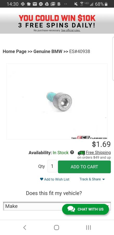

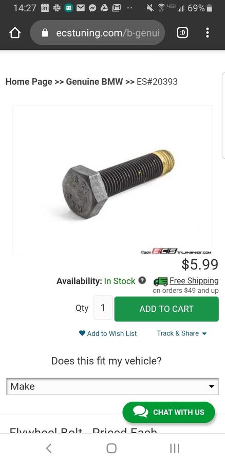

              The torque spec pdf has some "interesting" comments included for the flywheel bolts - it says to always replace and not to use locktite. Well, "always replace" is up to the owner, they are not stretch bolts, but regarding locktite comment, all new ones come with some sort of thread lock on them...Click image for larger version  Name:	Screenshot_20200418-142703_Chrome.jpg Views:	0 Size:	34.2 KB ID:	13724
              PP bolts in pdf says to always replace, no comment about locktite, but all new ones come with some thread lock.
              Click image for larger version  Name:	Screenshot_20200418-143004_Chrome.jpg Views:	0 Size:	33.7 KB ID:	13725
              Personally I replaced. If I were reusing, I would wipe the threads clean, brake cleaner blast them and use locktite.

                        Just be careful reusing.
                        I did get news ones with my flywheel but the are reusable is what I meant to say. I definitely put some blue locktite on them. JB Racing uses stronger bolts and in their directions it says basically the last thing you said. Clean and relocktite when removed. They also came with washers which I don't think OE bolts do. I believe this helps keep them tight. The reason they do this is because the flywheel is more track oriented. It doesn't come with actual threads, they insert helicoils instead of actually machining teeth into the aluminum. It's designed to be able to come off and go back on. My exhaust covers up alot of the chatter. I couldn't even tell there was any. The camera definitely picked it up though.
