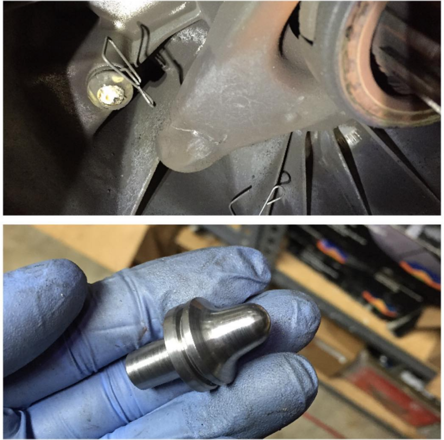

          Don’t get a brass pin. It will likely deform and bend before you even install it. They don’t fit perfectly and need some persuasion

            I find that all metal ones (brass, bronze, steel) require some filing down to fit properly into the bellhousing at proper height.

              Even the BMW steel pin (21511223281)?
                #52
                I did steel on one of the trannies, diameter on the end going into bellhousing had to be filed. Maybe it was a bad batch few years ago.

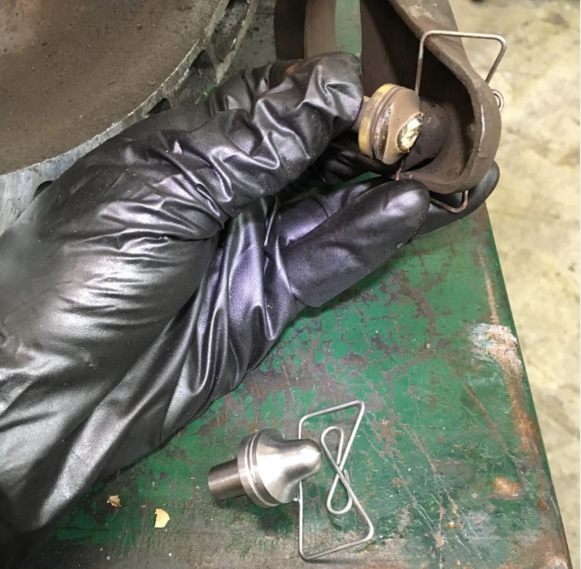

                        There is no clunking because the fork is attached to the pin via a spring clip and the two surfaces are in constant contact, plus you grease the mating surfaces.

                              Yeah, it's a close call for me-- close enough that I have a BMW metal pivot pin on the shelf that I opted not to install, but also didn't get rid of
                              It's basically comes down to the slight chance of a failure from the plastic one vs the guaranteed but pretty insignificant NHV increase from the metal one. I end up on new plastic, but I wouldn't fault anyone for going the other way.
                              ... but definitely not brass.
                              Part that can fail vs part that can't. To me it's a no brainer!
