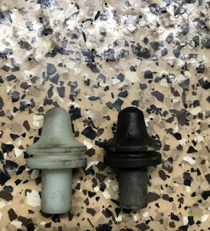

                    This was my pivot pin after 140k miles next to the new one. I think some people are just really harsh drivers

                      #40
Name:	Screen Shot 2020-04-13 at 2.42.46 PM.png
                      Interesting how there seems to be so much variation. Maybe it's an effect of failures being more compelling to report? Regardless, I'll update this thread with the condition of my pivot pin when I do all of this.
