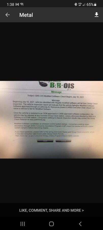

        Oh shit this software thing goes into effect Jul 19. I'll do what I can to get my car smogged this week. That will at least buy me two years before I have to get it smogged again.
                What's your source on this? I'm going through the regs right now and haven't seen this, only saw it was proposed
                      Page 9 of the link Samsonite79 posted: https://www.bar.ca.gov/pdf/BAG/20210...d_Software.pdf

                        I really don't see how modifying a little code is going to change the serial numbers. As long as the ECU is your original, should be fine I would guess.
                          Sure, if the CVN and CAL ID are just constants stored in the firmware (serial numbers, hardware/software numbers, etc), then getting past these checks is trivial.
                          However, the documents posted make it seem like the CVN is actually a checksum. This is a mathematical operation that is performed on the entirety of the software to produce a number. So yes, even if you change a single bit, the checksum will change too.

                              The e46 may be exempt. Manufacturers were not required to submit CAL ID and CVN info for 2007 and prior years.
                              Page 6 of http://ww2.arb.ca.gov/sites/default/...og/msc0623.pdf
                              CAL ID & CVN
                              Section (g)(4.7.4) of the OBD II regulation requires manufacturers to submit CAL ID and CVN information. A template titled “CAL ID and CVN Data” is provided in this Mail-Out as Attachment E. For 2008 and subsequent model years, manufacturers are required to use the Microsoft Excel electronic template provided on the ARB website http://www.arb.ca.gov/msprog/obdprog/obdprog.htm for reporting and electronically submitting CAL ID and CVN data to ARB.
                                heinzboehmer has it correct.
                                Everyone needs to realize that if the CVN is indeed a checksum, which is how it reads, rather than a simple stored value then any modification to the DME will cause you to be flagged as your CVN would then be incorrect. I can't believe CVN is a simple stored value because it's usefulness as a software modification check would then be zero. It almost assuredly is a calculated value. If you aren't a computer guy your thinking what do you mean calculated? A little formula using the OE software engine parameters as inputs will be used to produce a value. Change an engine parameter, change the value that is produced by the calculation.
