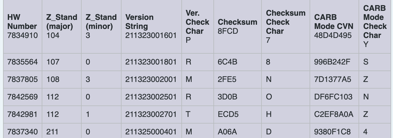

                      It's calculated. Exactly how it's calculated isn't entirely clear to me. IIRC @gpetersen found that if you brute force the checksum such that the calculated checksum is equal to the stock value, then the CVN is also correct. So it's either itself a CRC16 (of each half) with a different initial value and/or polynomial, or it's some sort of calculation that's done to the calculated checksum.
                      Probably wouldn't be crazy difficult to hardcode the program to return a valid value
                      Maybe it's time for us to start a database/chart of what HW belongs to which SW, CAL, CVN so that we can reference back in case we do return to stock or "unmodified" software. This way, we can get an idea if we got the correct MODE 9 data for the california tree huggers... lol
                      So far I know this is real and true, which is for my MSS54 (non-hp):
                      for version 211322002801J469
                      SW ID: 7842975
                      CVN: 59D512B9
                      Cali ID: 7842974
                      CVN: 7DCC4B79
                      Program & CVN # can be found on https://nam3forum.com/forums/forum/s...me-information
                      but not the calibration/tune CVN#.

                          If we can disable CRC check and modify the CVN and Cal ID to that of virgin stock tune parameters, this will be easy to bypass by spoofing. I'm thinking just mirror all these checksum parameters in the tune file (pic below) from the reference tables in the mss54 master page to match a virgin tune then just roll up lol. If its possible this will create some insane demand. Think of all the manual swap cars on hacked tunes.
                          Only other option is to do what repoman suggested which would be to modify unused sections of the tune to adjust the checksum calculation to match the virgin cvn number.
