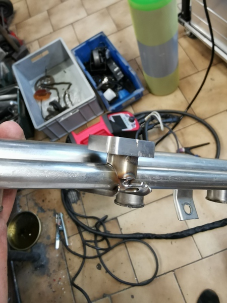

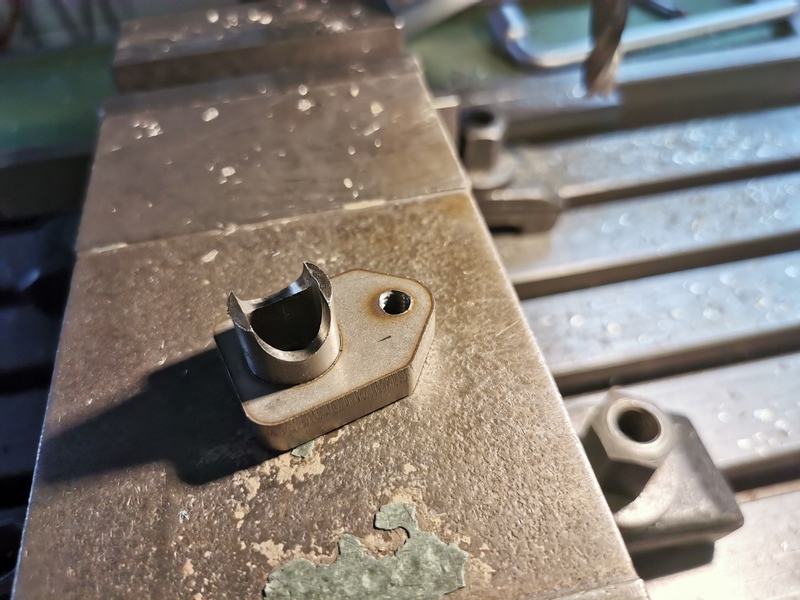

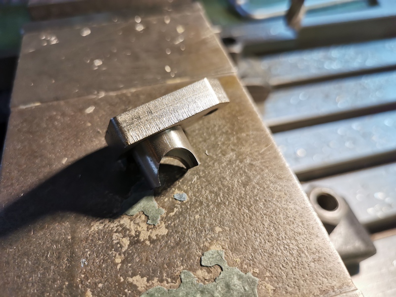

    Here is the laser cutted adapter:
    Click image for larger version  Name:	img_20210416_145705mmj18.jpg Views:	0 Size:	197.3 KB ID:	113315
    Click image for larger version  Name:	img_20210416_145709atkht.jpg Views:	0 Size:	195.7 KB ID:	113316​

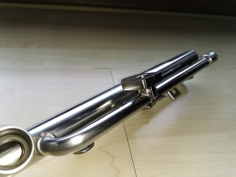

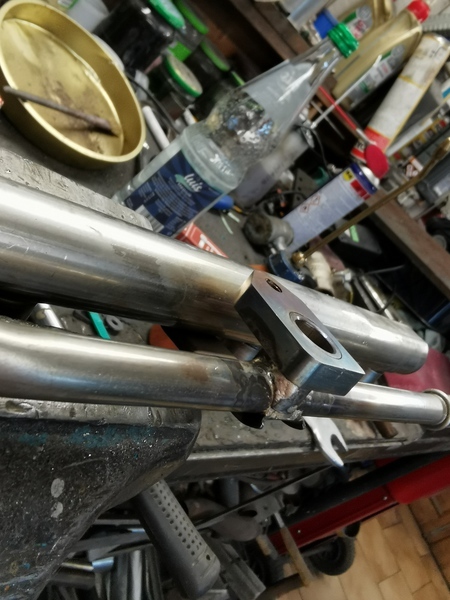

    The most difficult thing has been to connect the adapter gastight to the air rail.
    Click image for larger version  Name:	img_20210417_145731fwjuo.jpg Views:	0 Size:	109.5 KB ID:	113318Click image for larger version  Name:	12rkpg.jpg Views:	0 Size:	126.1 KB ID:	113317​

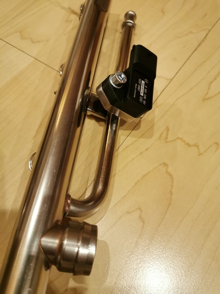

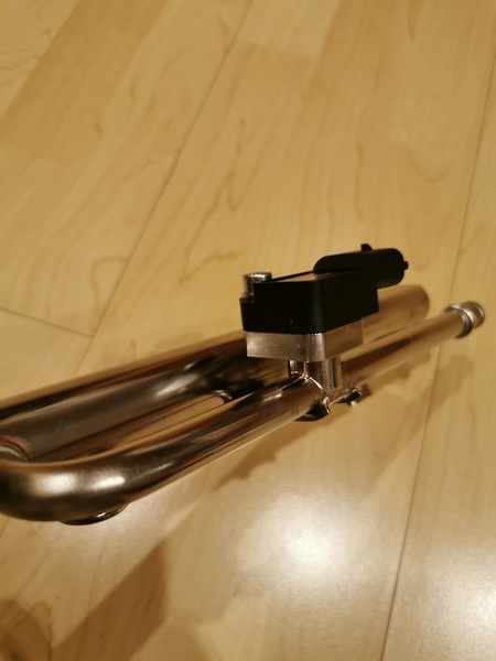

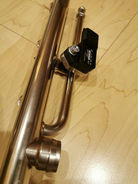

    After cleaning everything and the test if it is gas tight - here's the final result.
    Click image for larger version  Name:	img_20210416_2136475jk3n.jpg Views:	0 Size:	65.7 KB ID:	113319Click image for larger version  Name:	img_20210416_21432465j4c.jpg Views:	0 Size:	73.7 KB ID:	113321​
    Click image for larger version  Name:	img_20210416_214316iek02.jpg Views:	0 Size:	100.3 KB ID:	113325
    Click image for larger version  Name:	img_20210417_1619460tj71.jpg Views:	0 Size:	124.7 KB ID:	113326

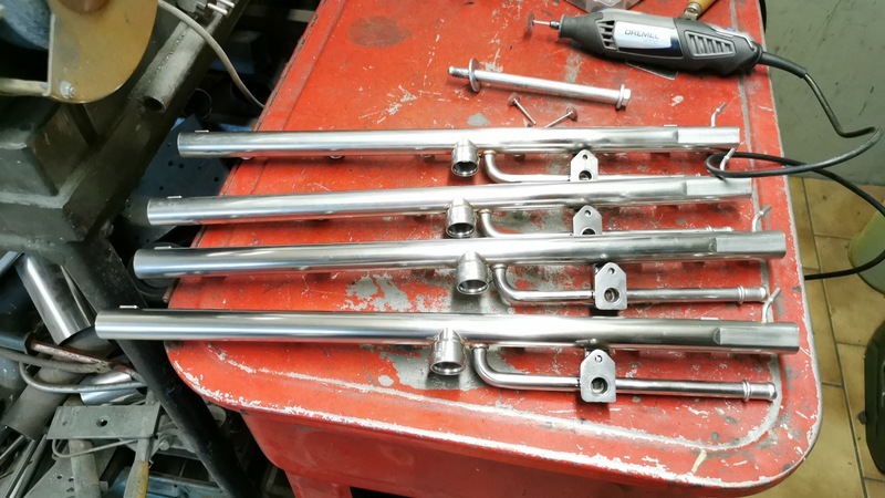

    Some friend of mine also wanted to have this rail. Every rail looks a little different because it is hand made ;-)
    Click image for larger version  Name:	img-20210605-wa0065h8jyf.jpg Views:	0 Size:	130.8 KB ID:	113322

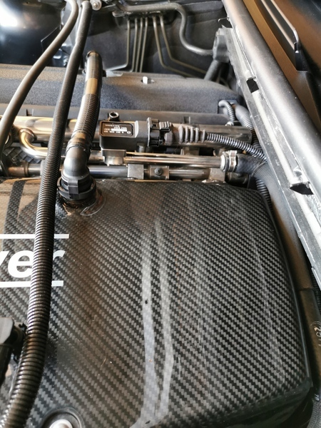

    This is how the adapter is located in the car - but on the pics it is the first adapter i built (it looks a little different, but the location is the same).
    Click image for larger version  Name:	img_20201203_1335381uj78.jpg Views:	0 Size:	164.0 KB ID:	113323Click image for larger version  Name:	img_20201203_133540lak0d.jpg Views:	0 Size:	153.9 KB ID:	113324
