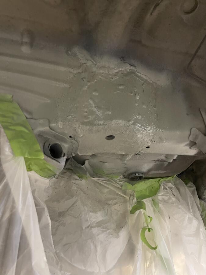

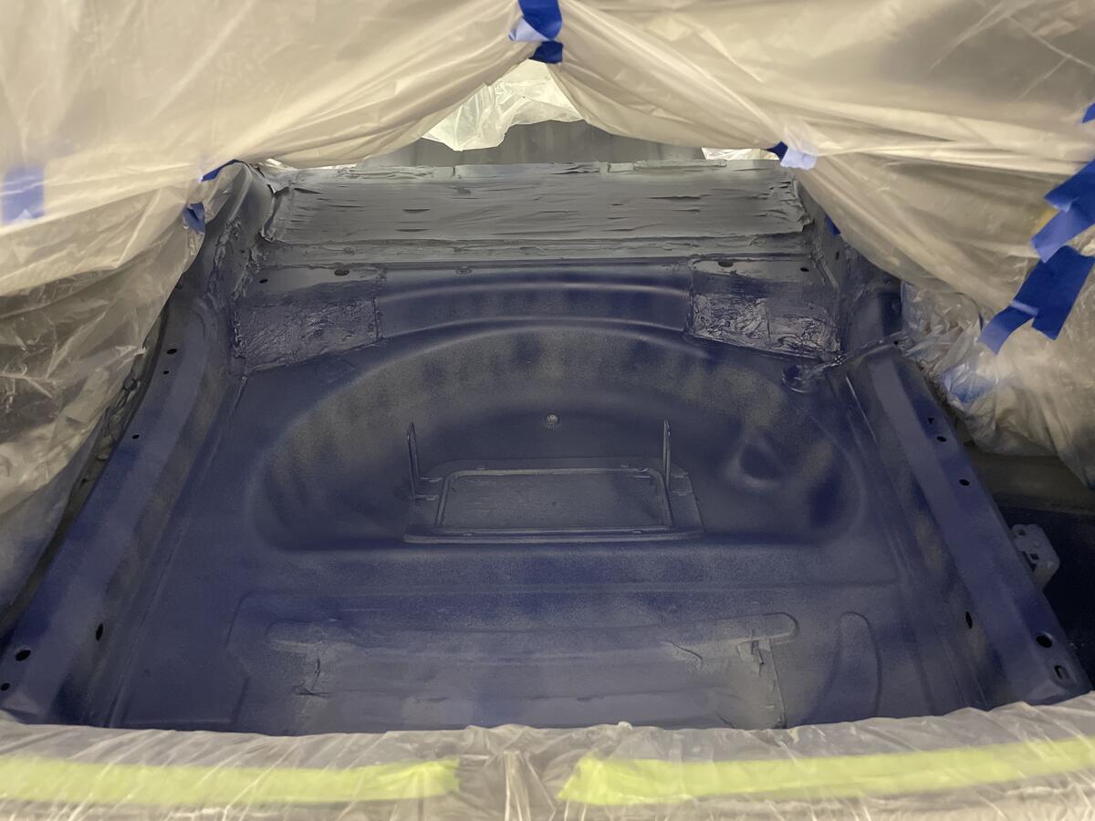

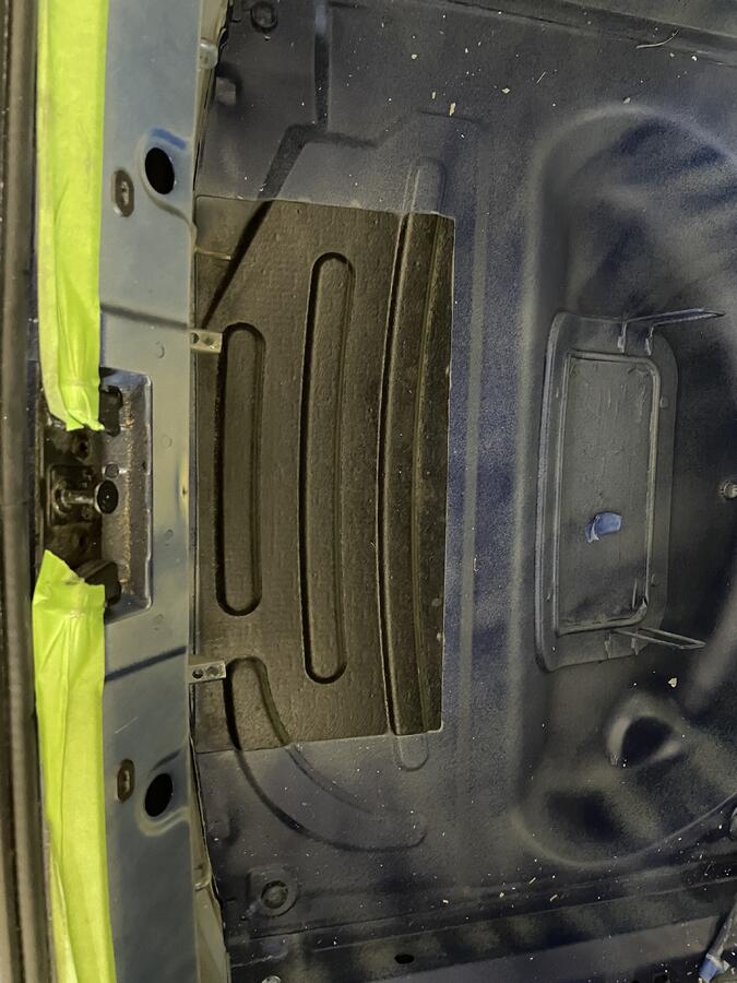

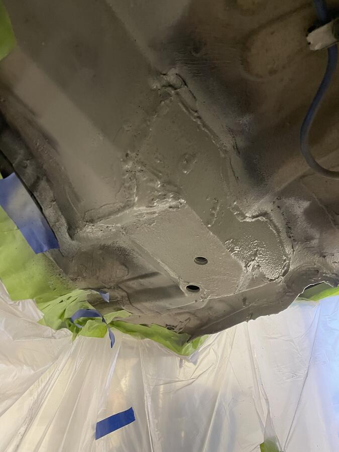

      I finished up the paint/underbody stuff tonight. I tried to replicate the factory "overspray" and now just have a dusted blue trunk. I kinda wish I left it the ecoat color, but it is supposed to be blue. When it dried, the color ended up being appropriate(ignore the white specs from my masking plastic). Click image for larger version  Name:	IMG_4729.jpeg Views:	0 Size:	83.8 KB ID:	125695 Click image for larger version  Name:	IMG_4728.jpg Views:	0 Size:	101.2 KB ID:	125520 Click image for larger version  Name:	IMG_4726.jpg Views:	0 Size:	49.5 KB ID:	125521 Click image for larger version  Name:	IMG_4727.jpg Views:	0 Size:	59.5 KB ID:	125522

                    No bolt like the vincebar or cmp. You drill through the spot welds in the cavity on either side and plug weld to the reinforcemnt plate underneat around the threaded portion of the rear mounts. The front mount, they just wanted teh factory mig welds ground down and rewelded and cracked repaired there.

                        I'm not really sure what that means. The stud is in its normal place and the sheet metal inside is welded to the plate in the form of plug welds instead of the factory spot welds, if that makes sense. Nothing is done to the stud. Just those plugs to the underside and the side plate that is welded to connect the frame rail to the RACP.
