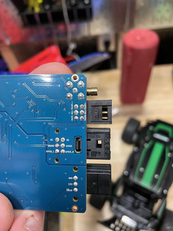

                      Does anyone have the part number, or can take a quick picture of the 6 pin TCU I/O pin connector?
                      I'd like to get my phone up and running and am comfortable doing the de-pinning exercise: https://github.com/tedsalmon/BlueBus...-TCU-connector
                      TE make a lot of connectors. On the board side it just says "AMP".
                        Here's what Ted shared with me when I posed the same question via email:
                        The TCU header is a different family than what the car uses so the terminals are not interchangeable (car uses TE MQS and the TCU header is TE AMPMODIV). The reason is that the only 6 pin connector available in the MQS family was literally the same one as the 6 pin analog audio connector, so I couldn't use it as it would create massive confusion.
                        For de-pinning, I supply the MQS 6-pin that is used for the 6 pin analog audio connector, since it just so happens to mate into the TCU connector (its part number is TE 185311-1). The ACTUAL housing is TE 87977-1
                        Does that make things UNclear enough?
                        LOL - I didn't catch the nuance, if there was one. I bought the 185311-1 and it worked well enough.

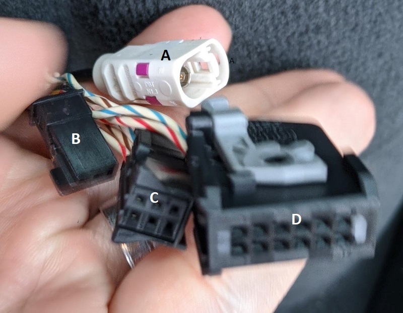

                          Hi all. Just picked up an E83 X3 for my son, and it has the hifi DSP stereo and bluetooth. Just like my E46 M3, the stock bluetooth system just doesn't seem to be compatible with modern phones and/or doesn't connect consistently, so I was happy to see the BlueBus was compatible. Will be nice to just stick with the overall stock system as it has the flip up Nav screen and I love what the BlueBus can do with the stock Nav unit. If I hadn't already "upgraded" my M3 to an Android Xtron unit (looks almost stock) I would have bought this earlier last year when it was just being started out.
                          Below are the CD changer cables I found. Do I also need to pick up the light blue connector from the bluetooth module with the adapter cable to use the built-in telephone wiring? Is the adapter cable included?
                          Referencing my pictures, connectors B and C seem to match what I've seen for power and iBus connectivity. Connector A...is that the digital connection? Can I use that as-is with the BlueBus? The digital coax connector I saw in an E39 M5 installation video looked different, and doesn't seem like this connector would fit in the BlueBus. As for Connector D, not sure what that is for.

                            James,
                            Few things going on --
                            1. E8x vehicles will always use the black 54-pin adapter. The E8x were never offered with SES (blue) pre-wiring because BMW had already rolled that functionality into the latest stock "Everest" TCU (the one your car came with).
                            2. E8x vehicles with the DSP amplifier cannot make use of the digital output from the BlueBus without modification. Though it's still possible to make it work, the DSP must be dismantled and the SMB coax connector must be soldered onto the existing footprint on the PCB. Thankfully, the casement has a cutout, so that's the bulk of the work.
                            3. Most E83s (and not other E8x cars that I know of) came pre-wired for Sirius, which is the 14 pin connector in your picture. This usually means you'll need to muck with the radio wiring and "swap" the white connector on the radios quadlock from the "CDC" one to the other one floating about. The E83s CD Changer (CDC) location is in the center console, not in the trunk, so they had to add extra wiring to support the Sirius.

                              So assuming I want the "easy" version and not the best version, what am I looking at? a) pull the radio of the dash and move the white wire, then b) use the black 54-pin adapter and the 3-wire power connection? I'm prepared to video/write-up the E83 installation, but I've had my share of radio projects and don't want to invest much beyond some time and BlueBus money on this one. Much more than a BlueBus in cost and I can buy an Android unit and iDrive style controller for the E83.
                                For A, refer to: https://www.manualslib.com/manual/82...?page=4#manual (4th picture). You'd want to swap in the white connector labeled "CD-SDARS".
                                For B, the 54-pin connector you want is currently attached to the factory Bluetooth. It should be a fairly quick install, though certainly more involved than the E39 and E46.
