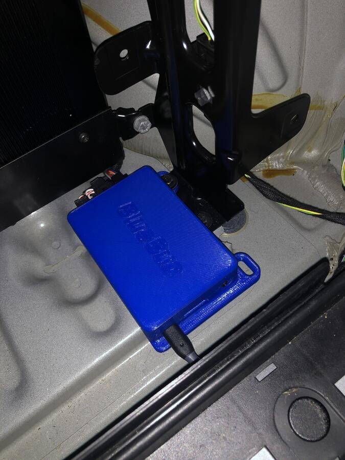

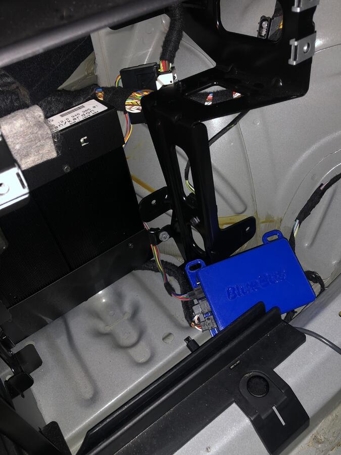

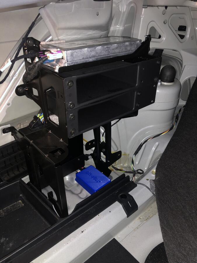

                      Hmm, is there any chance you snapped a picture before buttoning it back up?
                      When testing calls, are you placing the call from BT mode or FM/AM/Sirius?
                      Thanks!
                      -Ted

                            Here you go, Ted. I went with an alternate mounting location because I didn't want to remove the original TCU. The last picture shows the routing of the TCU adapter cable and a better visual of the connections to the bluebus after unbolting it from where it normally sits.
                            I have tried placing the call from BT mode and from FM - same issue in both cases. In order to reduce the echo for the person on the other side of the call, I have to reduce the volume in the car to the point that it's hard to hear the caller.

                              Can you shoot me an email at [email protected], please? There's a few avenues to pursue, and I don't want to keep bumping this thread
                              -Ted
