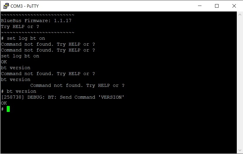

      Is it below 50F where you are? With the E53 unit, could you possibly try this rather odd procedure to test?
      1. Remove the unit from the car and place it in the freezer for 60+ minutes.
      2. Remove the unit from the freezer and immediately plug it into the USB port of a computer, make sure NOT to unplug it.
      3, Follow this guide: https://github.com/tedsalmon/BlueBus...g-the-Terminal
      4. Run these commands:
      set log bt on
      bt version
      5. Post the results
      If it *only* says `SEND COMMAND 'VERSION'`, then there's a problem . If it shows the MAC ID and other tid bits, then it might be something else.
      -Ted
      I finally ran the cold test after having received my latest bluebus order (nice upgrades on the new case btw). Yes, it looks like the unit that was in my E53 suffered this issue.

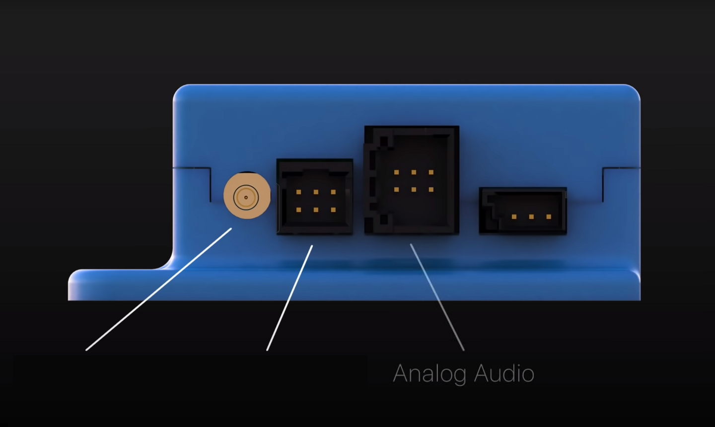

                                Hi guys,
                                do you know PIN description for the analog audio output?
                                Thx
